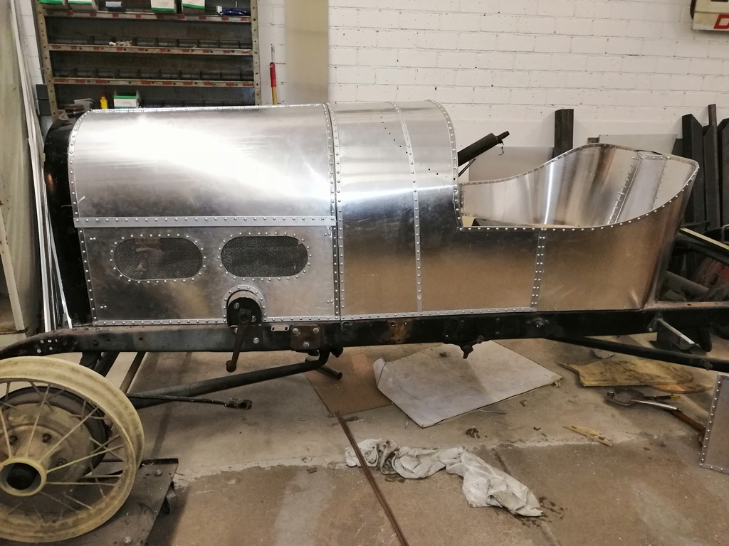

  1. Thought I show you guys what I'm building here in the Netherlands.
    Its something like a Speedster and/or Hot Rod on a A-Ford ch***is and driveline.
    With a basic idea in my head but the detailes will change during the build........

  2. chevy57dude
    Joined: Dec 10, 2007
    Posts: 9,871
    chevy57dude
    Hand built body, very nice.

  4. Phil P
    Joined: Jan 1, 2018
    Posts: 563
    Phil P
    I really like the rivets.

  6. Fordors
    Joined: Sep 22, 2016
    Posts: 6,691
    Fordors
    You are a very talented sheet metal worker, well done!

  7. cjtwigt
    Joined: Dec 23, 2017
    Posts: 148
    cjtwigt
    Mooi man! Is dat alu? Waar zit je in Nederland?
    Groet uit Abbekerk
    De Konjel likes this.
  8. Ha haha! Yep, gemaakt van 1,5mm aluminium.
    Kom uit Hilvarenbeek. Niet echt in de buurt van Abbekerk.... [emoji848]

  11. Atwater Mike
    Joined: May 31, 2002
    Posts: 11,618
    Atwater Mike
    That's .063" aluminum...here... Nice to work with, real nice yield with the smooth curves, and rivets galore!
    This is an exciting project!
    (recall the new poster began the project with 'No specific plan, but an idea in my head, and the details may change'. This is the stuff experts are made of...)

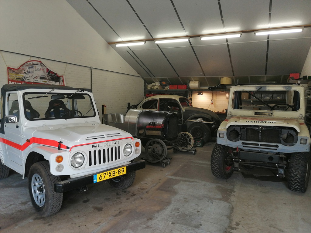

  12. With our country almost locked perhaps some more time to put in this build.............[​IMG]
