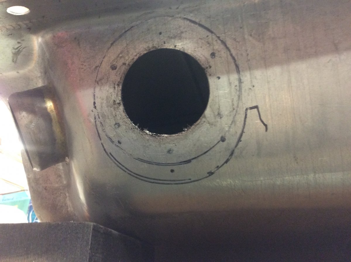

    Cold here today , so I started working on the gas tank . To do my cutting without getting chips inside I coated everything in grease and put a magnet inside next to hole and on the hole saw . Cut it on the side with the top pointed down . Worked great . Only got about 20 little chips inside that I can find .
    After doing all the chip making , I put the backup ring in and spot welded in place . Mounted the fuel gauge sender also . Ready to be installed as soon as it warms up enough to seam seal and insulation.

    Note all the chips above . Below I used a file backwards so chips came out, did this upside down. Cleaned out inside with vacuum cleaner, magnet, and a duct tape mop on a stick . Worked great .

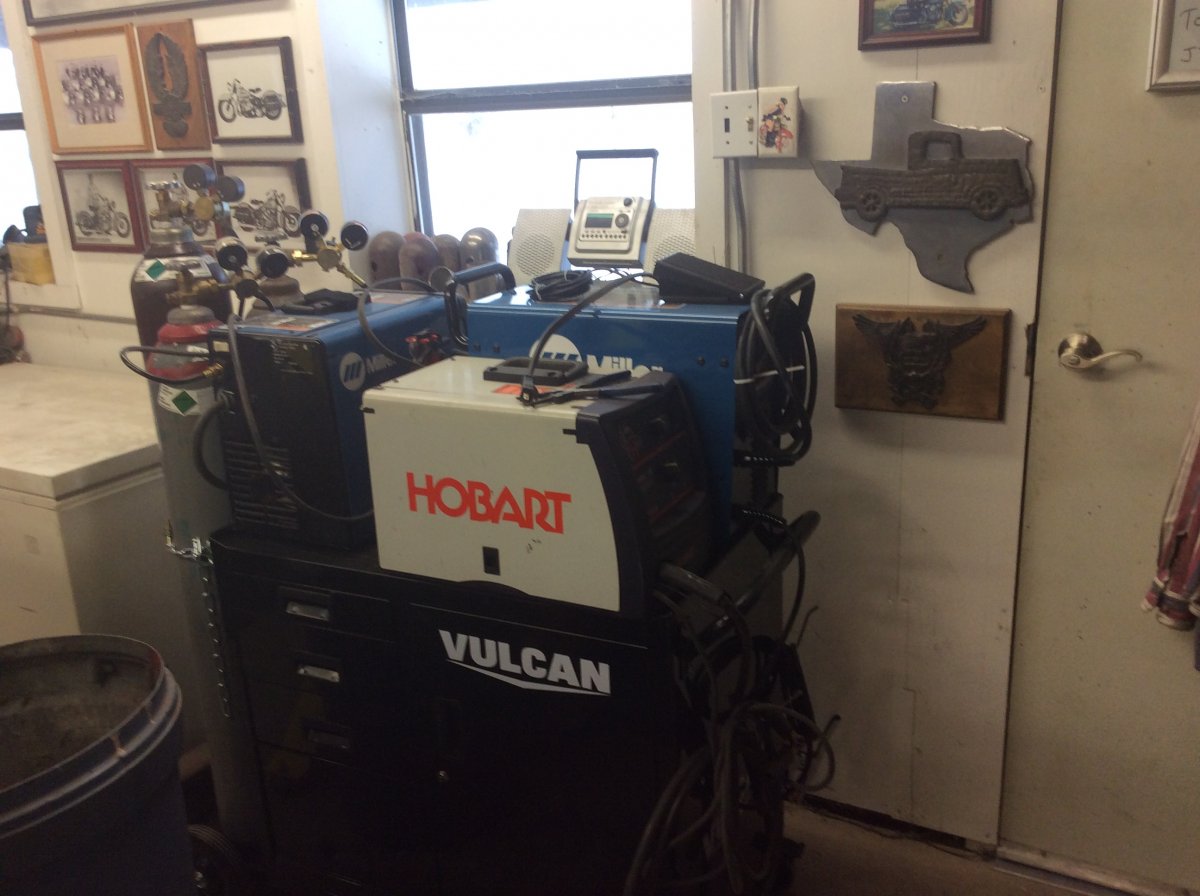

    How is that Hobart welder? I've been looking at getting the Hobart 190

    The Hobart has been good , first mig a bought . I like it because it has a purge for whatever gas your using. I also have a Miller 211 mig and a Miller 185 tig which I love . I have the Hobart loaded with 22 wire and the Miller filled with 35 .works good for me .
