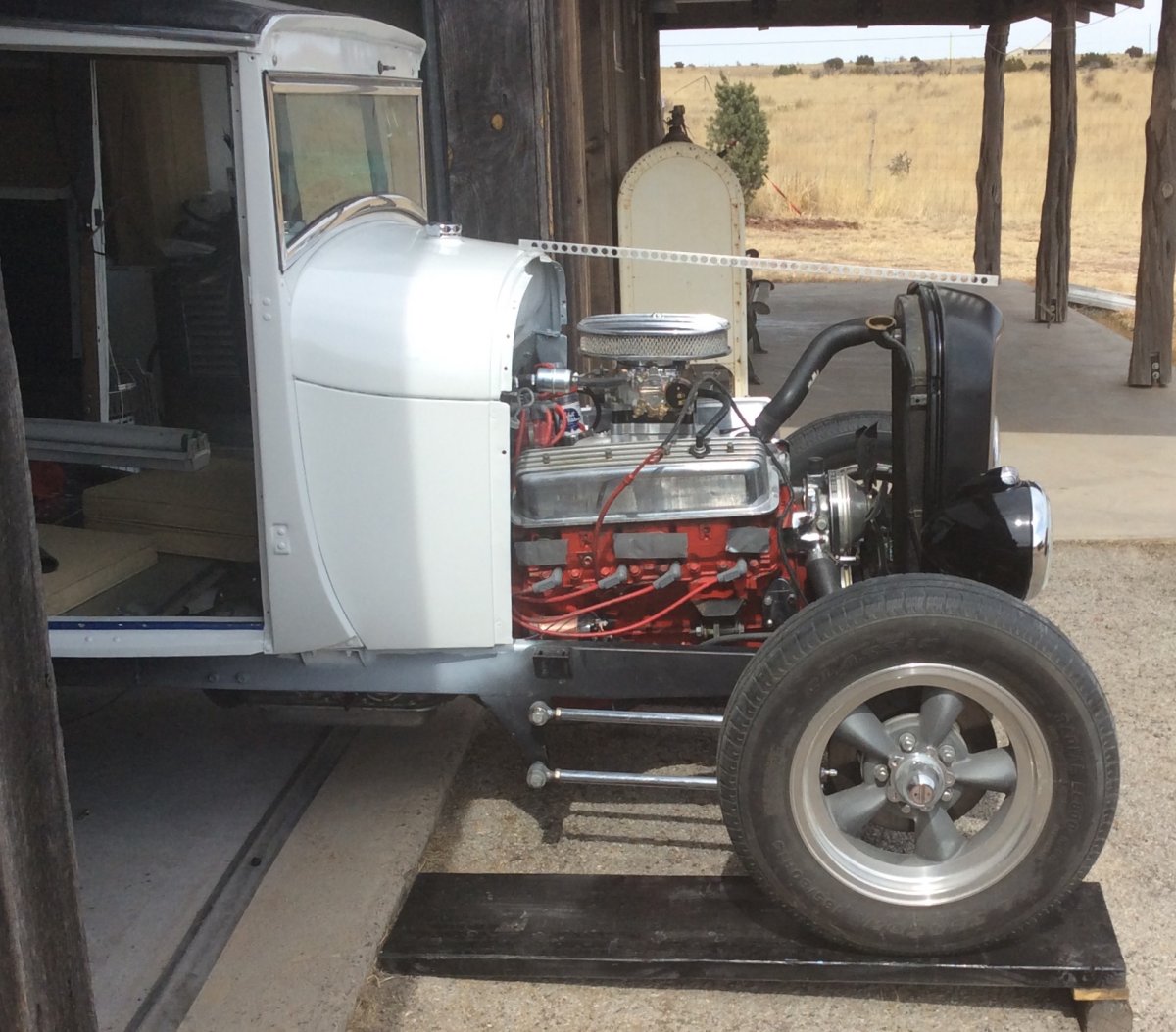

    Most guys have it turned the other way . Fit great either way . Mounted this way cause it made a fairly flat surface toward front . I think , and will find out this week , when I start my bead rolled Al. Panels .

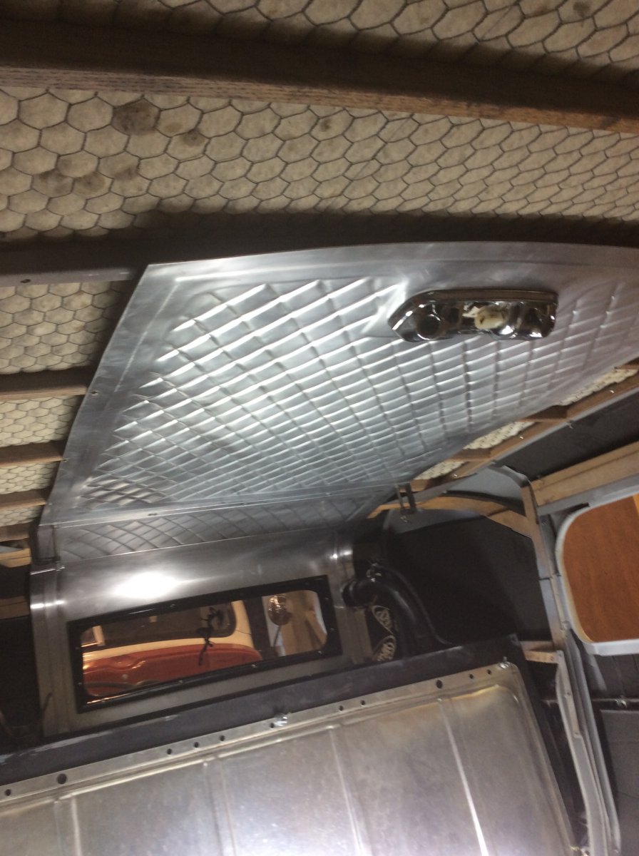

    Well I rolled the next headliner panel . Made the diamonds a little deeper and didn’t sneak up on them . This stretched the material more and gave it a curve . I will work it a little and it should match the crown of the bows in the top . Will cut the hole for interior light and mount it into the other panel and check the fit . Haven’t decided if to polish or not . It’s a little crowded as you can see , best lighting shop .

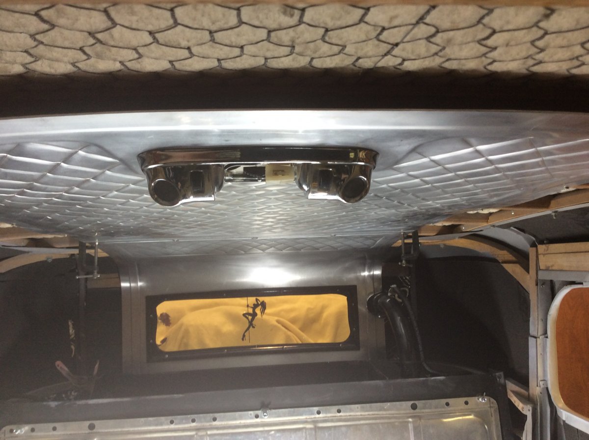

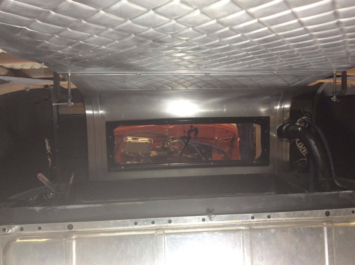

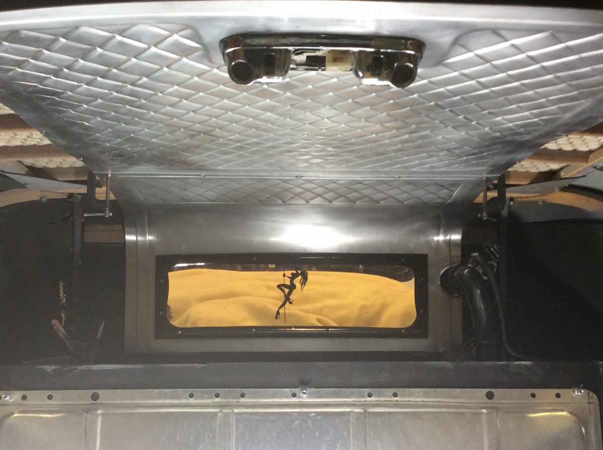

    Two down and mounted . Started making patterns for rest of headliner . Pole dancer came with the car . Going to run gas lines and the long battery cables .

  11. loudbang
    Posts: 40,349
    I don't know your seating position but it MAY be that those lights MAY be pointed towards the front but MAY be needed to be turned around.?? I had them in an ot car and they were pointed more downwards yours MAY point over your shoulder and out the front window the way they point now. Unless they swivel???

    Good catch , Bang . If turned around it will spot in very rear . I will check it when I get the seats in . Can’t really tell yet but looks like it will shine on dash . Left the wires long above . Little tweaking may be called for . Blue

    I have one of those same dome lights in my 75 F250 four door, came out of a big Mercury. It's mounted in the center and just behind my shoulder. Shines on my (or my p***engers) knees. Just right for reading a map or do***ent, or, haha, when I built the truck 30 years ago, just right for reading the label on c***ette tapes.

    Not a focused beam. Lights an area a couple feet square at knee level. Mine does anyway, might be different lenses in some models.

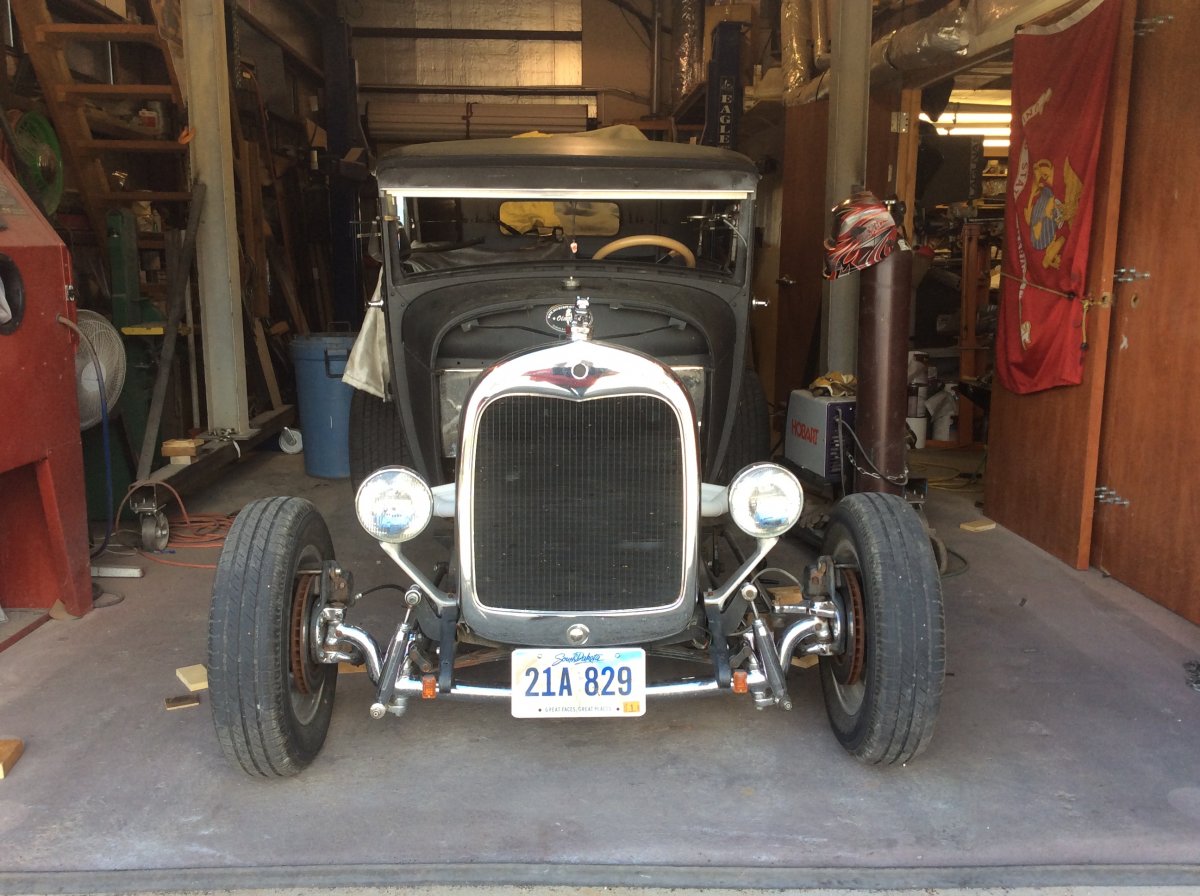

    Finishing up some little thing this morn when my A.D.D. kicked in and decided to change the look of the front . Need to get lights where I needed them for wiring. I think I like it just need to square it up and make some mounts . I have an idea for a hood I’m going to build in the future .
    Before:
    After :
    0DF78CD1-64B5-47E5-B2B6-E8AFCFDAEAA7.jpeg 9CE14034-931B-44DD-8B8C-AC402BC18988.jpeg EA7CD428-638D-40E2-9FCA-C780E6ED10C5.jpeg
    I think I will like the slope of hood . Blue
