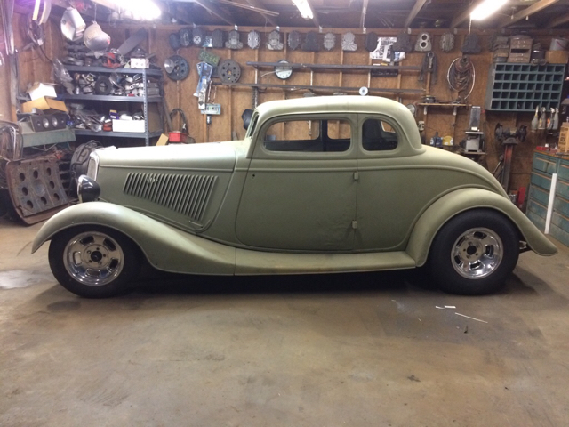

    Got the back down a few inches and got a quick pic. In my mind, the front is down a bit more but the reality of that is it ain't gonna happen with a fendered daily driver. I can live with it. I think.

  15. Maybe just a slightly shorter front tire? Just a 1/2" reduction in sidewall would help.

    Or a 1" shorter tire and another half-inch drop in axle. :D I am with you flamedabone. The stance is either right, or it's wrong. If it's a car to flip I probably wouldn't mess with it. But if it's a keeper I'd get it a little lower. You're making great progress...
