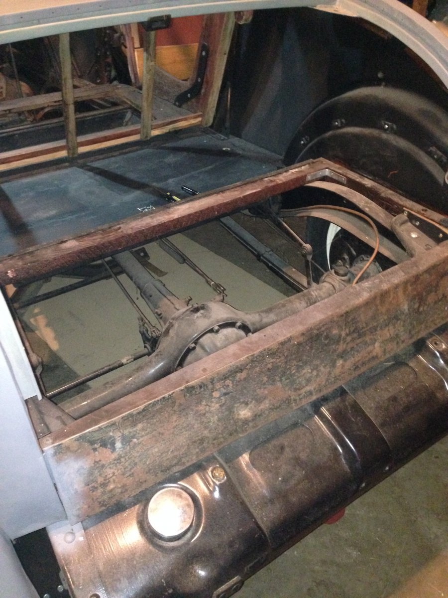

    Got back into the body shop at school this semester and dragged in my '32 to start the De-Wooding process. The biggest problem I have is nothing is really lining up in door/pillar/panel alignment with 1/3 original wood and 2/3 home built replacement wood from oak tables found at yard sales (second previous owner). Some of it is a real hack job, I found door shims made from broken paint sticks. :eek:
    I was able to square the roof today and got that braced up, working on removing 87 yr old stuck screws to pull the doors but it looks like the steel A pillar faces are coming without a fight.
    Does anyone know where I can find body measurements and dimensions for a 1932 Chevy Confederate Five window coupe? It would go a lot faster if I did not have to guess at how to fit everything back together.
