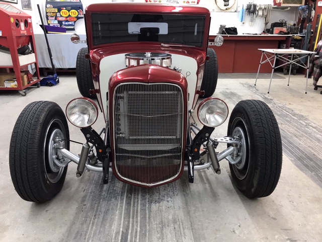

    Each has their opinion, and I wonder how many of them have really built a car with it and really drove it several thousands of miles. I have been making and using a Dead-Perch on my Hot Rod's for 40 years.
