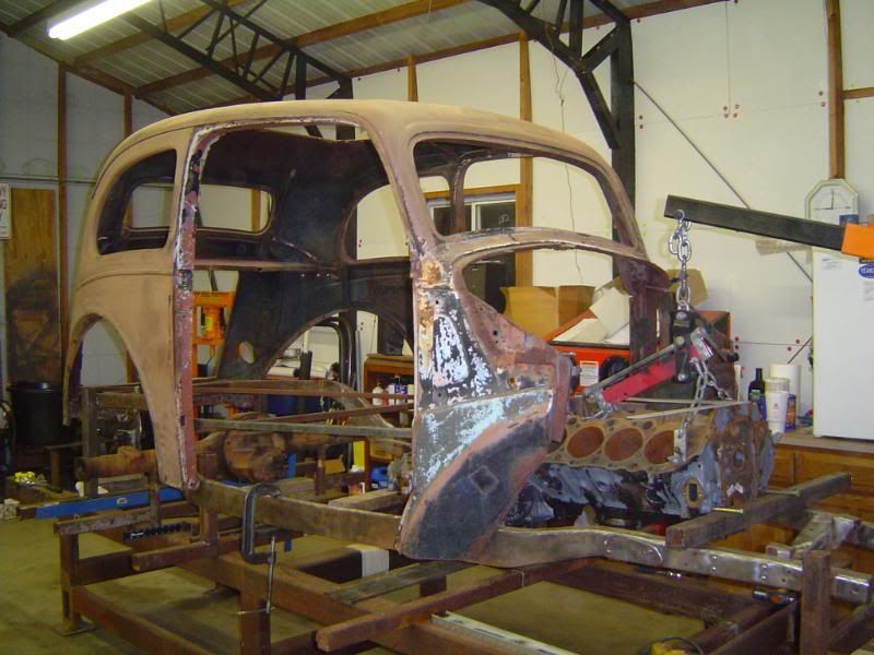

    Posted a little on this project on other forums but thought I would share here as well. Building a '48 Anglia pretty much for strip use only. Steel body, doors and deck lid, while the rest is all fibergl***. Going to try and run a boxed stock frame that will have a 12 pt. cage, coil overs, ladder bars, straight axle with transverse spring.
    Currently getting together a 496 BBC, TH400 and a 9" as well.
    Tons of details on parts and plans but I guess I will add as I go on this. Here is the body:
    ...and here is the frame on the jig ready to be worked on:
    Square one on a project.

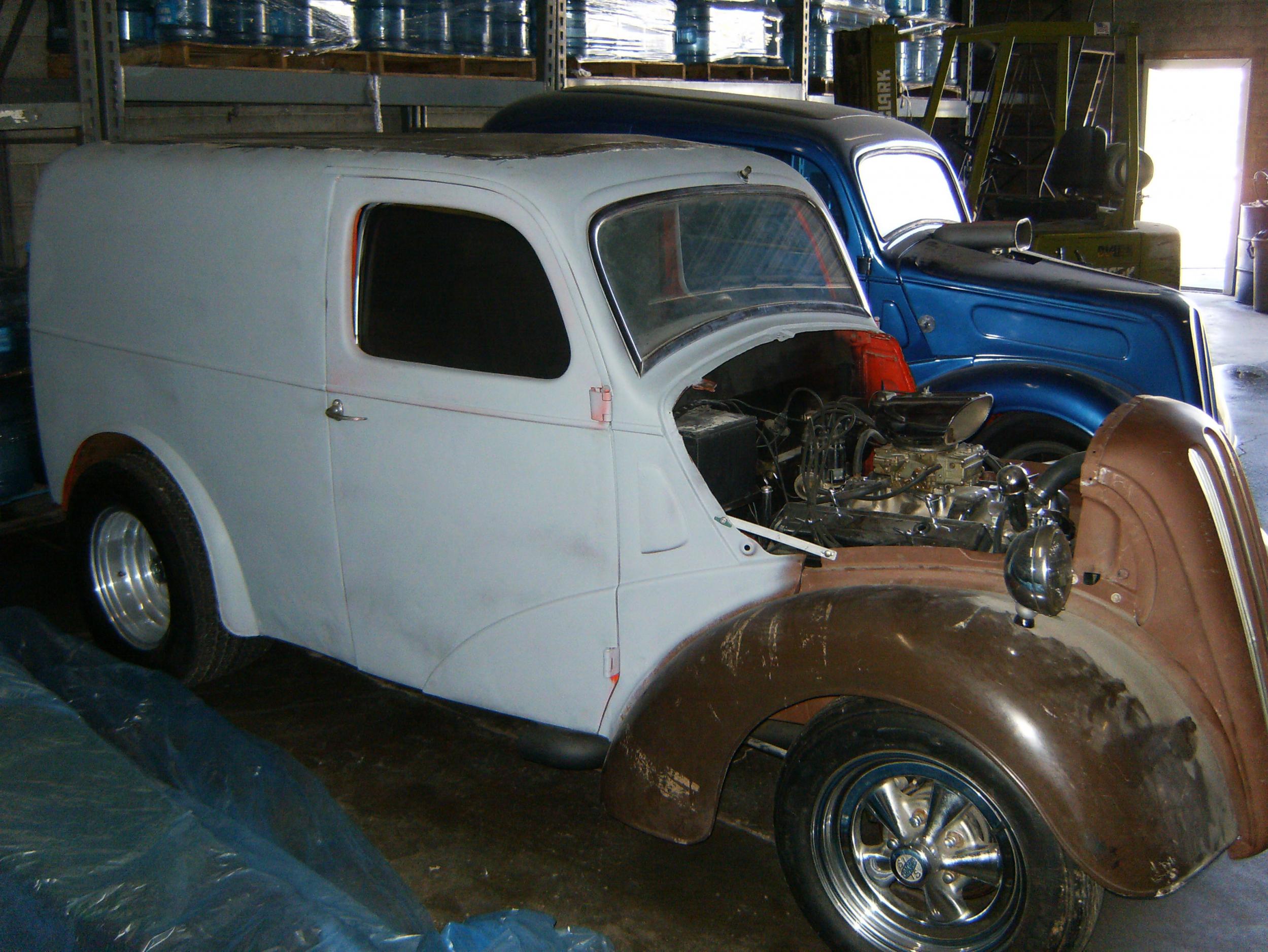

    Just sharing some pics of the next project. 48 Thames. I was told it ran at US 30 but I cant find any old pics with Thames. There are a few colors here and there left behind from old paint jobs but, looks like it was red and might have been yellow at one time??? Cool ch***is with chrome drop straight axle and 4 wheel disc brakes. Love the Anglia's

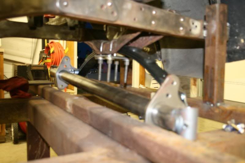

    Pretty amazing how fast a project can come to a halt when finances are gone. Not to mention personal issues have pulled me off this project for almost 2 months now. But....back on it last night. Yay!
    Didn't get a whole lot done, but the main hoop for the cage is welded in and the back bars are bent and tacked in position. Threw the gl*** pieced together for the front end and mocked it up, as well as my front axle just to see ho the front tire position is going to turn out.
    Here are some pics:
    Next week we are going to try and get the halo and a-pillar bars bent and mounted. Also my rocker panels, rear valence, and other items I ordered months ago are finally on thier way. Small steps, but steps in progress....

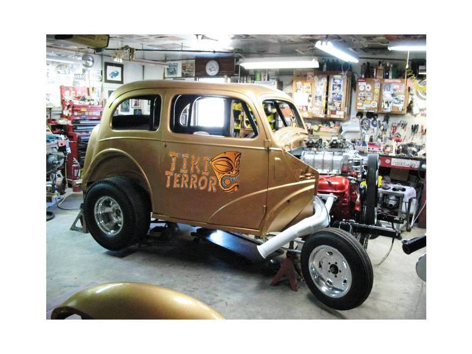

  27. Just thought I would throw mine in for some inspiration if needed to keep the motivation up.
      524 KB
      343

    "angie" wheels up at the "g***a guys" event in maine
