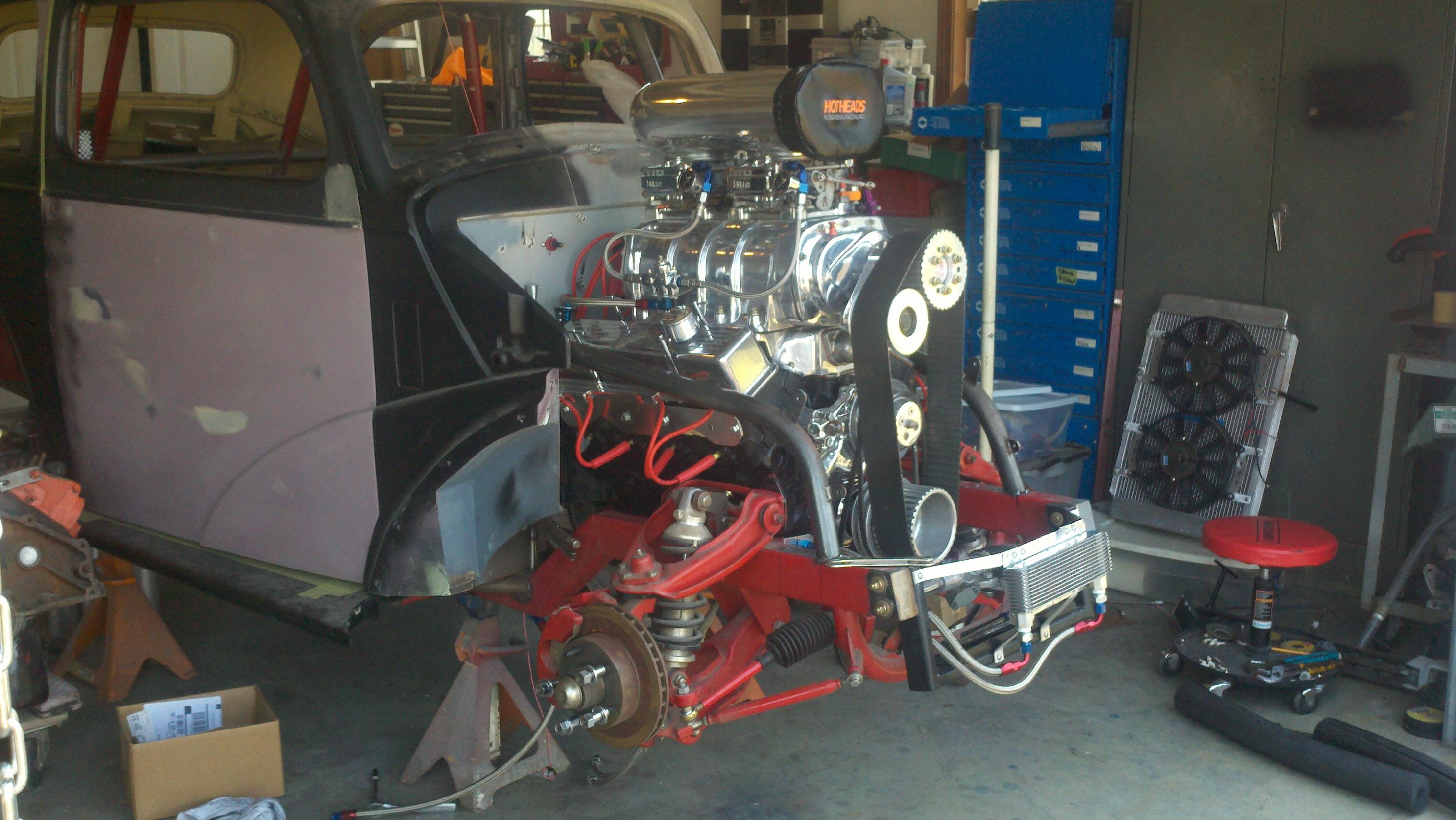

    Remember me? Probably not. LOL Been busy with health and other issues for months and finally getting back on this SLOWWWWW project.
    Well.....bought some parts, but nothing super exciting to take pics of. Got some Morel solid roller lifters and some roller rockers on the way. Also bought front rotors, bearings, calipers and pads for the front end.
    Got a Griffin radiator for Christmas. Looks good, but I am wondering on if it is going to keep this thing cool.
    Patched some holes in the cowl....more exciting bliss...

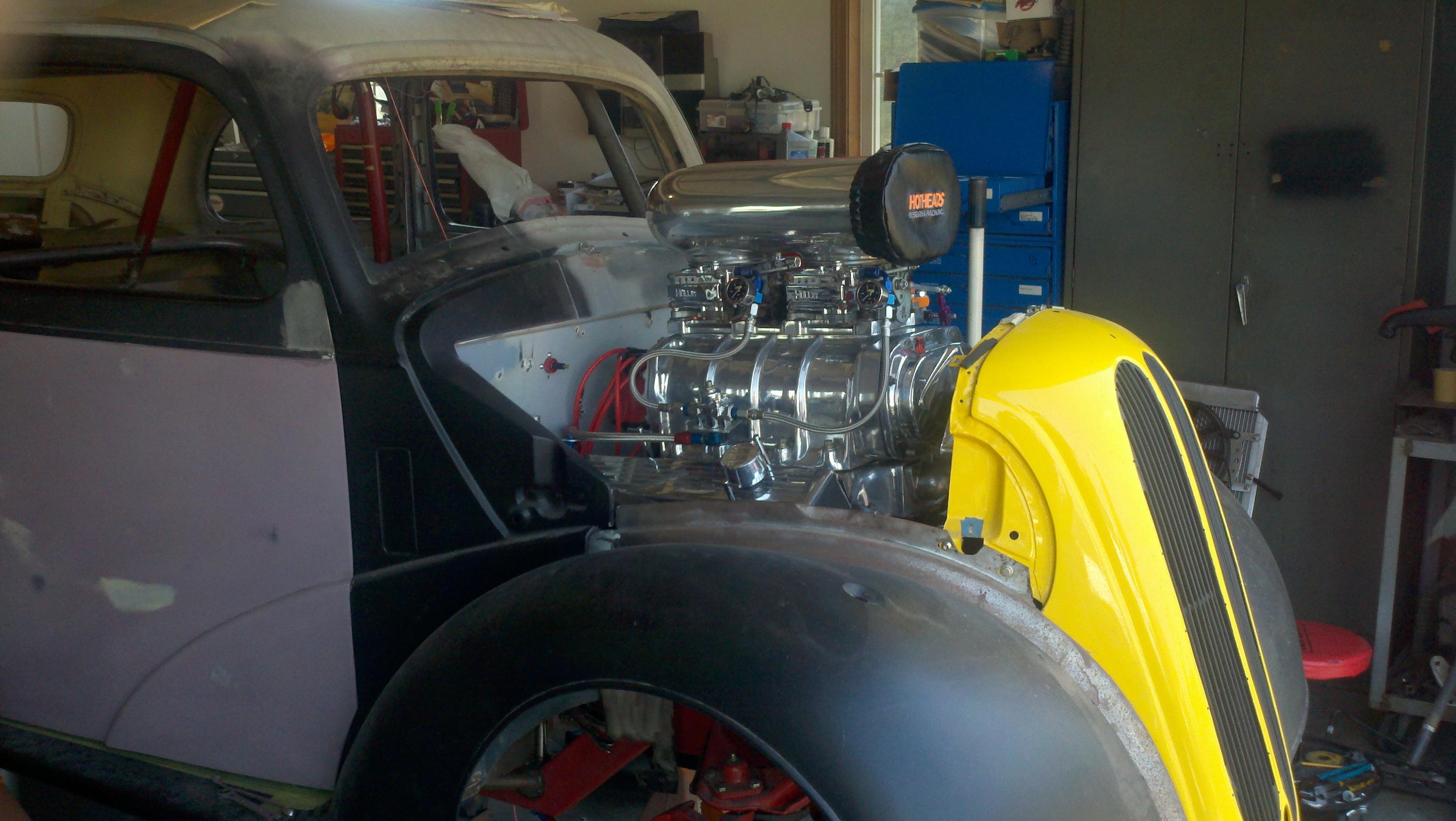

    Also made some motor mounts:
    Gave up on the deck lid and got a gl*** one from Unlimited:
    Hope to have some better pics and details this weekend.
    DC
