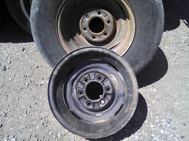

    A couple of weeks ago my friend and I nearly bought it. We were traveling on Highway 50 east of Dayton, NV at 60-65 mph. I had to pee so I pulled a couple of hundred yards down a dirt road. When I got out and shut the door the left front wheel fell off. If it had come off at 60 we might not be here. Saved by an enlarged prostate. :confused:
    All six lug nuts were loose inside the hubcap. This happened before almost twenty years ago, same pickup same kind of wheel on the left front. Then the studs all broke. I wrote if off to metal fatigue. I was wrong. The problem is using the wrong wheel.
    The '51to ? Chevy pickups use the same brake drums up to '70 on the six lug GMs. (4x4) My '70 Blazer uses the same drums as my '53 3100. The front drums attach to the hub with 3 rivets. You can see them in the photo as three shiny spots between the wheel studs. They stick up about 1/8". Or they did. :rolleyes:
    The proper wheel has indents between the studs so the rivets don't touch the wheel. You can see the indents in the bottom wheel and the three spots where the rivets contacted the one above. That is the one that did not come off. You can also see that the ring with the holes is deformed from the uneven seating.
    This it the one that came off. I think this style of wheel showed up around '72 when the 4x4 GMs got front disc brakes but I'm not sure. One thing I am sure of is that they are all leaving here. Third time is a charm. :)
    I don't know how people got away with the flat white or chrome spokes that were popular several years ago. I just wanted to share this incase someone else was running these things. I'm still putting it all back together with all new studs. I found a leaky wheel cylinder and a questionable brake line. Putting on a new set of leaf springs with all new hardware. The day this happened all three of my drivers broke down. I'm afraid one won't make it back. Maintenance, maintenance, maintenance o_O

    Good knowledge! I'd grind the damn rivet's an Carry-on

    we've been grinding the rivet heads off for decades....I guess you didn't get the memo.
    Maybe you'll help someone with this post....thanks!

    My brother put a pair of slicks mounted on aluminum slots on his 57 Pontiac and didn't realize the 2, 5/16ths bolts were contacting the wheel like your rivets. He kept snapping off 1/2" wheel studs "till I told him about those pesky bolts...really not needed. Grind or chizel 'em off.

    You could also just drill holes in the wheels where the rivets are hitting. I usually just grind the rivets.

  12. The same can happen when the lug nuts dont quite fit the wheel.
    This almost happened twice to my sister in the late 1970s when using Dodge Cragars on her 63 Lark she overhauled herself, then took on a cross-country trip.
    NO WOBBLE, JUST A MILD GROAN ROAD NOISE EASY TO IGNORE AS ROUGH ROAD RAIN GROOVES.
    The nuts felt bottomed out tight, but the wheels were only lightly "clamped" because the curve on the nut didn't match the curved indent in the chrome 5-slot Cragars. The nuts only lightly clamped the wheels just as the nuts bottomed out against the studs.
    Everything felt tight, but during a long cross country trip, a very light hum or groan developed. Almost like a tired tire hum, or rain grooves.
    She caught it in time before the studs were chewed all the way thru, but you could tell they had been chewing for a while.
    This was cured by using fatter lug nuts than stock on the chewed studs and slightly chewed out Cragars until she got back where we could put in new studs.

    I've been driving this pickup in one form or another since 1975. It has had several different wheel sets on it from 16" truck split rims and big aluminum **** to "artillery" wheels and stockers. The first ones that did this was in 2000 when my boys were driving it to school. Luckily they were just pulling out of a parking lot when the wheel came off. Like I said earlier I thought it was caused by metal fatigue because that time the studs broke. This time the nuts came loose. The right wheel was too loose as well. I got this set of wheels from a friend a couple of years ago with a new set of tires on them and just put them on. It all looked good. No wobble no noticeable noise except a small clunk in a dire parking lot in Stagecoach about 10 miles before the event. I had a broken leaf on a spring and thought that was the noise. I live on 2 miles of pretty rough dirt road so I hear lots of noises but right up to the involuntary dismount, nothing on the highway. It is a wonder it didn't fold up when I made the right turn onto the dirt road.
    Leon Bee, The lonely part of 50 starts on the other side of Fallon. This is a 4 lane section and busy.
    36roadster, I don't think so. Pickups before '51 had a different style brake and the drums for those mounted to the back of the hub. The wheel mounting surface in flat and the drum tapers away from the wheel. On '51 and up pickups the drums are flat and mount on the front of the hub with the three dastardly rivets. . I think the cars before '49 were the same as the early style trucks with no rivets. In '49 cars went to 5 lugs and I don't know anything about them. The newest Chevy car I have owned was a '48 Fleetline.

    Chevy changed from Huck brakes to Delco-Morrain brakes on pickups and cars in 1951, but they had rivets before that.

  15. Had a similar issue with 8 lug
    The mopar 8 lug wheels didn’t like the GM 8 lug hubs
    Hub pilot vs stud pilot
    Corrected before an accident

    Wheel spacers have been known to cause this too. My daughter was lucky, she was running wheel spacers on a OT Corvette with wire wheels. She was just about to accelerate up onto a freeway when she felt a vibration. She pulled over just in time, doing about 5-10 mph her rear wheel came off and the Vette just sat down upon the tire.

    I grind off the rivets. That opens up wheel choices.

    Here is a '49 pickup drum/hub. I think the '48 and earlier were the same. 180507_0001.jpg 180507_0002.jpg

    apparently there was more than one design...

    Must be. I took the whole axle from the truck myself. I was happy because they fit my 19" wire spokes for my roadster. I think they fit. I'll have to give it a closer look now.
