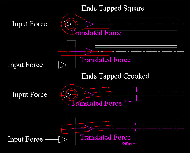

    Yeah, I think Dick was confused about which pieces I was talking about being misaligned.
    You are right, that a heim or a tie rod end will "find center" and align the force with the long axis of the tube, provided that the end of the tube was tapped square to begin with.
    It's like this:
    That offset causes a bending moment in the tube, whether it is loaded in tension or compression (though the effect is most easily seen in compression).
    I do not believe that the changing arm angles will have any effect on a self centering joint like a heim or tie rod end.
