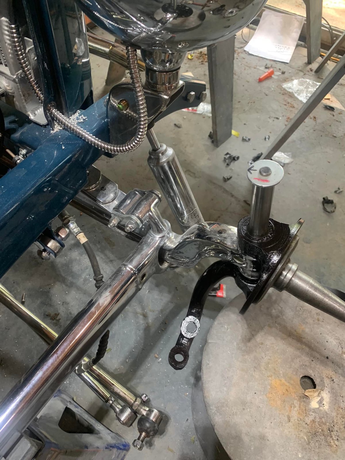

    I am new to hot rodding in general and Model A's specifically. I have a 29 roadster with a V8 that I bought from a fellow who started building it but ill health and age forced a sale. When I received the car the ch***is and frame were already complete and the engine in place. I have been working on it this winter completing the body, putting seats in, that sort of thing. I recently took it out for a test drive and when I got up to about 35MPH the car really wandered all over the road. A friend suggested I check the caster and I found that it was at 0 degrees. I made a pie cut on the split wishbones trying to get it to 6 or 7 degrees but I overdid it and ended up with 9 degrees. Now when I drive it, I get a violent wobble at about 15 to 20 MPH. it has a Vega steering box with cross steer and no panhard. I did try a dead spring perch but that did nothing at all and I have removed it. All suggestions are welcome. Thanks

    Photo's will help others be more helpful. "Dead Perch'But I removed it" WTH?,,,,= Yup,ya have no idea,so start reading up,and put up some pics,,,Most Death is just screw ups by builders,too much play n wrong setting,,but canbe bad tire , an, or balance> PIC PIC PIC's

    Pictures, pictures pictures.
    It's the how it's put together that is important. Of course nothing can beat actually being there, but pictures can reveal a lot.

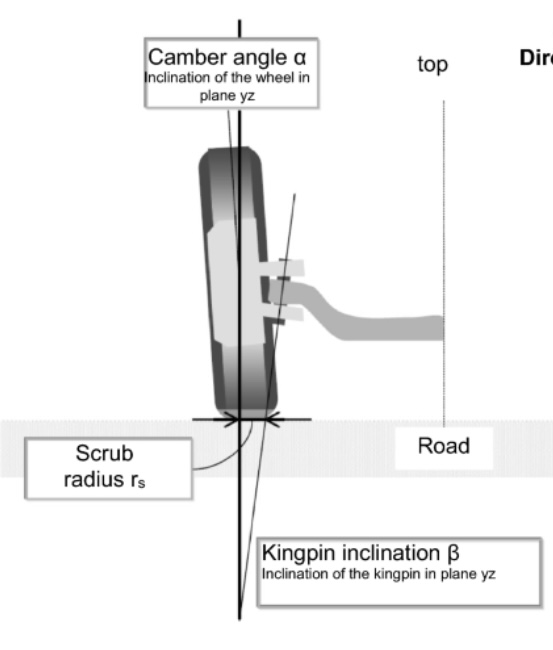

    I'm going to go out on a limb here and guess that the scrub radius is way off. Usually is in these type of threads.

    What is scrub radius?
