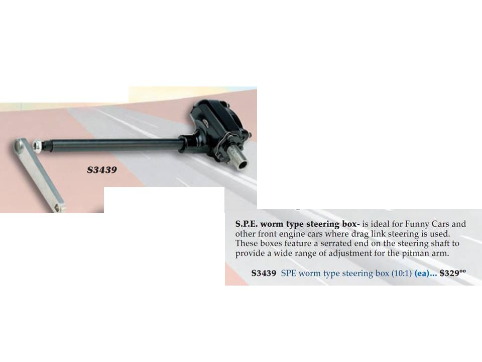

    Some have asked what type of steering box is it.
    SPE worm type - Strange Engineering sells them.
      35.1 KB
      204

    OMG........how many times do u have to be told that the steering box, shaft and bearing are TOTALLY inadequate?
    Read the Strange Eng website again.......Thos steering boxes are made for dragsters, you know, those cars with spindle mount front wheels cos there's no weight over the front wheels......they don't hit bumps, and don't supposed to steer.
    Replace yours or park it and polish the billet!

    That SPE box is made for a dragster. And as said earlier is entirely insufficient for a car. This may or may not actually be the cause of your trouble, but does need to be change.

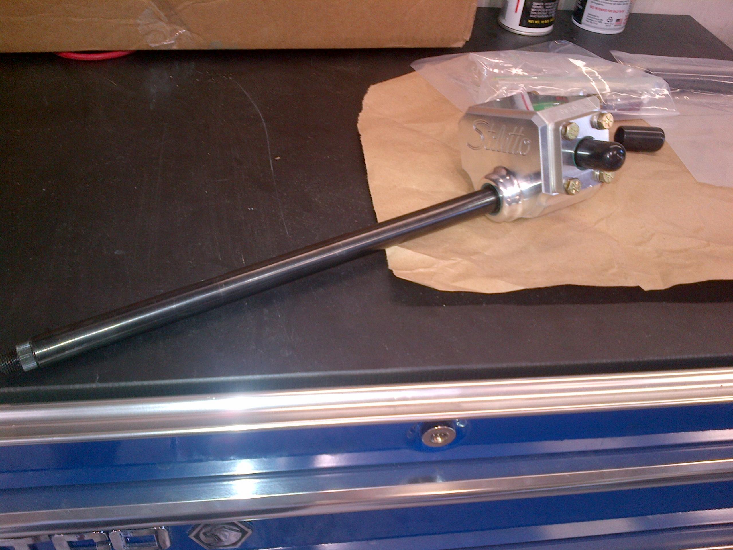

    Panhard bar has been fabed and installed.
    Steering box came in finally. The box mount will be more solid.
    Testing to follow.

    So tell me the difference between the SPE box you had & the new Stilleto box.
    Aren't they the same, light duty dragster type box, not designed for street driven cars ?
    Open them up, I'll bet they look the same inside.

    I never felt the SPE box was an inappropriate design for my application. It just wasn't mounted solid enough for street use. Once we took the box off, we found some play and worn spot on the worm gear.

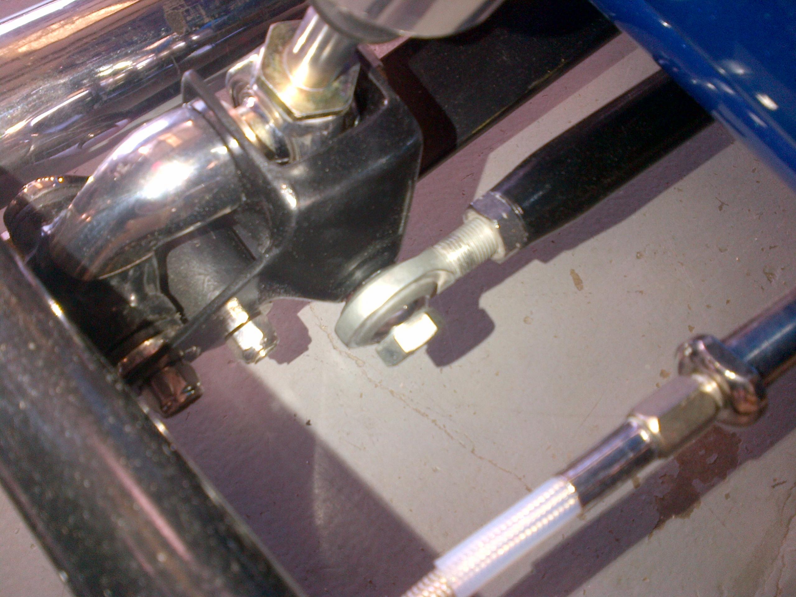

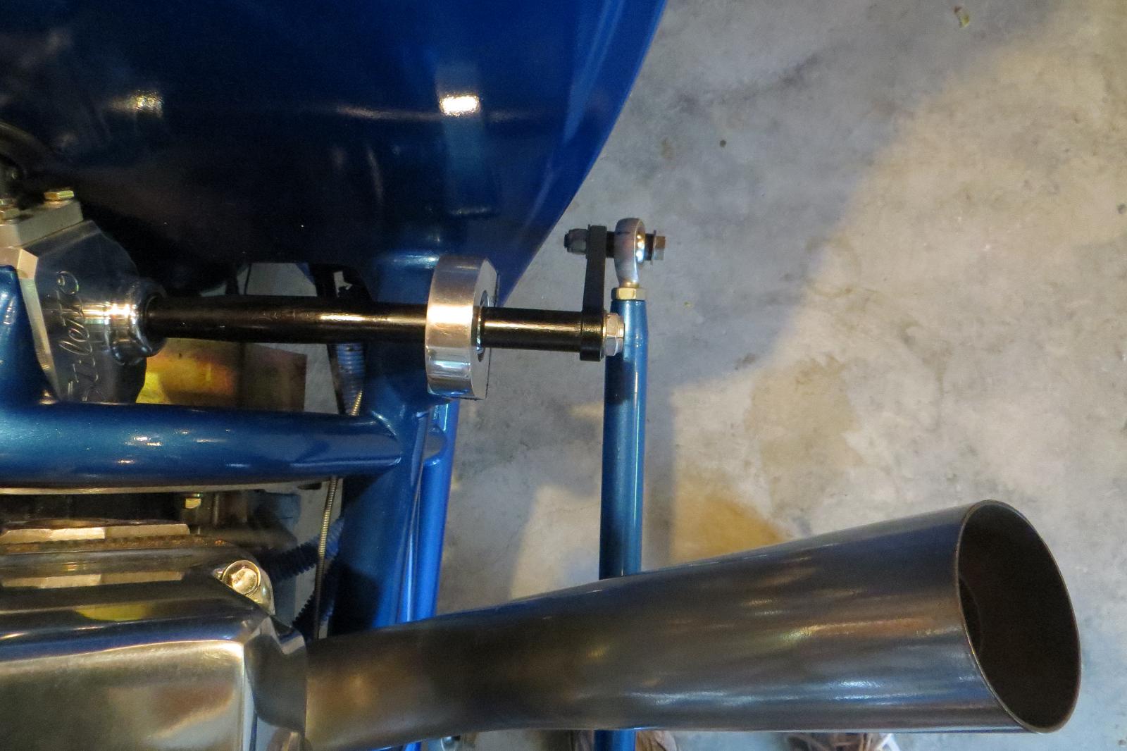

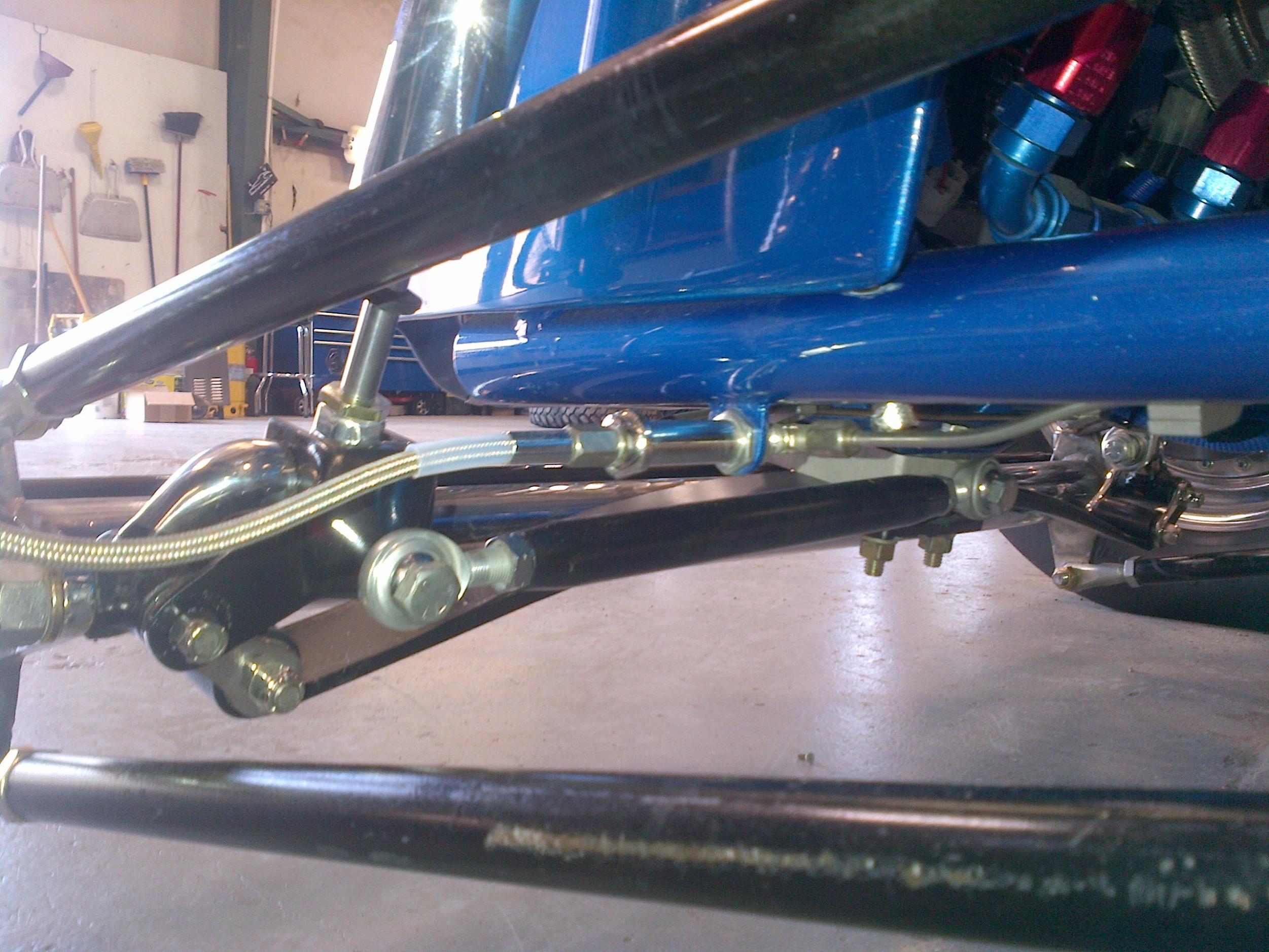

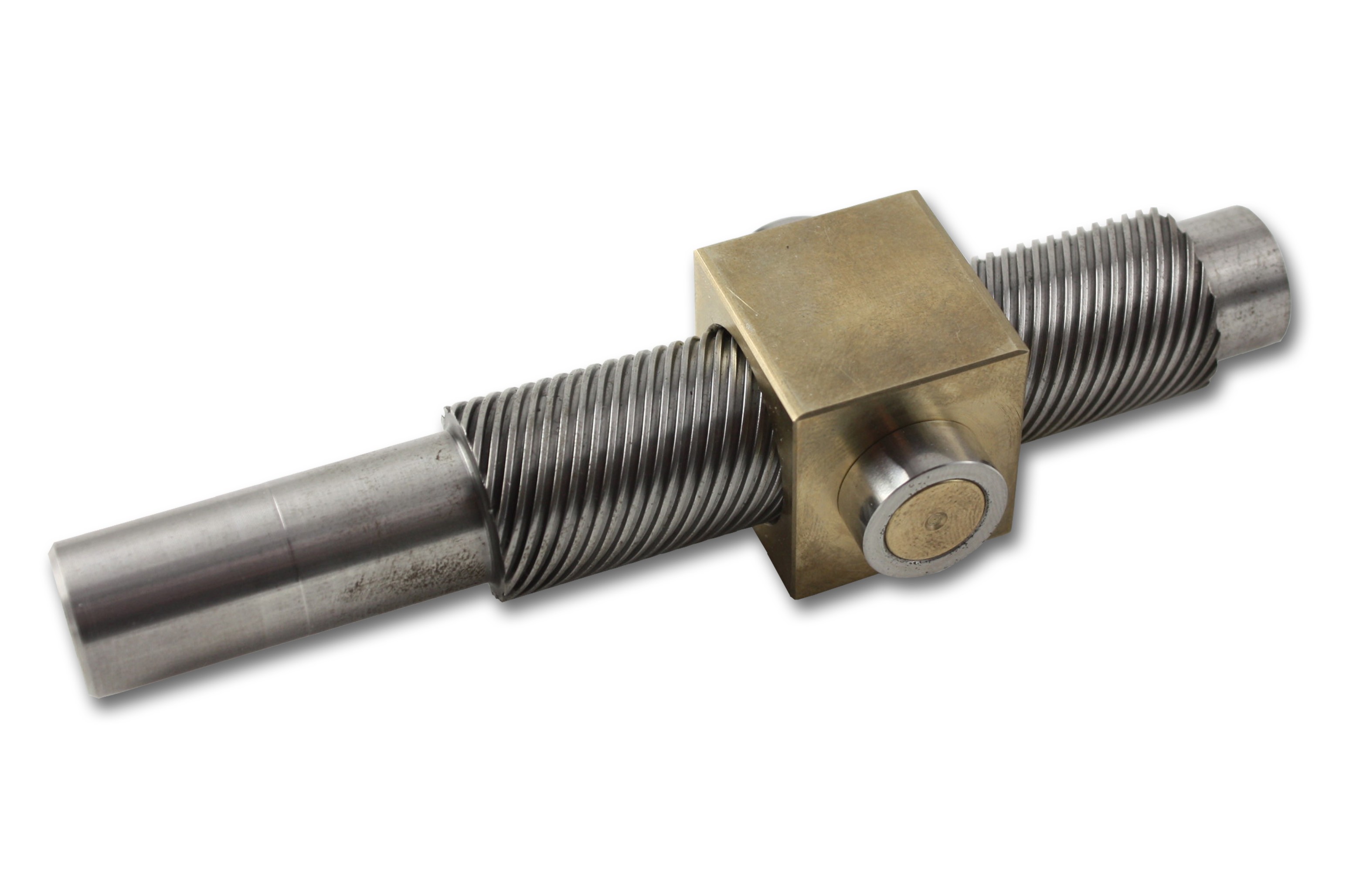

    * New steering box installed. Good solid mount. The gears in the box are much finer than what I had. Stronger internal design too.
    * Shorter pitman arm shaft. (Had to be shortened - Stiletto couldn't make a custom size timely)
    * Larger / stronger support bearing for the pitman arm shaft. Stiletto advised against using more than one - too hard to get it all on one plane.
    * New steering column with br*** bushings. New solid steering shaft with added universal joint. That universal joint also makes it where the system doesn't need to be perfectly square.
    * toe out is now + 1/16" Once the rain stops, we'll see how that works.
    (previous posts included heavier drag link & tie rod; install panhard bar)
    Besides playing with the alignment this should have it. (it was close with just the panhard bar added)

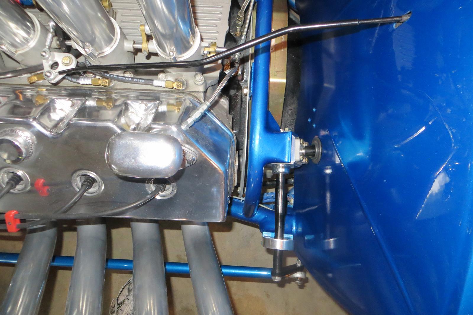

    First three pictures below are with wheels turned right all the way. The new set up will give me a tighter turn radius.
