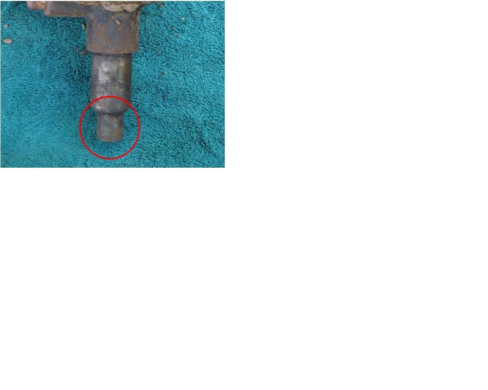

  4. The Mallory came in last night- it has a good bit of flash rust inside and out and needs to be torn down... in order to get the dist shaft out, do I need to tap out the pin in the circled area? I just don't want to ruin it!

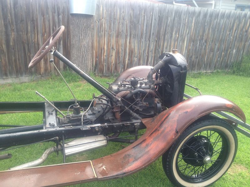

    G'day Stovebolt. That early A rolling chassis you picked up on ebay was a great buy alright. I was watching that one myself. It's great that it still has it's shock absorbers and even its radiator shroud. It must be a pretty early one.
    Great stuff, anyway. I have just registered a LHD RPU that I built up on a chassis that came from under a coupe. I'll be really interested to see how yours go with the jeep transmission in it. -Ed

  7. Remove the pin and it should come apart. Ken

    Tap the pin out with a small punch. then the shaft will pull out through the top. Keep track of any thin washers between the shaft coupling and the body--they take up any endplay.
