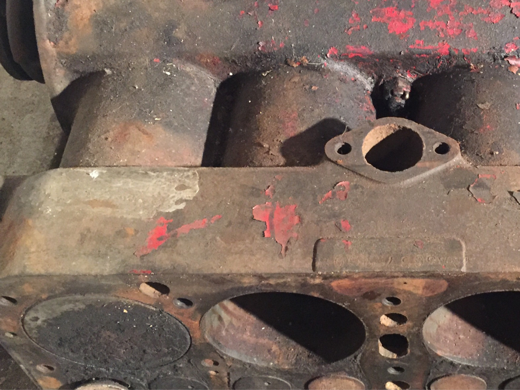

    Well, I sprung for that short block I posted about last month. Went and got it today and I think for $160 I did pretty good. Only concern is this "patch" type thing at the top of the block by the head. You can see it here all the way to the left, kind of looks like body filler (but it's metal.) I'll probably have that addressed when the block goes in for machine work, just to be on the safe side of things...

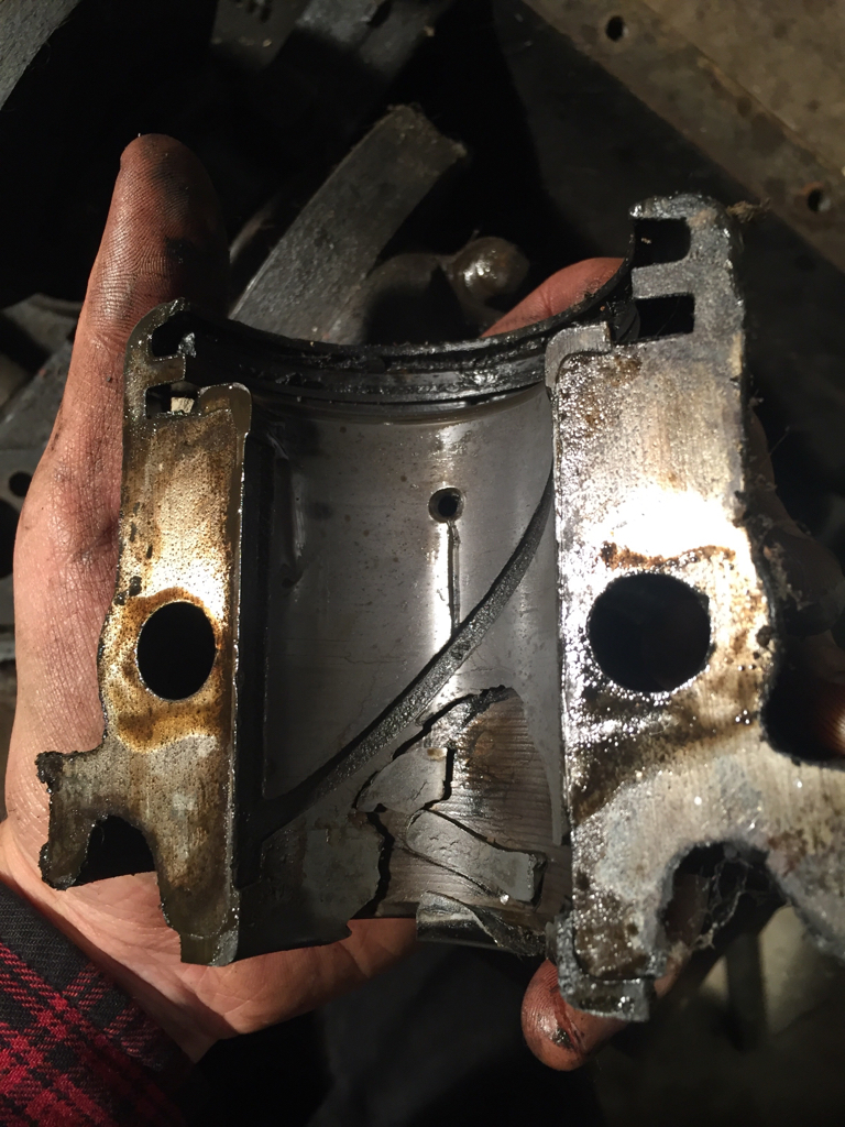

    And it didn't take long to find out why it had been taken out of service! ImageUploadedByH.A.M.B.1450060679.532765.jpg

    the plate near the head is the motor # plate . mine is registered to that # . take care of it !
    junk Babbitt is the norm on old motors .

  9. If you have it hot tanked you will see it better if the hot tank doesn't dissolve it. Looks like it could possibly be an old crack repair. Commonly repaired with JB weld or similar material. Maybe just a paint smear

    Yep, that's the plan. Now that you mention it t could be JB weld. I thought it was lead or something similar. If that's the case, how are these sorts of things best fixed? Brazing?

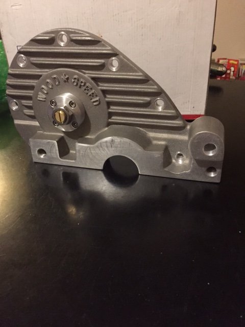

    This just arrived in the mail. Thanks to rockman29 (Jim) for the cover, and to BCCHOPIT for the heads-up on these.
  12. ^^^^ That's neat!

  14. Brazing is probably the most popular if done right. There are a lot of JB weld repairs that seem to work. You should shop for a welder that is familiar with this type of work.

    Thanks. I'm fortunate enough to have a fantastic engine and machine shop 40 minutes from me, I'd like to have it repaired with metal. While I have it stripped down I might as well go nuts with it.

    How do I get one of these for my project?!

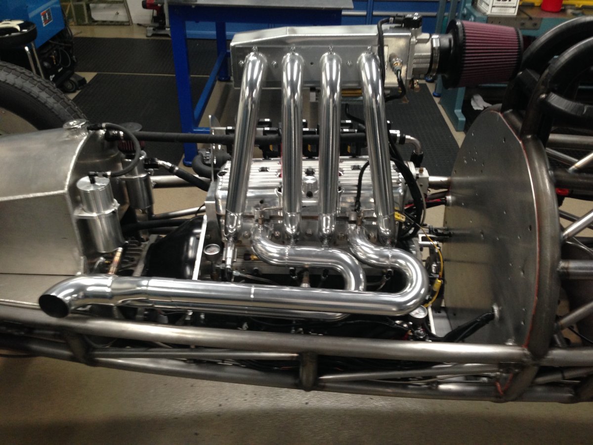

    Thought you might enjoy seeing the Bonneville engine, one year in the making, and two years waiting to prove itsellf on the salt........................................................................

    Thanks guys for the plugs! I have two more timing covers available from this run. You can PM me or send an e-mail at woodiesvintagespeed@yahoo.com if you are interested. If there is enough interest I will make another run this winter.
