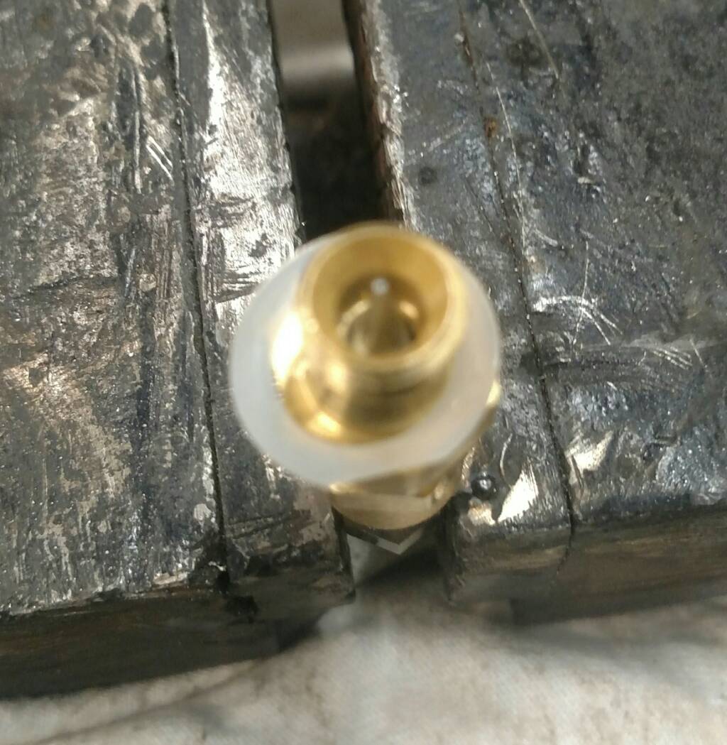

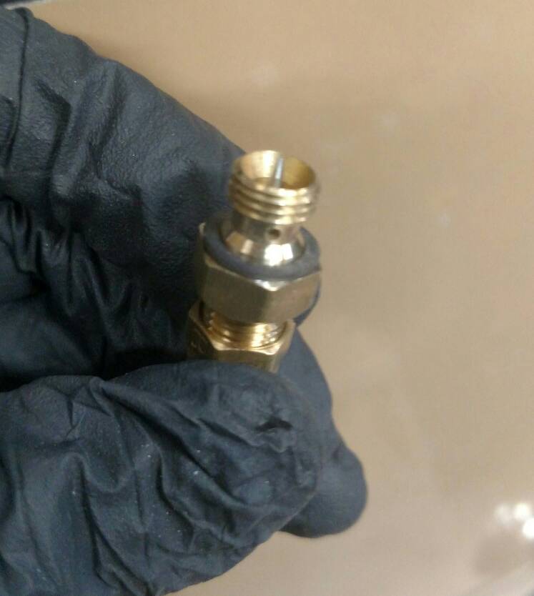

    You know how it is... working thru new ***embly items on the Vicky. Used Charlie Prices adjustable main jets on the 97's.
    I don't know why he supplies a nylon washer that doesn't fit, thus doesn't seal. Drips fuel like crazy. Wrong material in my mind for the application. IMG_20181225_102208.jpg The part he provides is made so it has a shoulder on the sealing area and won't accept the fiber washer off the stock plug.
    Turned down the shoulder and used the washer off the plug. IMG_20181225_103602.jpg Problem solved.

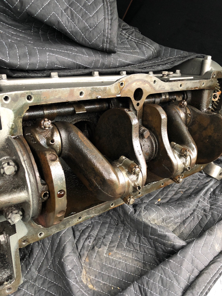

    Been working on the banger for my AA doodlebug. It's an old .045 over rebuild I got out of a parts 31 AA I bought. It looks like it should run ok. Its hooked to two 4 speeds and an early top drive truck rearend. 20181216_141603.jpeg 20181209_204343.jpeg 20180923_214023.jpeg
