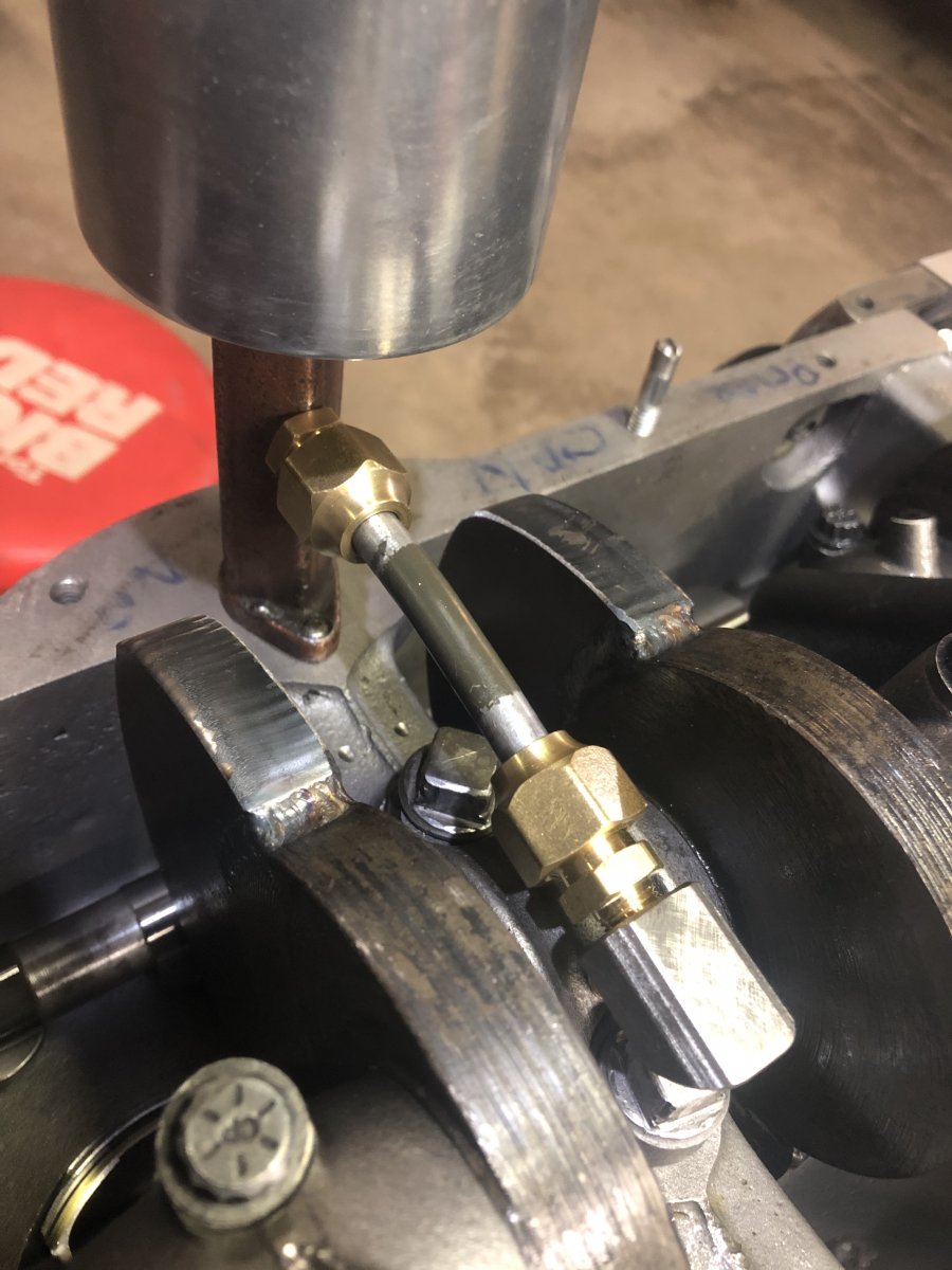

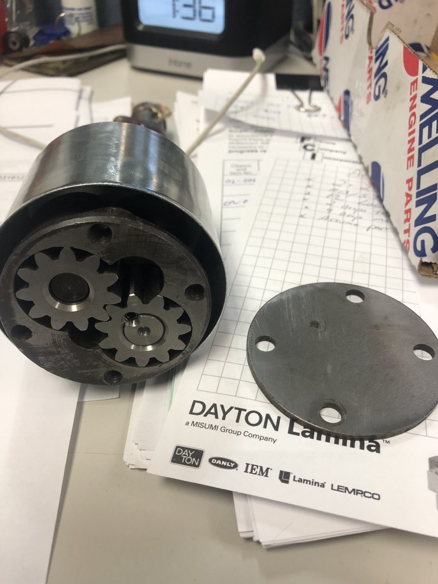

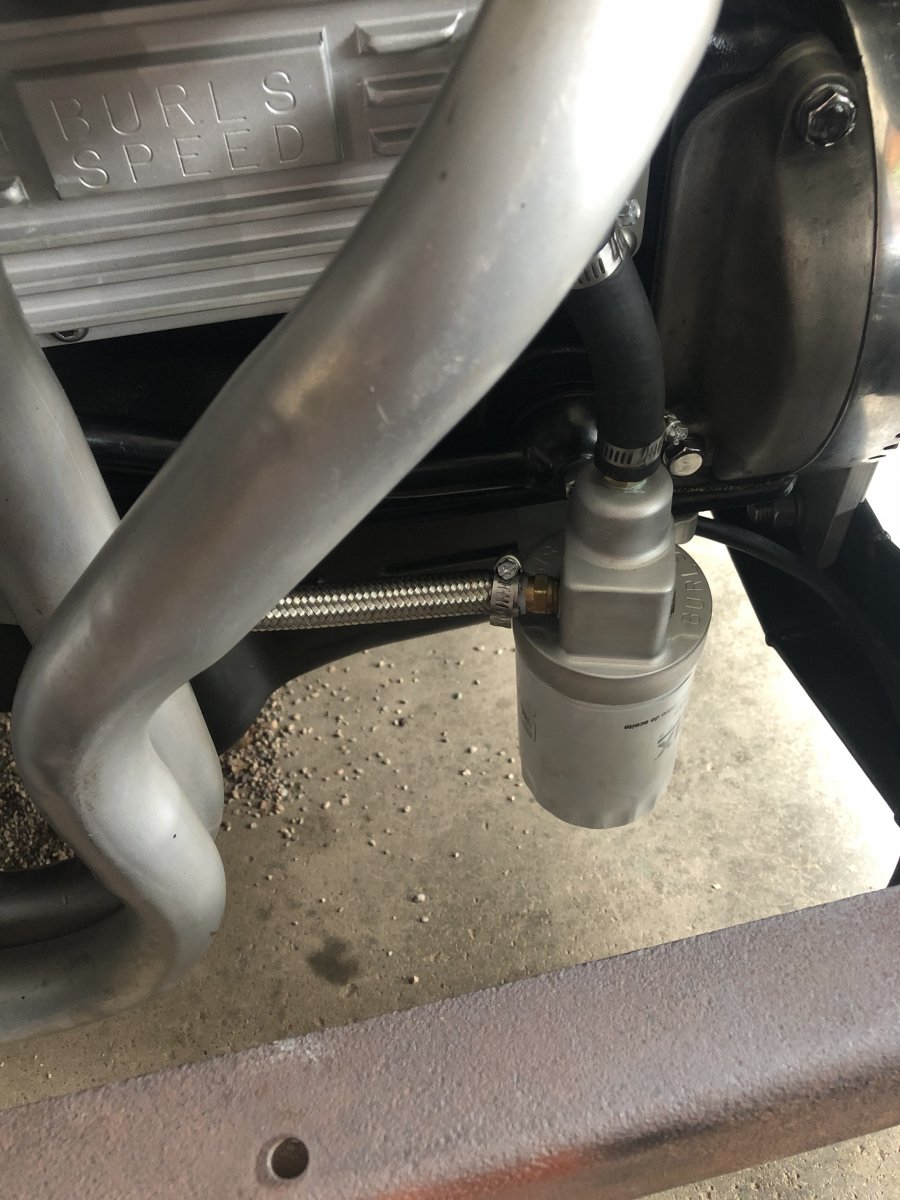

    When i was ***embling my motor for my 28 i did a lot research on oil pumps.There wasnt a lot of good factual information.I ended up modifying my stock pump.
    By tightening the clearance between the gears and bottom plate it really helped.It also modified to direct the oil through a filter and then into the upper area.I looked at the stipe pumps but couldnt bring myself to spend close $400 on it.The modified pump puts out around 30 psi cold and then maintains between 10 to 15 psi hot which should be more than enough for a warmed up A engine. oil pump.jpg oil to main.jpg oil filter.jpg

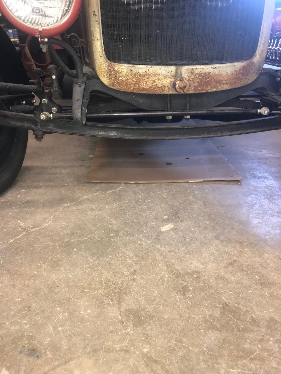

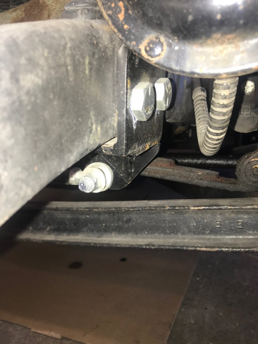

    Below are photos of a bar I put on banger. The ch***is is lowered by reverse eye springs and leaf removal, so the bar only fit in front of the axle. Drivers side of bar is mounted to ch***is, p***enger side of bar is mounted to spring perch. This modification did make a positve change in handling. Hope this helps. IMG_4994.jpg IMG_4996.jpg IMG_4998.jpg IMG_4999.jpg
    No PhredH, the p***enger side is not mounted to the spring perch, it's mounted to the shackle. Any time the spring height changes it will push or pull the axle sideways, relative to the ch***is. If this was a cross steering car bump steer would likely be severe. in your case, with your drag link running lengthwise to the frame it may not create bump steer.
  28. You could do with another bolt in that shock absorber link PhredH!

    It just dawned on me that your setup would probably work for cross steer cars by simply putting the shackle bolt in the lower hole and the panhard rod in the upper hole. that would change the motion of the axle end of the panhard bar from horizontal to vertical and it would no longer push or pull the axle side to side. Or, at least the side to side movement would likely be negligible.
    Nice job on the construction.
