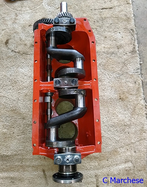

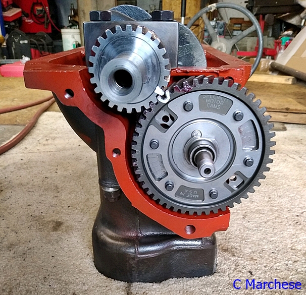

    Just in time for Christmas, my engine came back from midway across the country. Conversion of the A crank into the T block is done. Still much more to do, but this was a big step.

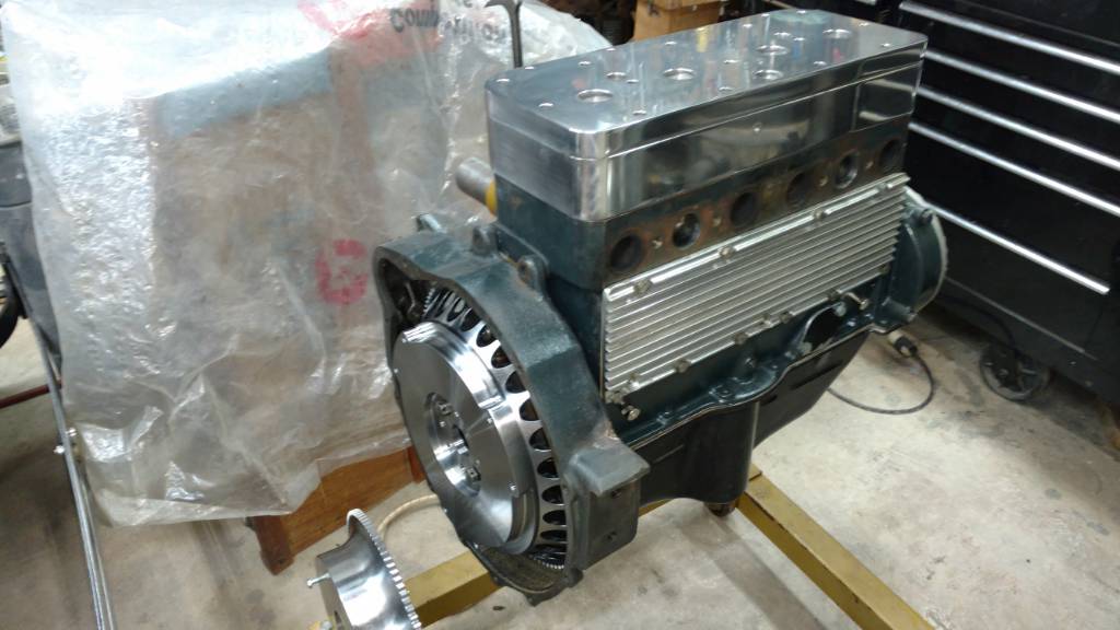

    Stipe adjustable cam gear and reproduction "Roof" .310" cam (out of production)

    That's awfully nice looking...

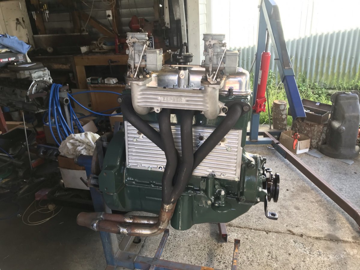

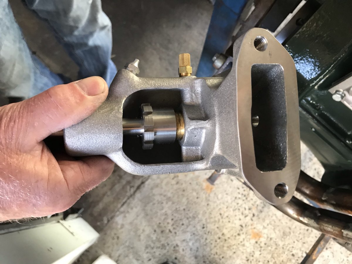

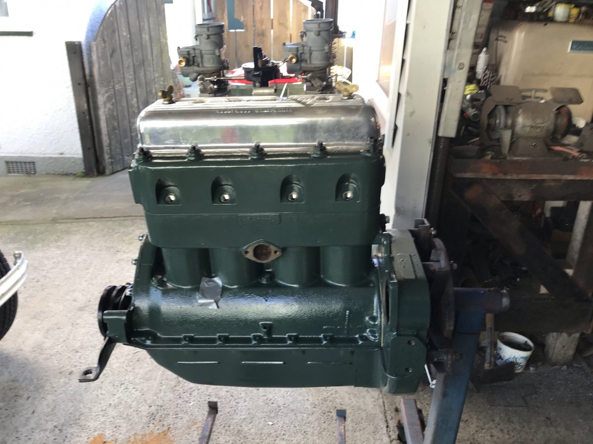

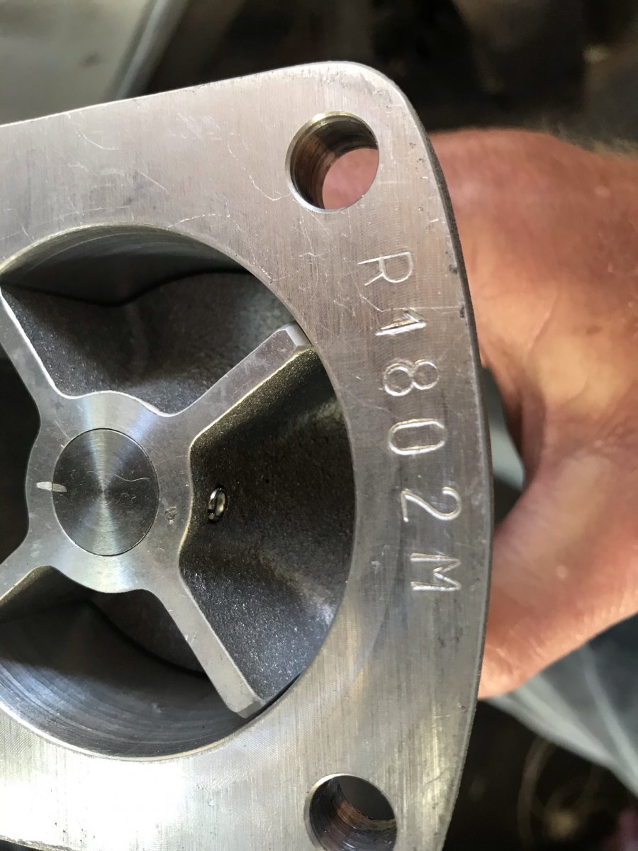

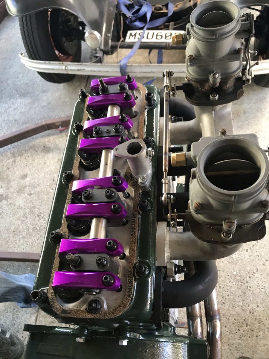

    Ok , we are making progress,finally. The real question is what sort of lube does this water pump require and how often . The present pump is a B pump on a B and has a modern pump with the screw down grease filled cap, so easy to do . This critter looks like it may need a dedicated grease gun ???? Bit of a PIA if its so>
    I know you cant see it in the pics but for some odd reason the distributor drive shaft was maybe 5/8” too long ( yes we did take some off the head to raise theC/R but not that much, so rather than modify what we presume is a hardened shaft we put a 5/8 spacer under the dizzy. Oh yes its Steve Serr miller head and attachments. Hopefully we can more than double the original HP and still have bags of torque . BA2E3FD4-94A9-4495-A9DA-1D360DAF2E3F.jpeg A7430069-9FF0-43FA-916D-F4912D431658.jpeg 49F3A6FA-A458-4F03-9C4D-A57DA35E8B0E.jpeg 790F0119-E45D-41E1-B497-4B06400CCA1D.jpeg 5C43506C-7614-4185-A90C-B893358843B3.jpeg

  11. The setup looks really good, you will not be disappointed with the power developed.
    Nice Christmas present.
    As for the water pump, you can email Steve to see what lube is preferred.
    I will make one observation, please be careful with using the "B" upper housing as the attachment point to the stand. I have had these fail in the past and you do not want that motor laying on the floor.

    You ott'a be able to haul *** in one trip with that set up.
    I remember that I've had to 'trim to fit' the dizzy drive shaft. Better to do with one that is to long.
    Yes, check with Steve as if the pump has a modern seal (pack less) the zerk with the cap might be just for looks. No lube other than at ***embly necessary.
    I like Chevron SRI in the front as it is a polyurea based grease and is 'stickier' than the lithium based greases and stays in the bearing better at higher RPM (above 3000) in my experience.

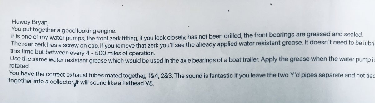

    got a very speedy reply from Steve Serr , top guy. I had to admit to I couldn’t remember it it was his pump .

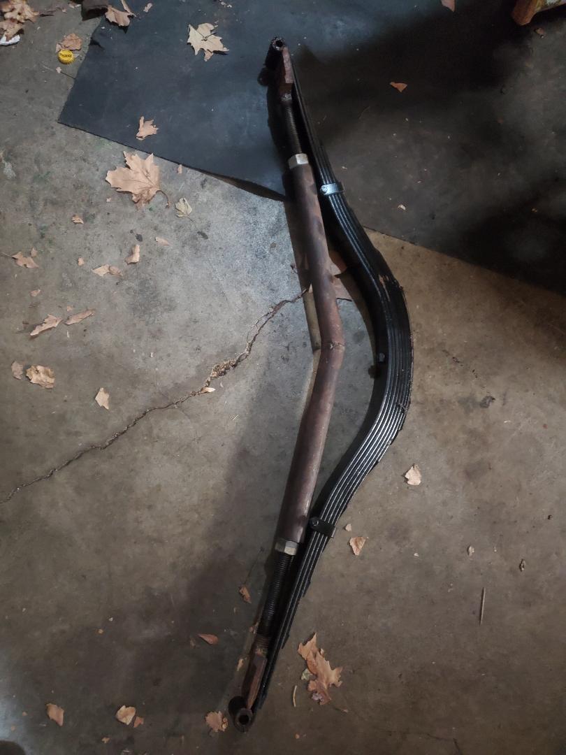

    00ui.jpg ****ed Henry's crossbow tonight..

    Nice , looks a little clunky to use unless you can fit a ratchet type ring wrench in there , of course then once its on you cant turn it around. What stops the bar bending ,or it just doesn’t? Yeah i know original ford spreaders are hard to find. So you have done a nice job of improvising .

    Schedule 80 tubing,1" grade 8 all thread,single s***ch triple p*** 7018.. never tried to find an original.

    leakless water pump . no lube except ..... antifreeze + or water wetter , internal lube

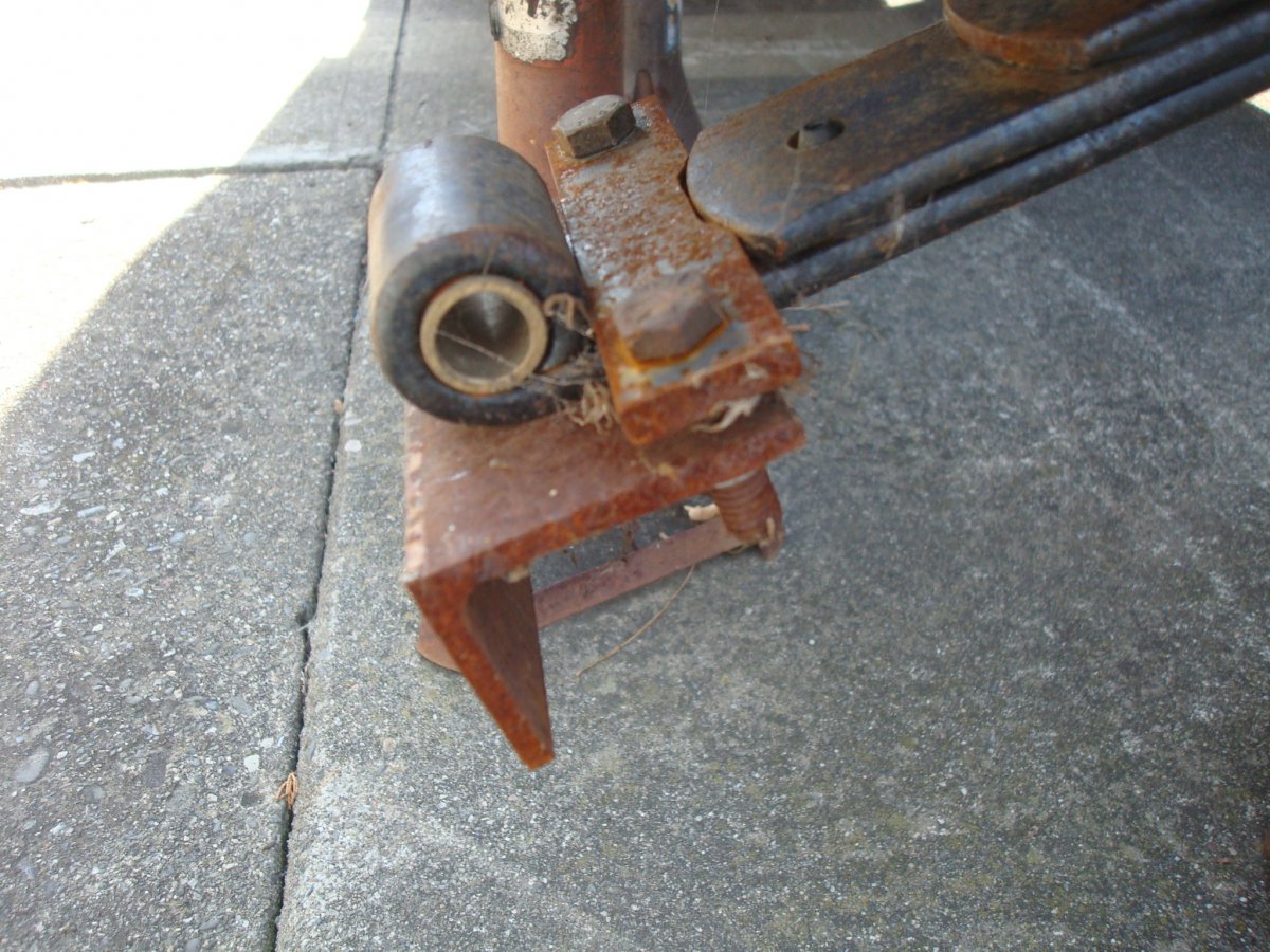

    Great Idea!

    How do you get the axle in place with clamp on?
    I just dis***emble the spring and re***emble

    John, This is a speedway Model T low profile spring, I'm trying to use with a Model A axle. The 1 1/2 angle iron clamps were low enough for the spring perches on the Model A axle. I'm going to have to dissemble my spring too, it wouldn't spread enough with the spring bolted to the frame.

    Looking Good! Been Watching your progress great Job! The Motor Rocks..

    I'm going to design a clip that slides on the main leaf and works by being bound under load of the spreader..clearance is an issue,offsetting the spreader from under the spring? Going to fool around some...maybe dual spreaders we'll see.

    Be very careful! I have a chipped tooth and a scar on my chin from this very dangerous operation! We have a Nor-Cal FAST spreader available for all paid up members in good standing- Guess that lets you out!!!! Much safer to take the spring apart and just do the main leaf. HAVE FUN!

    Hey my member is in good standing...all done with the widow maker for now,dropped her down some and put on some bigger meats..and fenders!!!
