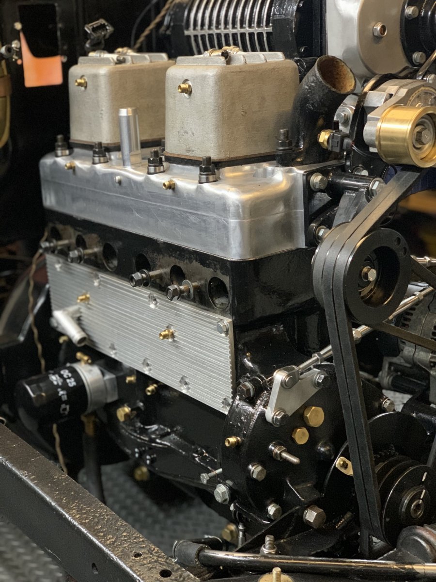

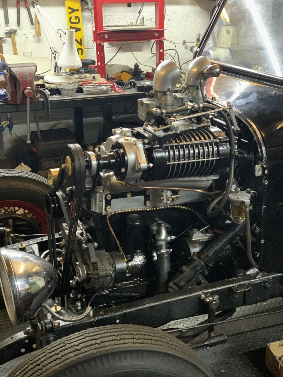

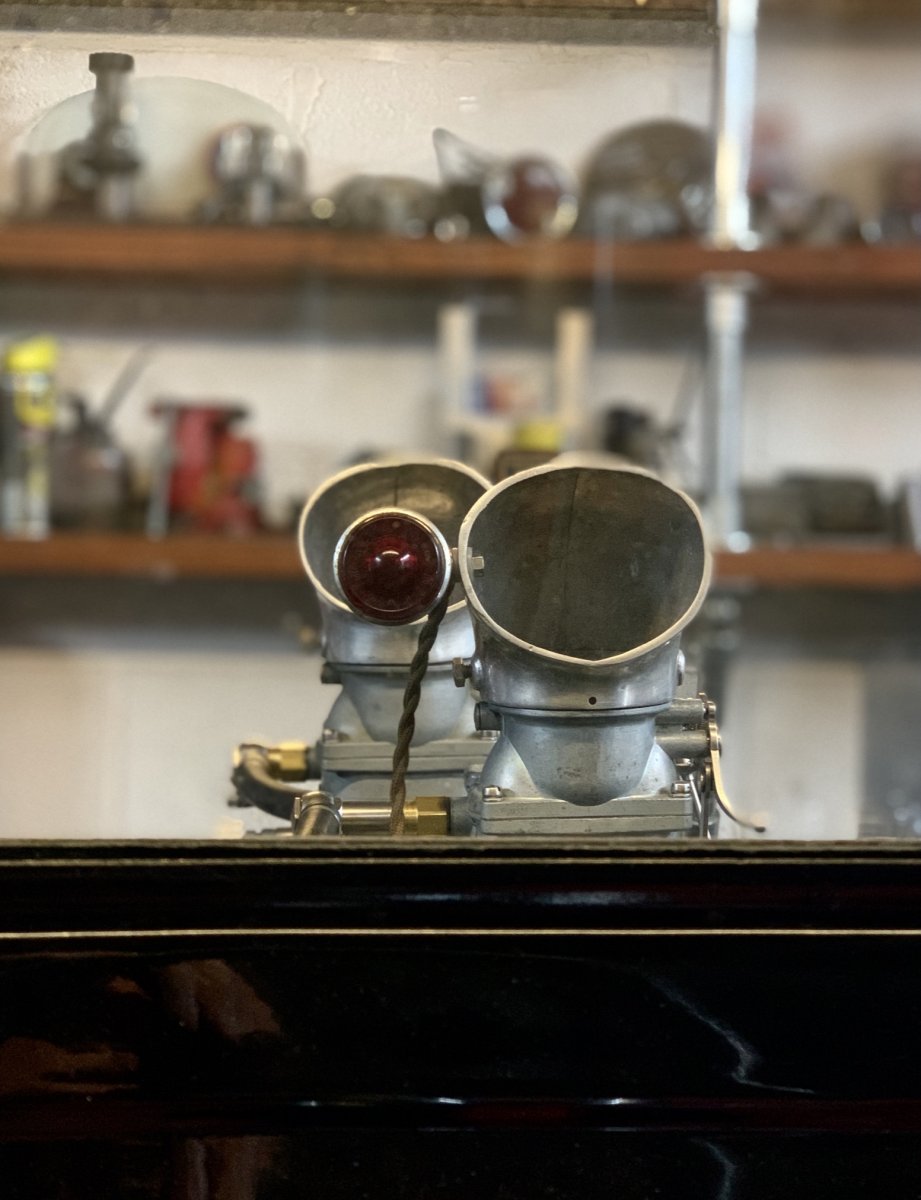

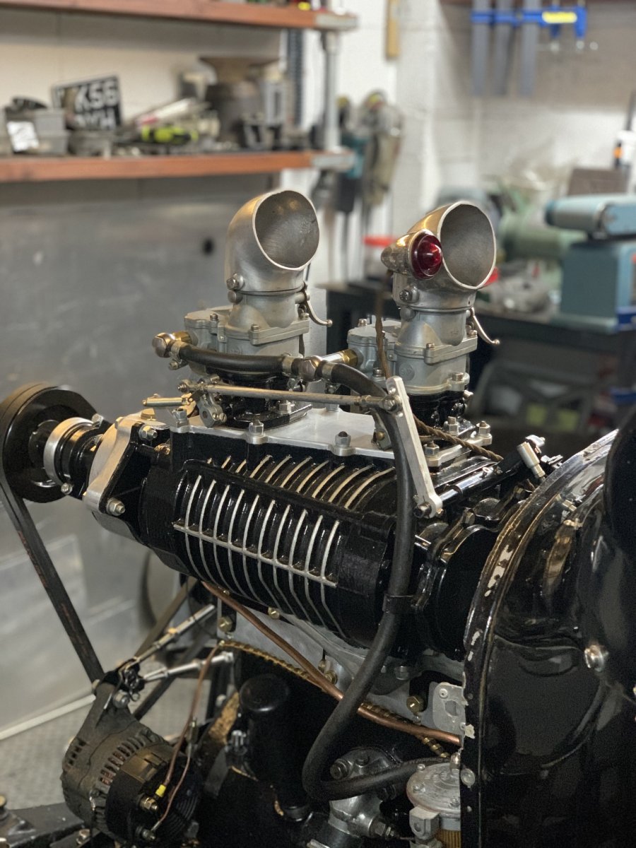

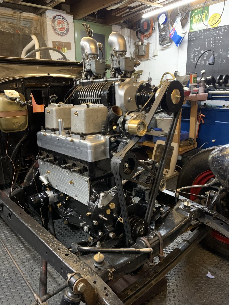

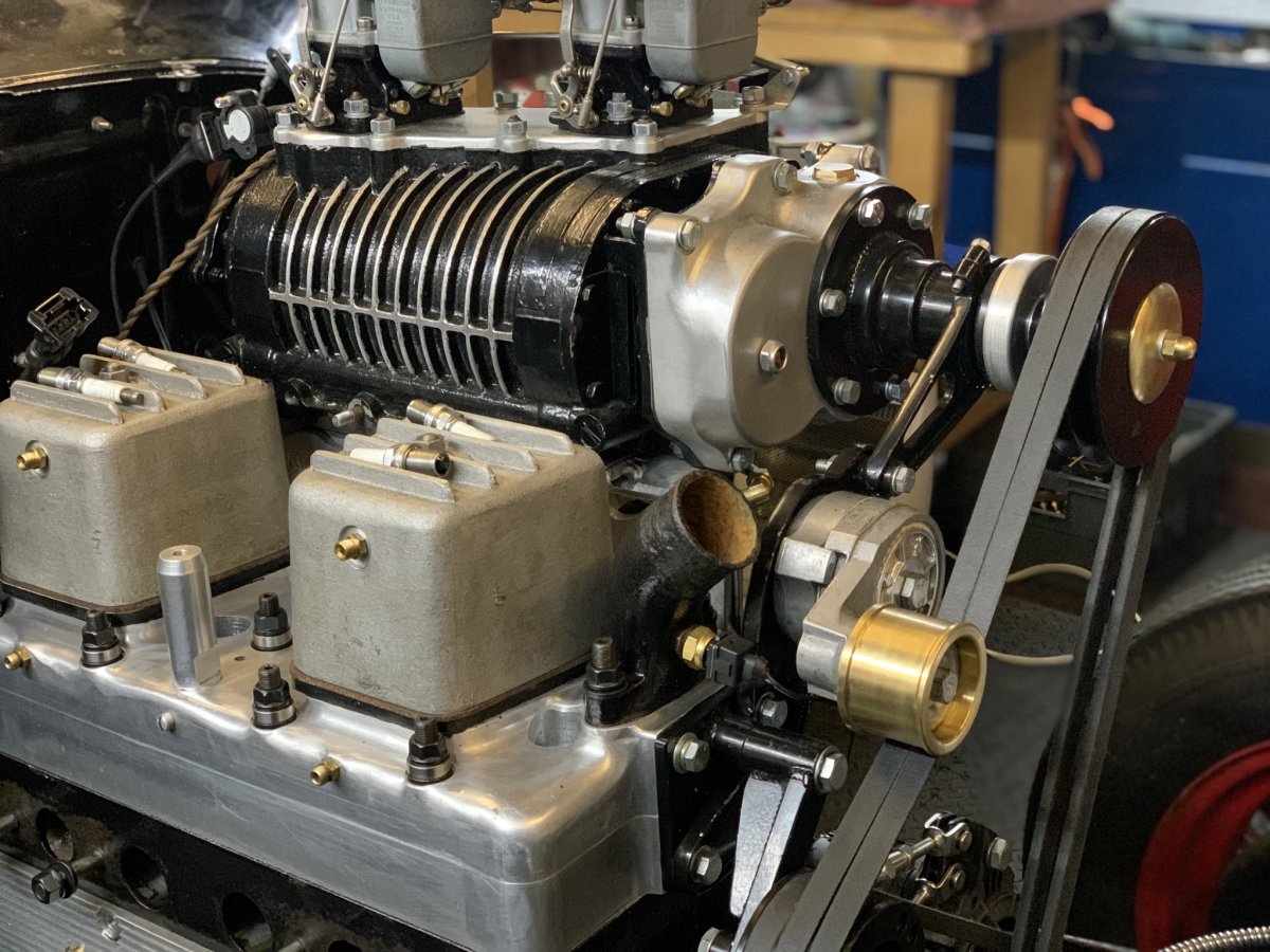

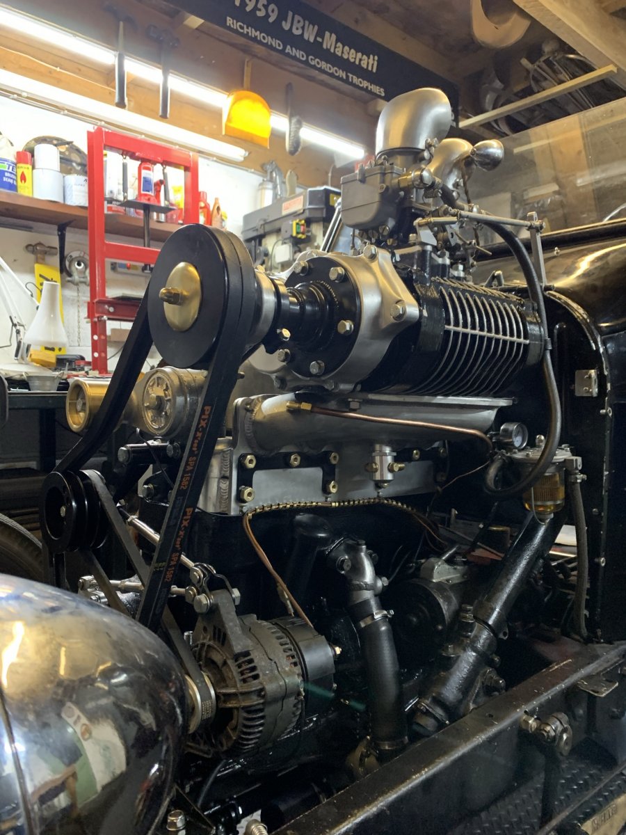

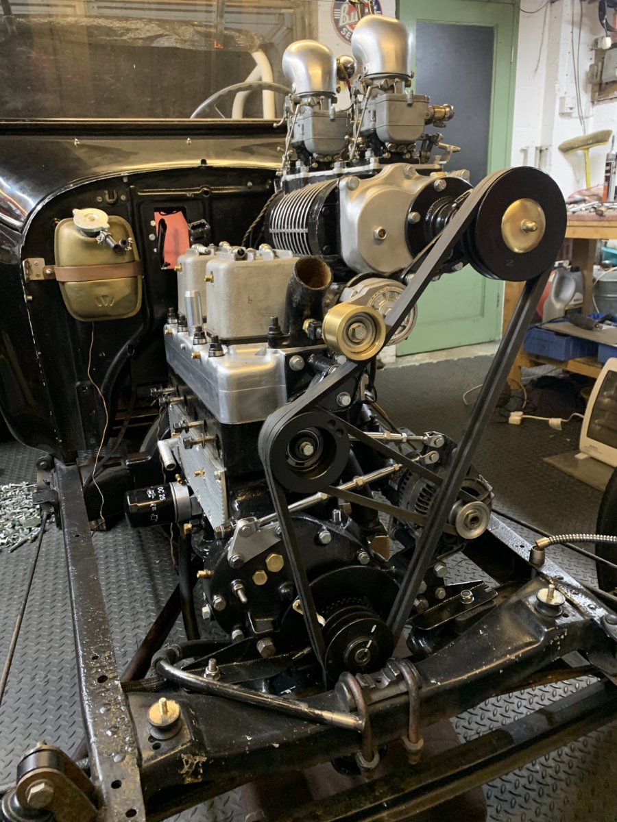

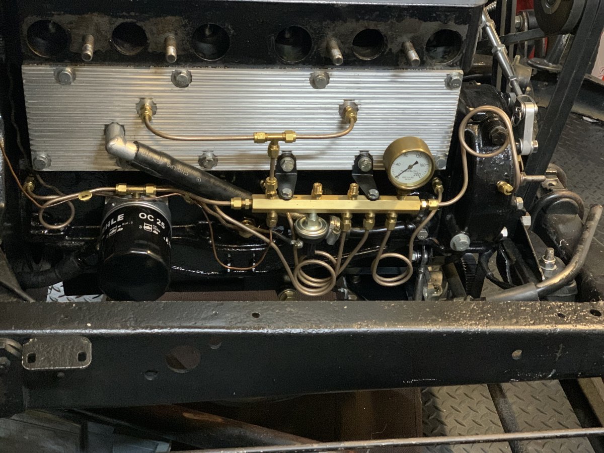

    Finally getting my motor back together after several issues. Hopefully all issues now resolved.
    CAC15E19-1B78-449B-9040-D0A89BF8D7F0.jpeg 7846F763-1CD2-489C-A89B-791311A80AA5.jpeg 7049B02D-6E8B-4821-AFDC-A60137AEE1A0.jpeg 262EE2F0-230D-49E4-8172-AA918CAF189B.jpeg 69640058-101A-45D6-B28B-324777A47C40.jpeg B7F20C19-BF9F-4843-9AEB-DEECD90F6D5D.jpeg 421ED350-DE7D-4B15-8918-1FC1B88BB36F.jpeg 093CF969-EE52-4B3A-8C12-9D1D4DA7514A.jpeg
    Happy new year to you all.
    Pete.

    Glad to see it coming together (after all the problems) again. Good luck mate!

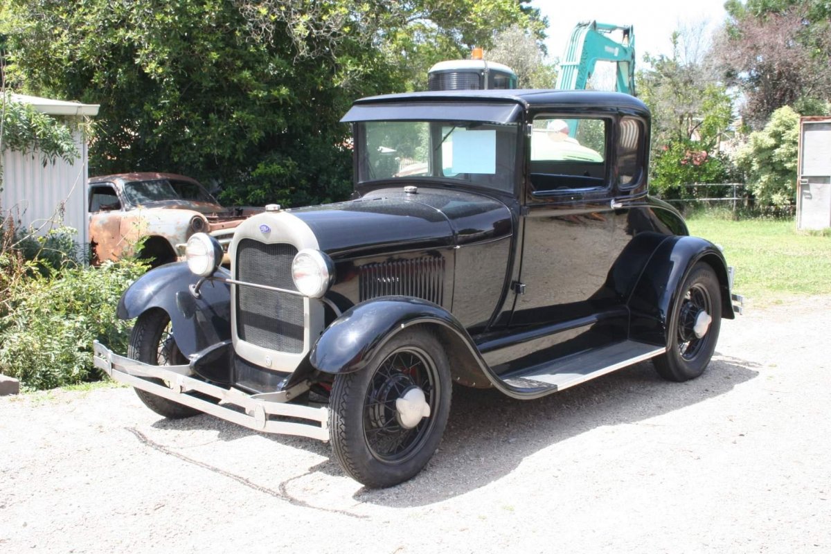

    Here's a picture of my coupe when it was owned by Harold, B motor otherwise stock.
    It has a B diamond block, winfield cam and head, single 97 on a burns intake, 12 volt.
    Car has been lowered using a flattened and reversed eye front spring 33-36 axle, 32 spindles, perch bolts and front brakes. The rear has a T spring. The car runs 18" wires
    I feel humbled to now be the caretaker of this car - the only plans I have for it is to make it a reliable, easy car to drive.

    it’s an oil pressure warning light. When the tonneau cover is fitted I can’t see the dash lights, so added the extra one on the carb.

    Aaaw !
    What was called an idiot light on american production cars !
    Pressure operated. Hooked into oil galley ?
  23. nutrocker
    Joined: Jan 12, 2007
    Posts: 414
    nutrocker
    yup, that’s it. I have an adjustable pressure switch on the external oil rail that feeds the cam bearings, rocker shafts and oil mist jets for the valve chests. I have it set for 30psi. The light comes on if the oil pressure drops below that level. I expect the light to flicker a bit when the oil is hot and at idle, but that’s ok.
