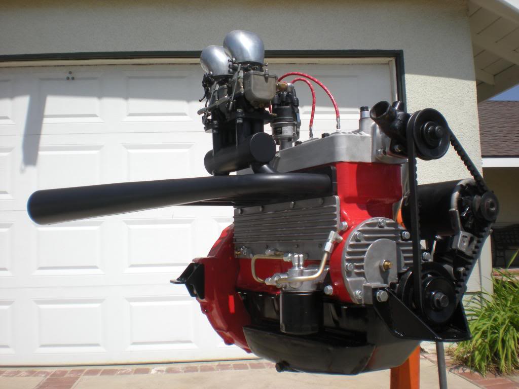

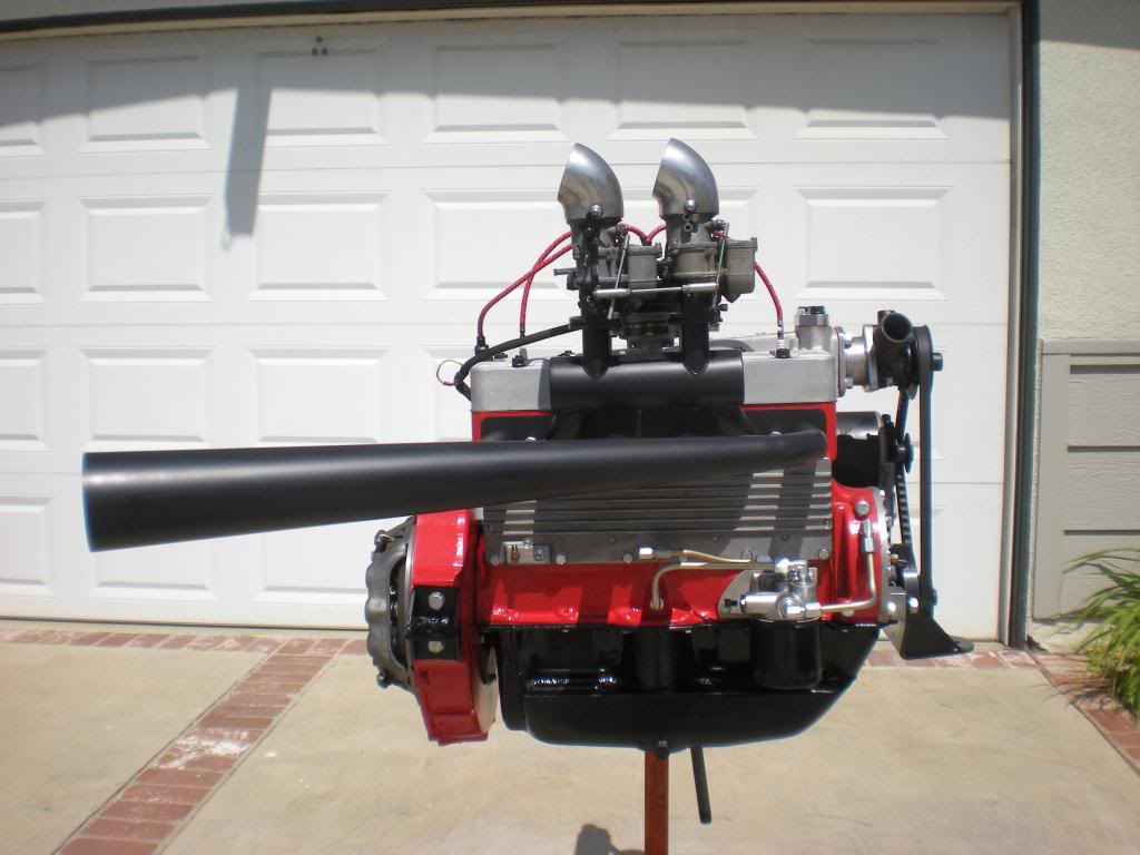

    New motor just about ready to drop in. B block with C crank drilled for full pressure oil, AER rods, EGGE pistons with modern ring package, Brierley cam, Aluminum McEachern timing gears, Stipe oil pump, Murray Horn harmonic balancer, ****ermore 7:1 Winfield crowsfoot head, FSI distributor, lightened flywheel, Mustang pressure plate and Holley 94. Air cleaner is from a 1936 and has been gutted and a K&N filter installed. Just waiting on the new flywheel housing to show up.

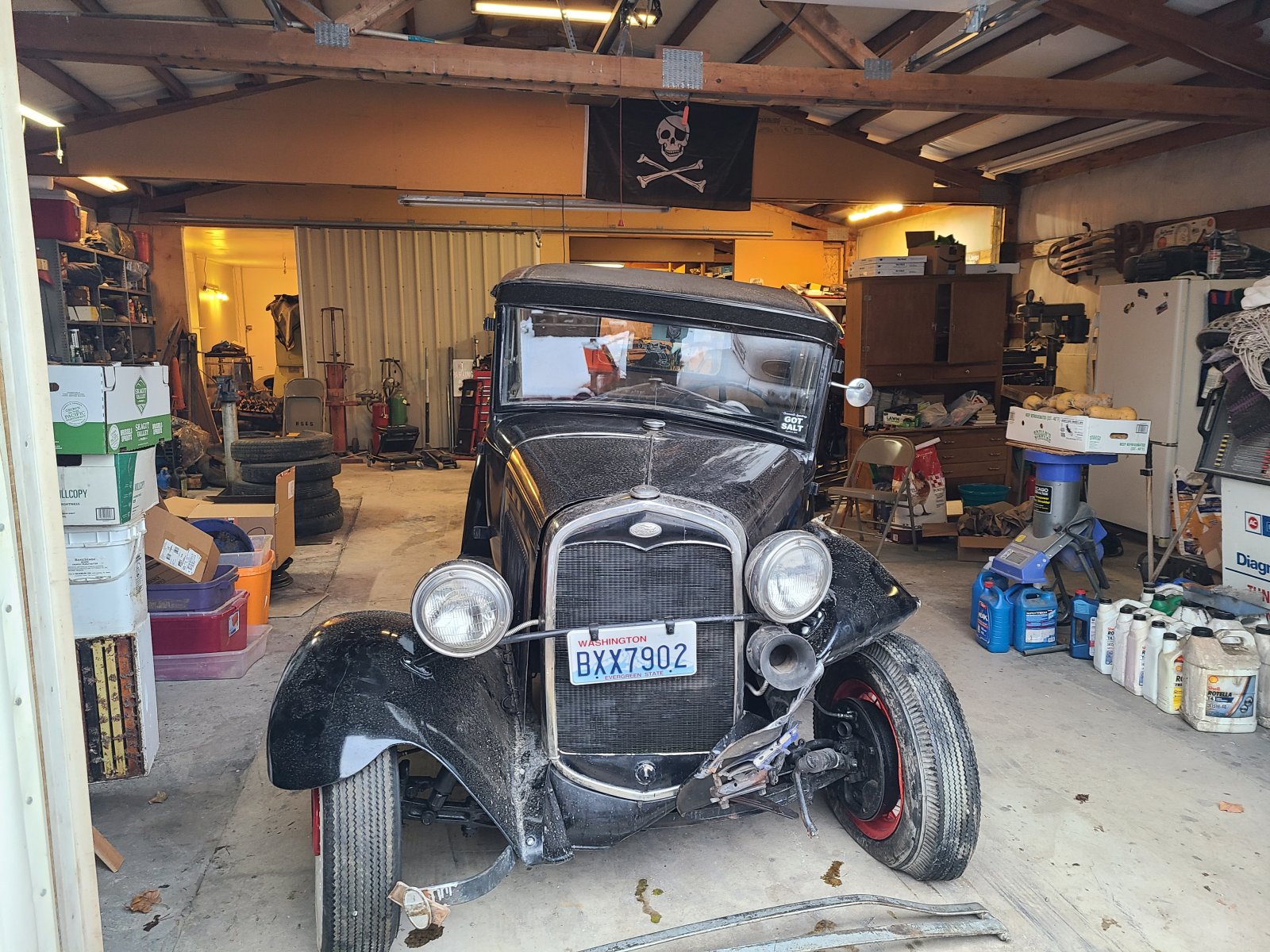

    Well, where to begin. I guess for me it's back to the drawing board. Took my 30 coupe out for drive, finally had gotten it sorted and it was running beautifully. Then I had someone who failed to yield and t-boned the coupe. Long story short no seat belts **** and I got partially ejected. Cars totalled, and I still need to heal. On the flip side my burtz block ships soon, got the notice while in the hospital. And I'm now getting a 31 coupe as a replacement. This one's getting belts. Merry Christmas everyone

    THAT ****S get healed up there is aways time to fix your car

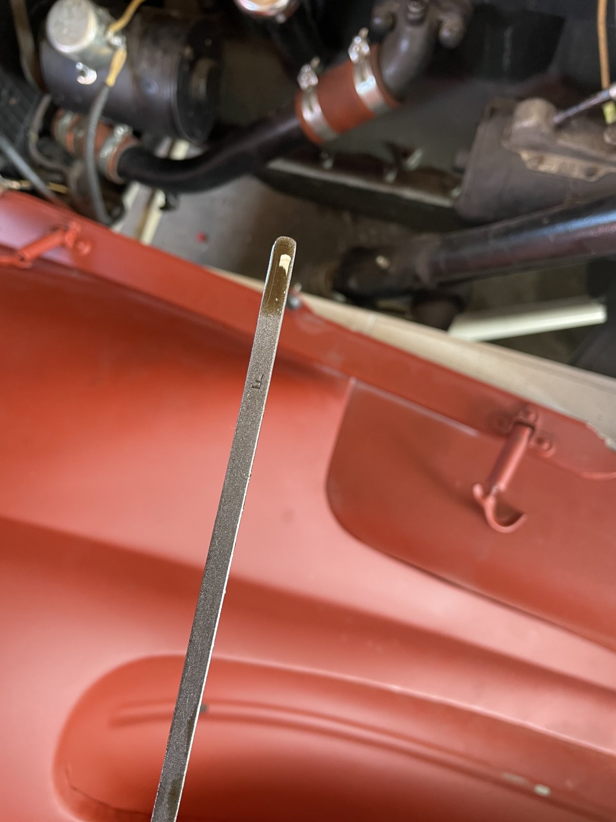

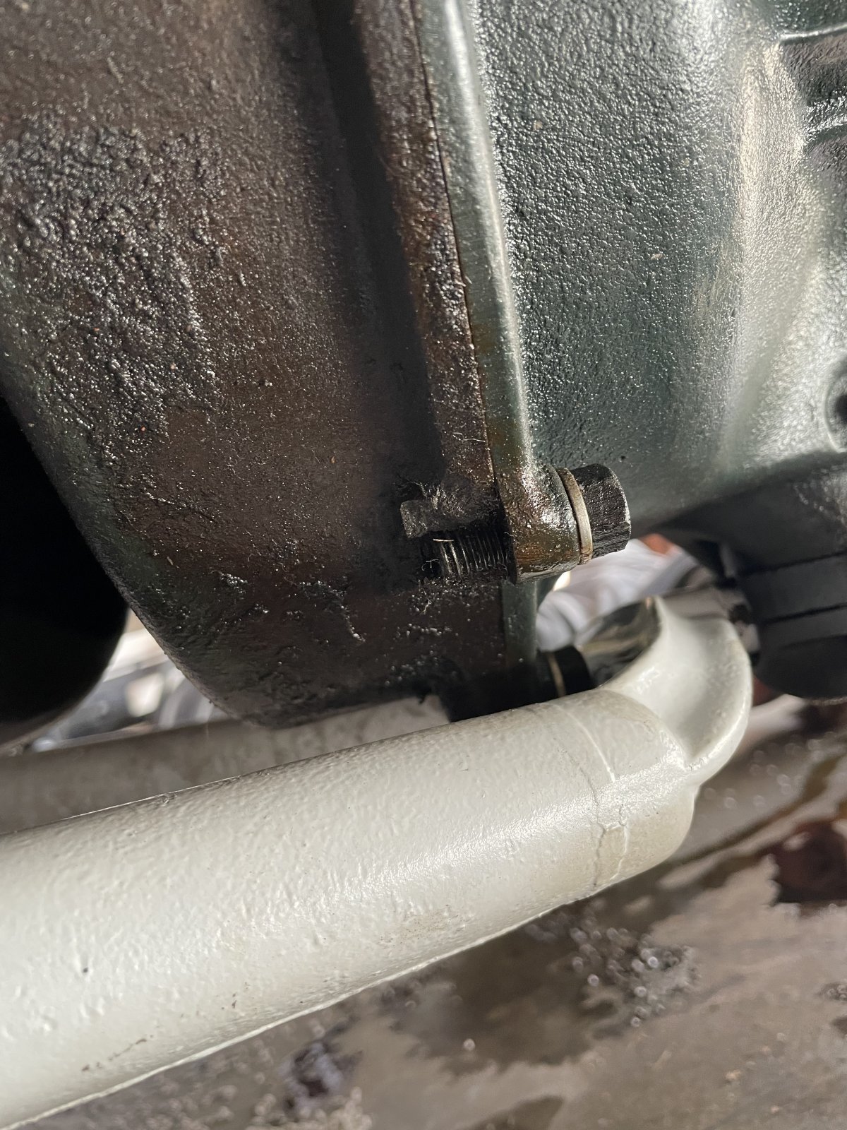

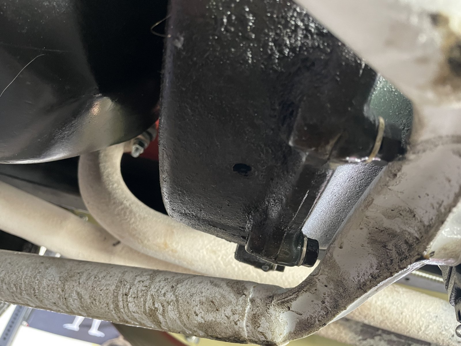

    So I’ve probably put about 80-100 miles on my car since the juice brake conversion. I noticed the car is leaking oil. The dip stick reads about half full after only 80-100 miles which I know model as notoriously leak and mark their territory but I think this is a little excessive leaking. Also I noticed the cast iron block where it meets the bell housing has one of the cast iron tapped holes broken… you can see the bolt where it threads in and should be a blind hole, but it’s screwed in and showing in the one picture.
    In any case, Is this something that can be fixed? Or something that can’t?
    Is there any way to check the oil pressure etc?

  16. Phil,
    Merry Christmas to you and Family!!
    That is a nice looking ***embly, I would expect nothing less from You.
    Enjoy, John
    Phil Damon likes this.
  17. G_Don,
    Let's see, lots of questions... I'll attempt
    The housing bolt boss is broken, probably not repairable nor is critical. If/when you take the motor out you can replace the housing.
    More than likely the rear main needs some attention, without knowing what is there it is hard to suggest a solution.
    What that means is it will need be opened up and then ****ysed.
    Can you check oil pressure? well, a stock Model "A or B" is not pressurized. (some debate about "B's" but that is for another discussion)
    The best bet is to take some pictures of the side cover and see if there is a oil line modification.
    There is a pretty good book availability that will address stock motors and modified so you can identify what you have.
    See the front page of this thread and look for Jim Brierley's book 4Bangers and Me.
    It is a good read of 80 plus years of modifications done to Mode "A" motors.
    Merry Christmas and Happy Holidays, John
