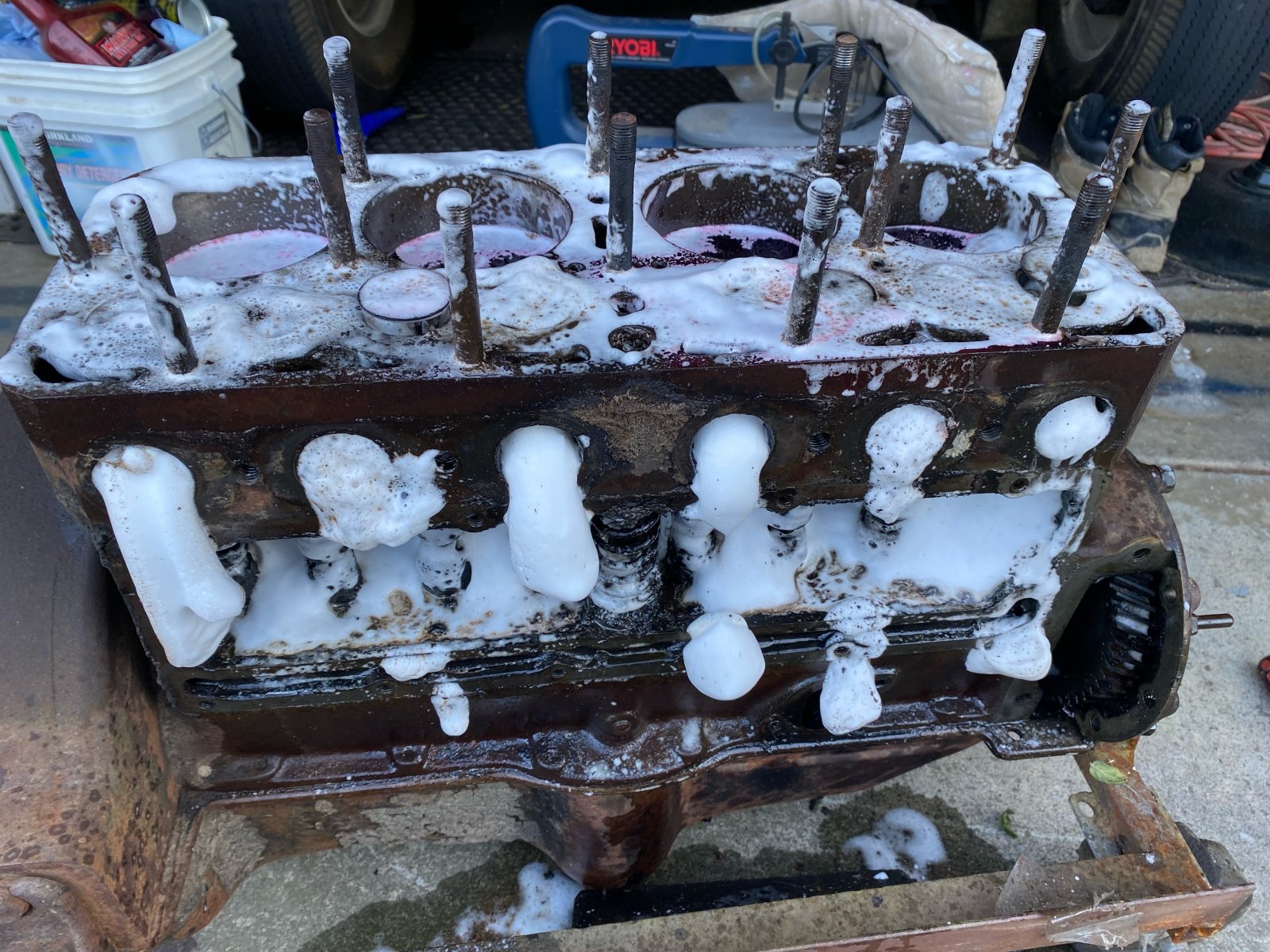

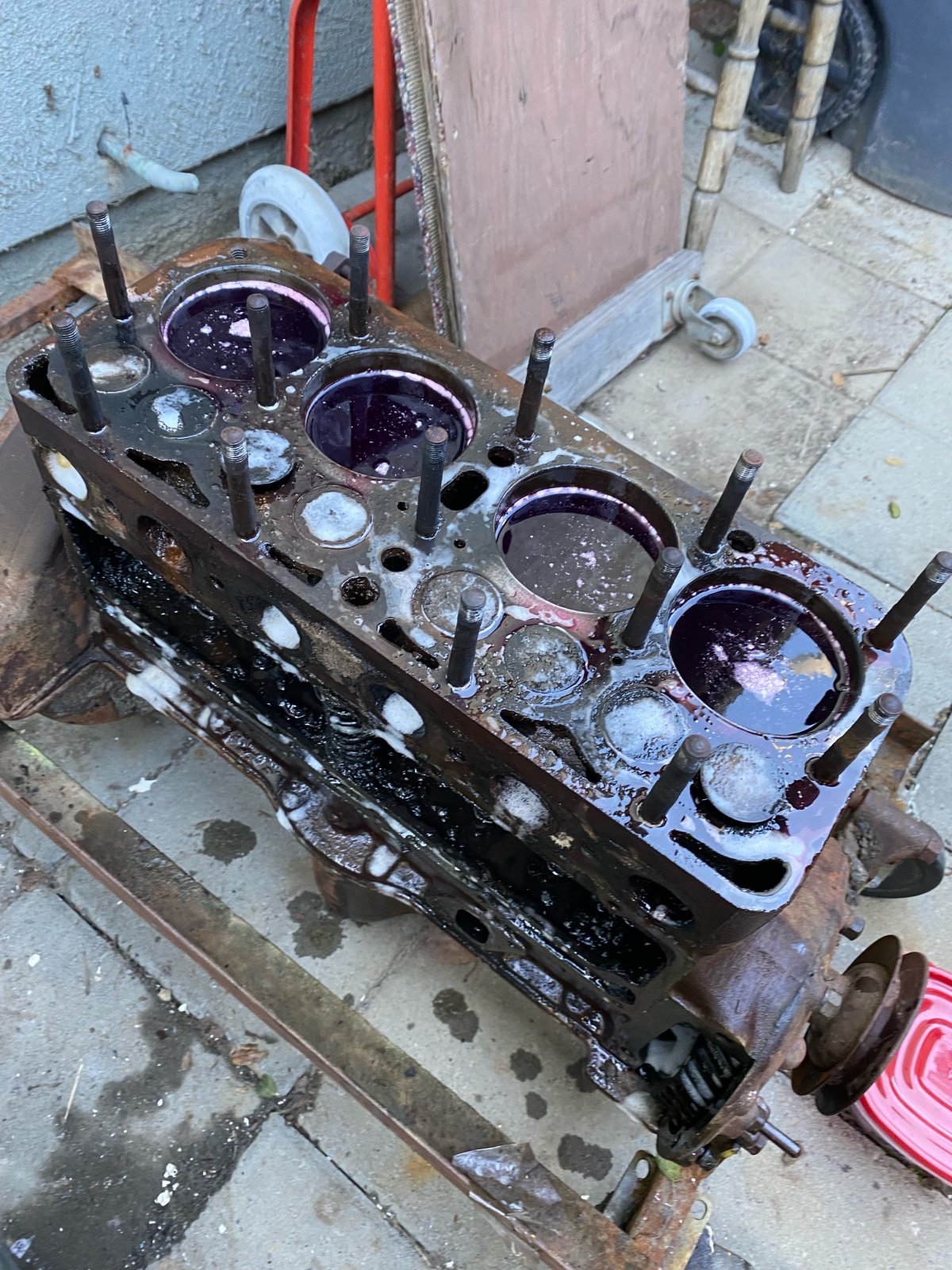

    Stuck valve could be part of the cause also...
    Id drop the pan and reverse soak it also when you get a chance. The wrist pins on my forgotten banger were froze solid on 2 rods the other two were free and clear...

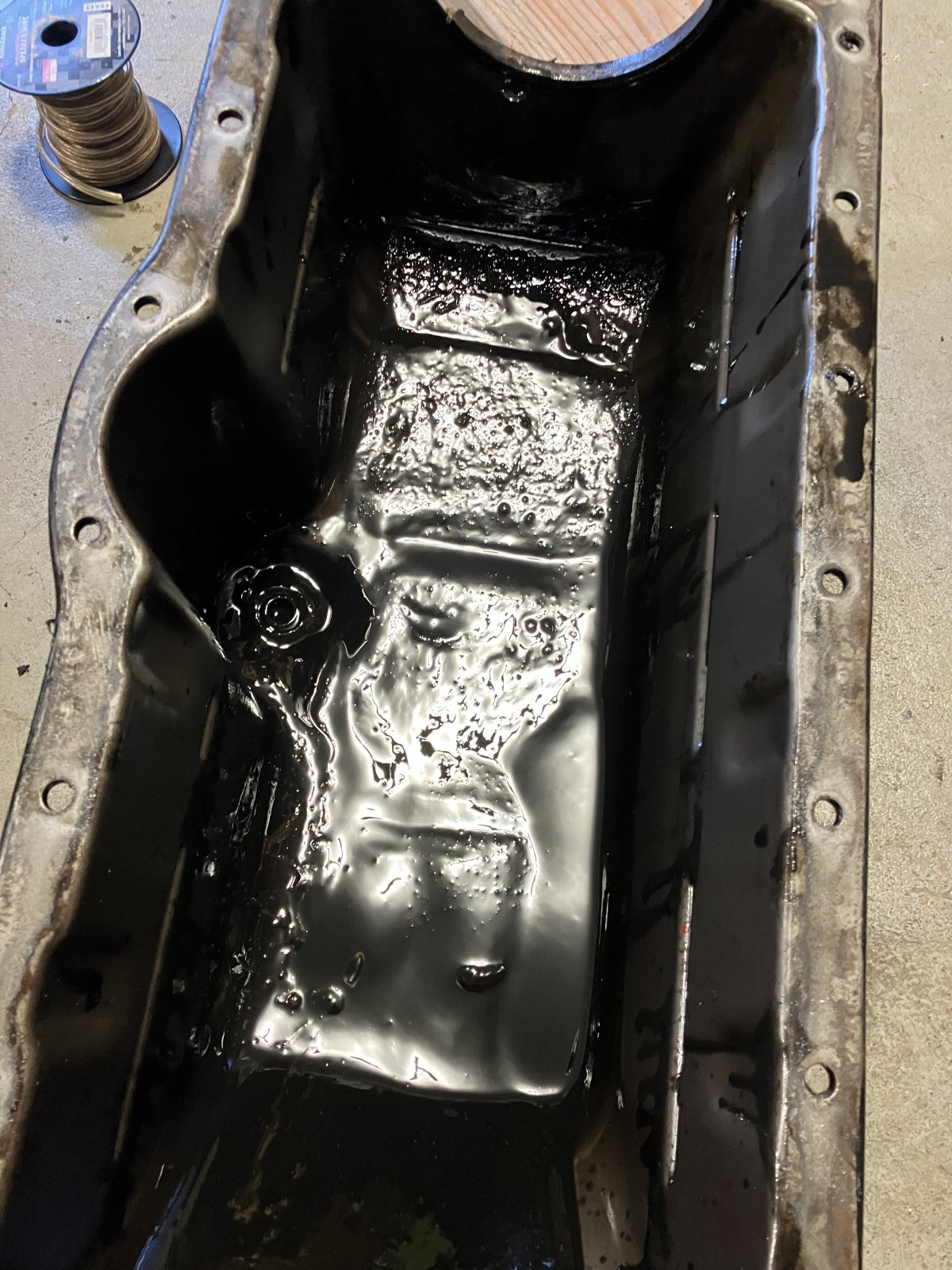

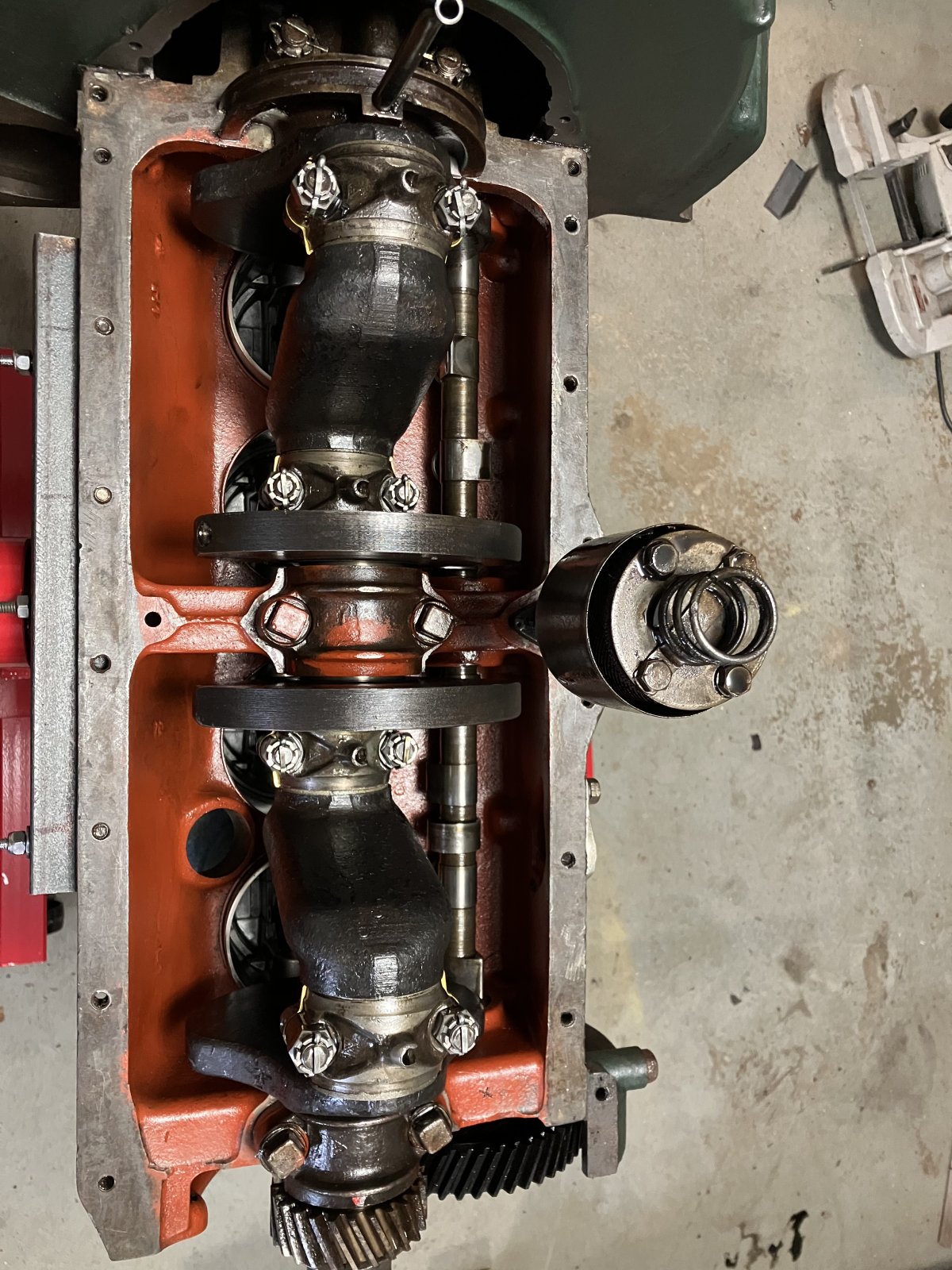

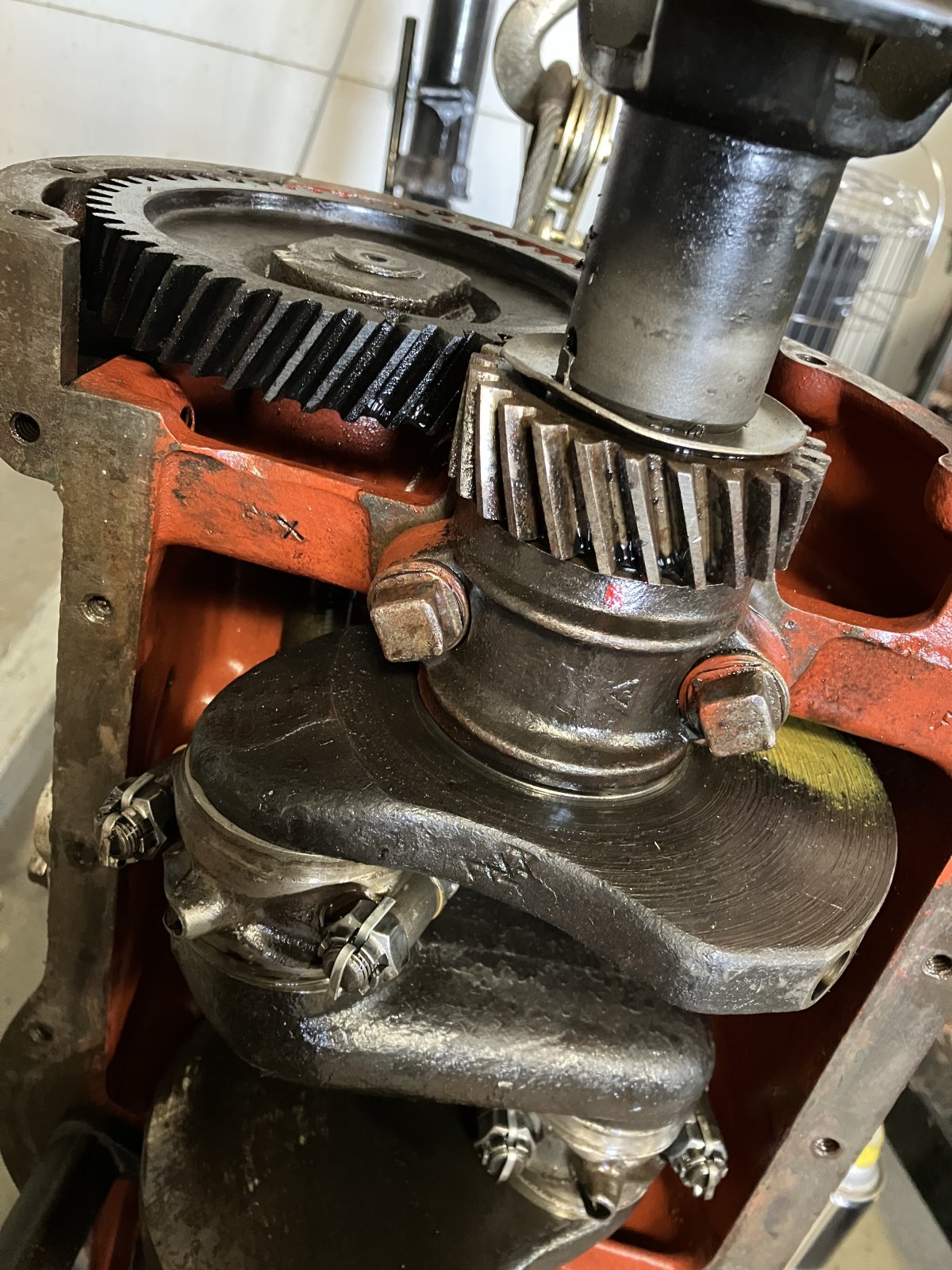

    Pulled the pan, little more sludgy than I would have guessed from a rebuilt engine. But nothing too ugly.
    2BDB0192-6214-44A2-B001-1ACAC4F92EFA.jpeg A2125EB1-6F6D-41D6-94D4-89AC8EFC6171.jpeg
    everything else looks in order.
    Didn’t check the babbitt clearances because I don’t have an engine stand.
    I would guess to do correctly, the weight of the crank should be on the block, yes?
    27FA44A0-F464-408A-9222-7413339769BA.jpeg 2A909A73-9570-4A26-8407-8D0BD066B44E.jpeg D30F9F00-8D63-44A5-B2F2-F106B80377D7.jpeg D5EFABDC-F32E-46B3-A070-7814FC72DAD2.jpeg

    Many experts say you should support the crank from below if you are checking clearances with plastigage; probably a good method. Throwout bearings are pretty much all the same, but lots of 8N and 9N tractor pressure plates get sold as the correct piece for any Ford 9-inch clutch. However the don't have the counterweights that increase clamping force as rpm's increase and should not be used in our vehicles. I would suggest Van Pelt or 3rd Gen as good vendors on the east coast.

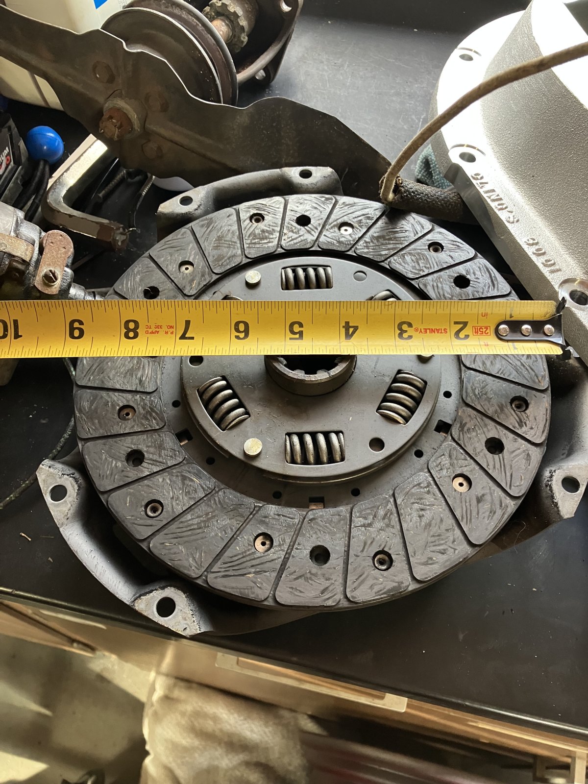

    Any clue if this is one of those aforementioned pressure plates that is “bad”?
    8E518CDC-58B3-45C4-9385-F70EE48704E1.jpeg 82CB9BB8-5D02-41D9-A2A1-4D28F71073F4.jpeg
    Funny, I put one of these on a few years ago on a previous car and never gave it any thought.

    Yes, that's the tractor clutch. Hesitate to call it bad, but may be more prone to slippage under duress. Couldn't find a better picture, but look at the one below, you can see one of the counterweights on that PP.

    I believe what you have is what many call a "tractor clutch" while it does not have counter weights I personally believe it is a better unit then the stock original clutch. It does show some slippage, but that may be operator error or a worn disk, You can purchase both from all of the Model A retailers Mikes, Bert's and etc. I noticed a Alum. adaptor in the upper right hand of the clutch photo, what is that? You may have a very nice engine there' try to pickup an engine stand, it will make your life much easier!

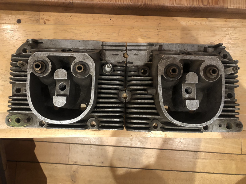

  21. While creeping the internet, I found photos of this really cool head. No provisions for a water pump, and finned for air-cooled use only. Does anyone recognize it?

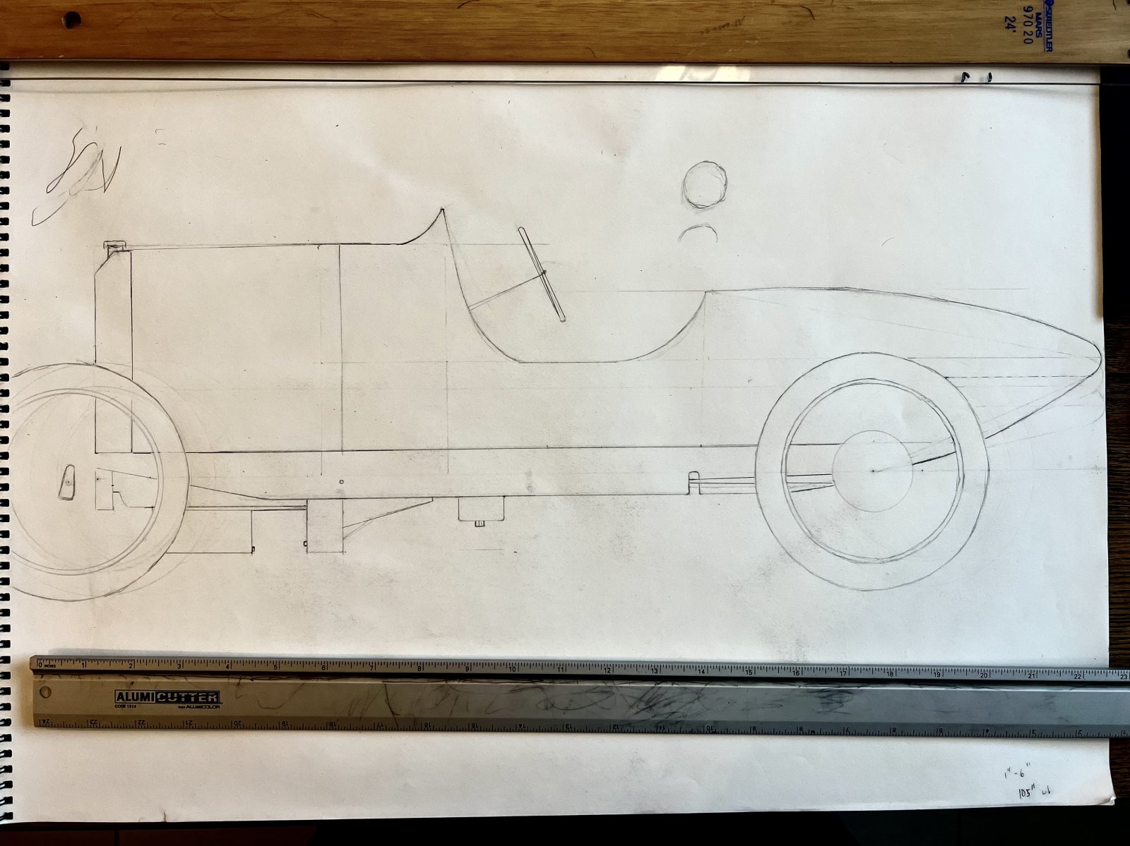

    That is the basic idea. 105" wb, about a 7" drop in the front and 6" in the rear. The steering wheel height is what I have used in the past. 6" side valence. Probably a bit off on a few dimensions here and there. Need to ponder the split front wish bones.

    IoE. Interesting! Has it been cut in half or 2 separate castings?

  28. For whatever reason, I want to say this is a Flynn or Flinn head.

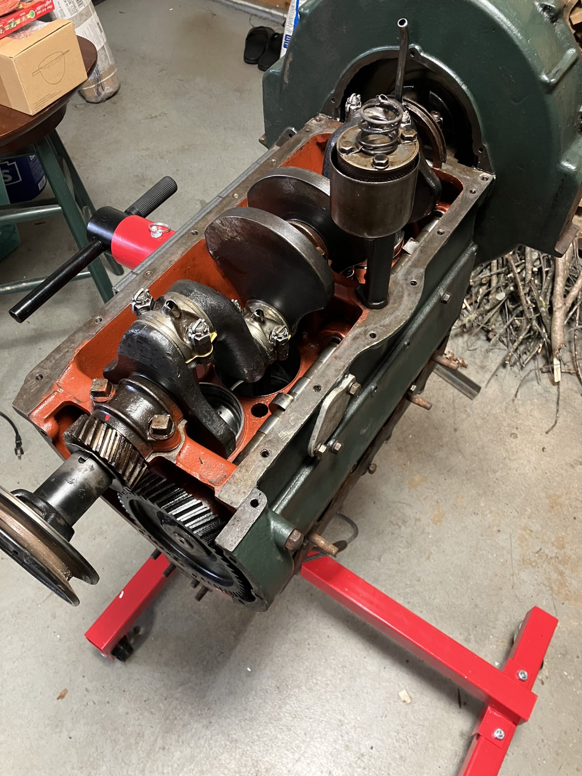

    I got an engine stand from Harbor freight.
    If I’d known the pain it was to bolt the engine up, I would have bought the adapter specifically for the banger.
    Oh well, at least I saved some money.
    Yeah, much easier to move around. And putting the pan back on.. much less likely to have a leak.

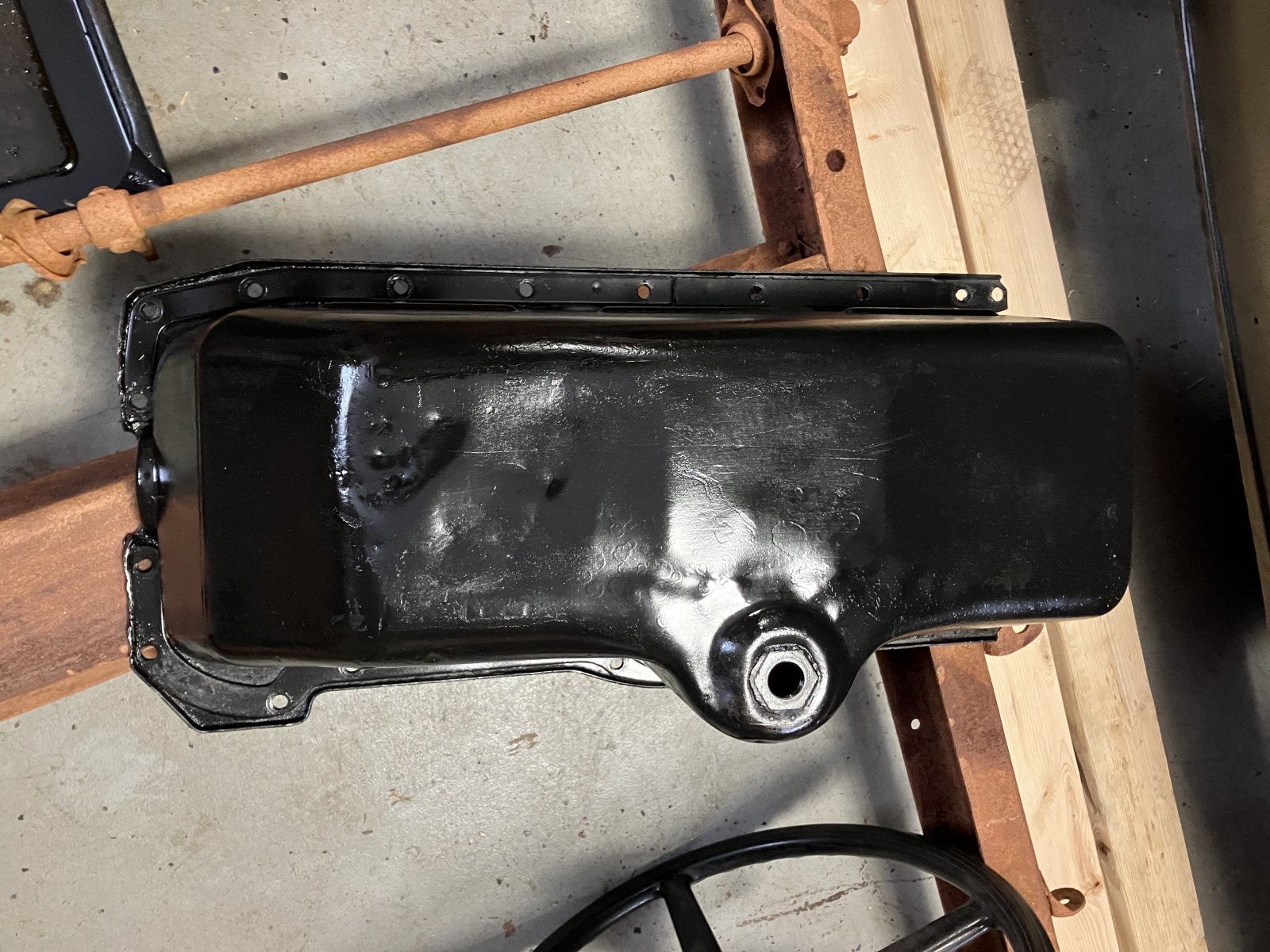

    question though
    There’s some welding/grinding on the oil baffle(guessing at what it’s called)
    Any thoughts on why that would have happened?
    Doesn’t seem likely that an oil pan would have rusted through to need repair.
