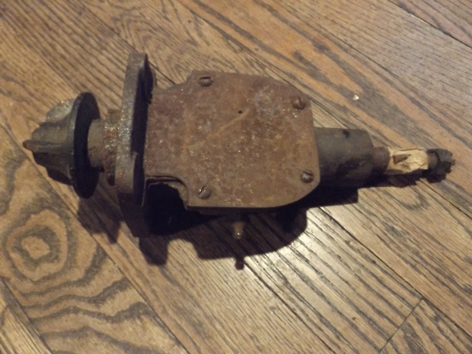

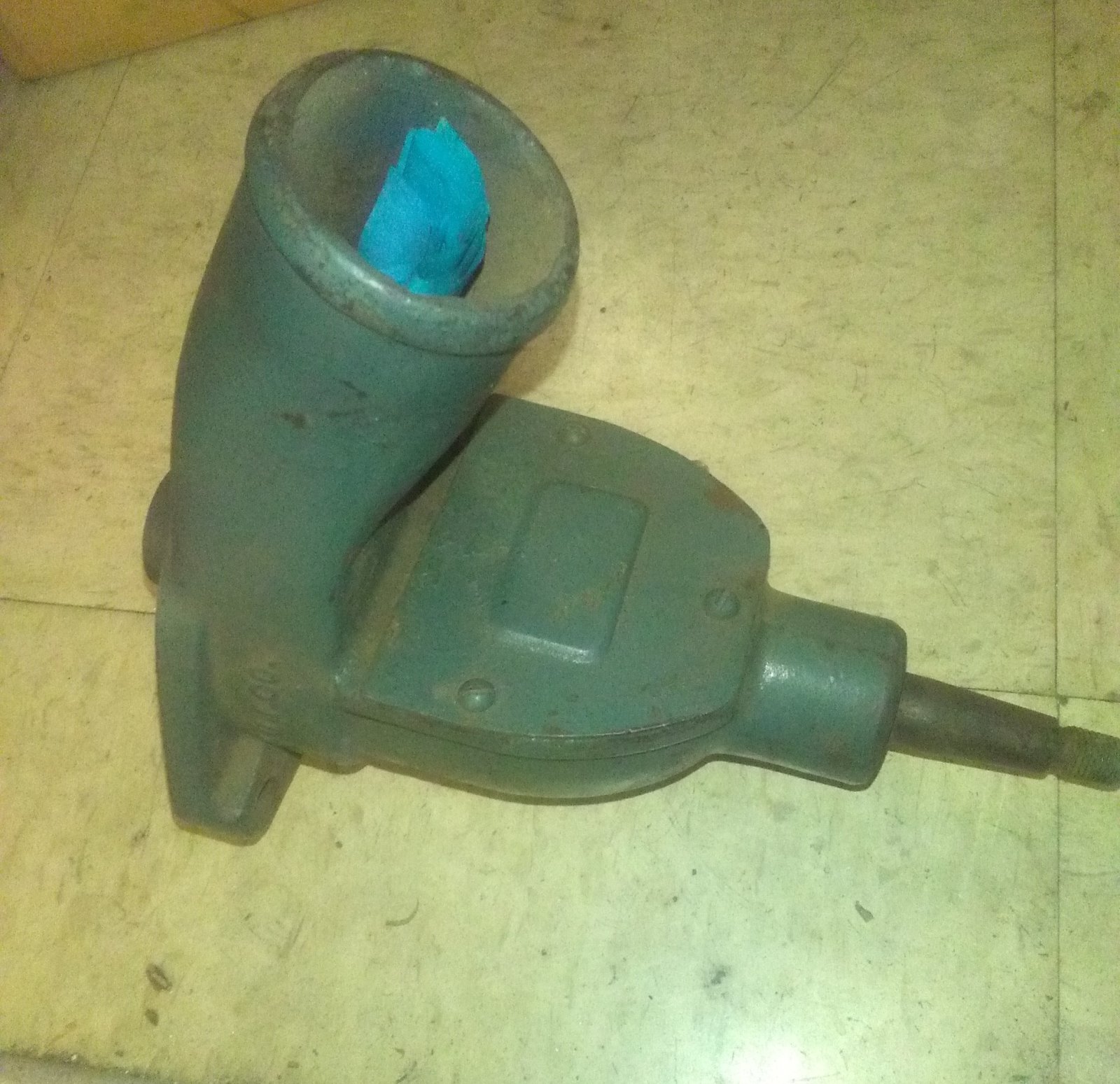

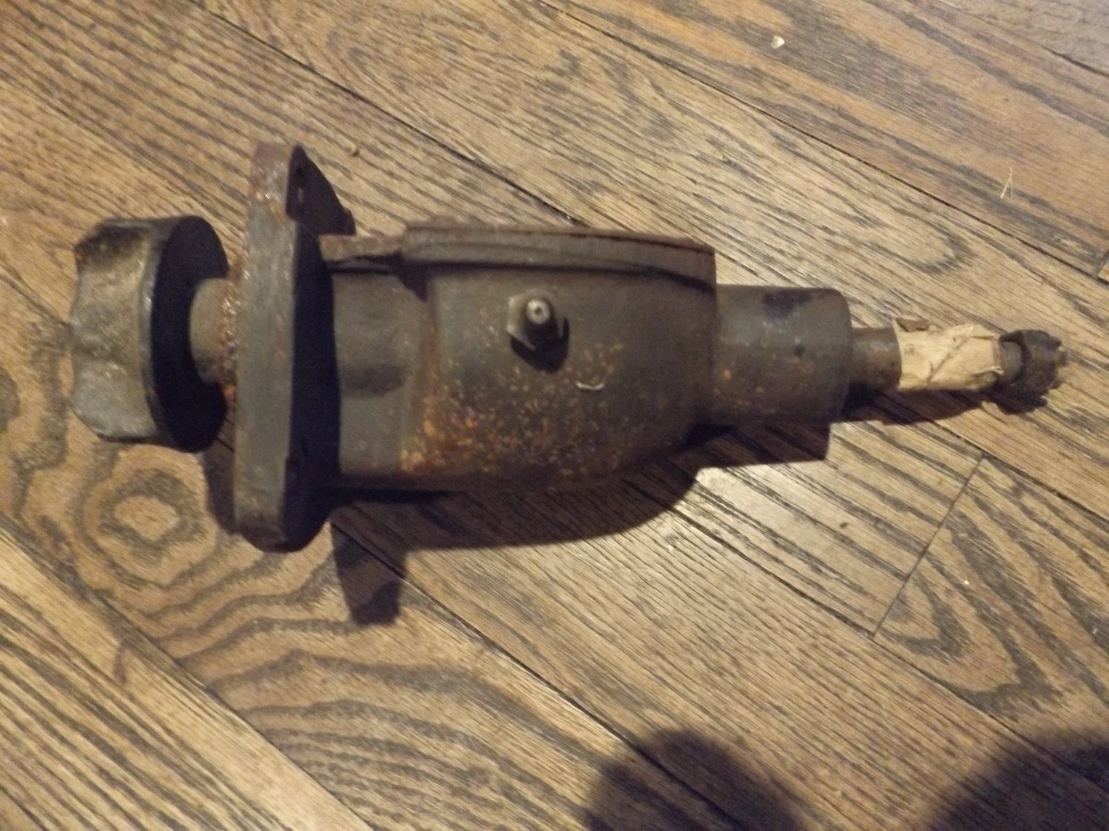

    Here is a similar pump, except for a B head. The style of the top plate is very similar. I have the same one on my Four Port- it has a spring loaded face seal and does not use packing.

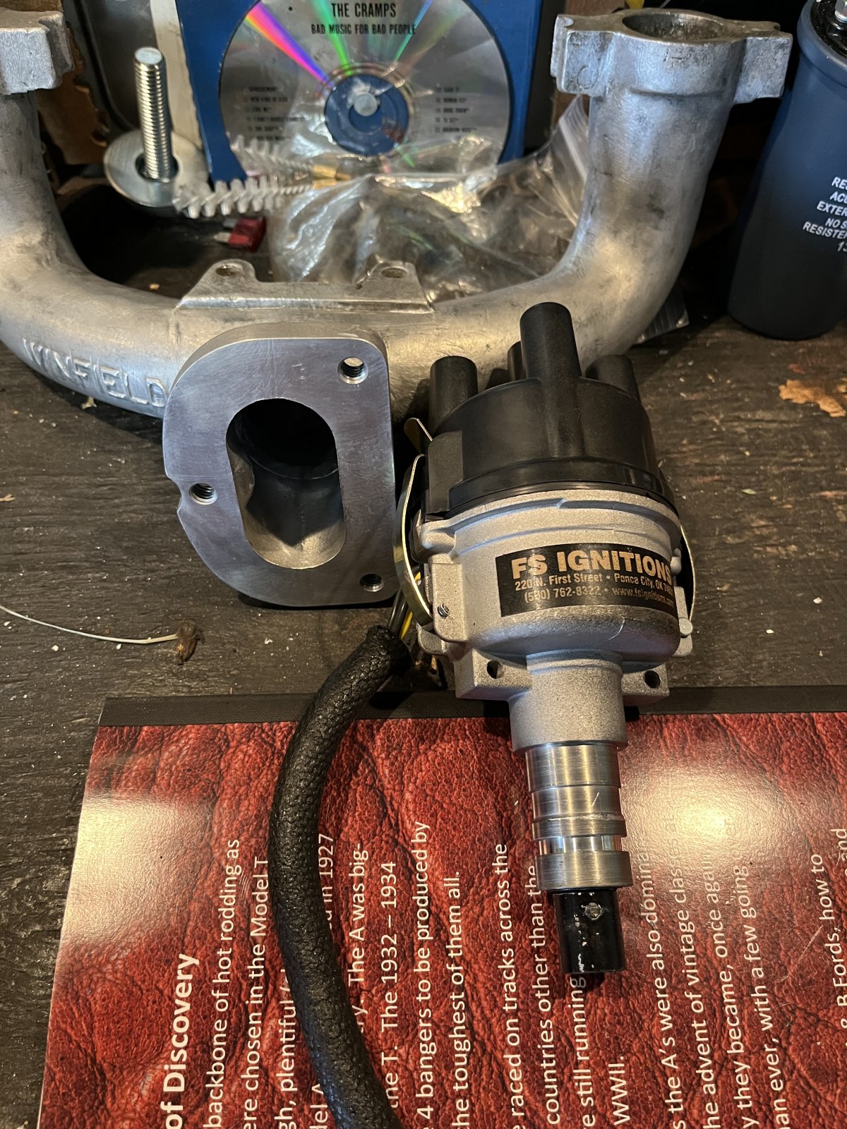

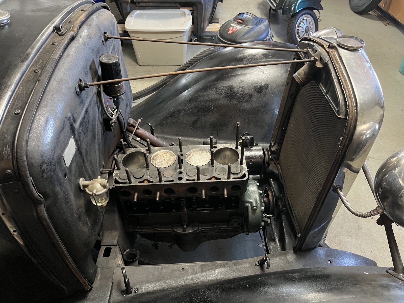

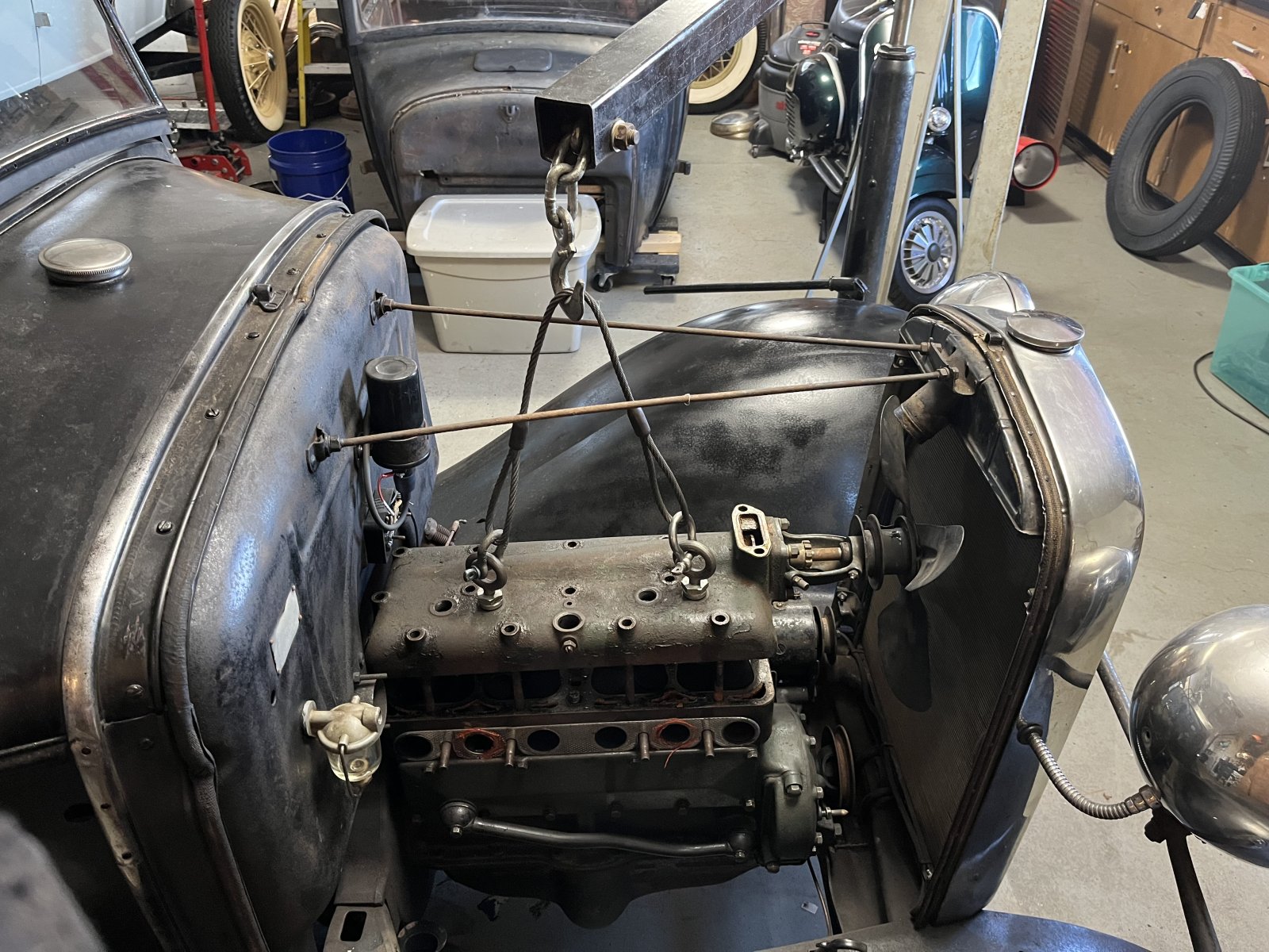

    Working on a new project until the engine is rebuilt for my coupe.
    Traded for this phaeton.
    Only needs some fine tuning with the springs, add some shocks and mess with the brakes. it’s fairly solid.
    Going to get the distributor reworked to match the head a little better.keeping 6 volt though.
    New header and carb too. Two blade fan as well.
    Once I get it on jack stands to fix the front spring, I’ll drop the pan to get any sludge out and check shims.
    In mockup stage waiting for gaskets.

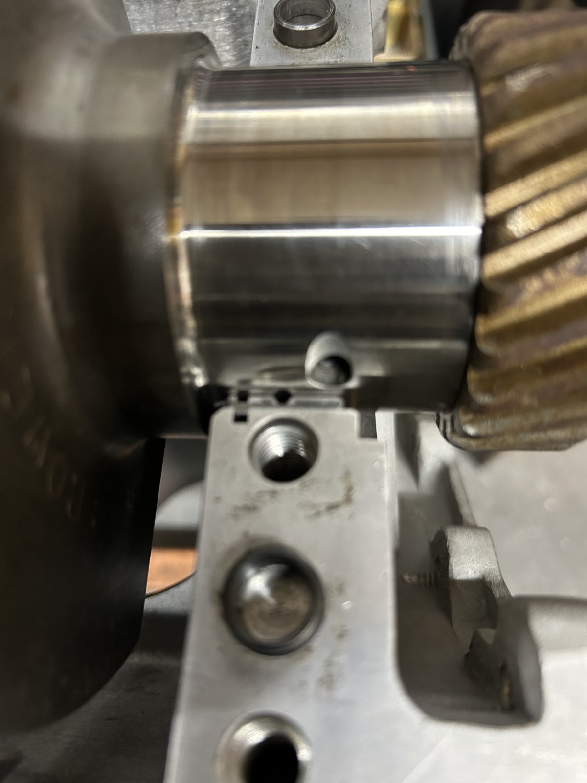

  15. This came to me as ready to run
    Always trust but verify
    John
    fur biscuit and Dan from Oakland like this.
  16. Kevin Pharis
    Joined: Aug 22, 2020
    Posts: 718
    Kevin Pharis
    from Califunny
    Looks ready to run to me… run all the oil out the front that is! Good catch! Would have made a mess out of #1 rod bearing in a hurry
  17. joemac05
    Joined: Jul 29, 2006
    Posts: 506
    joemac05
    How can you fix that, is it just the wrong bearing shell? :oops:
  18. I think best to plug the crank and redrill hole in line with bearing
    The web would not be wide enough to support a wide enough bearing to use existing hole
    Much easier to fix now than later
    J
  19. joemac05
    Posts: 506
    joemac05
    I am ***uming that it is at least a B crank, as if drilling them isn't bad enough, my good golly.:eek:
  20. No not a B crank
    This is a Donovan model D motor
    Drilling C cranks are easy with proper fixture and drills
    J
  21. joemac05
    Posts: 506
    joemac05
    Well that feels better, and better material in that new crank no doubt. :)

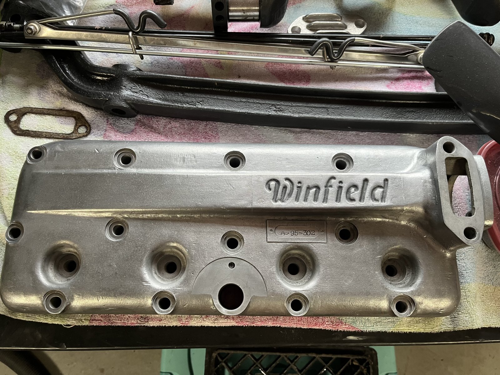

    Could someone help me choose spark plugs for this head?
    Should be 6.8 +/- compression made by Specialty Ford Parts. I believe 14mm.

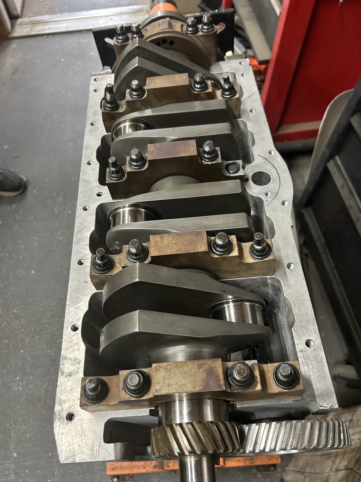

  26. Time for lunch
    2 bottom ends together
    Finally getting some where

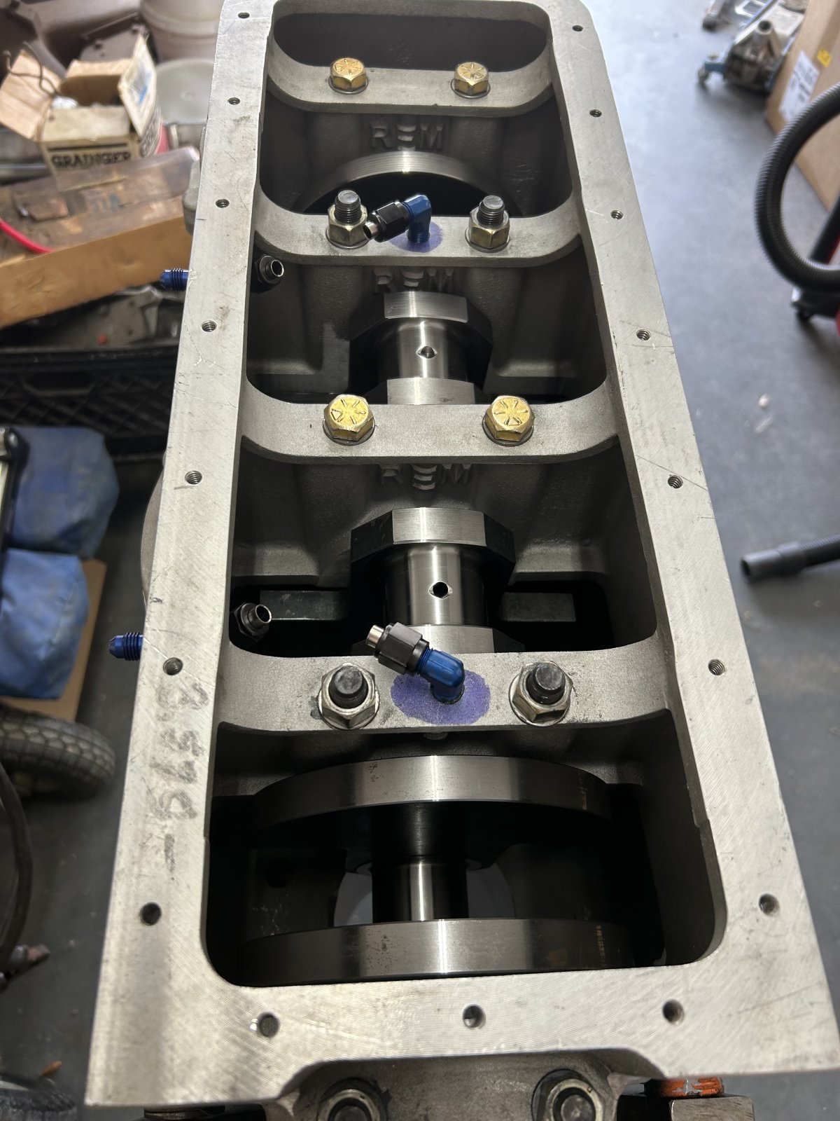

  30. Agreed, it is a nice piece.
    This one was machined by Jay Steel some time ago, never run.
    I had to clearance the block for the REM Rods and will under a HAL 2 cam head.
