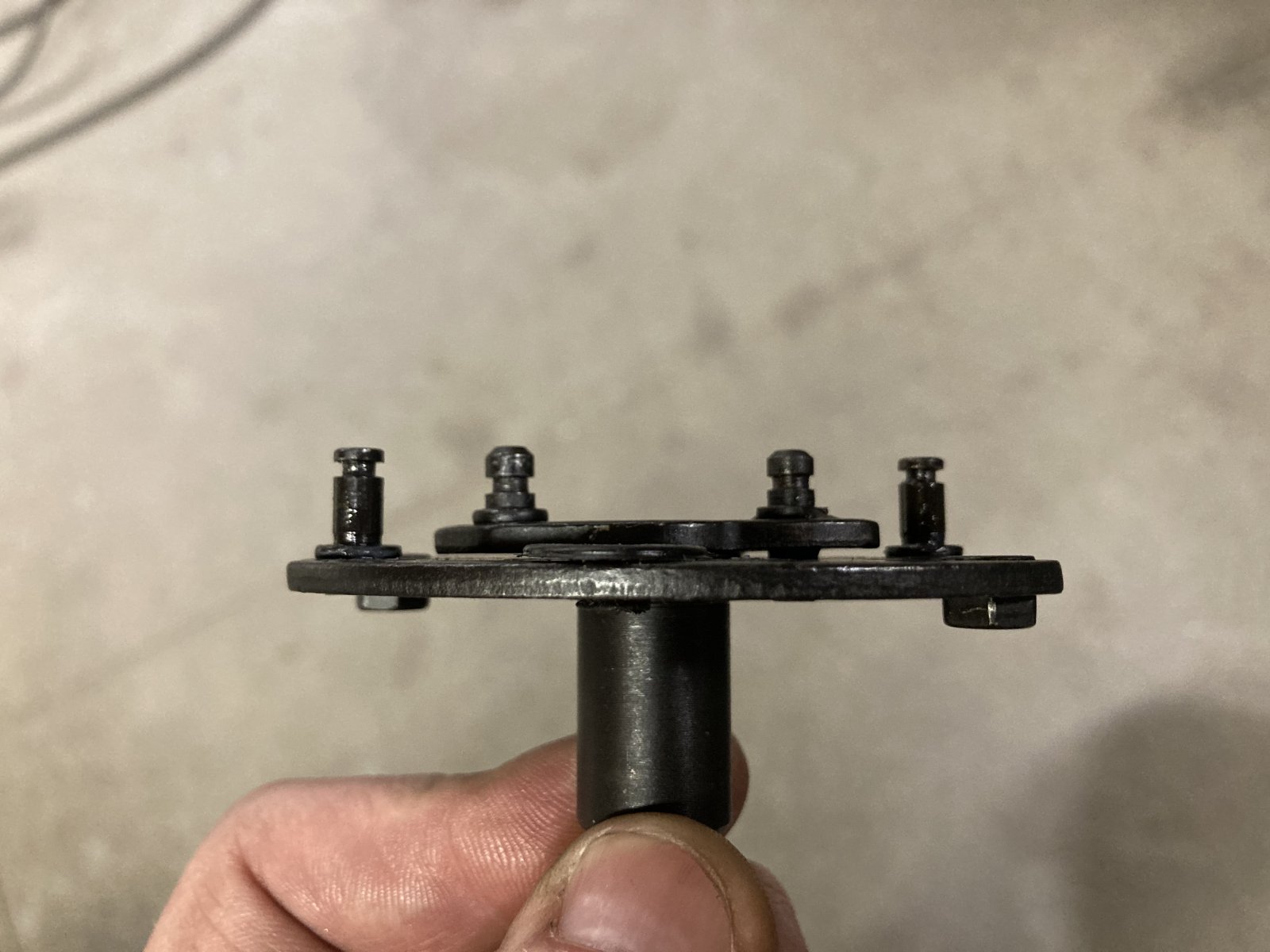

    Kevin : it looks like the pivot hole in the weight that's "riding up" might be "wallowed out", allowing it to ride over the advance cam. Possibly weld or "sleeve"(?) & redrill the hole on both weights (with a tighter tolerance), & square the contact edges of both the weights & the advance cam?

    Just found that the center shaft flange is .030” lower on the side that is slipping the weight. Seems a little on the delicate side if .030” is going to make or break the design. The flyweights are a smidge sloppy on the pivots… but no worse than any other I’ve seen
  3. Is there not another rub block/surface over the top of the flyweight?
    But yes, you have found a QC issue.

    The rotor screws down over the top and becomes the upper contact surface, and there is a plastic ****on on the lower plate. Apparently, still not enough to keep the flyweights under control… F36BD91A-087C-4CBC-87FB-B3A3FF5B1063.jpeg

    Is there room to put a retaining ring on the shaft to hold the flyweights down? Or maybe just bend the plate up by .030"?

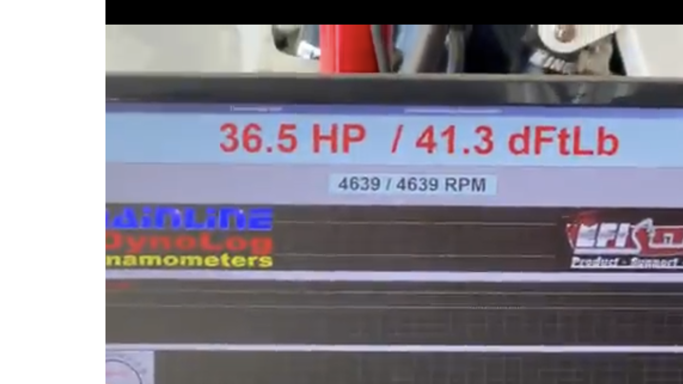

    Been watching these videos on my lunch break this week. This guy put a stock Model T on the dyno. Then replaced it with a hopped up motor and dynoed it again. Pretty cool.

    I bent the inner flange up the .030” to match the other side, and moved a .020” thrust washer from the base to between the upper and lower centrifugal plates. The flyweights now seat against the full width of the inner flange and I feel will run reliably

    Sorry, 36 HP at the rear wheels !!!............. sumptin not quite right there---- in my opinion!

    Agreed! He must have done some pretty serious work on that stock NH carb!;)
    Curious if the HP number was calculated to figure the HP at the flywheel. He may have used a large friction loss value…?

    Just watched this video again but looked a bit closer at the Dyno results
    41 lb/ft of torque seems a little bit low… but 4639 rpm seems a LOT high! The ol girl didn’t appear to be turnin near 120 mph on that pull:eek: If the 41 lb/ft is accurate, and let’s say the rpm got doubled (still a bit high for a basically stock T, would work out to bout 60 mph), the HP is then halved to 18.25. Much more believable. Especially considering he says that he made it up to 35mph on the way over to the dyno shop
    HP = Torque x RPM / 5250

    Its gotta be the dual exhaust manifold I tell ya!!
    Nice catch!!
  15. Or he was tipping the can pretty good!!

    This dizzy came to me with an alternative centrifugal spring combination, scratches on the center shaft, and the rev limiter adjustment screw turned all the way in one direction. My su****ion is that someone returned this distributor after incompetently futzin with it, and these “adjustments” went unnoticed when it was repackaged. I believe it possible that the center shaft was dropped during the futzin, causing my quality complaint. I’m not so sure that it was a production flaw… but I did purchase it “new” directly from Pertronix, and so expected their tech support to be at least remedially helpful… but who am I to make such ***umptions…:confused:
