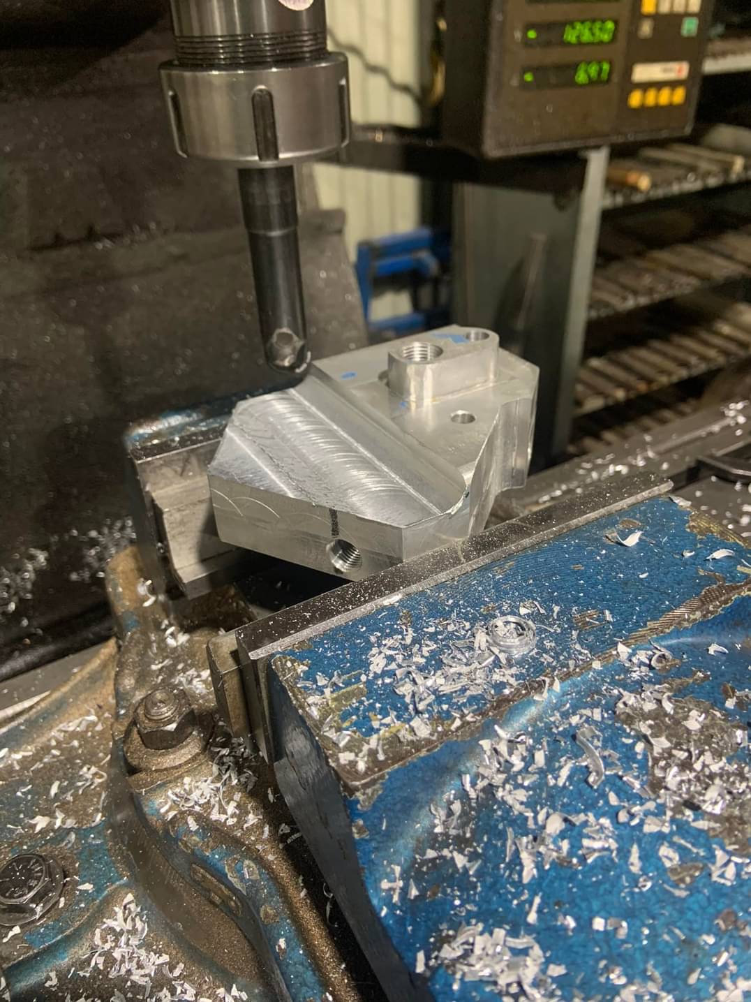

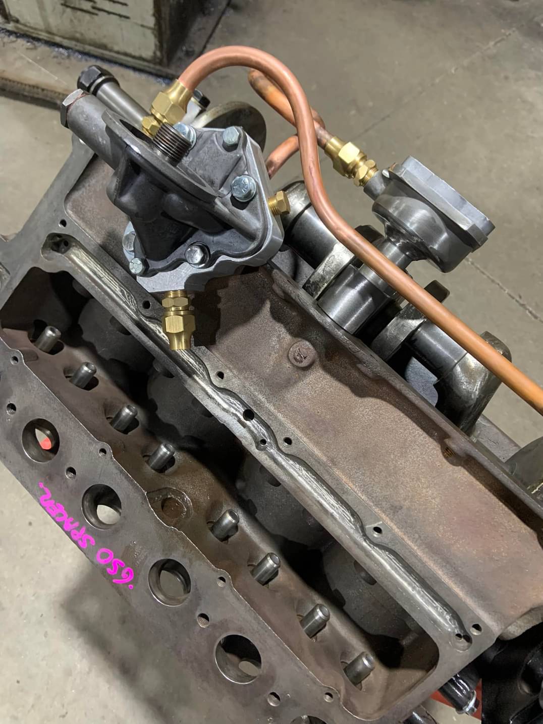

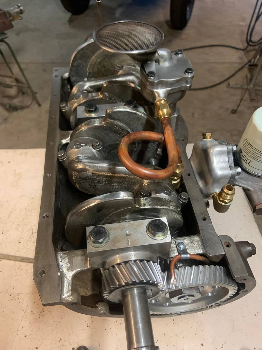

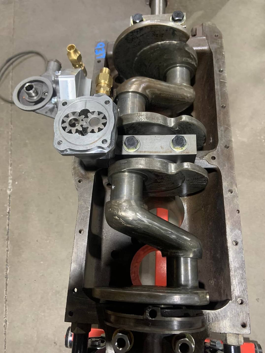

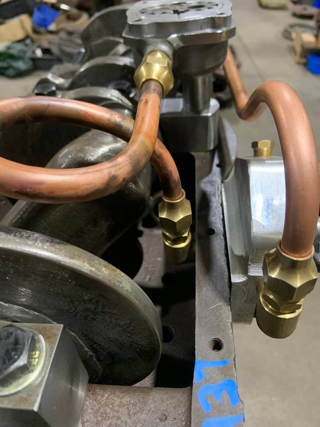

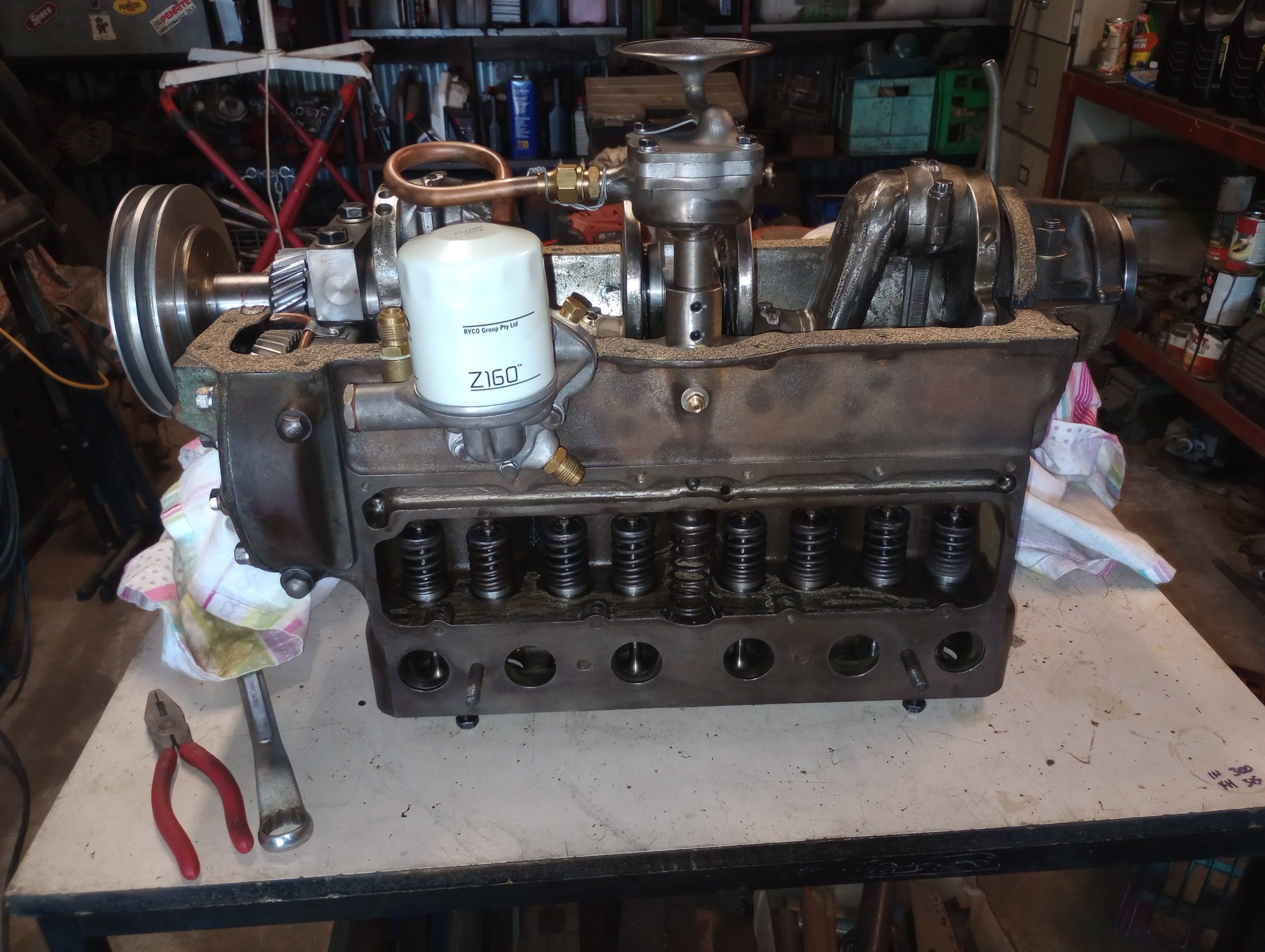

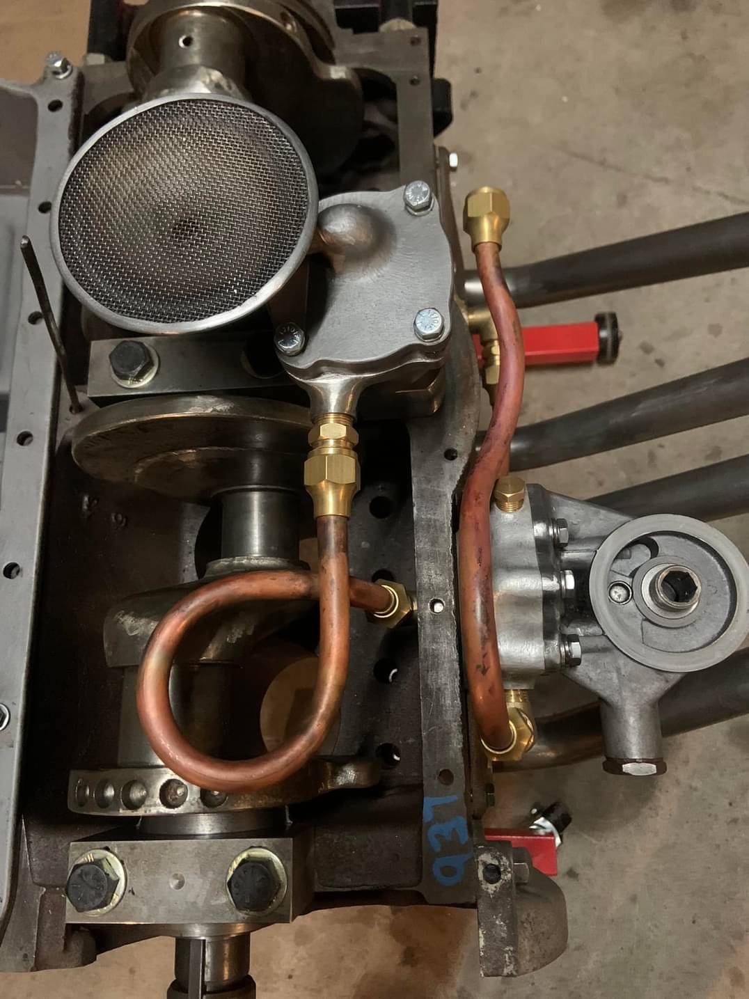

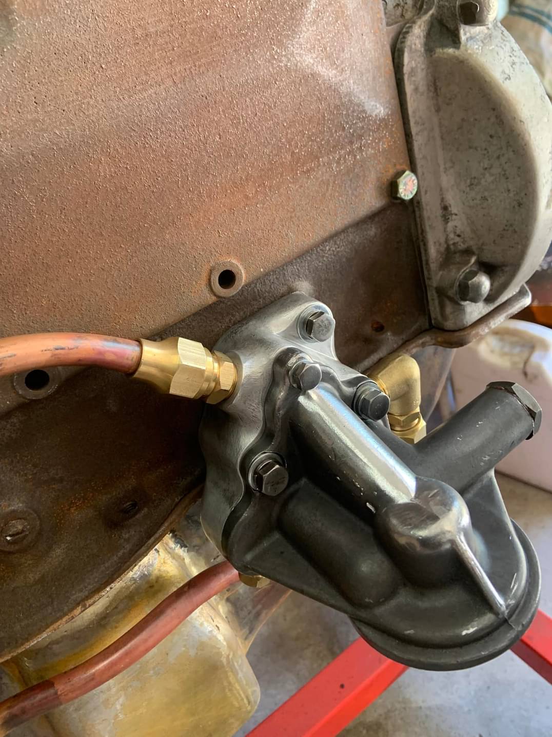

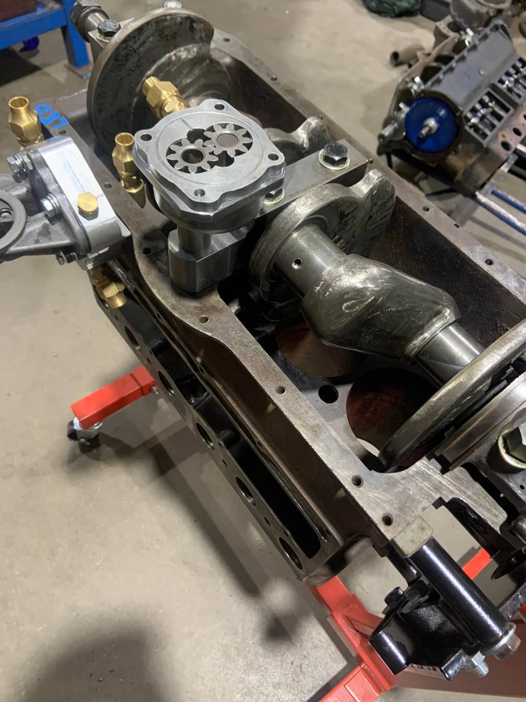

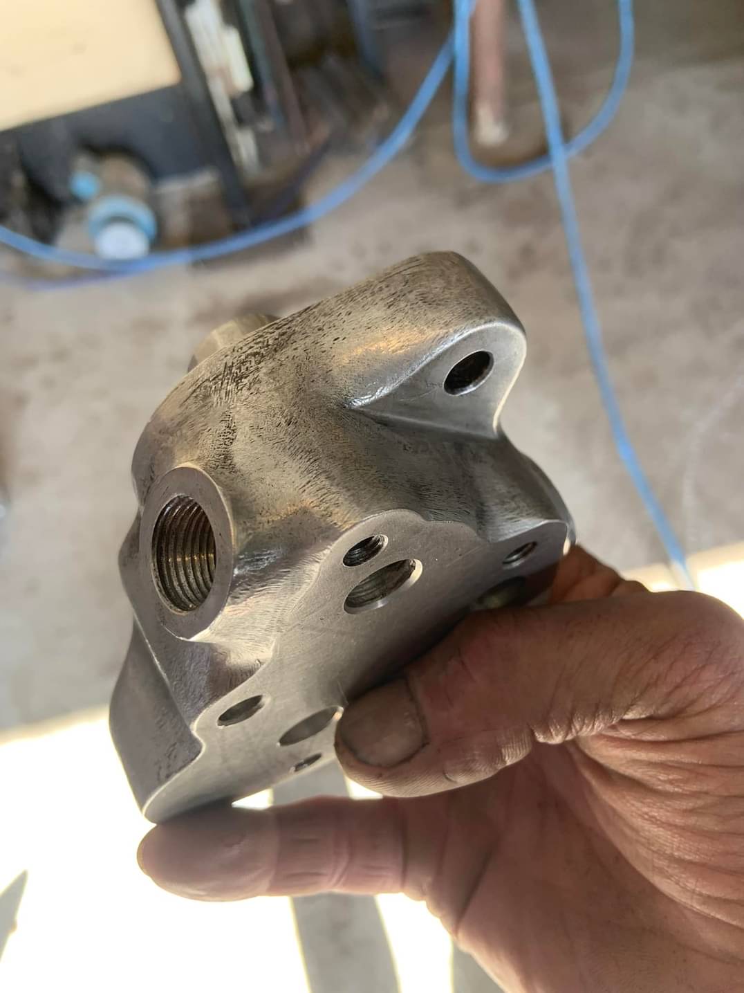

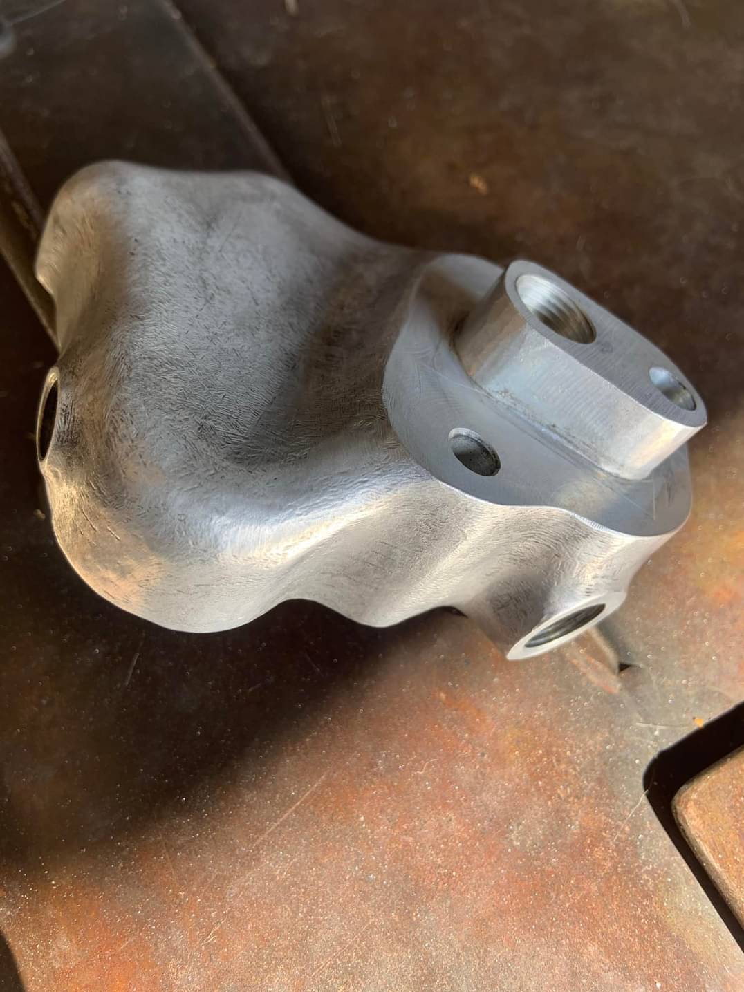

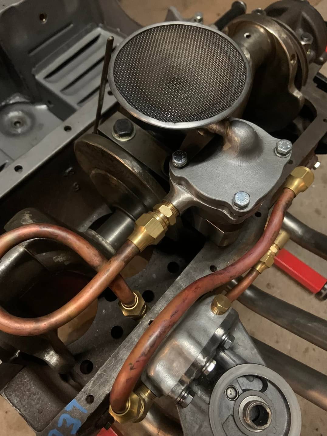

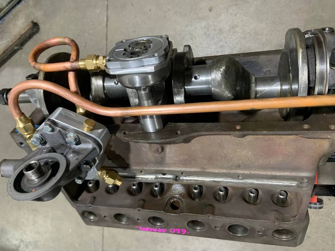

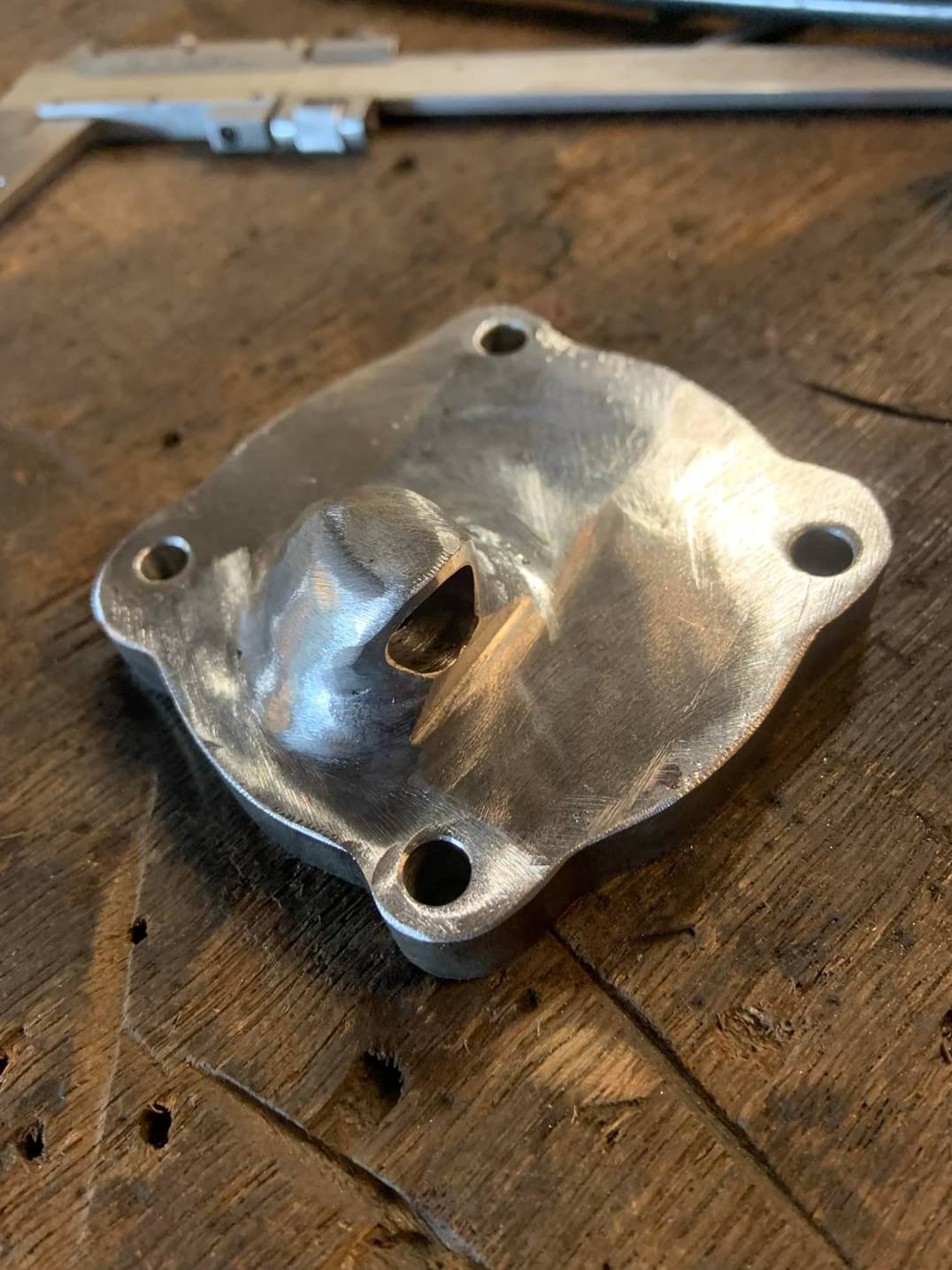

    Here you go, the order may be a little mucked up.
    The oil pump is vw beetle & oil filter housing has a pressure valve & is Aussie gm v8

  12. Wow, my wrist hurts just looking at those bends. Solid work!!

  17. @Outback, that’s nice work, and good use of, off the shelve parts, modified to work with our old engines. I really like how he has given the machined parts a cast look. Can you share how that was done? Is the oil pump fitted into a custom main bearing cap ?

    I believe he uses a die grinder running very slowly to achieve the finish
    Yes he made custom main caps to suit the oil pump,
    He also welded the counter weights on & built up the rear seal area to run a modern lip seal.
    He's a little concerned about the extra load on the pump drive, with 55psi. Has anyone had issues with pump drive failure with higher pressure's
