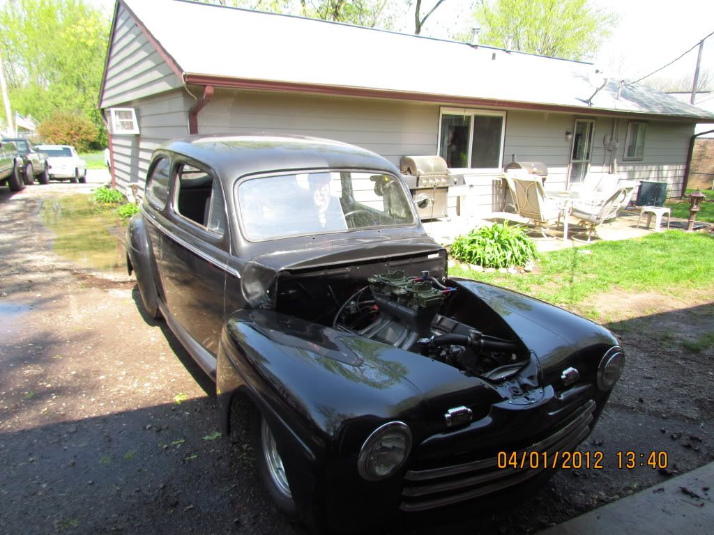

  1. Just bought my very first pre-60's Vehicle, a 1946 Ford Sedan Tudor. getting really anxious to bust knuckles and start tearing into it. end of the month it will be in my garage. trying to decide on an engine. basically what i want out of this car is a daily driver, no fancy paint or body work yet, just throw a drivetrain in it, maybe a couple bucket seats and go! i will be hitting miles in it being that i go to almost every swap meet and car show on the western side of canada. so i would like a little fuel economy, as well as not having to worry about elevation when i hit those mountains. but i do want to keep it old school. and being an engine machinist i look at way too many sbc's as it is. im thinking about going 289 with a modern top end. maf fuel injection, roller cam, and a better maybe lighter head. behind that i would like a 4 or 5 speed standard trans, and behind that maybe a locking 8.8 rear end. only questions i really have about this is how will a small block ford fit in? if anyone has done it to these types of cars let me know what headers you ran. and also has anyone used the 8.8" rear? and what would be the best way to put it in? also how can i get disc brakes up front? what brake boosters fit under the hood? and what steering columns have been used? im open to any ideas or comments
    heres the car
