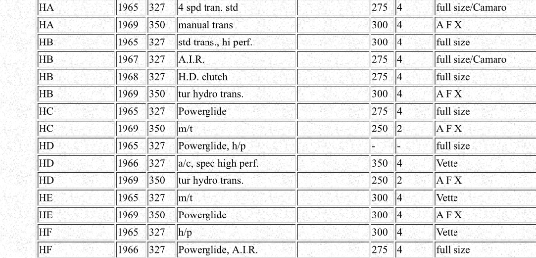

  9. We have a great teacher

  11. DDDenny
    Posts: 22,602
    Those charts can be less than fully accurate, such as the first one, (1965) calls out full size/Camaro.:confused:

  13. squirrel
    Joined: Sep 23, 2004
    Posts: 60,070
    squirrel
    The chart is accurate for the years it shows, the HC suffix was used in Full Size in 65-68, then in A (chevelle) F(camaro) and X(nova) in 1969.

  15. Fordors
    Joined: Sep 22, 2016
    Posts: 6,577
    Fordors
    The chart I referenced shows the 327’s as all 4 barrel carbs, Power Glide, fitted to PA, p***enger cars. The 350 was a 2 barrel, manual transmission and the applications were as follows CA, CH, EC, NO, Camaro, Chevelle, El Camino, Nova.
