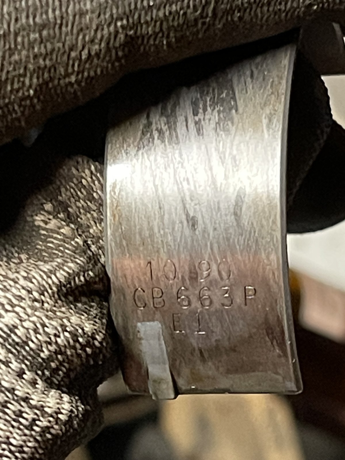

    IMG_5846.jpeg IMG_5847.jpeg I’m trying to decode the main and rod bearings in my 350 Chevy small block so I can order new ones.
    Rods- 10 90
    CB 663P
    E1
    Main- 1 89
    MB 2508 P
    LOWER T
    Thought maybe someone here that was well versed in engine rebuilding may know what undersize these are. If not I can take the crank to my buddy’s shop this weekend and have him use his fancy micrometer type tools to figure it out, but I’d like to get them on the way soon as possible.
    Thanks! -John
  2. superduper88
    Joined: Sep 13, 2007
    Posts: 214
    superduper88
    I’m guessing the rods are .010 from the “10”, and the mains are .001 from the “1” marking, but I’m not positive.
  3. brando1956
    Joined: Jun 25, 2017
    Posts: 258
    brando1956
    Are you sure these aren't standard size? The part # is Clevite 77 and any of these I've seen have the undersize stamped right after the part #. The first set of numbers is the month/year manufactured. The CB is connecting rod bearing and MB is main bearing. I would mic the bearings and crank to verify. You really should mic the crank anyway to make sure the bearings you use have proper clearance.

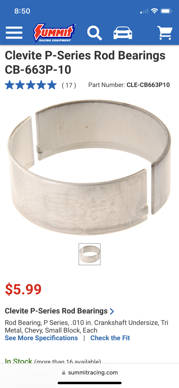

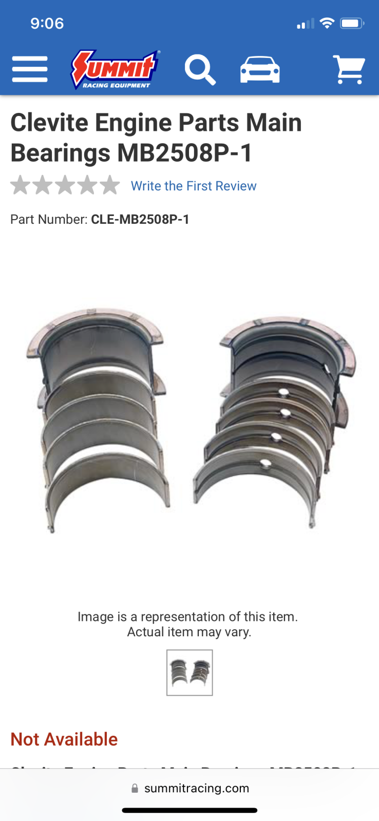

    .010 .010 is what I come up with. Main only has a 1 not follow by a zero per other vendors. D3EAFB18-5F41-4314-A1A3-CEF3D06C9409.png B3D876F9-257A-41CA-AF33-6F2E5FB0C2E7.png

  6. squirrel
    Joined: Sep 23, 2004
    Posts: 60,995
    squirrel
    Mike has you figured out...standard size, made almost 35 years ago.
    Always measure the crankshaft before ordering bearings.
    Also, if the other side of them still looks good, you can reuse them....it's a little known trick I use whenever I can.

  8. Johnny Gee
    Joined: Dec 3, 2009
    Posts: 15,002
    Johnny Gee
    from Downey, Ca
    That’s what I get. Stupid search goes where it want’s when not paying attention.
