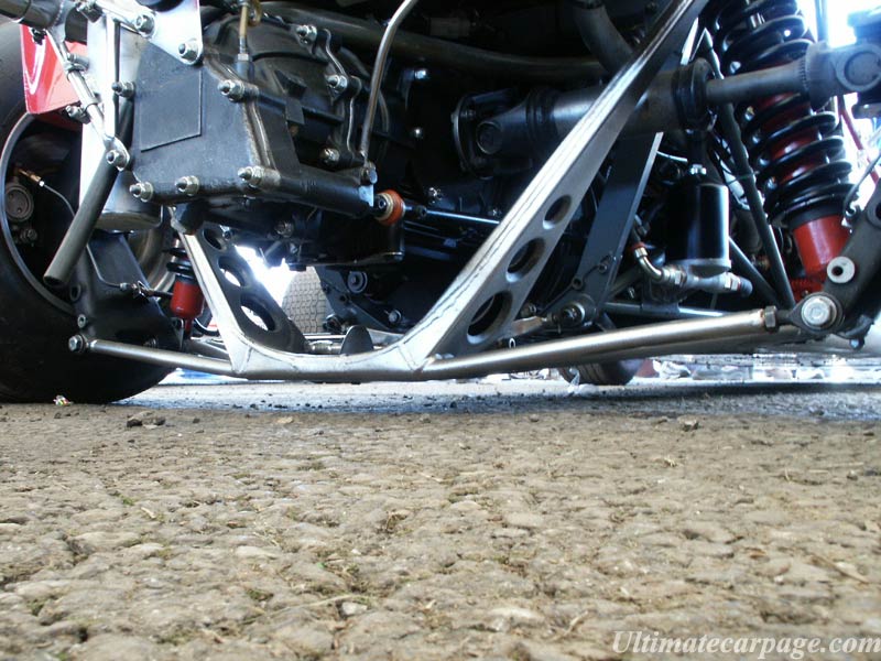

    Info from the 'net:
    "In a quest for maximum mechanical grip Colin Chapman designed the Lotus 58 F2 ch***is. It featured DeDion front and rear suspension to try and keep the wide tyres in vertical contact with the track. The 58 was furthermore equipped with a revolutionary four-pedal dual braking system."

    So that's just Chapman's pathetic attempt to replicate a Model T...
    That Alfetta yoke/locater arm almost IS an early Ford front end.

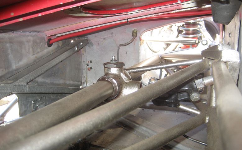

    Here's one being built in France by "Hispano", who has just joined us, using a Rover P6 axle:
