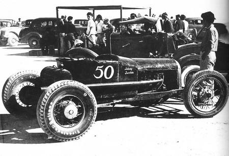

  7. When I hear the term "modified", this image pops into my head.
