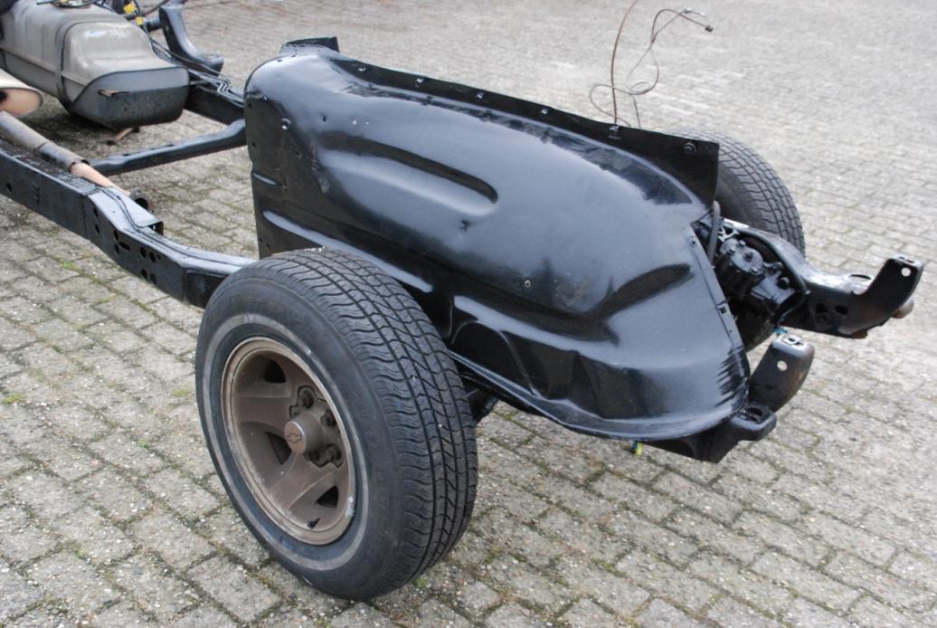

  3. I am interested as well, as I have a '36 lowcab that I would like to build as a shop truck, full fendered of co****. A bit of research showed the short S10 frame as a good match in wheelbase, my only concern being whether the front fenders would clear the upper control arms.

    my frame is ready for the backets next time i want to get my cab. and front fenders and start with welding the brackets on the ch***is..

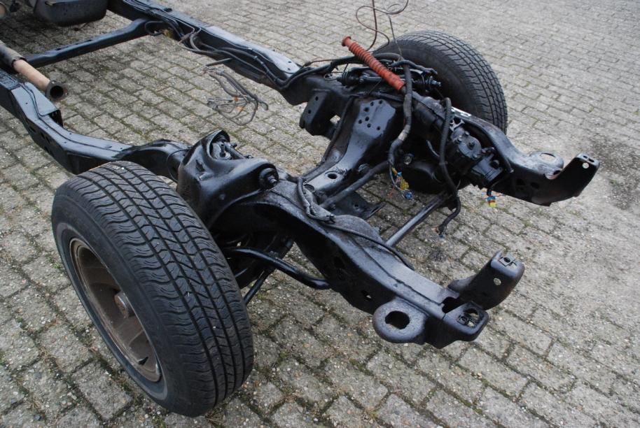

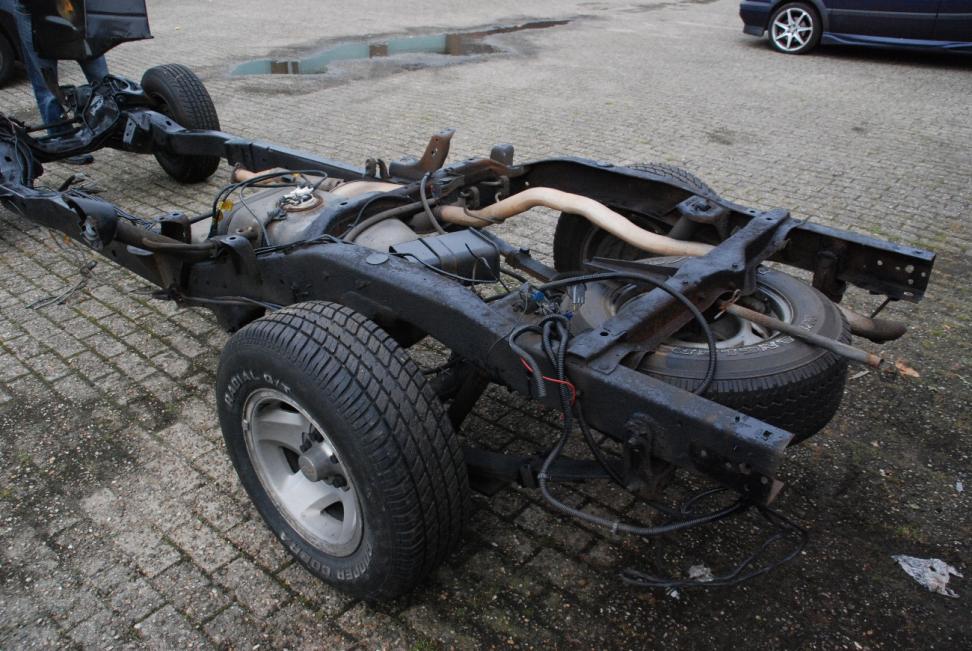

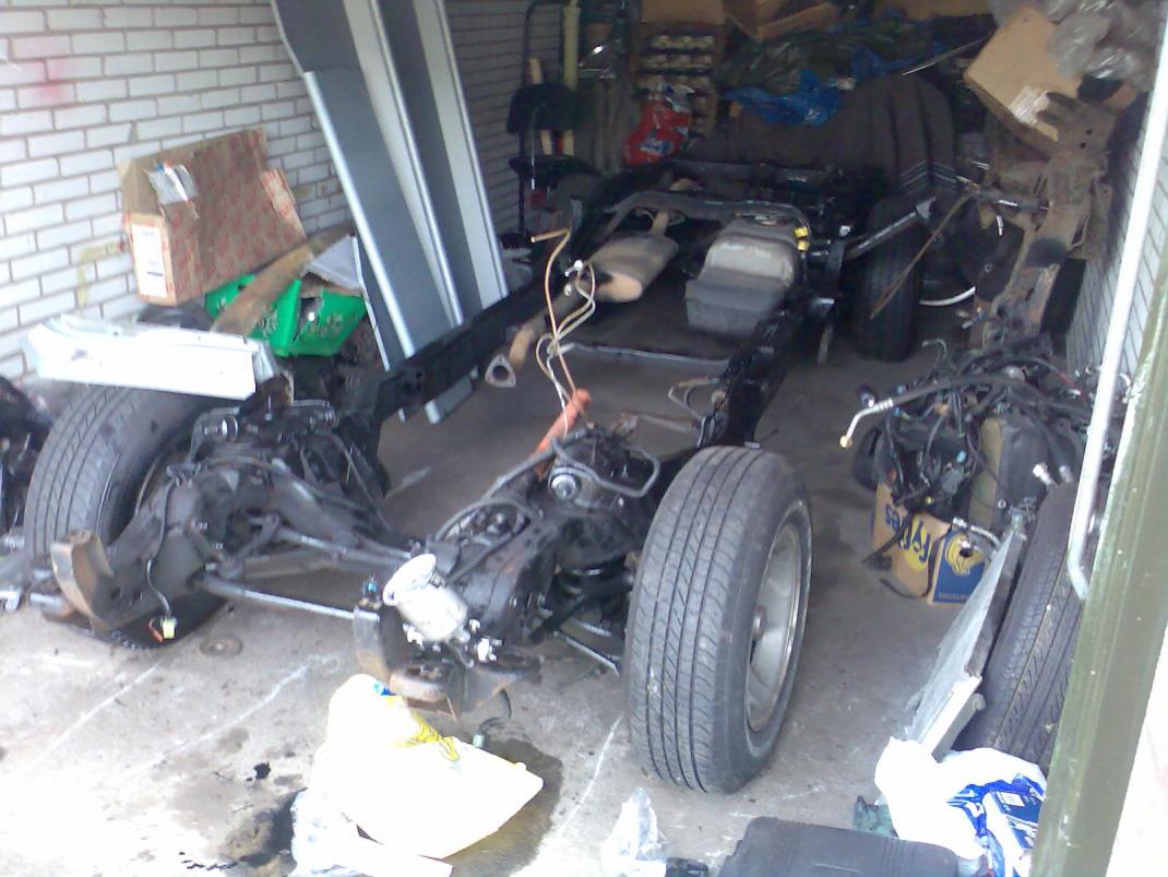

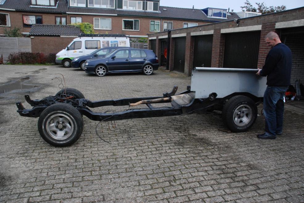

    here is a update from my S10 ch***is pictures..
    and now this pictures are taken last weekend
    frame-1.jpg frame-2.jpg frame-3.jpg frame-5.jpg frame-7.jpg frame-9.jpg frame-11.jpg
