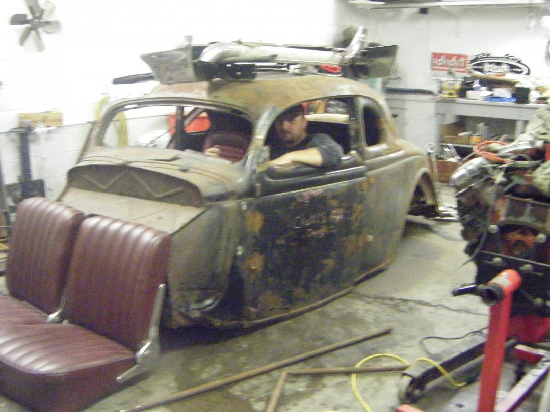

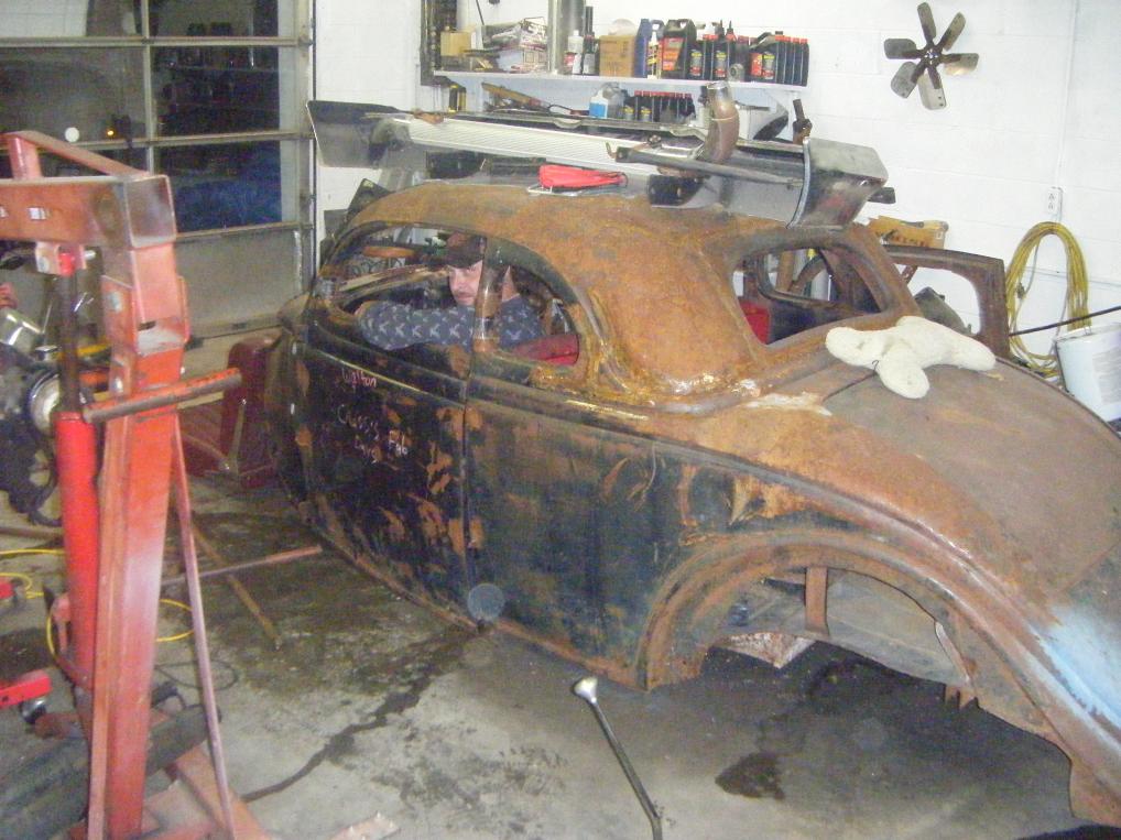

  22. I am doing an S-10 swap I havn't read about in this thread yet, I'm about stick my chopped 1935 Ford 5 window coupe on an 02' S-10 Extreme ch***is, 35 had a stock wheel base of 113" and the s10 is very close...
    and comes factory with dropped spindels, (optioned)two piston calipers up front, disc brake posi rear, dearched rear springs,big sway bars, quick steer box, and this will all be hiding under my fat fenders and running boards...I've been told by someone who has done it that the ford will sit on the ch***is with very little modifaction except to the rear floor area of the 35 will have to have reliefs 3"x8" cuts for the s-10 frame rails to come inside...
    I'm not tryin to build a traditional hotrod this time, I am doin this to have a daily driver I can go everywhere in, cross country ect...I want it to ride nice, have power accossories and be able to get parts at any parts store anywhere...I have a "spirited" 383 sbc and an artt carr 700 r4 trans for a powerplant...It will be rolling on a set of 17 x 9.5 and 17 x 8 american racing torque thrust II's
    I am aquireing the ch***is this week as the car awaits it donor ch***is in my shop bay now.
  23. Here's the car...pix didn't load I guess?

  26. the one in the coupe I'm sittin on is a bench bottom split back ford probably falcon or ranchero,
    the buckets in front of the coupe are 67 Jaguar XKE roadster seats...they need a good home, you interested?
