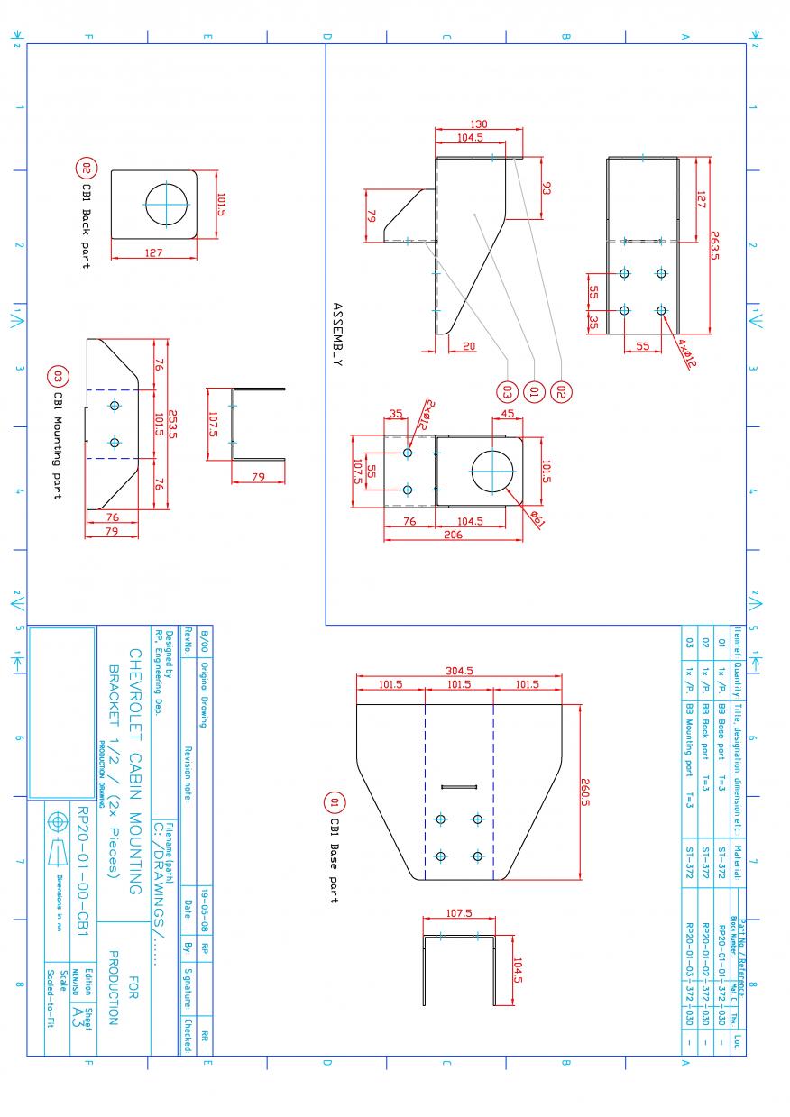

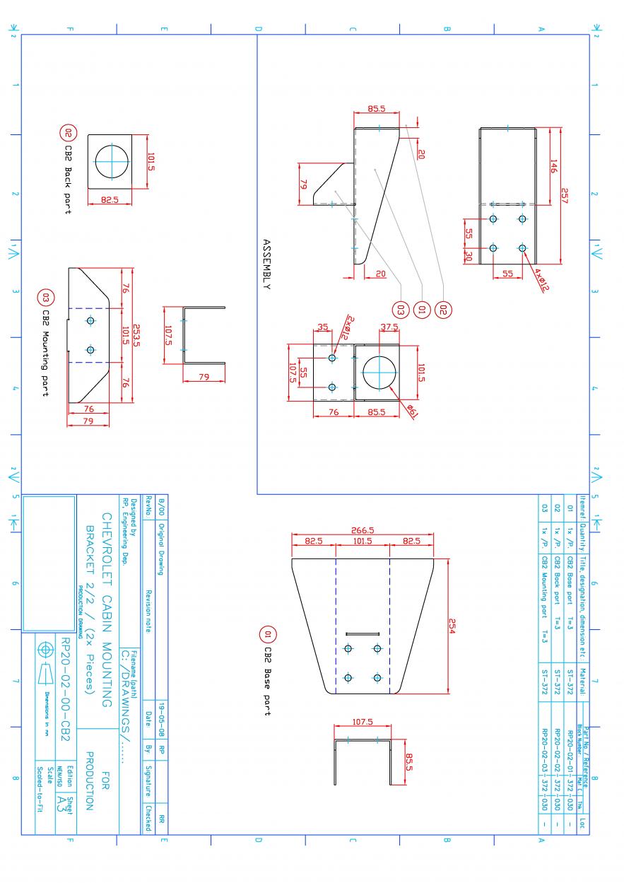

    and the drawing is coming for the engine mounts... :p

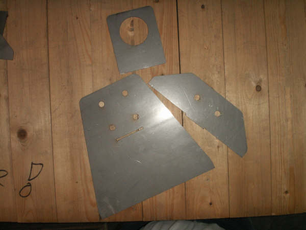

  23. bigtumtum
    Joined: Jul 2, 2008
    Posts: 658
    bigtumtum

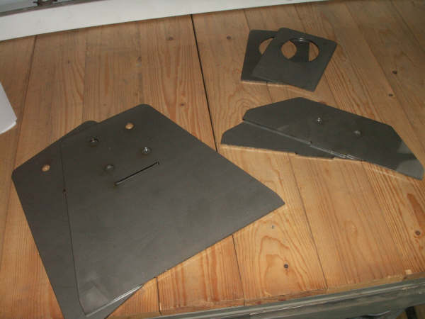

    here are some of the pics from my cab mounts they are stil in procces.. but they have lasercut them last week . and this week they are going trying to do the rest (tig welding)

  30. bigtumtum
    Joined: Jul 2, 2008
    Posts: 658
    bigtumtum

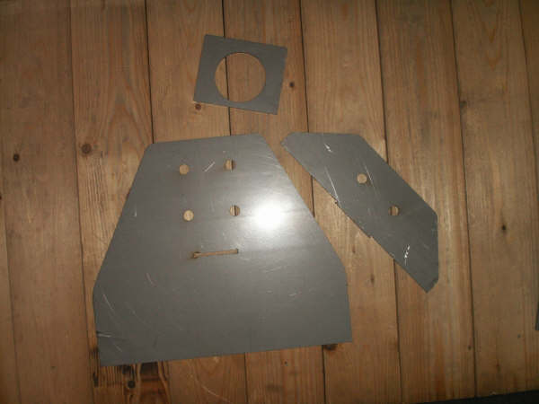

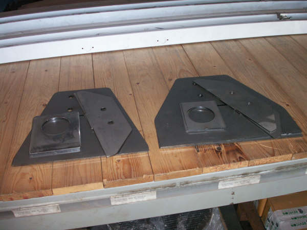

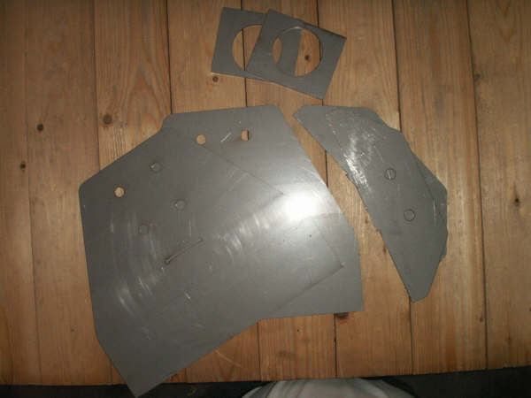

    Here is a update my buddy have send me the pictures today..
    the brackets are almost finish he is going to Tig-weld it this weekend..
