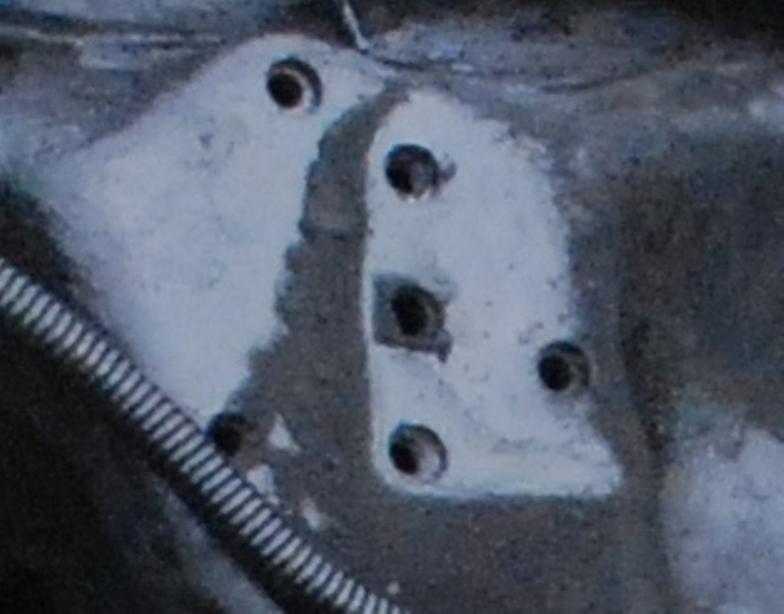

    I have a chevrolet s10 2wd 4cyl. frame i have got this kit :

  15. bigtumtum
    Joined: Jul 2, 2008
    Posts: 658
    bigtumtum
    yeah i can see that i dont have to worry about nuts because in my 96' its already welded....
    but the real different what i see is that i have 2 more holes..

  17. Haywood
    Joined: Feb 17, 2007
    Posts: 444
    Haywood
    from M'boro,TN
    Ok. I can see it better in that picture. I thought yours had a raised area. That must be road grime around where the 4-cylinder mount was.
    So everything else should be basically the same.
