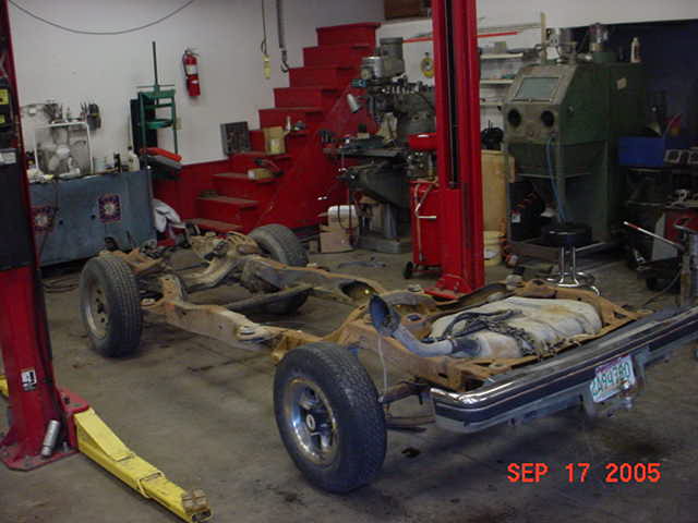

  8. monzadood
    Joined: Sep 10, 2006
    Posts: 1,032
    monzadood
    here is an image of the frame cut at the seam
  9. Abomination
    Joined: Oct 5, 2006
    Posts: 6,772
    Abomination
    Oh, f'n sweet!
    THIS is the kind of thing you don't see very often online - real pics of the actual swap in progress. Lots of talk about that seam, but not many pics out there... especially ones like that!
    ~Jason

  27. monzadood
    Posts: 1,032
    monzadood
    these frames are a breeze to separate
  28. Abomination
    Joined: Oct 5, 2006
    Posts: 6,772
    Abomination
    Oh, sweet!
    I have a fondness for pics like this. It helps to have as a point of reference when getting everything straight before a build.
    ~Jason
