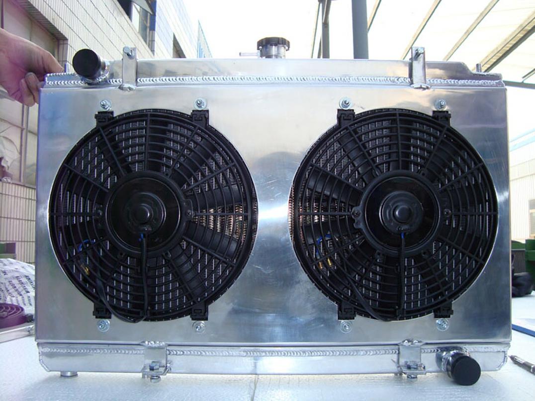

  12. bigtumtum
    Joined: Jul 2, 2008
    Posts: 658
    bigtumtum
    it would be super if someone can tell me the dimensions of a radiator what would fit... so i can go to a junkyard and ask them for sompthing in that size maybe from a european car like example a ford sierra :D :(
    or a peugeot 309
    [​IMG]:D:D:D:D:D:D

    Yeah, but many times those guys want your minimum order to be 100 units. There's a way around it if you pose as a large business, and order a "sample" after leading them on to believe you're interested in importing some... but these guys do not usually sell onseie-twosie. I'm not big enough to play in their court. ;)
    ~Jason
  23. bigtumtum
    Joined: Jul 2, 2008
    Posts: 658
    bigtumtum
    Jason you read my mind im already talking to one...
    and i was for 5year a dirtbike/motorbike importer so i know my way in yongkang and wuyi city.. :D still have contacts there..
    the company tell me the radiator costs around 120$ (custom made)
