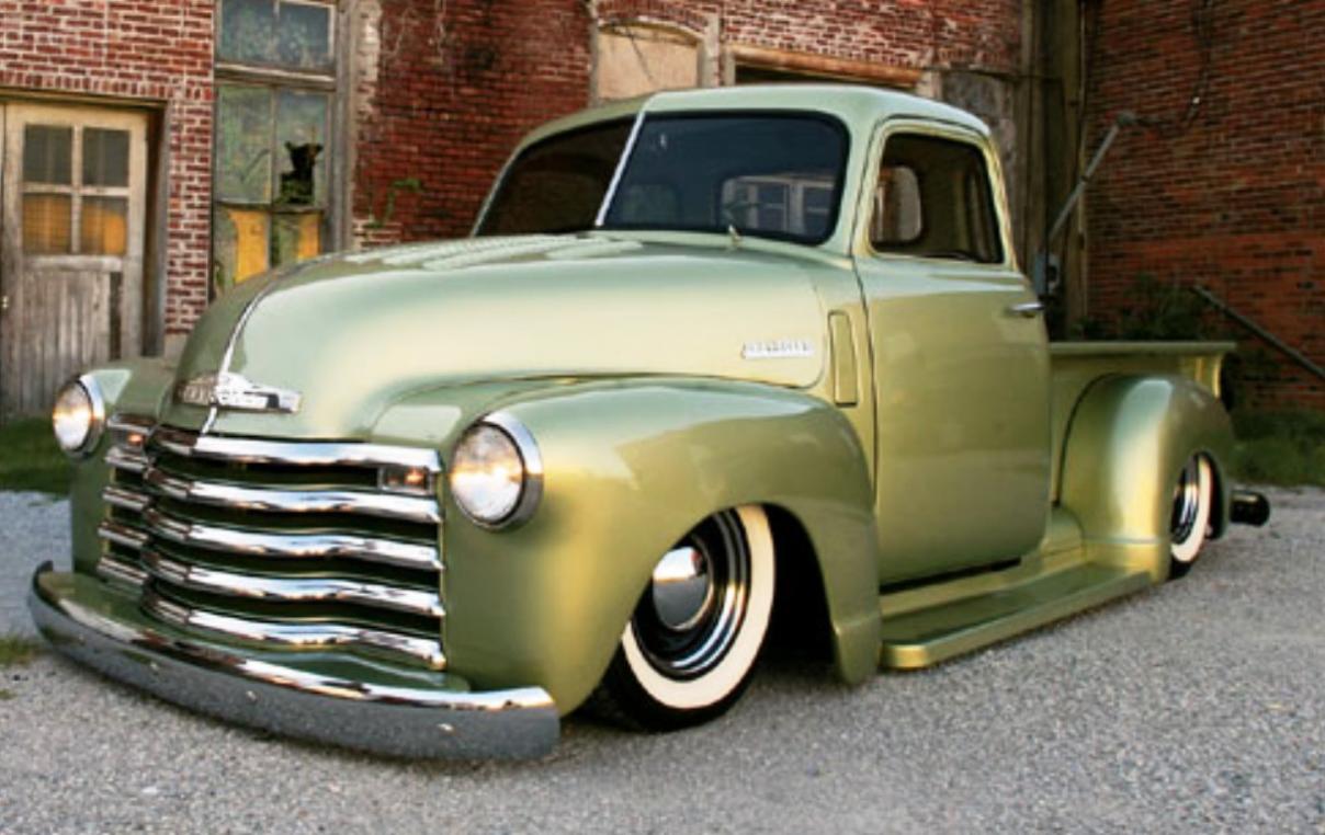

    is that your truck??
    that's bad ***!!
  3. bigtumtum
    Joined: Jul 2, 2008
    Posts: 658
    bigtumtum
    i realy realy wish it was but its from the magazine cl***ictrucks.com
  4. Abomination
    Joined: Oct 5, 2006
    Posts: 6,773
    Abomination
    No, but I'll sell it to you for $7,000.
    I also have this for sale...
    Just kidding. :D LOL!
    ~Jason
  5. bigtumtum
    Joined: Jul 2, 2008
    Posts: 658
    bigtumtum
    its a deal!!!! i will come and give you 7000,- and you give me that truck :D
