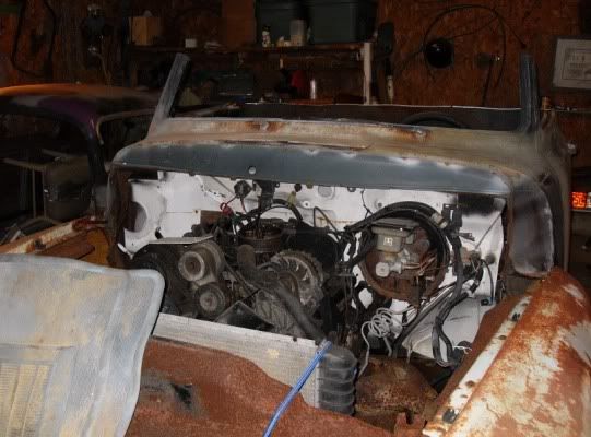

    Picture of the stock S-10 firewall spliced into the '54 Ford cab. It has some gaps. Its a roadster, so it'll be loud, windy, and leaky anyway. Not too ugly once the heater box is gone. And yes, I'm definetly running a hood.
