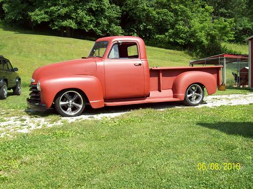

    This is my AD on the S-10

    Ilguy that looks great!!! what wheels did you use there? 2wd or 4wd offset and did you use spacers? whats in it for a power plant, ****** and rear end? Spill the beans my friend. Im in the middle of setting up my rig.

    Fiddy-Tree. They are 18" wheels and I did have to space them a bit to get it to look better. It is a blazer rear. I have a 350/700R4 combo in it.

    Are they 2wd or 4 wd offset on the rims? what size spacer did you go with?
    Im just curious as im am almost at the wheel and tire stage of my build. Thanks and it looks awesome buddy.

    2wd. I think there is .75 in the front and 1.25 in the rear. Did you notice that it is a long box as well....Didnt start life as that. Used the longer S10 frame and rolled with it instead of chopping the frame

    well now that you mention it....... looks good.
    I built a 327 for mine with a 700r4 behind it. Blazer rearend with a 4 link coilover set up. do you have build pics as well?
