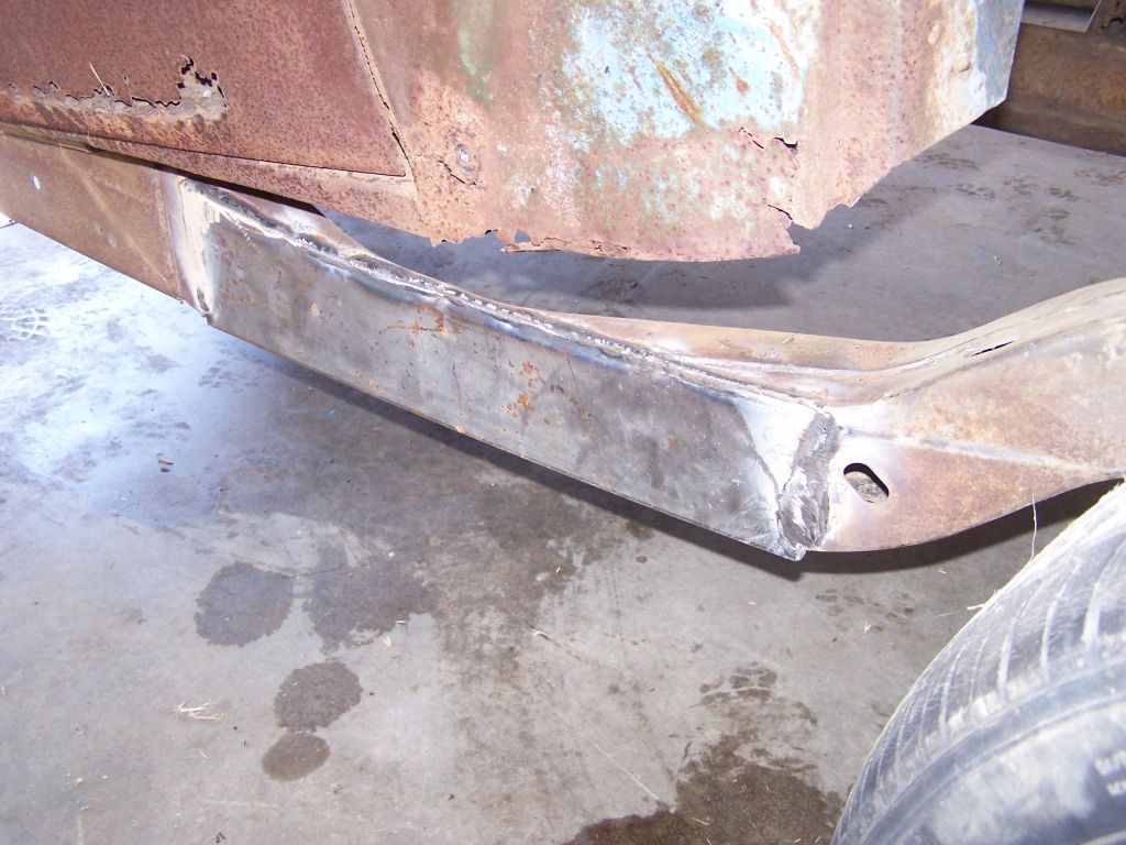

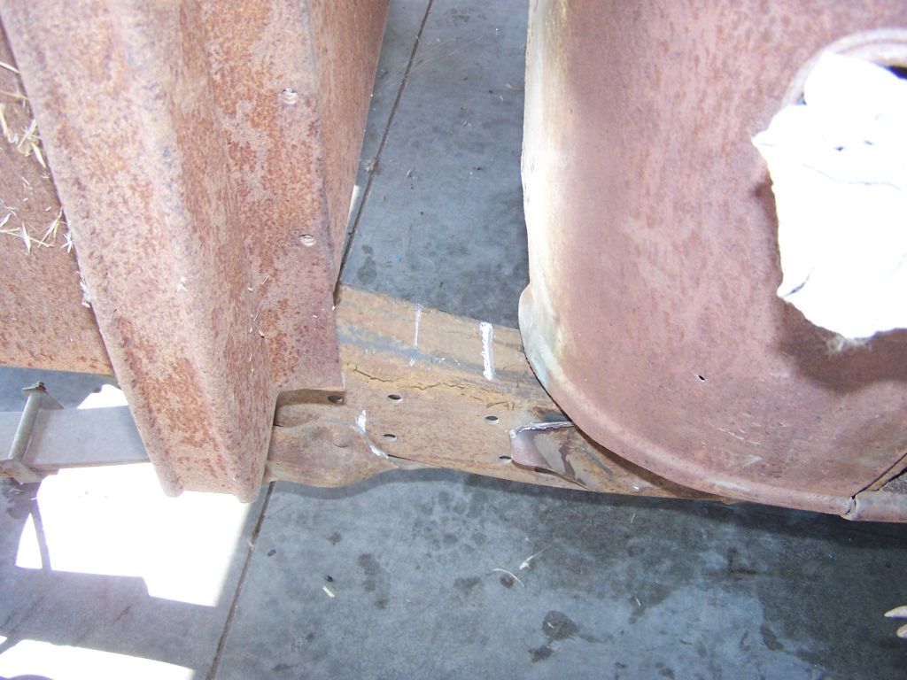

  10. Novadude55
    Joined: Nov 10, 2009
    Posts: 2,353
    Novadude55
    from CA
    I looked earlier today, and here is what I found, on my 41 I have about 6-7 inches between the steering box and the front edge of the fender,, see pics
    I am guessing your 37 must have a shorter fender than mine, I plan on moving the body back to the lighter white line in the third pic, which is only 2-3 inches, I have close to 10 inches to play with as you can see in the 1st pic.
