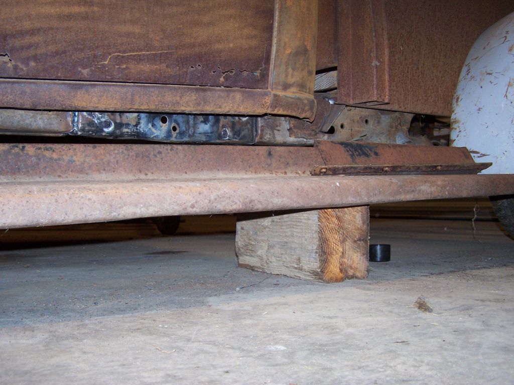

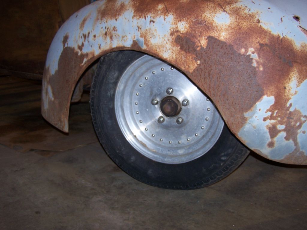

    I found out while mocking up the front fenders that I have big truck fenders instead of half ton fenders. This means I will be looking for half ton fenders. The big truck fenders dont line up with the half ton running boards. Check the pics,, I thot all the fenders from 1/2 to 2 ton were the same,, not so.
    the grey primered fenders are the correct 1/2 ton fenders and running boards on my stock truck. Both need work i admit, I was working on the stock one but then one of my kid has a nova race car, another son has a camaro race car, and they wanted to build me another nova, but i chose to hot rod another 41 truck ..
