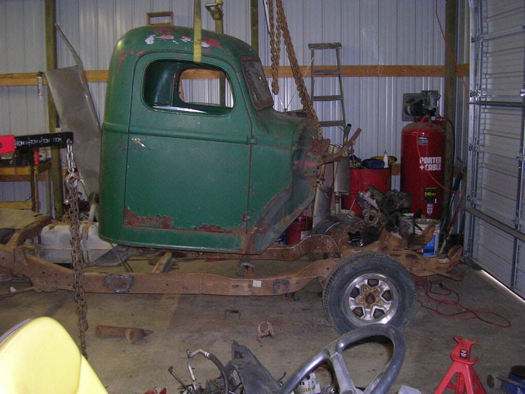

    I love this thread- Been waiting for it.
    I built a V8 s10 ('84 model- ext cab), and was going to sell it, but I knew I couldn't get my investment back. My dad happened to have a '41 chevy 1/2 ton body(actually, 2 cabs and almost enough to build 2 trucks) and suggested I just swap the bodies.
    He's giving me the 41- and I'm giving the s10 body to a guy that's gonna help me build mounts and get the 41 lined up on the s10 frame. I know the frame's too long- but I'll either shorten it, or stretch the bed and running boards (unless I find a 3/4 ton bed/running boards, which is about the perfect length for the ext cab s10).
    I'm sure some info on this thread will be helpful- and I'll try to do***ent my build and share it, when I get started.
