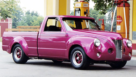

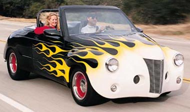

  30. Abomination
    Joined: Oct 5, 2006
    Posts: 6,772
    Abomination
    These guys were way ahead of you, man...
    Here's the link: http://www.rodster.com/
    I'm not a big fan, but they are out there, and some people really like 'em. Here's some pics, so you too can be all like, "Dude, WTF?"
    It's the roofline that kills it. Lose the roof and shave the handles/add old-style ones and it gets better. Kind of.
