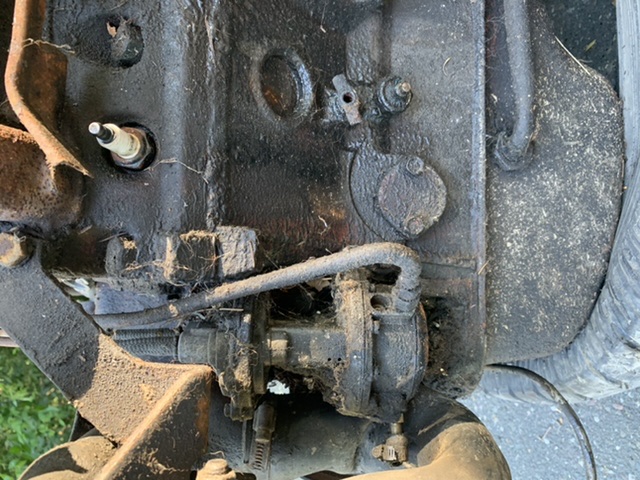

  9. 41 GMC K-18
    Joined: Jun 27, 2019
    Posts: 5,455
    41 GMC K-18
    You know, purely for the sake of entertainment, and to illustrate the amount of gunk and oil and what ever is on your engine, a few good shots of the engine from different angles, would really be interesting to see just how much excess residue there is, that you are trying to get off of the engine. How ever, there is the consideration of the " nah I don't want to show you all, how dirty and oily this engine is " factor, which is totally understandable!
    But that being said, come on and humor us and show us the engine, gunk and all please !

  11. 1930artdeco
    Joined: Oct 25, 2011
    Posts: 736
    1930artdeco
    from Lynden, Wa
    Sorry about that. The water would run straight towards a creek and I want to keep it out of that. Most of the grease/sludge/oil is on the left side of the block (Y block). I think cardboard may be the best option in the kiddie pool no less. So I get containment and soaking abilities.:) I am sure there have been worse coatings of oil, just trying to not make a mess.
    mime

  20. wraymen
    Joined: Jan 13, 2011
    Posts: 7,372
    wraymen
    The gunk on that engine doesn't look so bad. I brought home an FE once that looked like a giant chocolate turtle candy.
