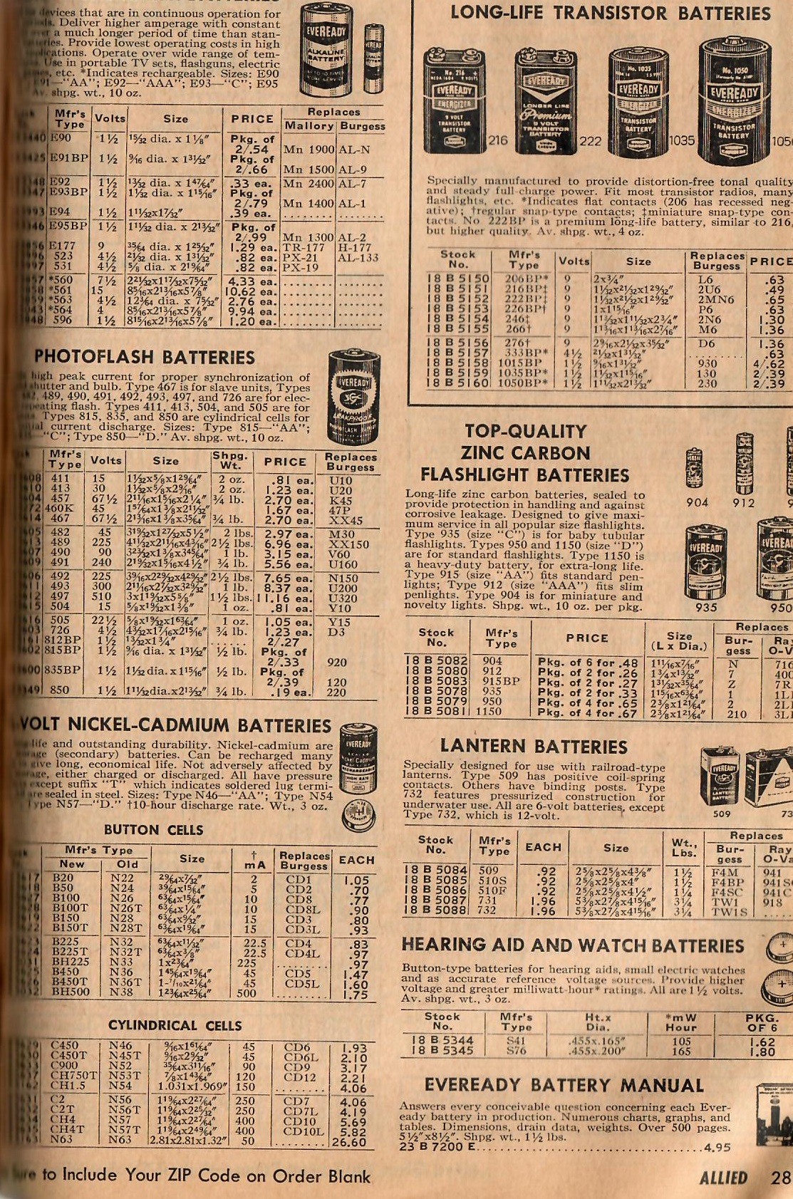

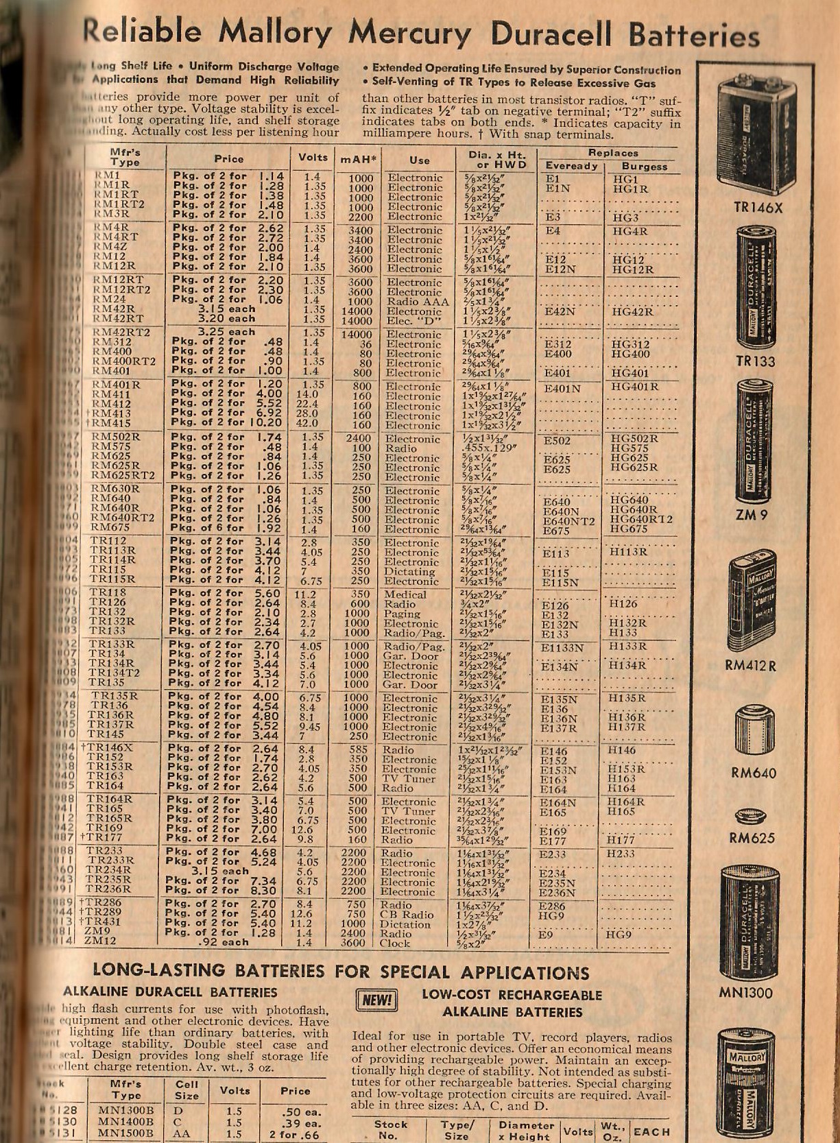

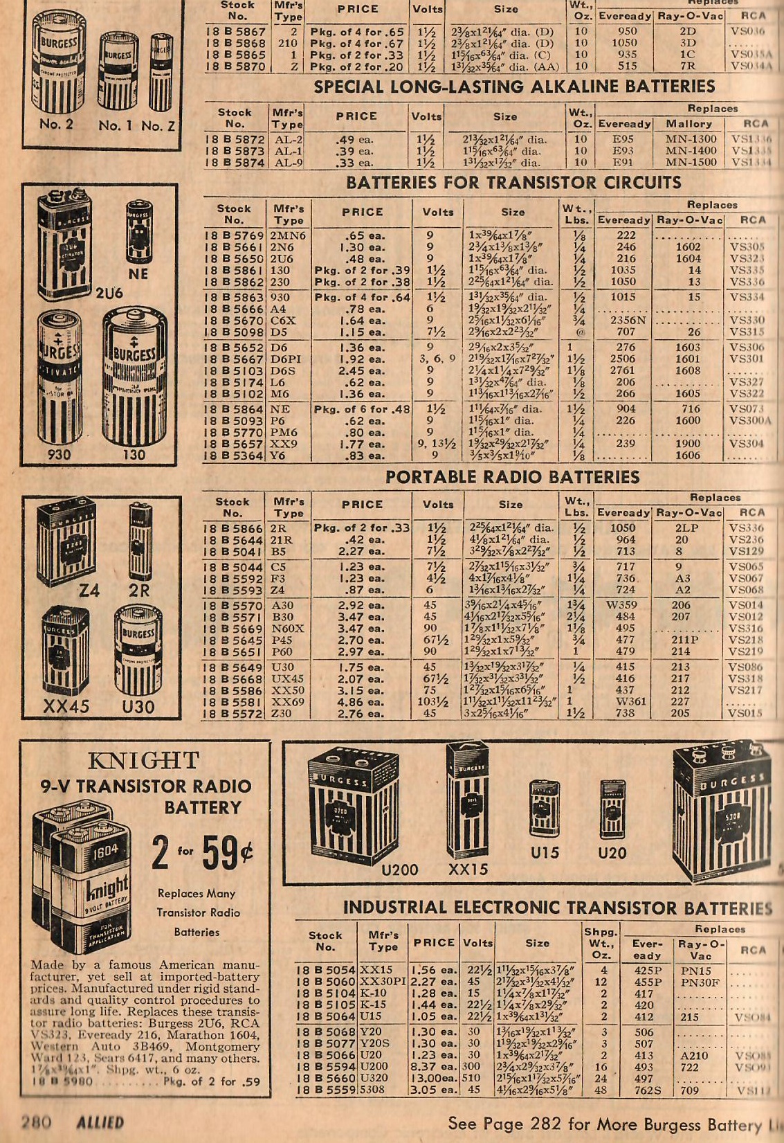

    bat02.jpg bat01.jpg ...and just for fun, here are a few of the battery sizes that were available for electronic stuff in the late 1960s.
