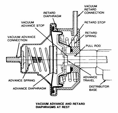

  7. RodStRace
    Joined: Dec 7, 2007
    Posts: 9,335
    RodStRace
    Here's a cutaway of a can. Ignore the retard function, and you can see the front spring tension is adjusted. No need to hack up old parts.
    Deuces likes this.

  10. RodStRace
    Joined: Dec 7, 2007
    Posts: 9,335
    RodStRace
    It was already labeled that way, had to use the same term.:oops:
    It was the only good image I found quickly, and had to save it and upload already. Guess I should have edited it.
    Just trying to save a part from destructive curiosity. We've all been there, right?
