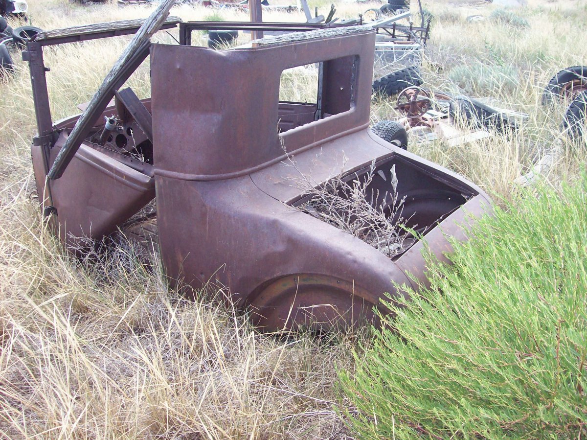

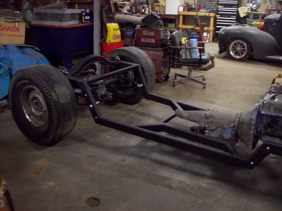

    Model A frame. I Z'd the hell out of it!

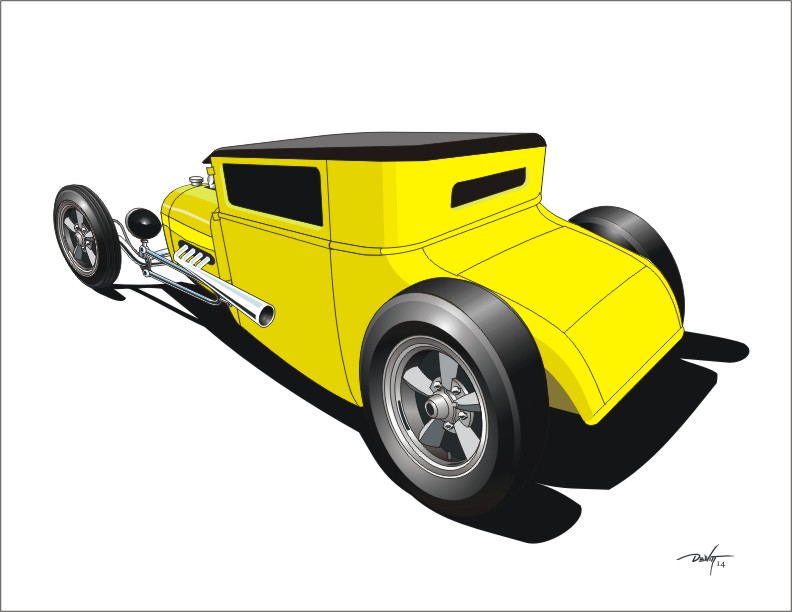

    Jimmy B, kiwijeff and verde742 like this.
  6. 56 Dodge Pickup
    Joined: Jul 1, 2009
    Posts: 1,837
    56 Dodge Pickup
    I'm in I love to build the different stuff that's what makes this hobby so cool. Man that pic is cool wish I could draw one for the 37 Plymouth I'm building subscribed ! Hobo Jim

  13. 31Dodger
    Joined: Mar 24, 2011
    Posts: 5,189
    31Dodger
    That door can be saved.
    117harv and fortypickup like this.
  14. fortypickup
    Joined: Aug 2, 2007
    Posts: 1,780
    fortypickup
    from Nebraska
    Yes it can...and yes it will be saved!

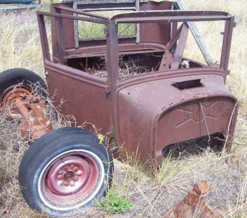

  15. Check out the red wheels, it must have been a Hot Rod once before...:D IMG_20161115_163336.png
    It's amazing how close these bodies look, to a Model T.
    I'm wondering why more don't get Hot Rodded.

    Found this ol Dodge B shell laying around! It weighs about 100 pounds LOL.

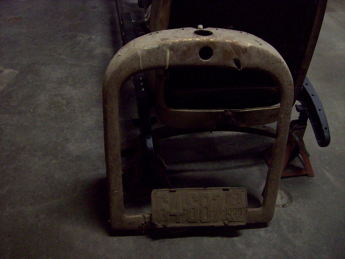

  23. Stogy
    Joined: Feb 10, 2007
    Posts: 27,395
    Stogy
    Much better than and a nice plate too...;)

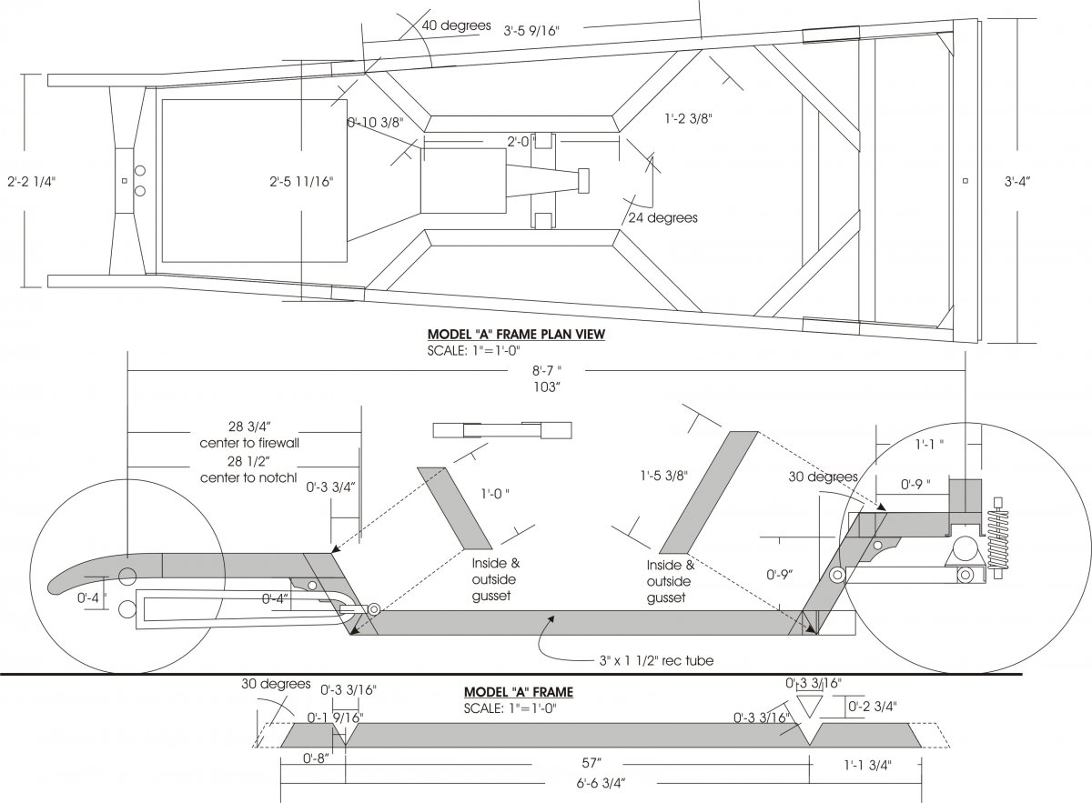

    Here is a few frame details and before and after pics
    a few details I drew prier to the build...Caution do not use these for your own build! LOL
    spurgeonforge and DylanHill1931 like this.

    A little history on this frame...
    My Dad welded 2 x 3 rec tube to model A front and rear cross member 30 years ago and i decided to resurrect it.
    Then I screwed it all up! LOL
    Before
    Mock up on the leveling table
    Cutting the frame

    If the transmission in the picture is the one you're going to use, it's a C4 not a C6
  28. fortypickup
    Joined: Aug 2, 2007
    Posts: 1,780
    fortypickup
    from Nebraska
    Good eye bud... the c4 is just for mockup
  29. 1930 A
    Joined: Apr 8, 2006
    Posts: 133
    1930 A
    The transmission mount looks like it's welded in and on a C6 its going to be further back.
