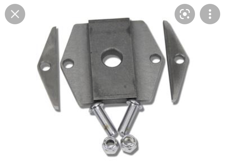

    AFD6D45A-B9A4-4C32-B0EC-4BE8617C677D.jpeg Maybe I have too much shiny stuff down low to be a rat rod! I am not familiar with the rat rod requirements.
