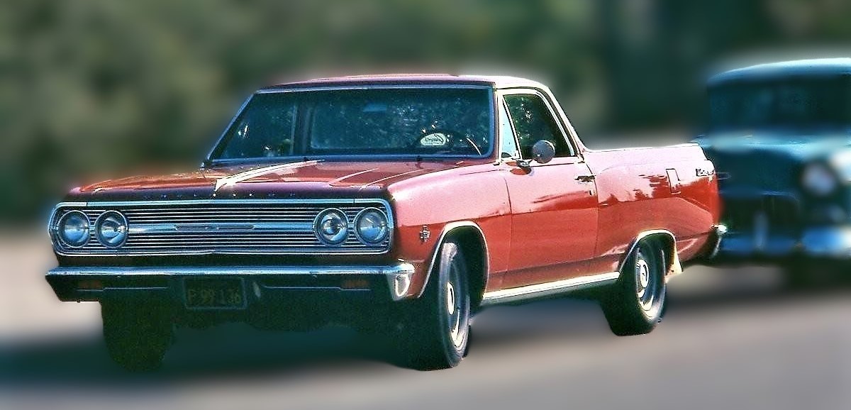

    All of our cars, the Flathead 40 Ford Sedan Delivery, the 65 El Camino (two sets of tires,) and our 327 powered 40 Ford Sedan Delivery all had the tire shaving done and then a great balancing + wheel alignment. Out of the 4 cars, the 327 powered sedan delivery was a project car and needed more extensive front end work and safety protocols. The El Camino had new wider tires and it too had the shakes, so a pile of rubber later, our front end spe******t took the balance and alignment to a total of 50k miles before another set was done.
