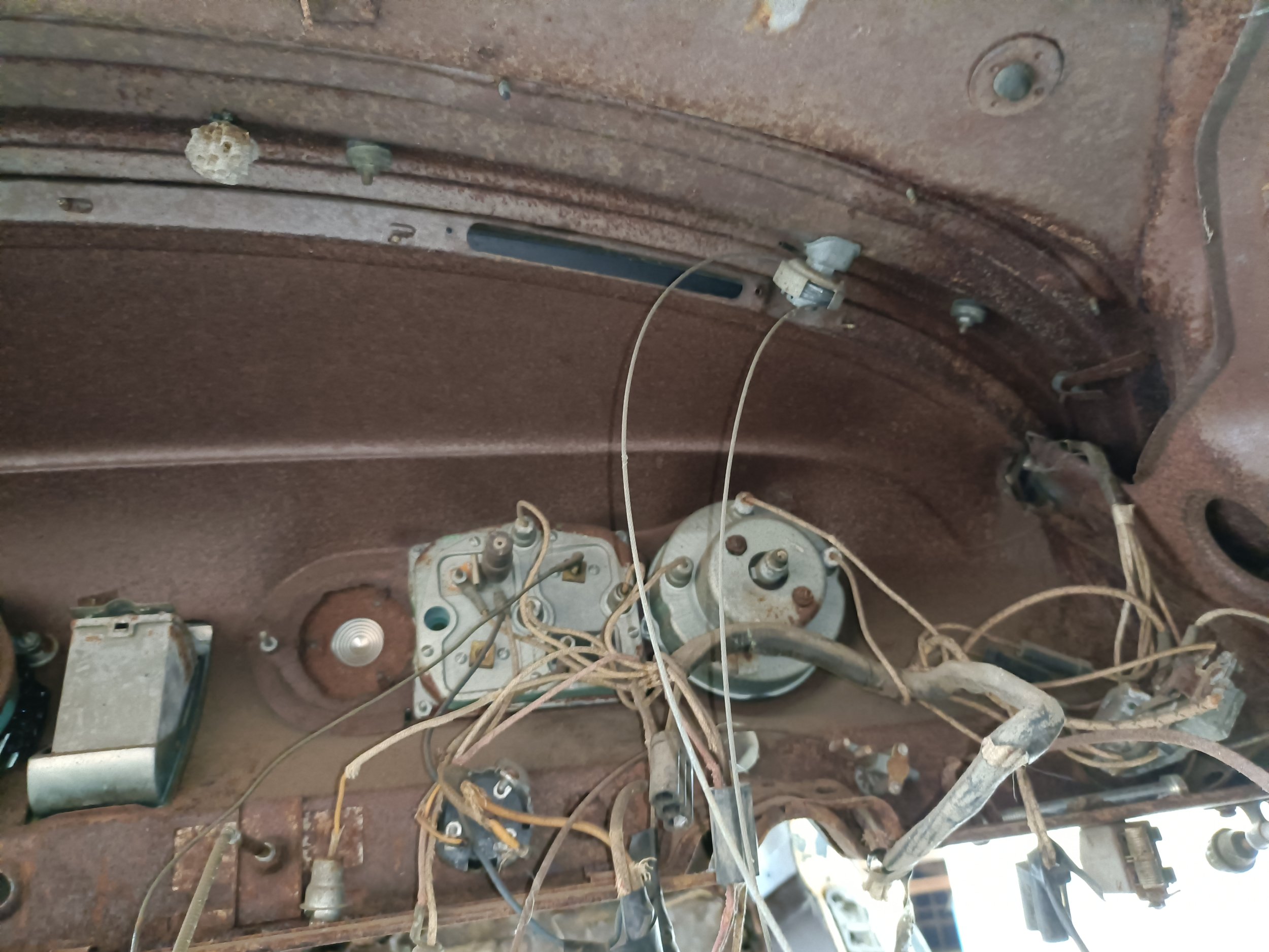

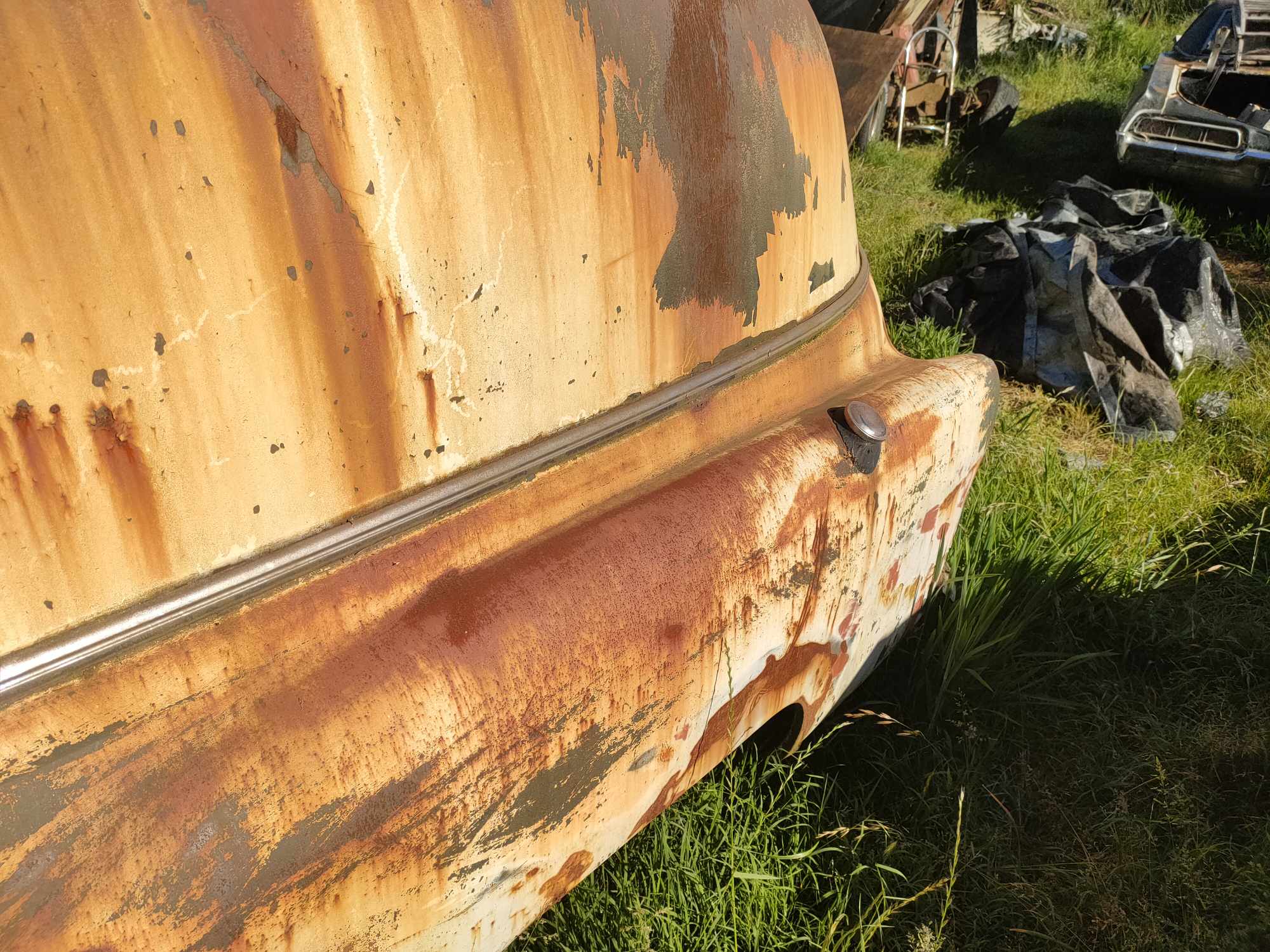

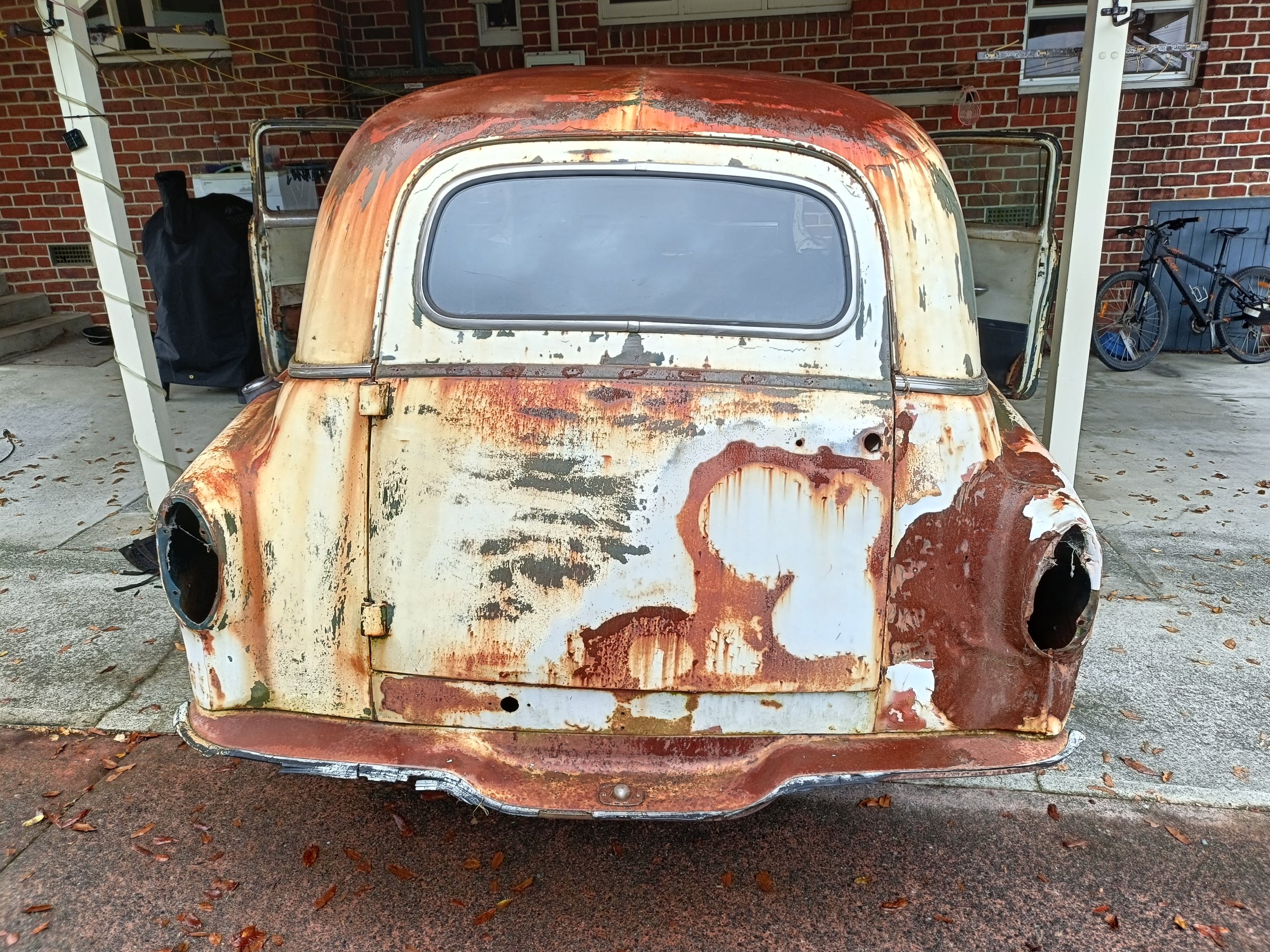

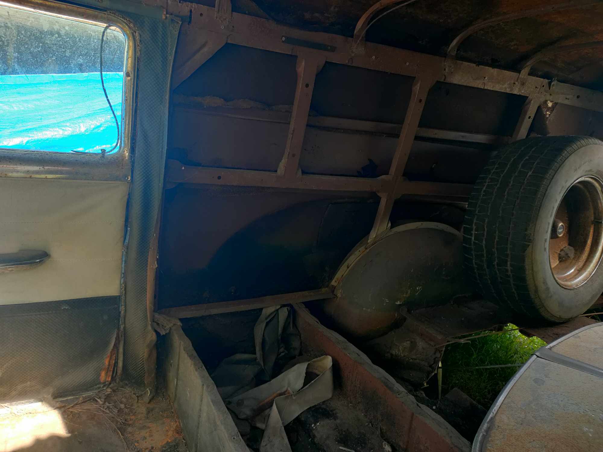

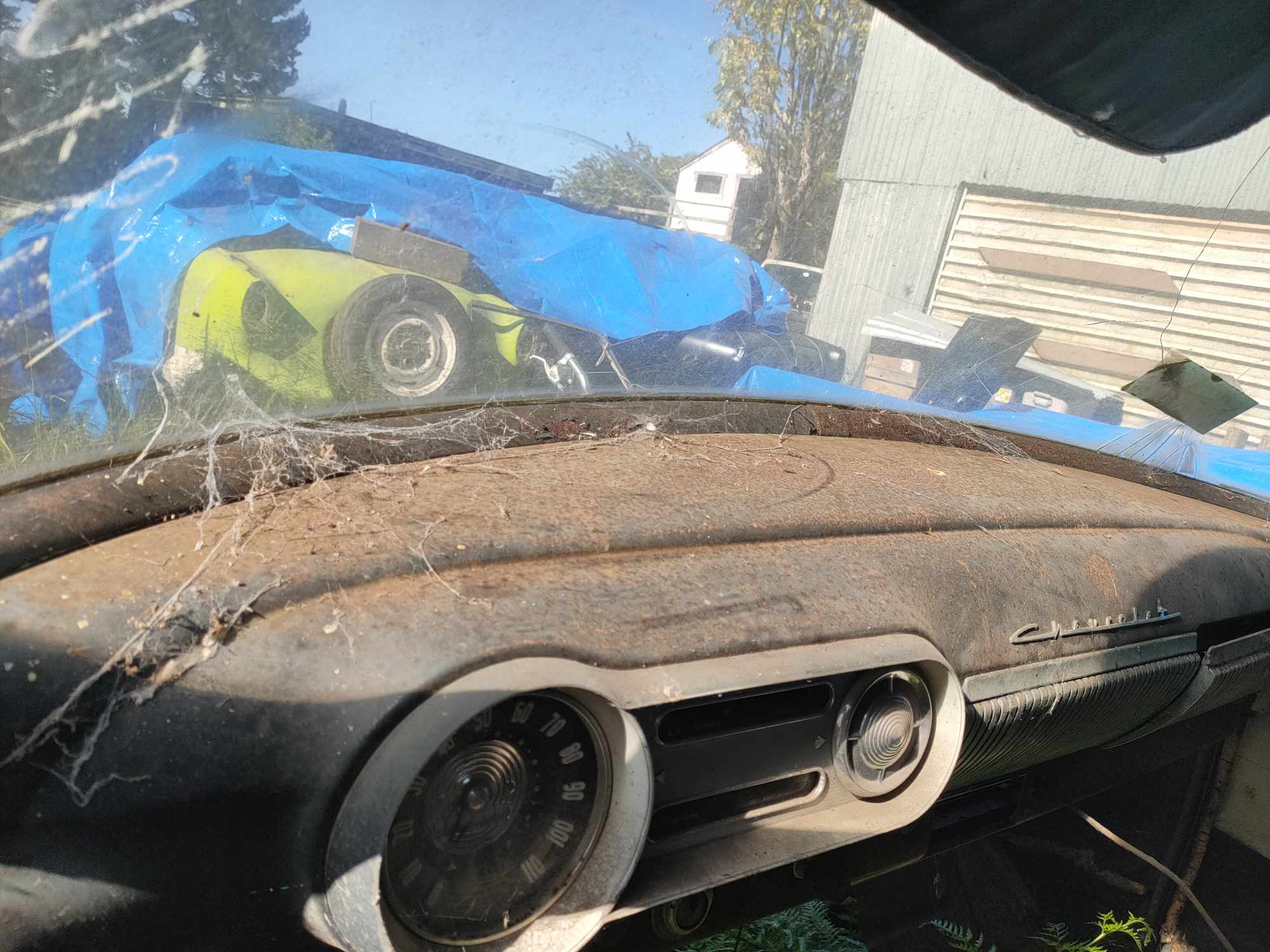

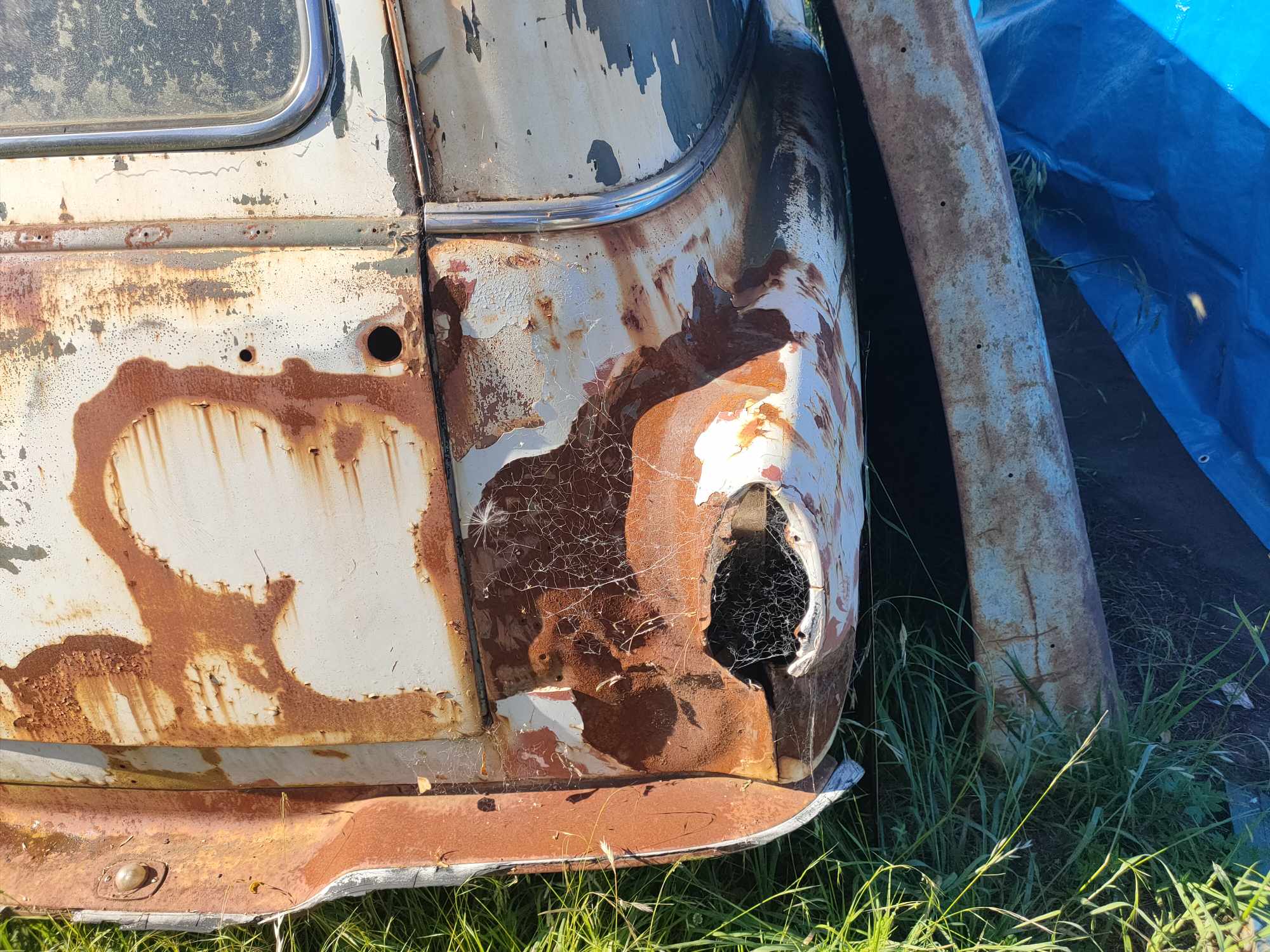

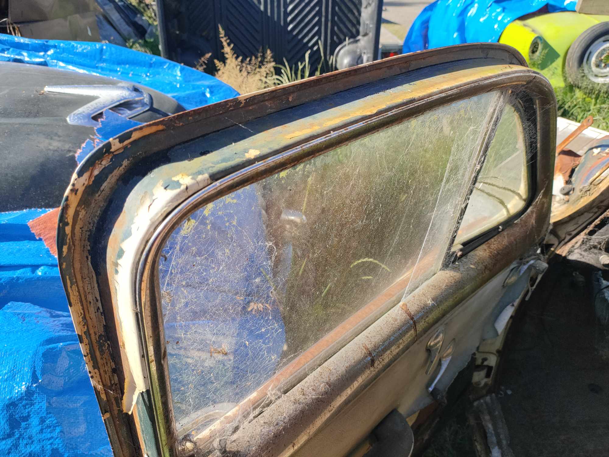

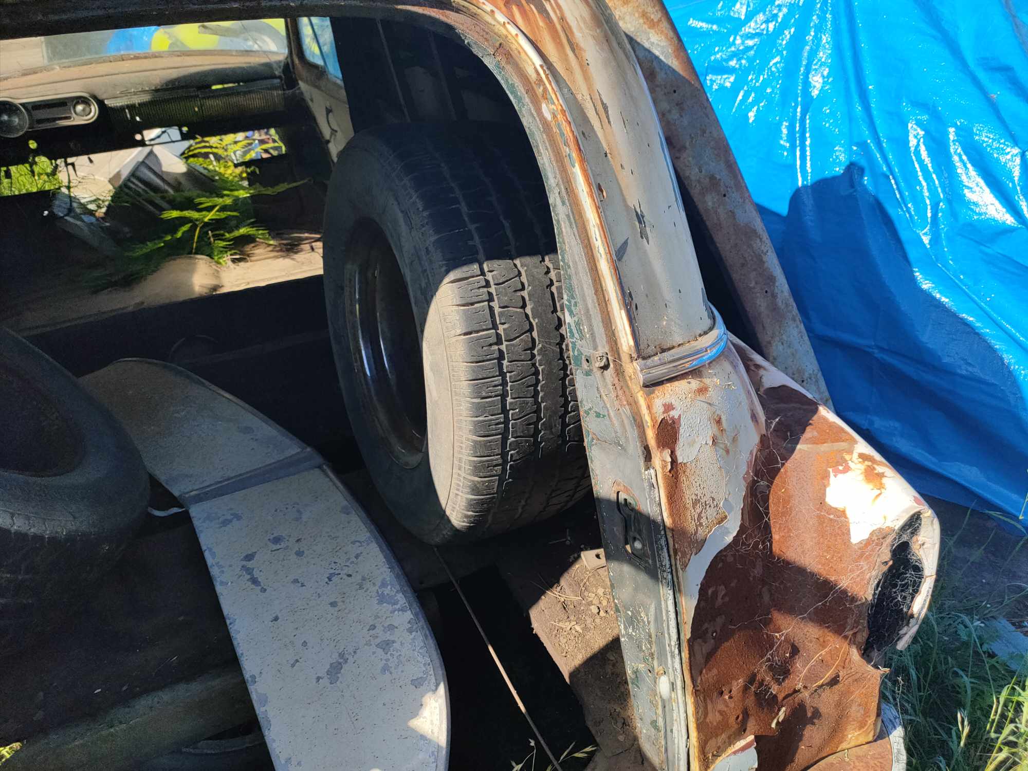

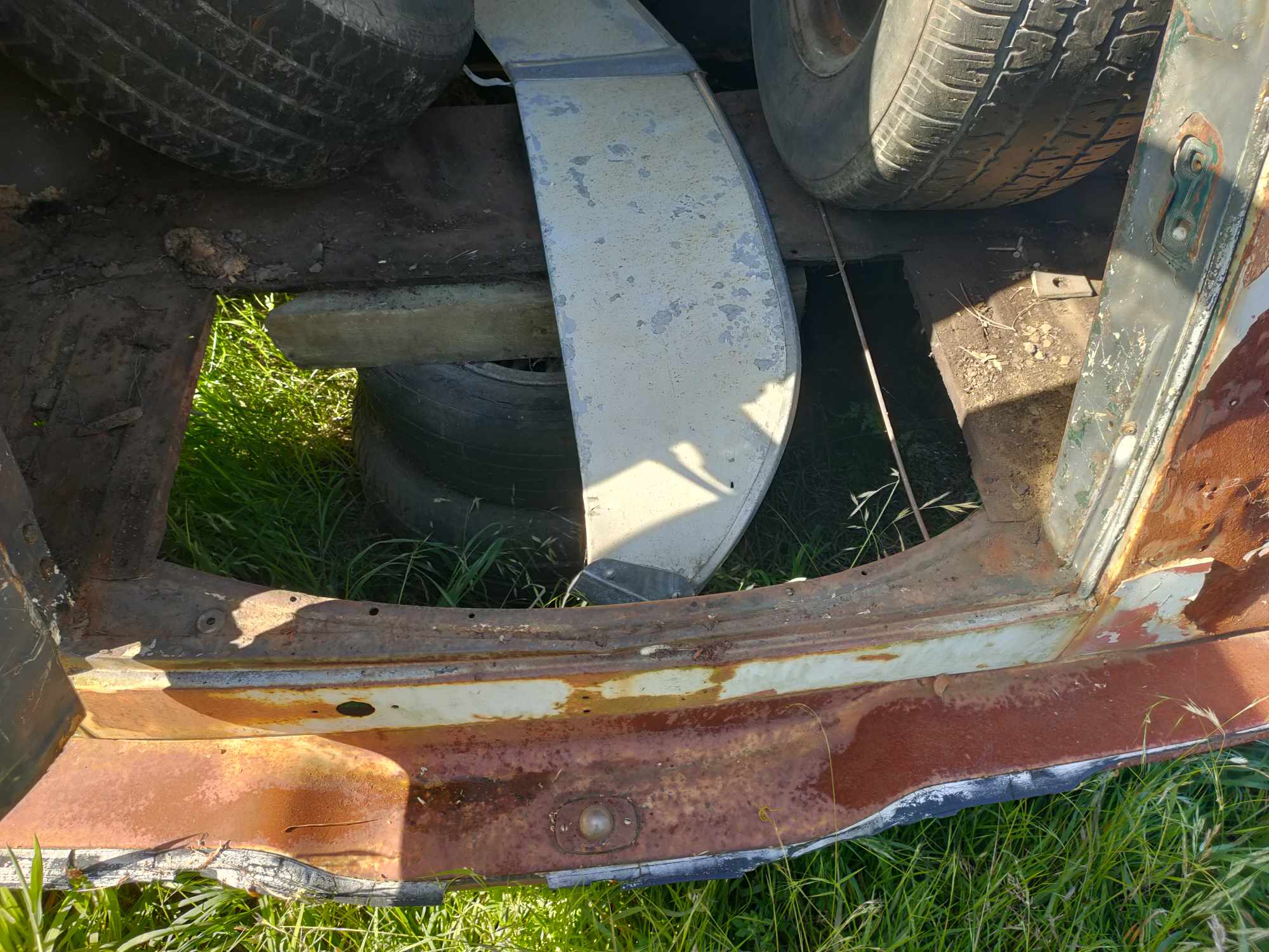

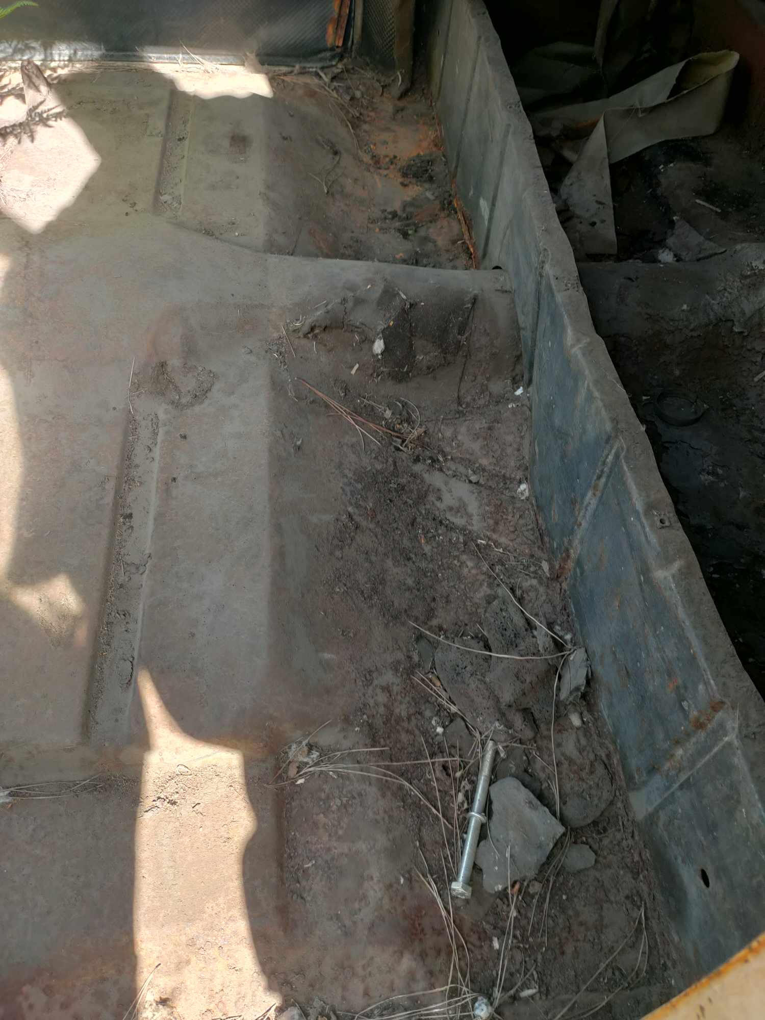

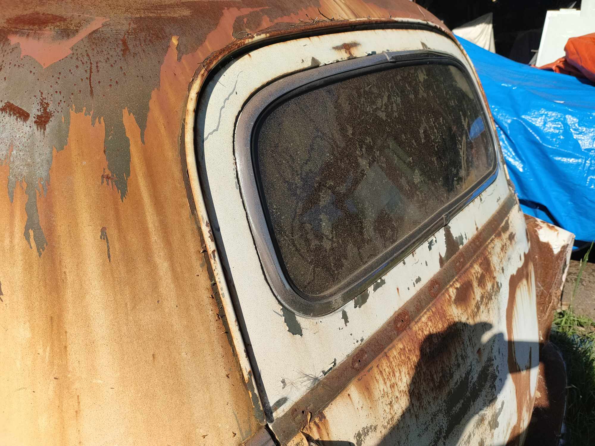

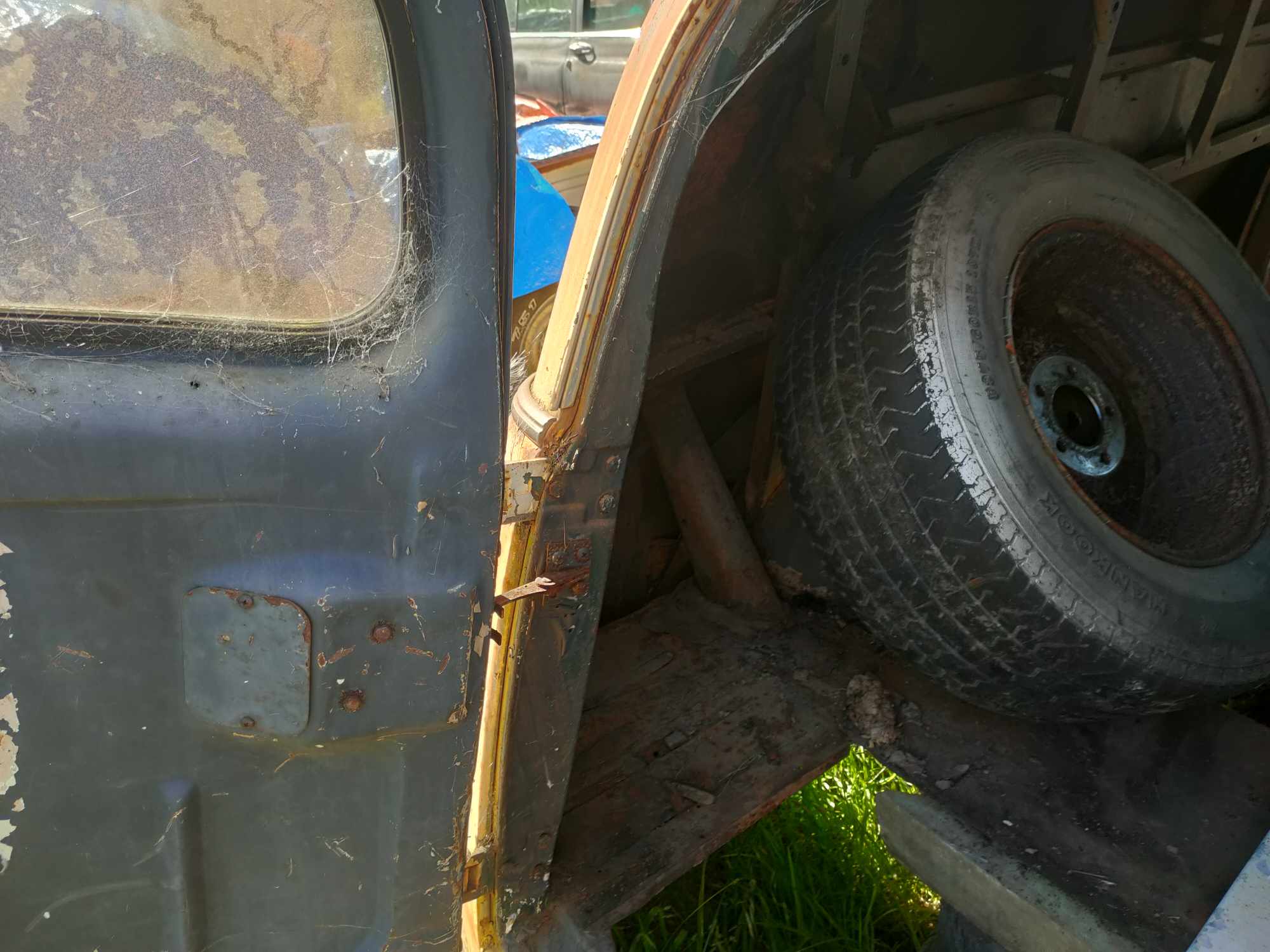

    A couple of years back we embarked on the build of a 1953 Chevrolet 150 business coupe that someone at the opposite end of the country (NZ) had started. Full credit to them, the work was all pretty damn good, making my life easier. Today was our last certification inspection so next is to make it legal with the govt. Any who.....short story long, I have bought another 53, this time a delivery, in not such great condition. We are going for a 6 hour drive on Wednesday to pick it up.
    These are the pics I have of it at this stage. IMG_20241207_182555.jpg IMG_20241204_085634.jpg IMG_20241204_085616.jpg IMG_20241204_085543.jpg

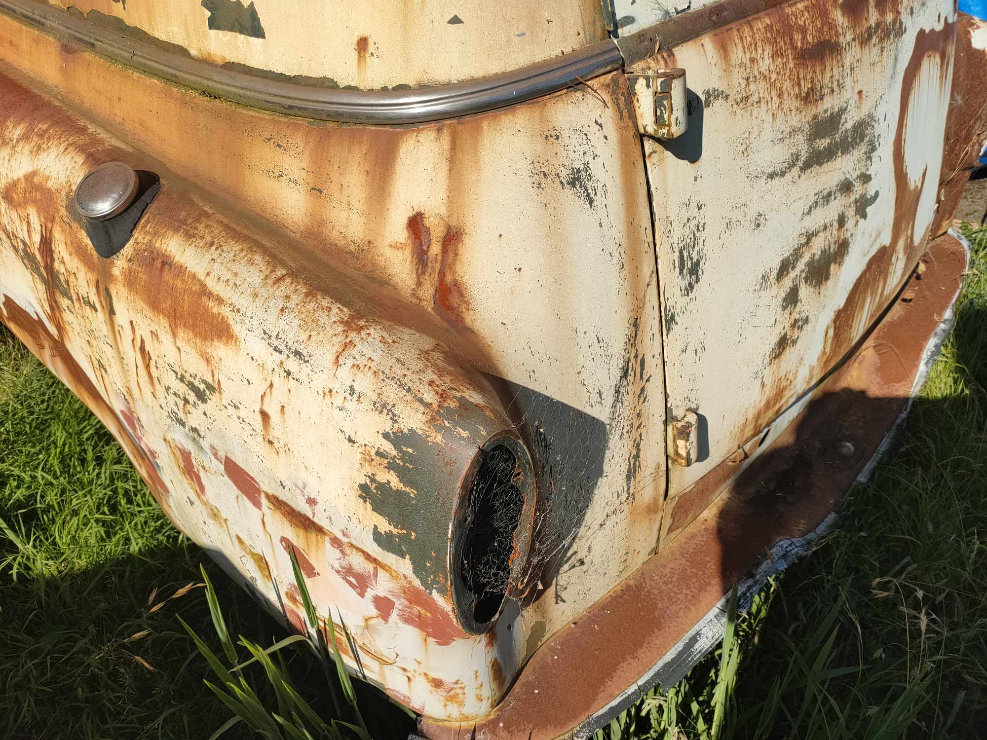

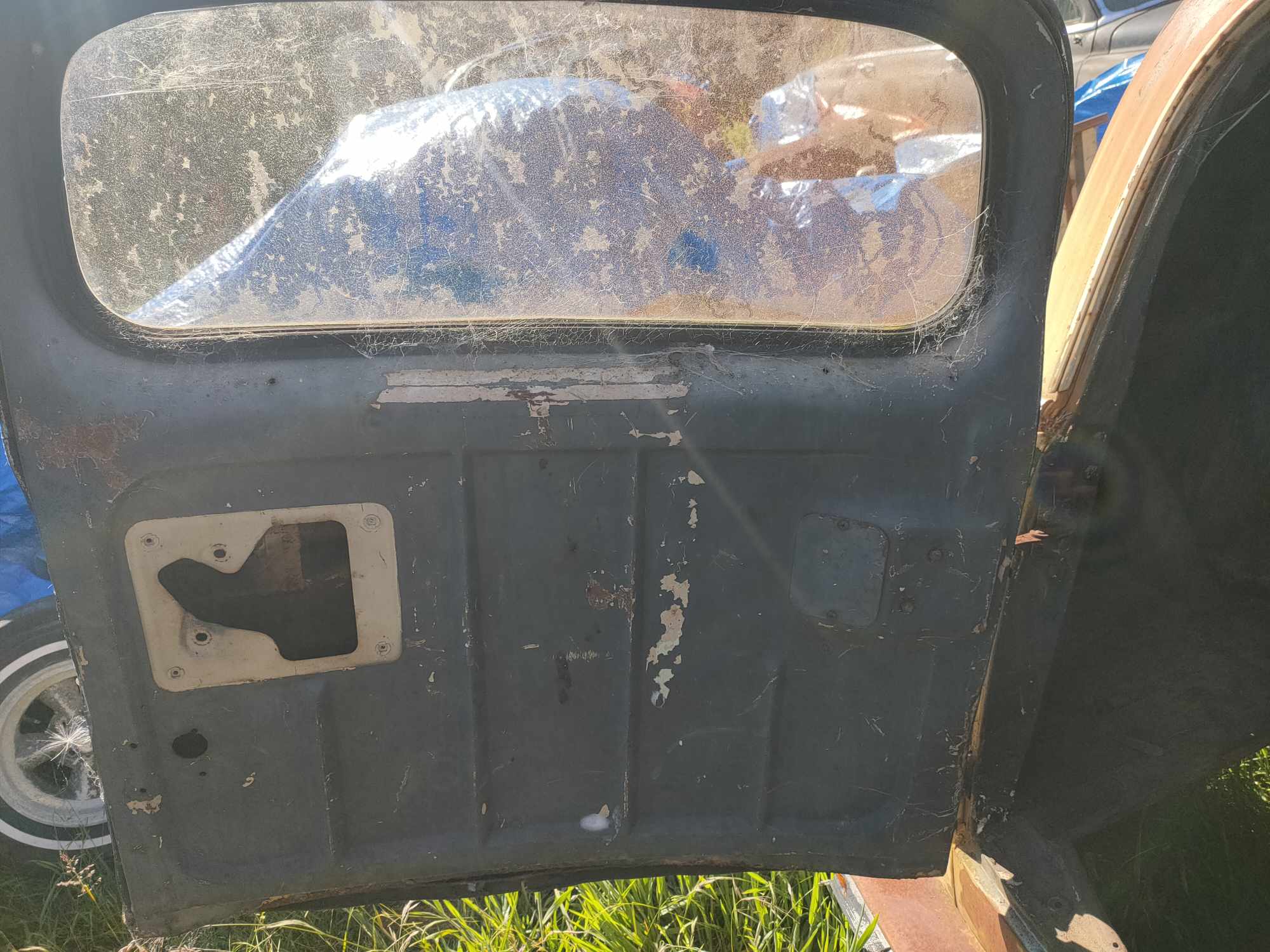

    Today was a good chance for a stock take of the inventory that came in the delivery.
    I also spent a fair bit of time on the water blaster both inside and out, resulting in an inadvertent change in color from rusty stained white to rusty stained blue/green that was probably a factory applied coating. From all the cleaning I only found 1 little bit of cancerous rust that will require excision and replacement.
    The door opens and closes beaut, a little wear on the hinge pins.
    IMG20241212100411.jpg IMG20241212100425.jpg IMG20241212100433.jpg IMG20241212100436.jpg IMG20241212100443.jpg IMG20241212100447.jpg IMG20241212100458.jpg IMG20241212100503.jpg
