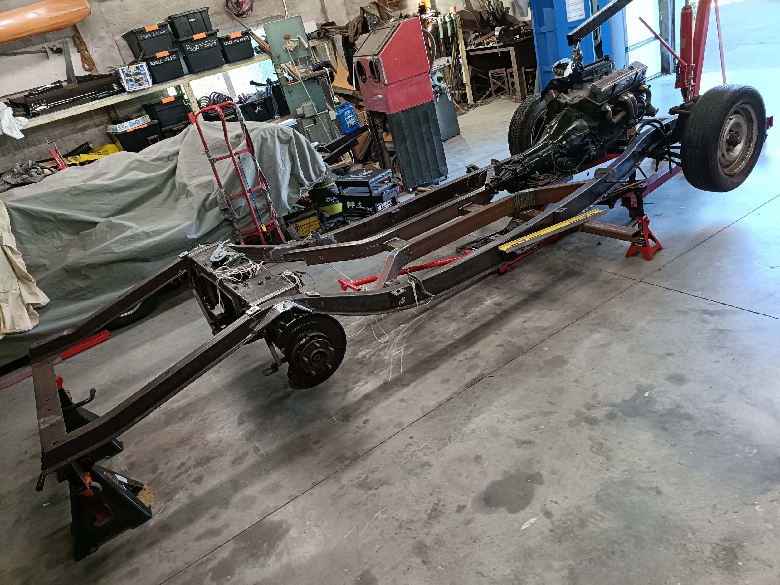

    So, here we are at the end of another week, with plenty more productive days behind us. IMG20250306104645.jpg
    I welded the two center pieces in to make the tubes into one manageable unit. Now it is possible to mark up where to trim the ends to fit between the chassis rails.
    After a bit of judicial trimming here and there the new fits between the old.
    I have cut and fit some 3mm plate for doublers on each corner to help spread the loading where the welds will be.
    Tomorrow we weld!

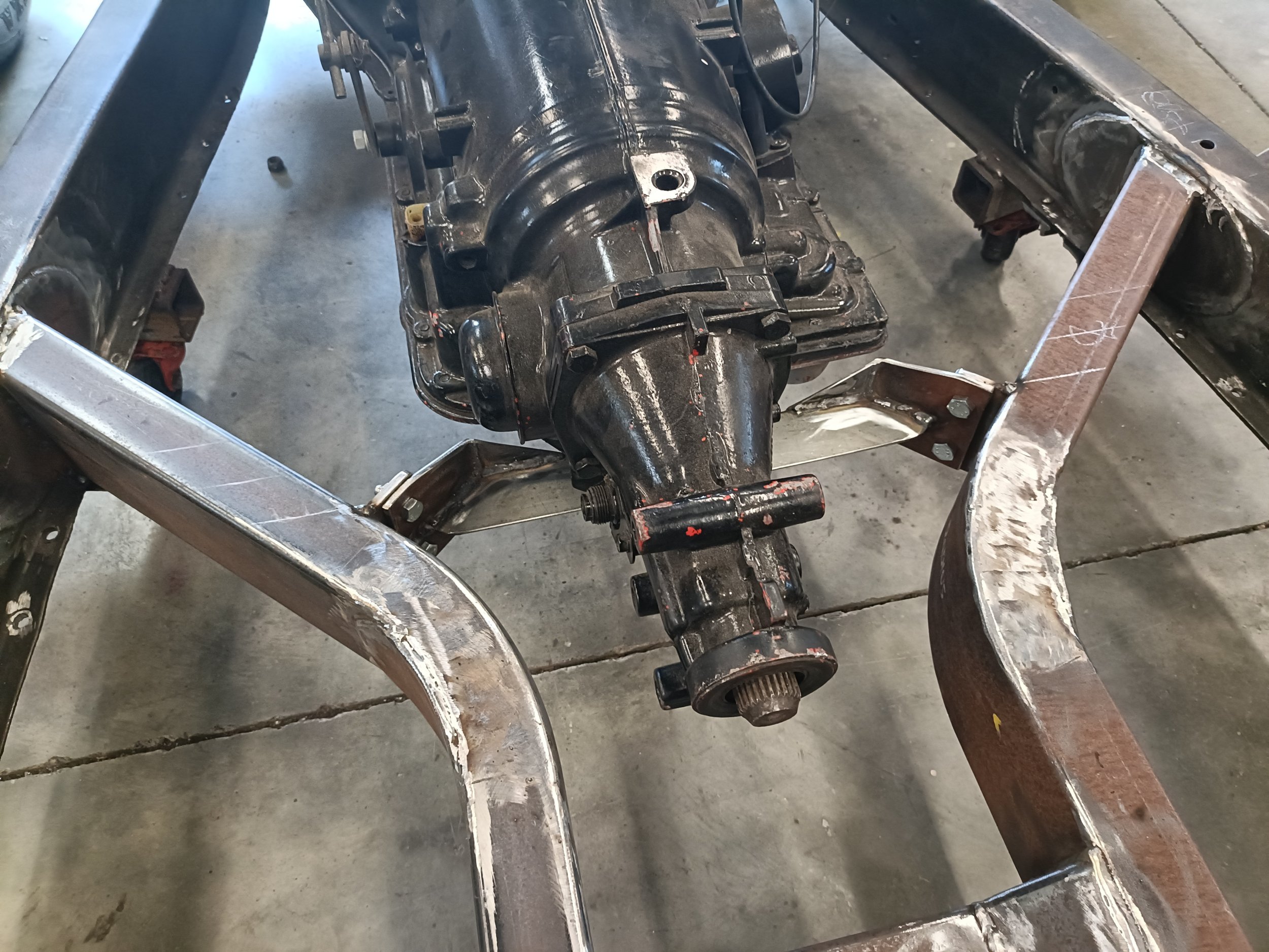

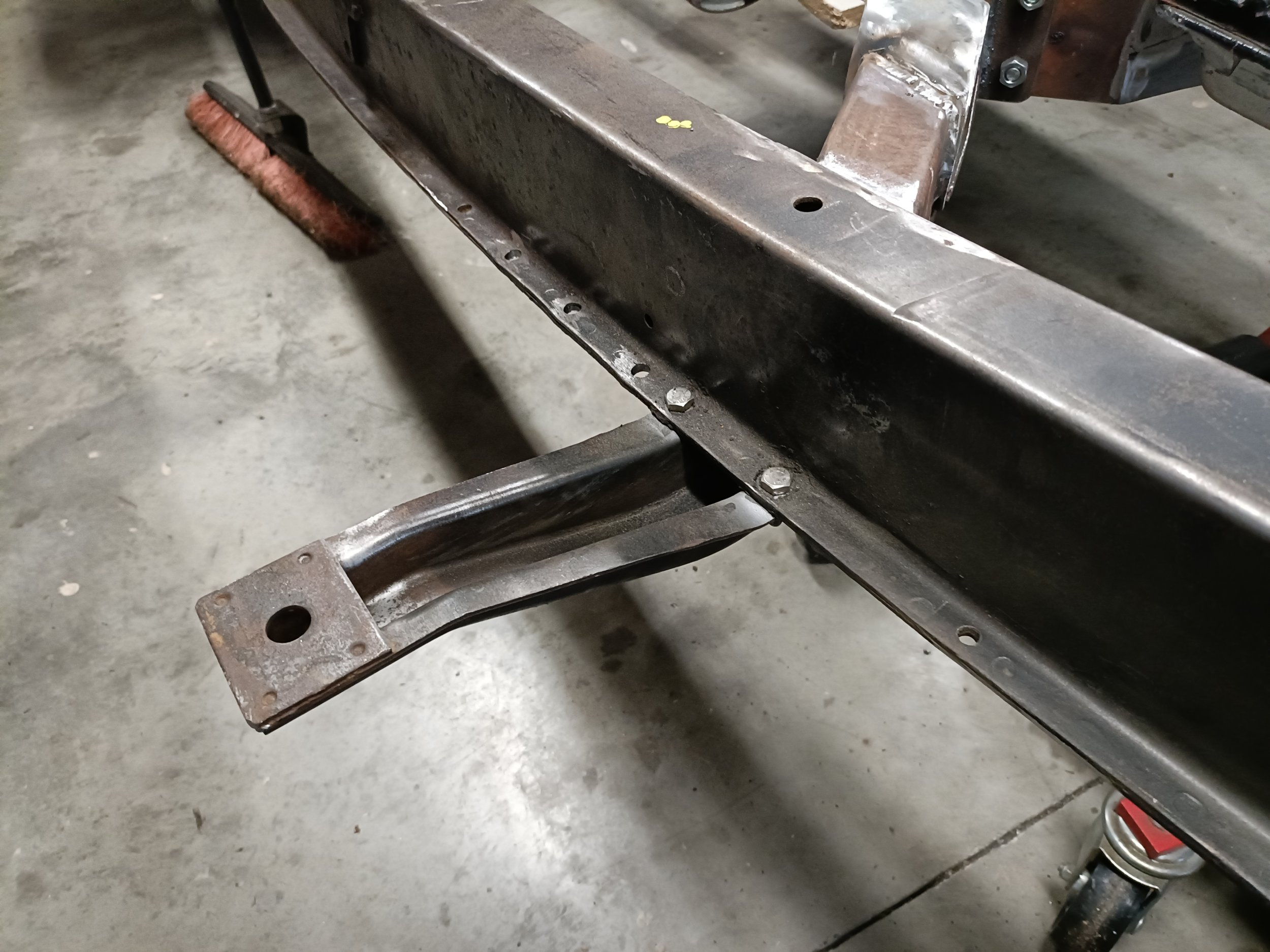

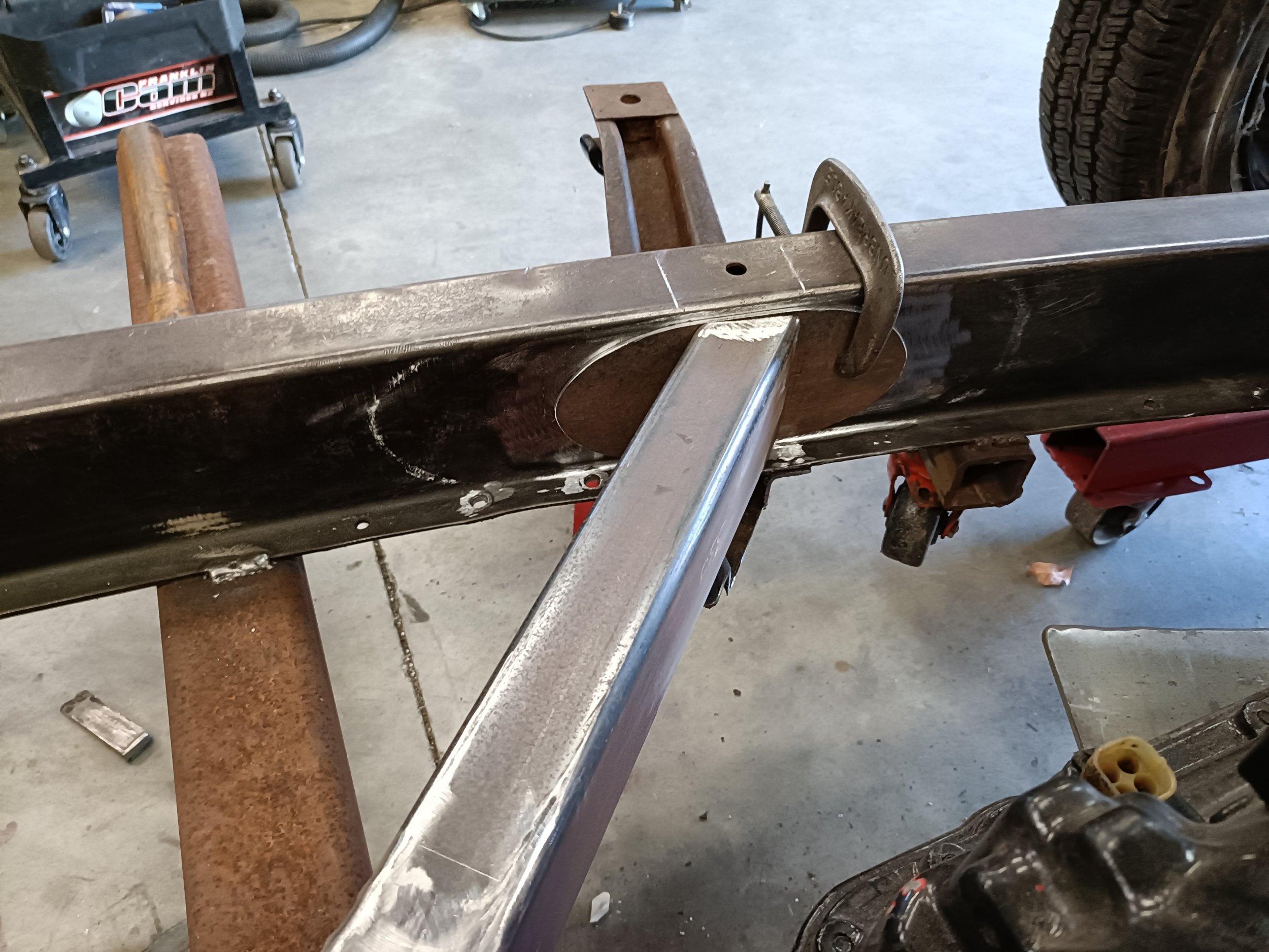

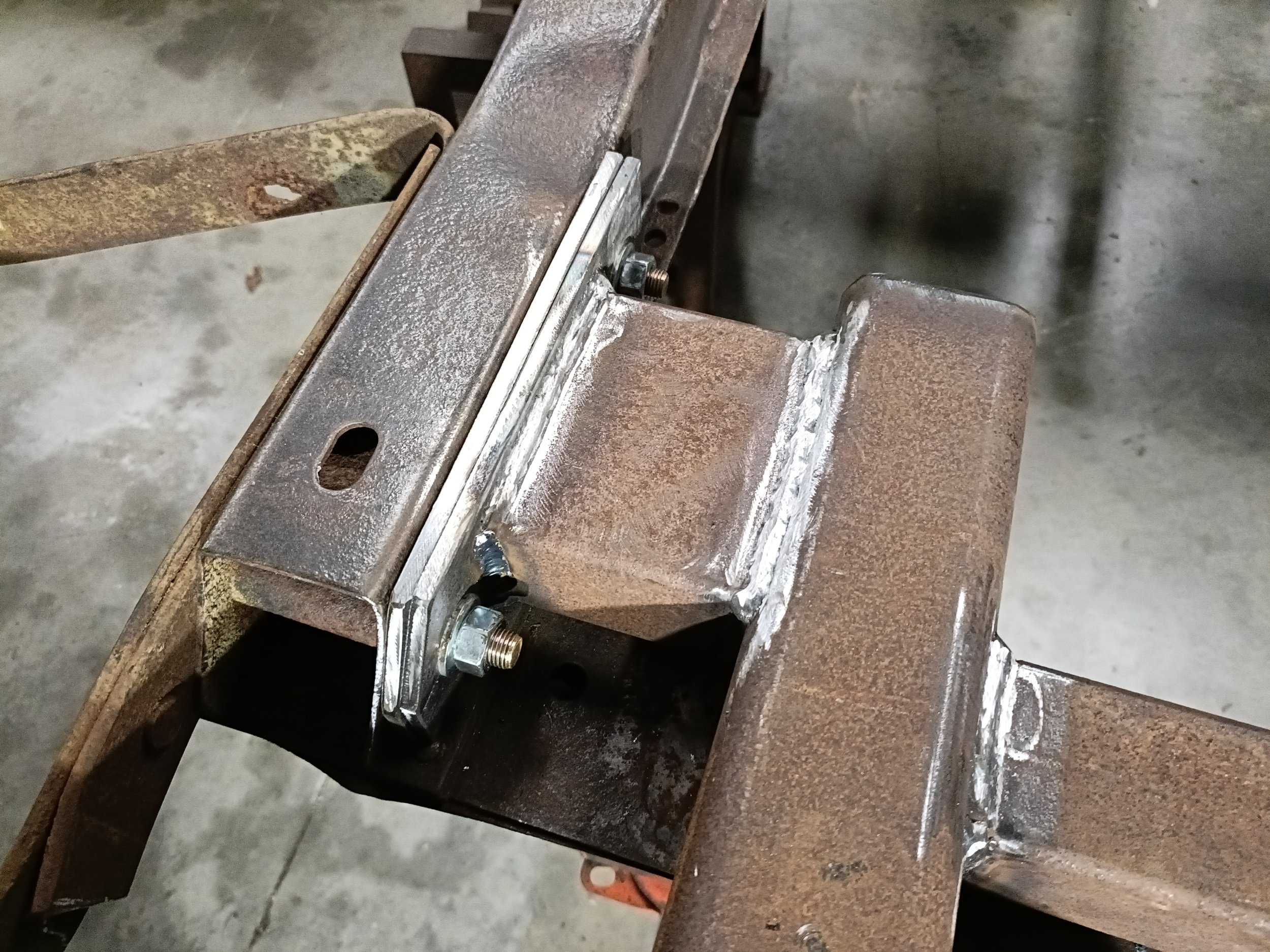

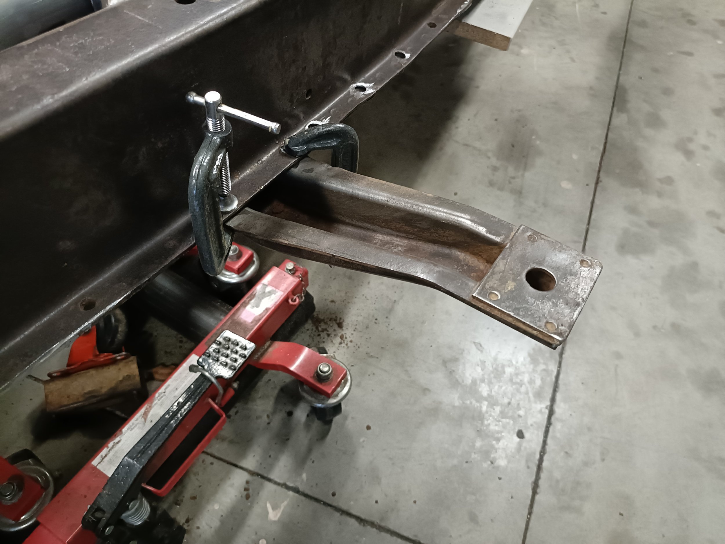

    Trimmed the ends to fit inside the rails.
    The rear ends needed a little fettling to fit.
    I added a 3mm doubler plate at each cross member to chassis node to spread the loading.
    To help further I cut a hole in the doubler and welded it to the chassis before the cross member went in.
    Same on the rear.
    I also added doublers to the inside of each x member bends.
    Next was the engine mounts. Yes it's offset to the left 1 inch to gain a bit of clearance for steering, starter and exhaust on the right side.
    Trans mount was next.
    The engine looked really excited to be in the car!
    Very happy with the weeks achievements!

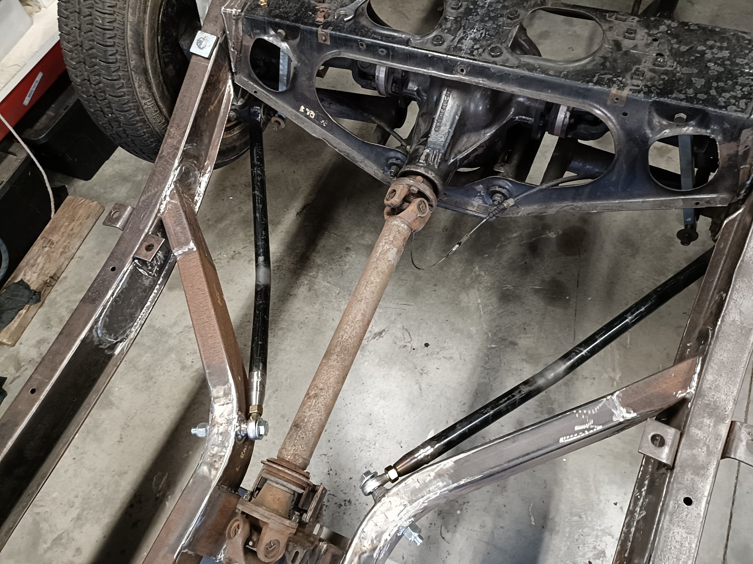

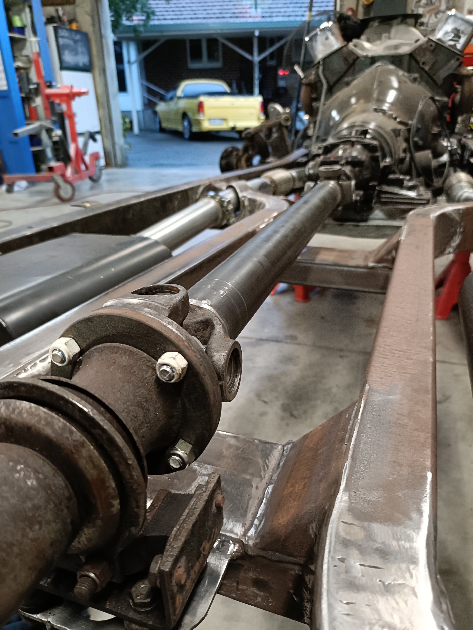

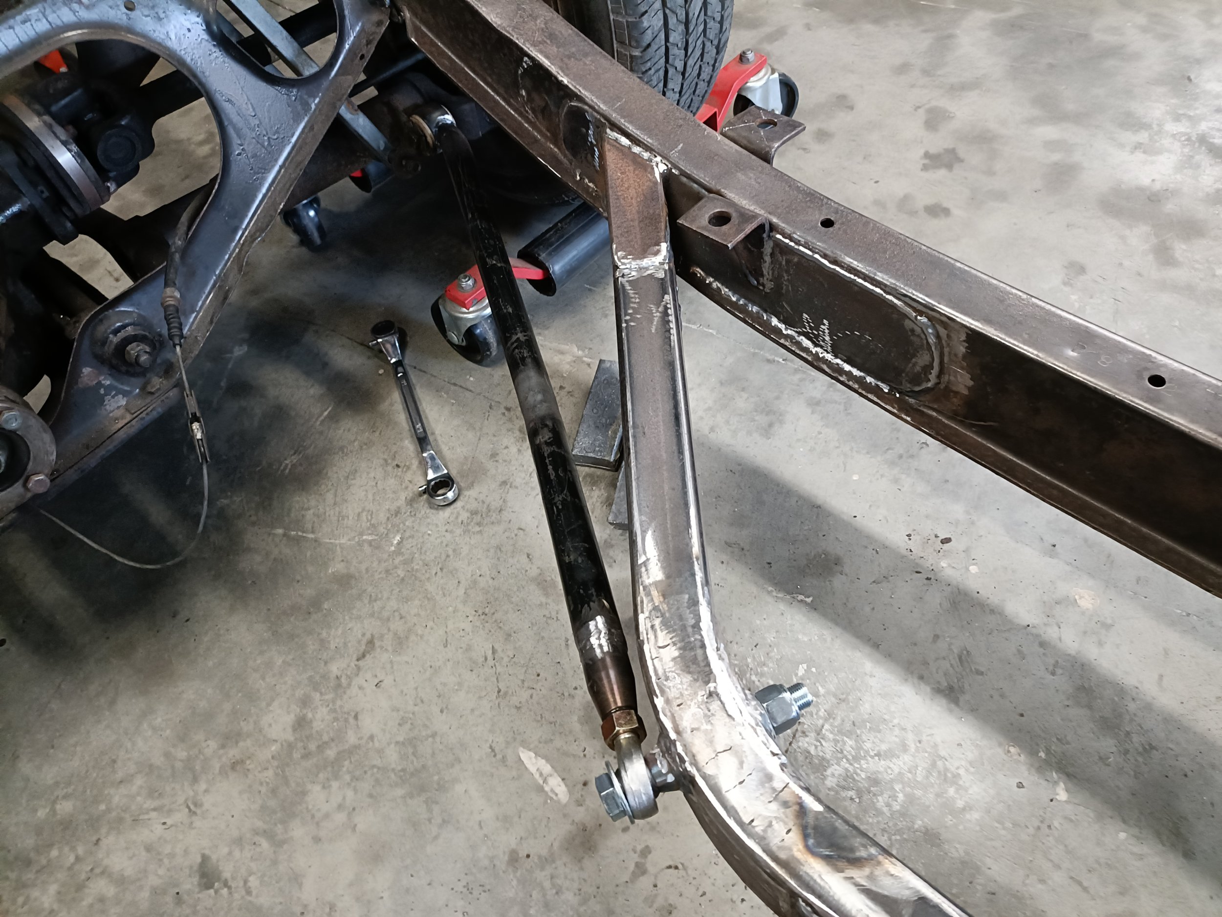

    Rod ends on the front are 5/8" with a solid shaft machined to through bolt to the k member.
    A slight bend to give more space for the exhaust later.
    Stock jag rear rubber bushing should isolate for noise.

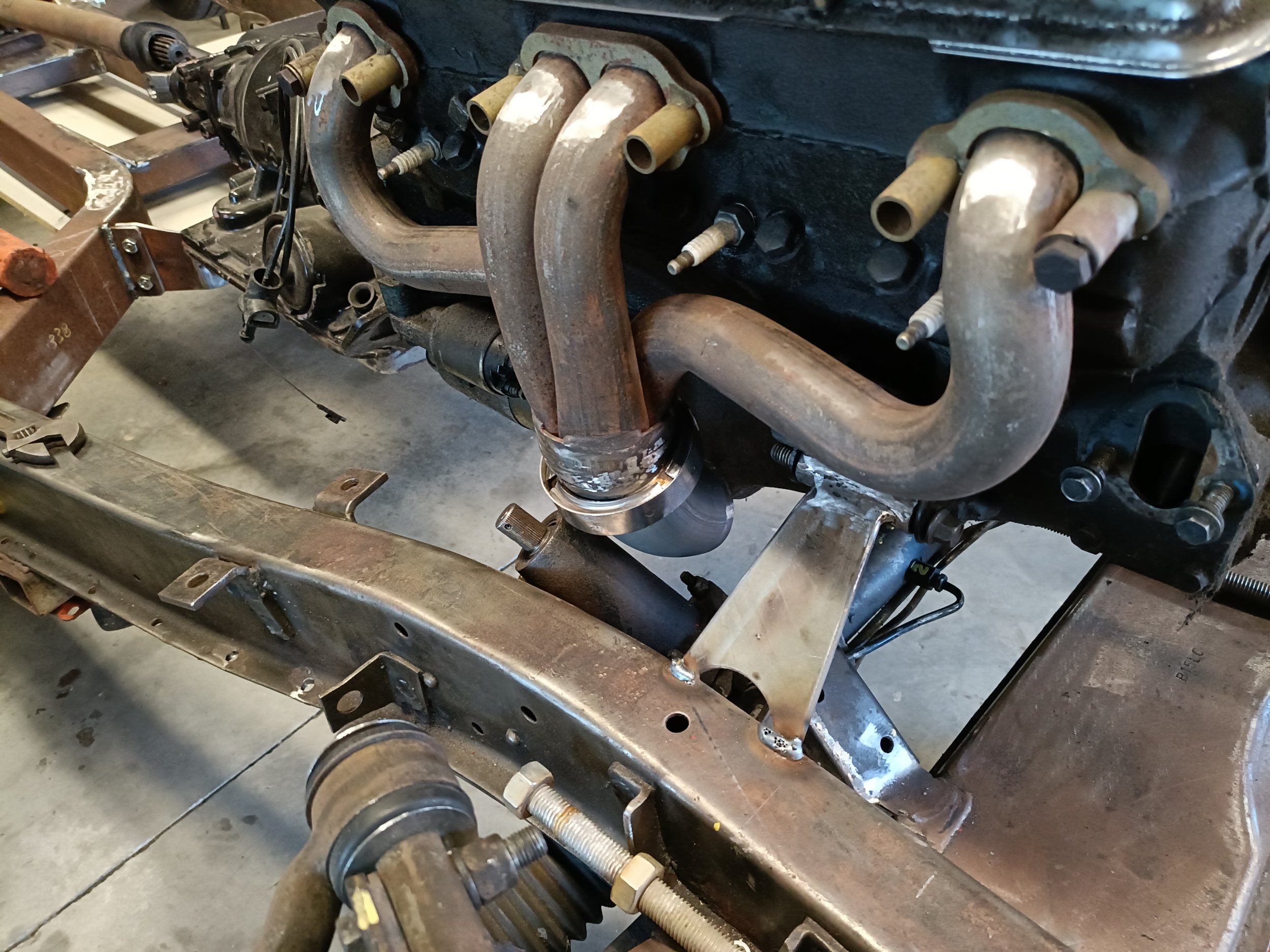

    A quick engine out of chassis job was a clearance for left side exhaust out of 3mm plate.
    Left side started and welded.
    And a bunch welded on for future O² sensor.

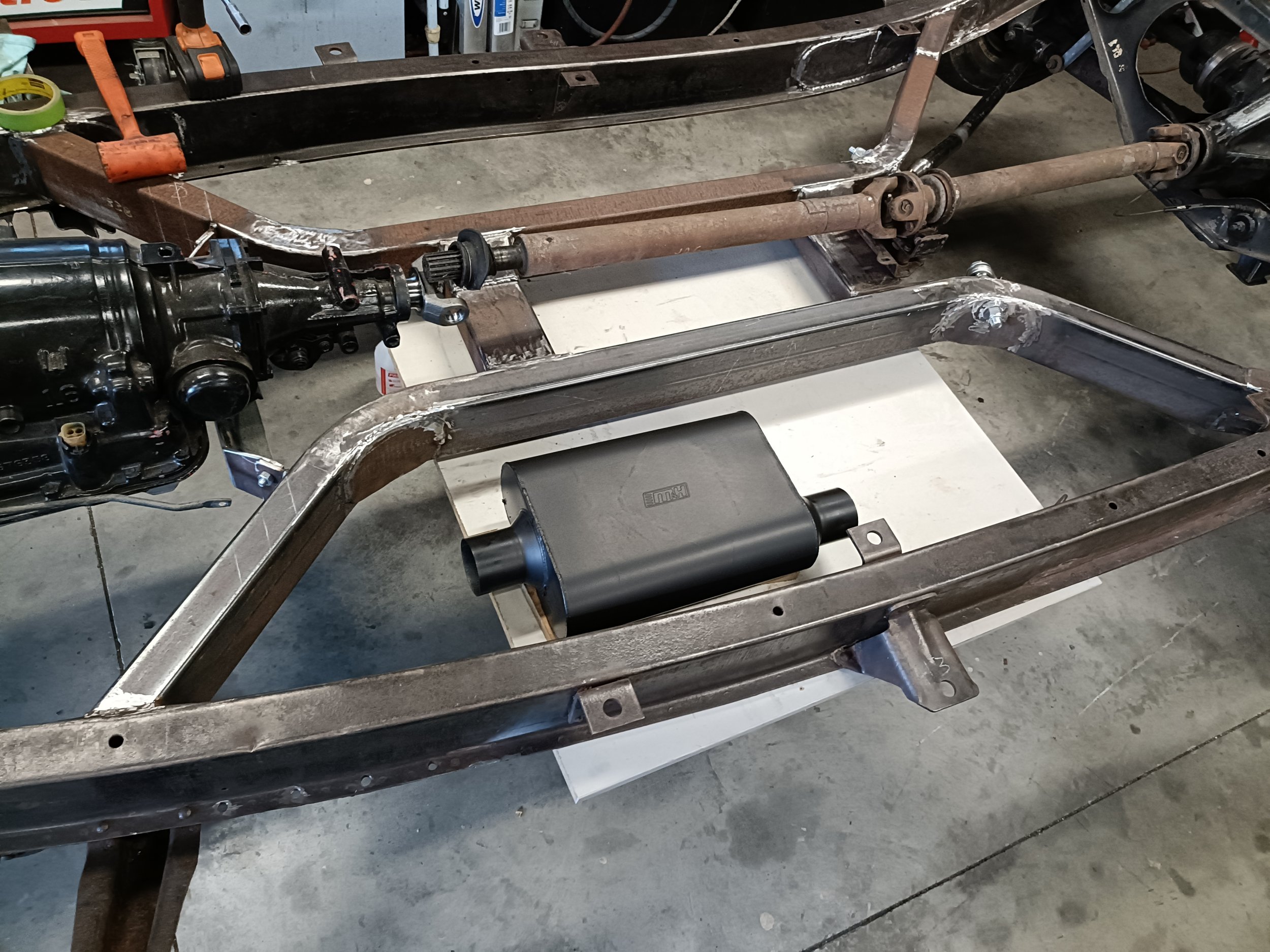

    Gotta love it when the couriers pay a visit. There should be enough to do both the 53 and the 39 coupe later.
    Time to find homes for all the pieces. Also toying with the idea of using the standard jag driveshaft with the carrier bearing in the middle and a few more u joints, because why not!
    On to the drivers side......
    I removed all the hydraulic lines from the standard jag power assist and will remake them to run out of the route of the exhaust.
    Now we just have to leave room for the starter and allow for potential need to remove it at a later date. One of the reasons I am opting for vee band clamps is future ease of removal in tight spaces.

    Port side pipework has advanced a little.
    Making the penetrations for the pipes took a while.
    Working out exactly where to put them in half the battle.
    Starboard side getting around the steering and starter took a bit of nutting out too. Still, progress is progress!

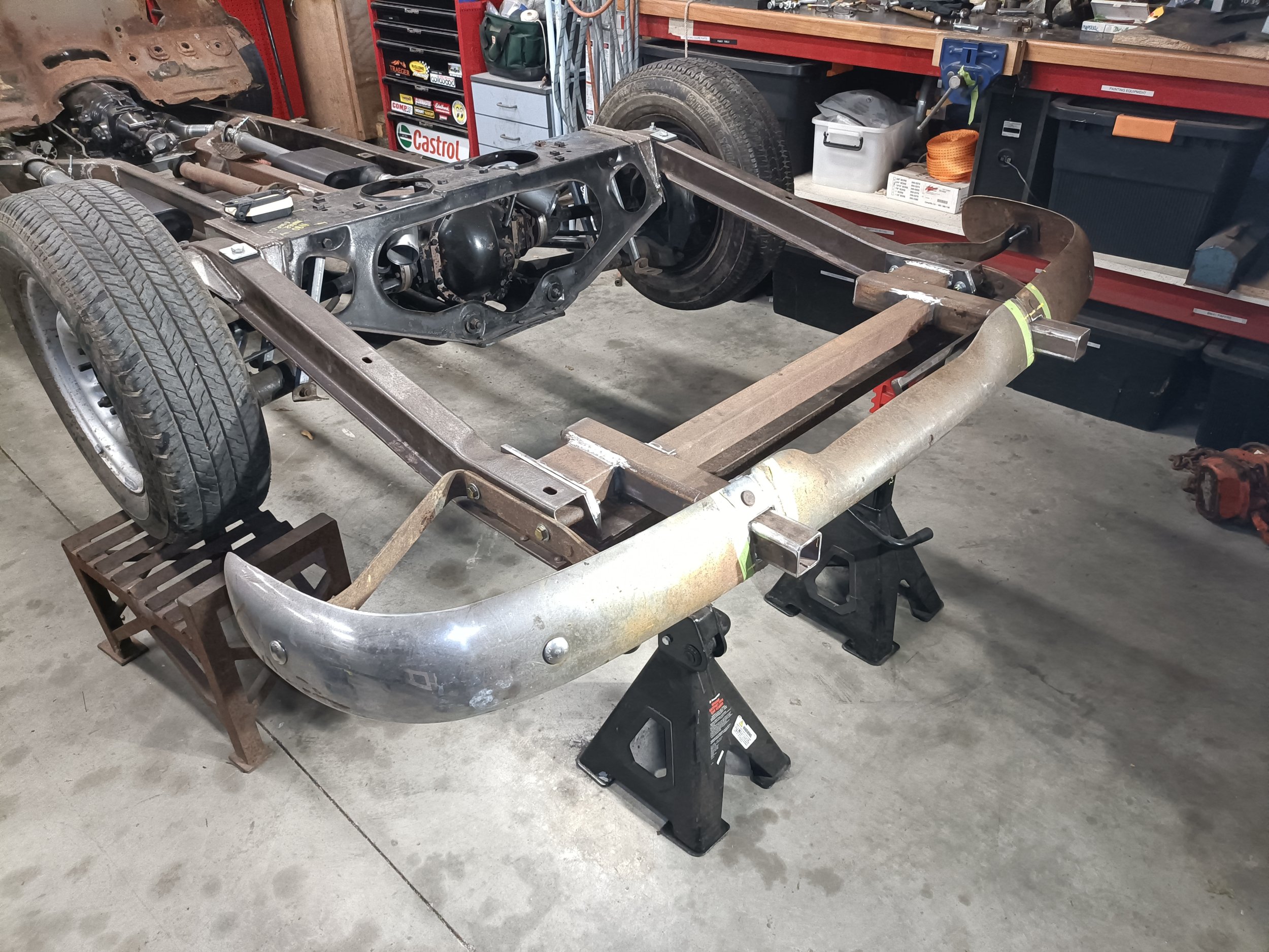

    This afternoon I spent a few minutes on the rear bumper and worked out how I will build the tow bar mounting.

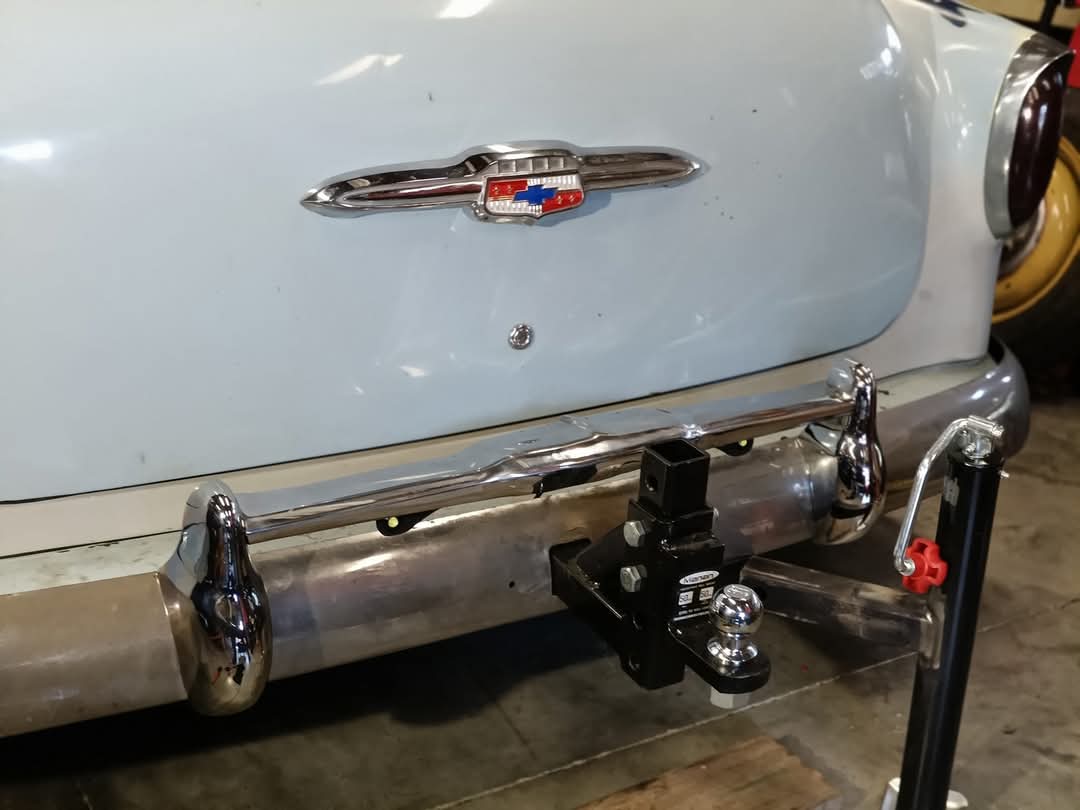

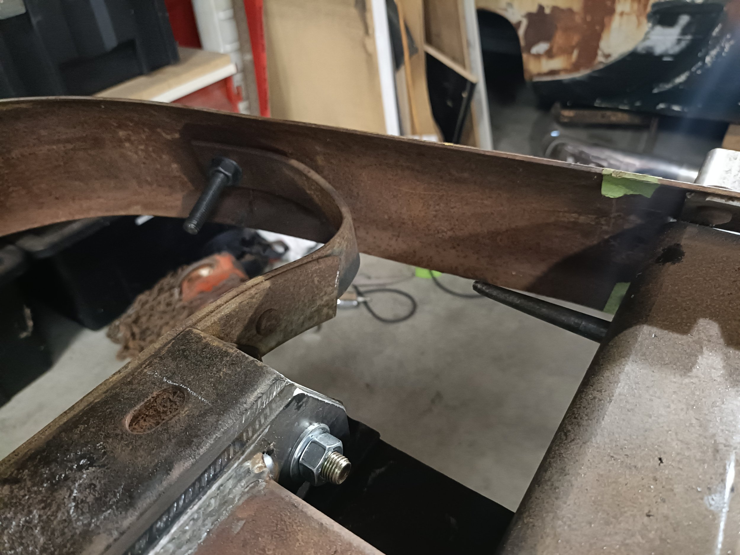

    On the coupe I added a hidden trailer hitch/drawbar through the rear bumper. Having one below the bumper would have been too low. FB_IMG_1744867353105.jpg
    The number plate mount slides into the trailer hitch receiver when not towing.
    On the delivery however the center of the rear bumper is reduced in depth to make a step to access the rear door, so I was not able to duplicate the tow hitch I made for the coupe.
    I came up with a cunning plan, so cunning you could put a tail on it and call it a rat!
    The twin bumper over riders provided the solution!

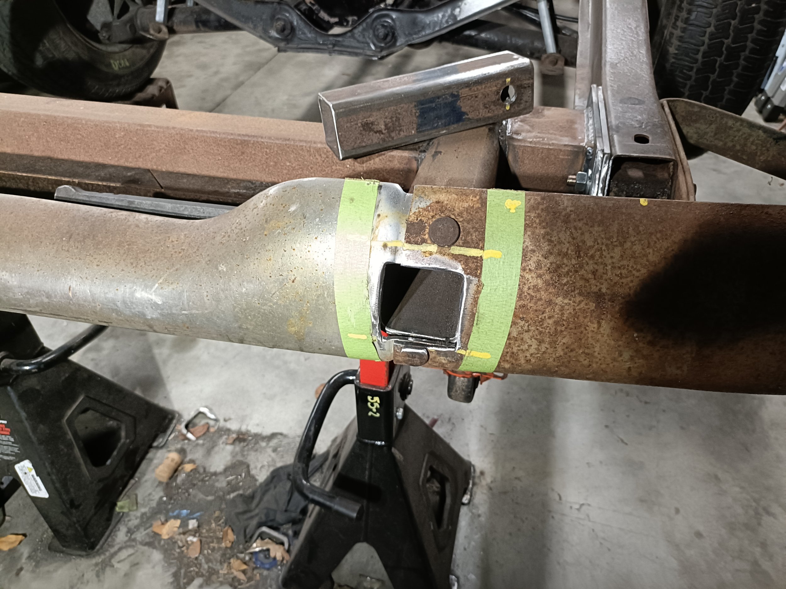

    First of all I bolted the bumper with fresh bolts and made sure the alignment was good. Next I made packer plates (to clear riveted chassis) and mount plates to use the bumper bolts.
    Then trimmed off the inner 2 bumper mount spring steel that the over riders would bolt through.
    This shot shows the spacer and mount plates on the bumper bolts.
    Then marked and cut the penetrations from the back side of the bumper.
    I have come up with further cunningness to fit the over riders when no tow hitch is attached.........
    The tow hitch will slide into the receivers and join both sides together with the ball on it.

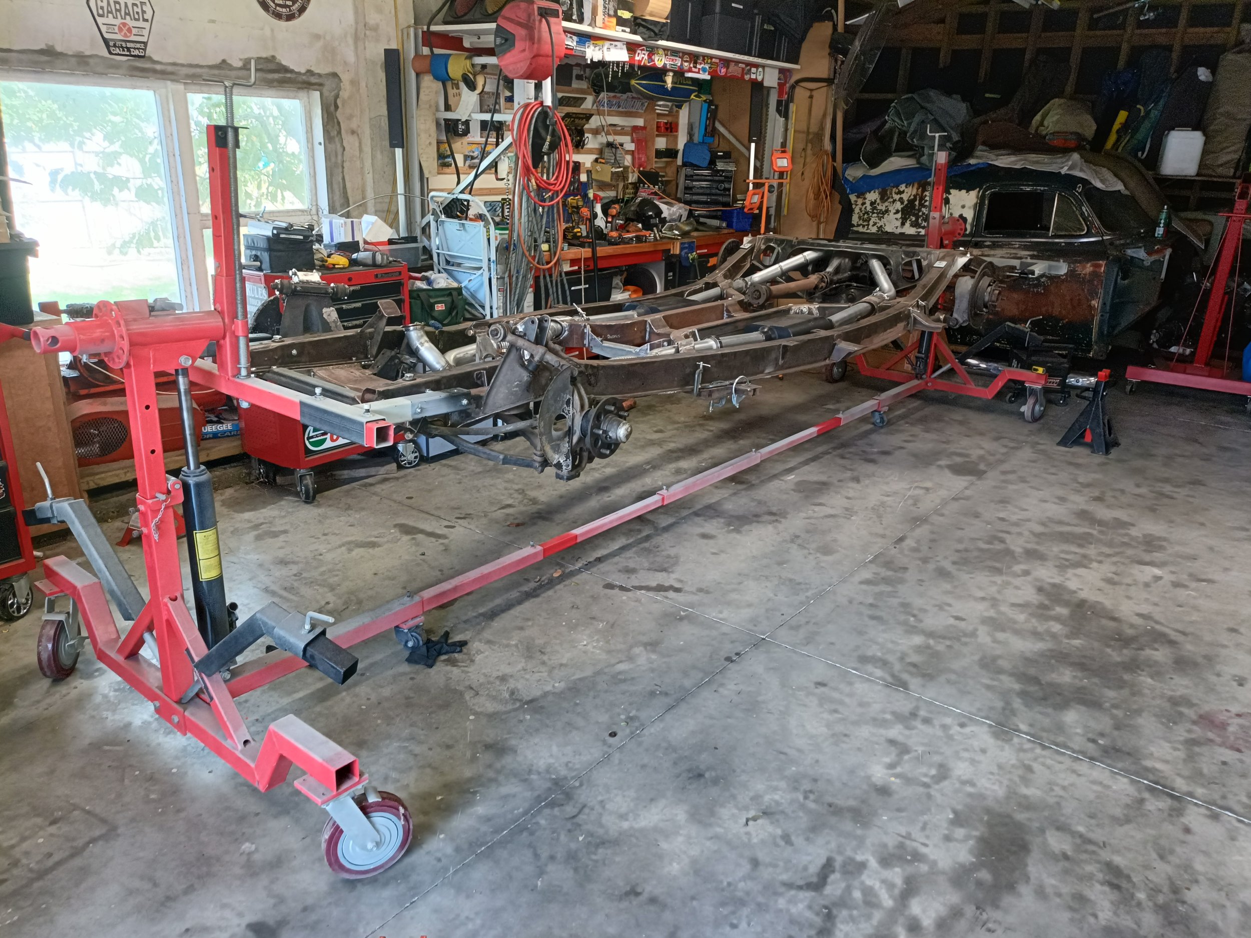

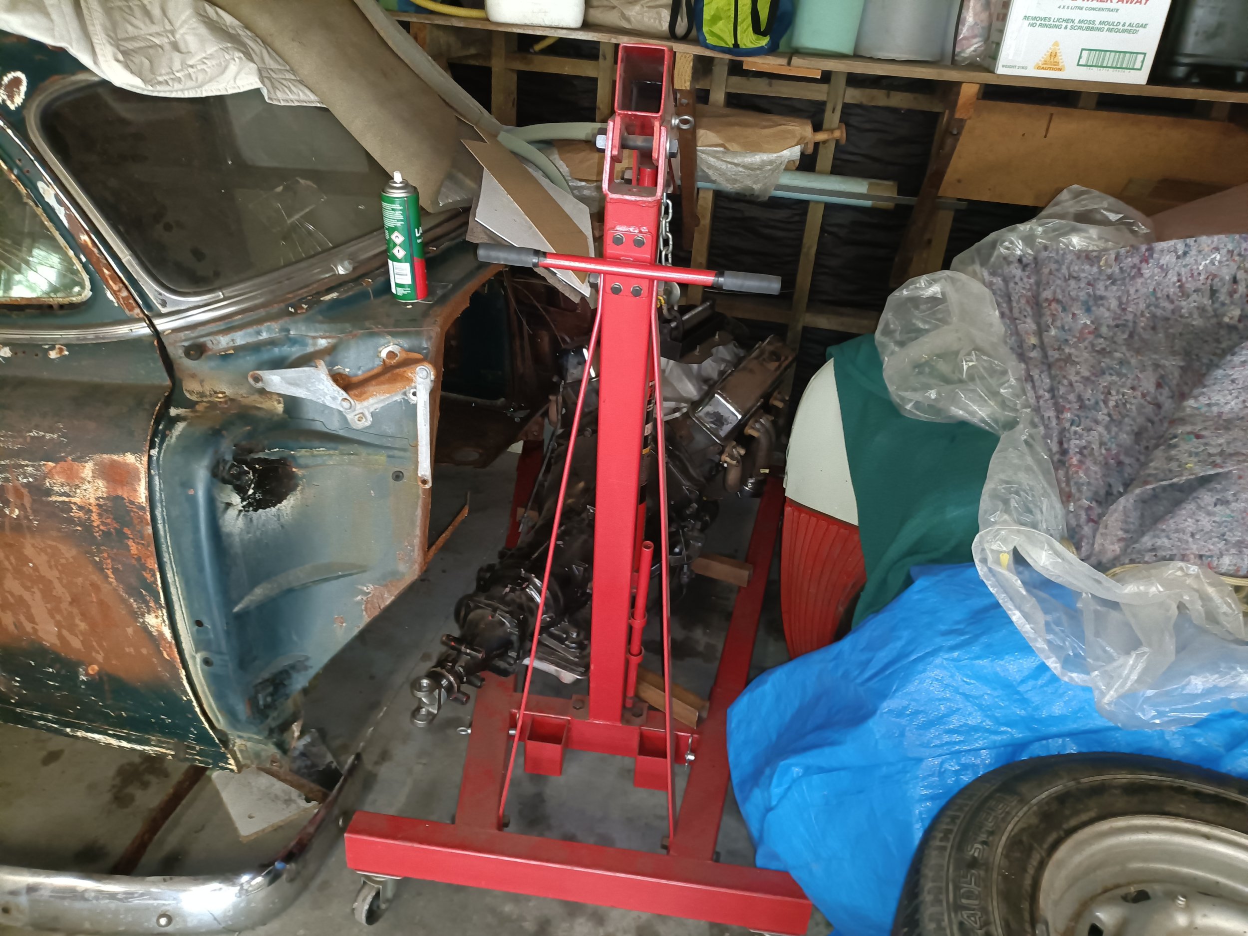

    Plucking the engine and trans out of the chassis.
    Safely lowered and supported on the hoist for storage.
    Jammed in a space out of the way for now.
    Engine out and ready to remove the rest.
    Exhaust and extra s all need to come out.
    Elevated and ready for work.
    Inverted ready to attack all the underside jobs.
    All the exhaust and bumper hardware will get some treatment to make it a bit prettier.

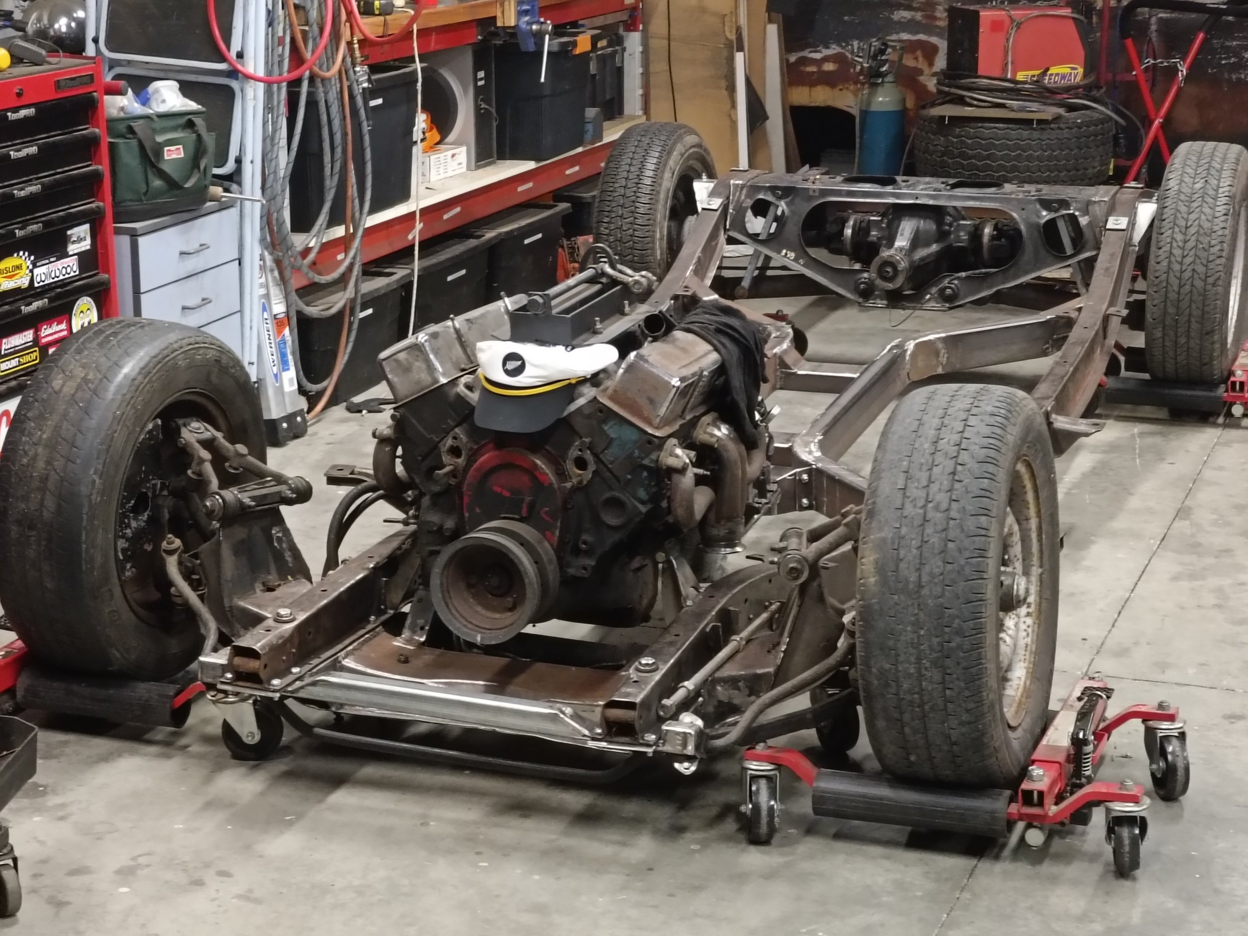

    A whole lot of activities this week, with no real visual changes. Such is the joy of finishing off all the welds on the chassis.
    I did find a brand new master cylinder and booster on marketplace and made a new hot rod mate.
    Had a drive shaft made to suit the jag mid bearing and the Chev trans.
    Time to reassemble it all for the certifier to check it out, then off to the blasters.

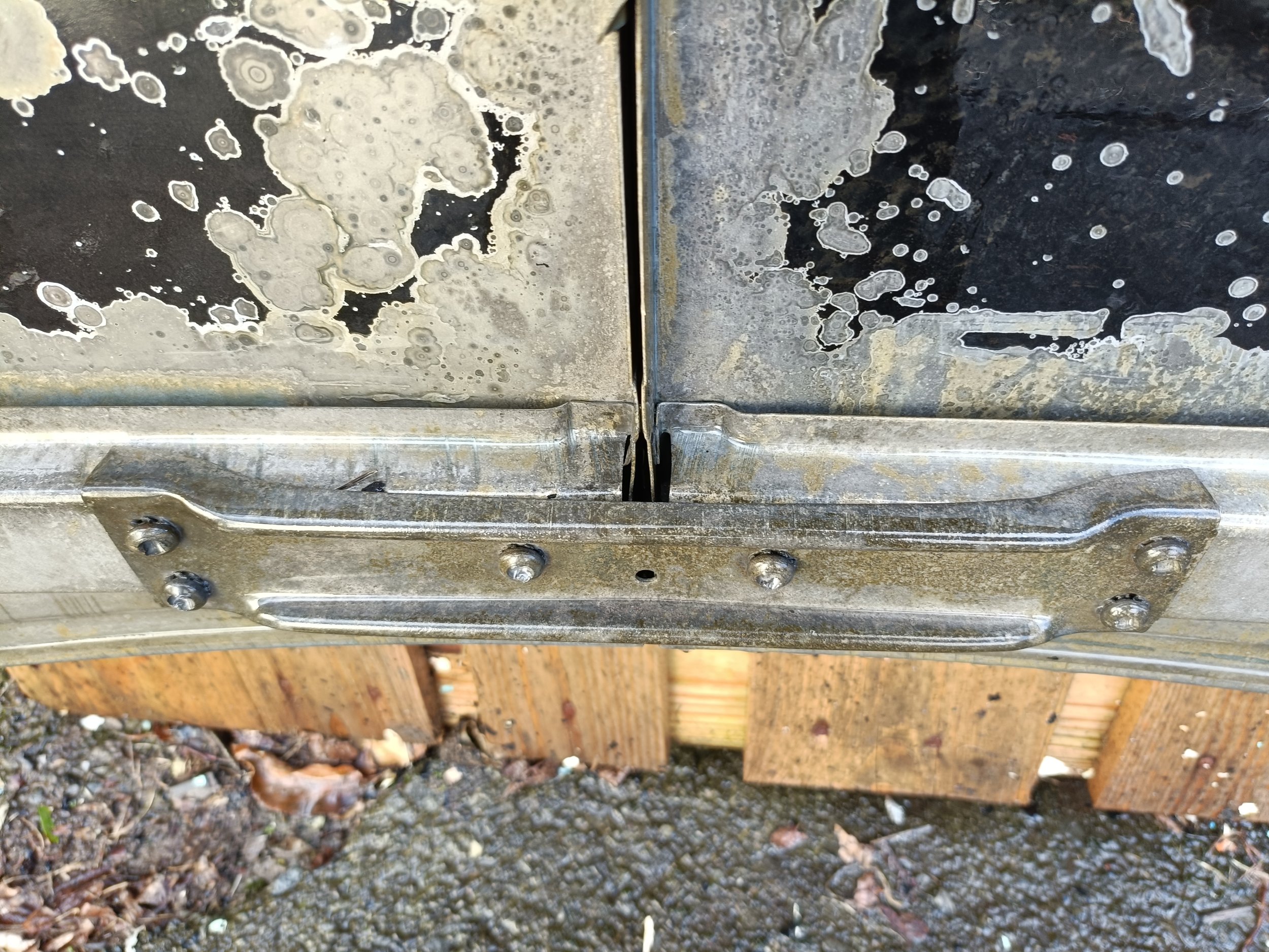

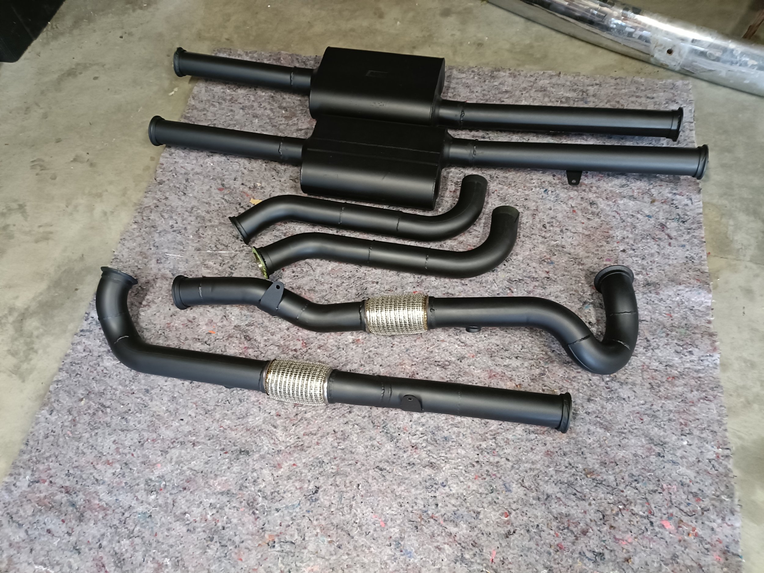

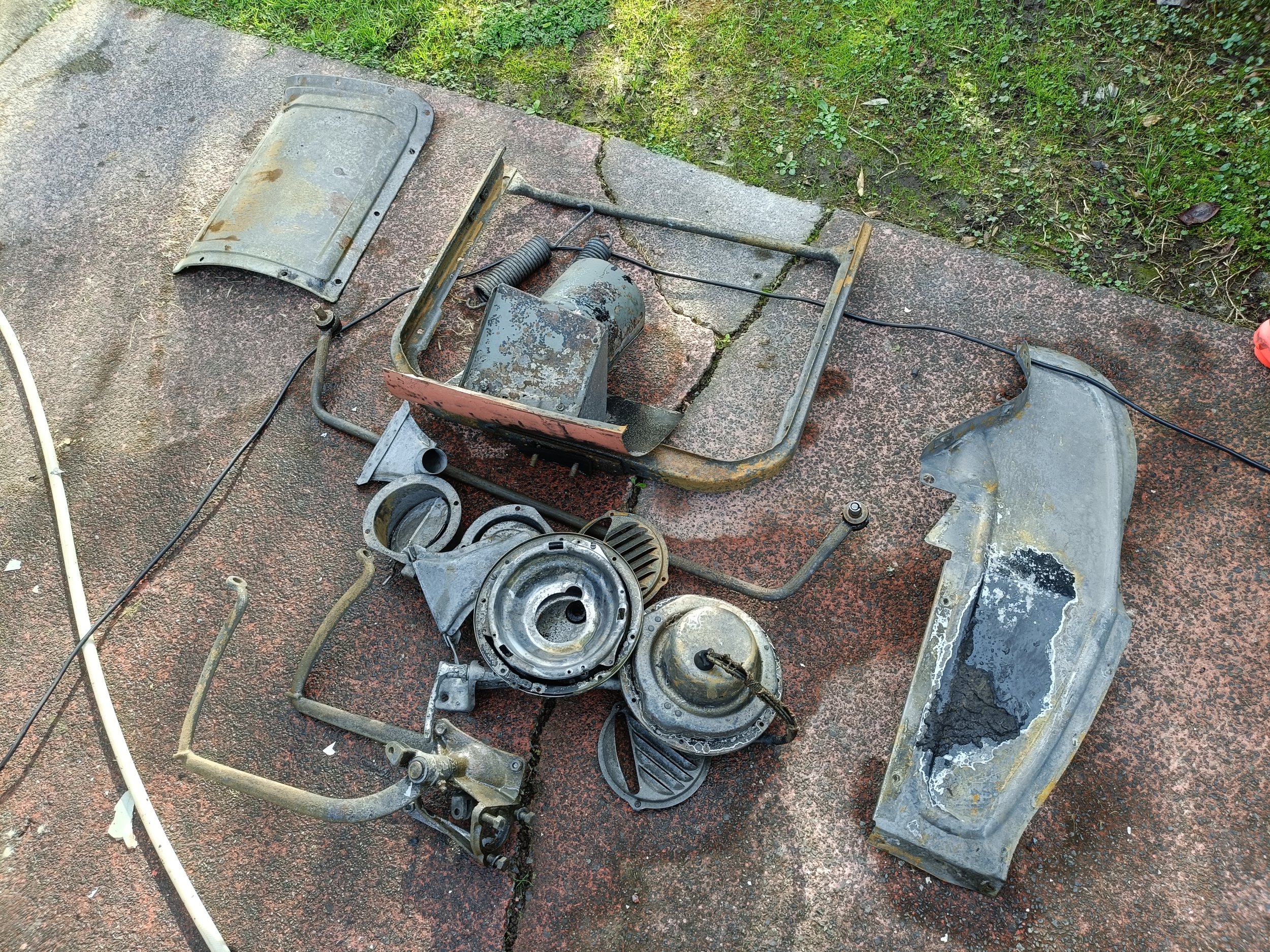

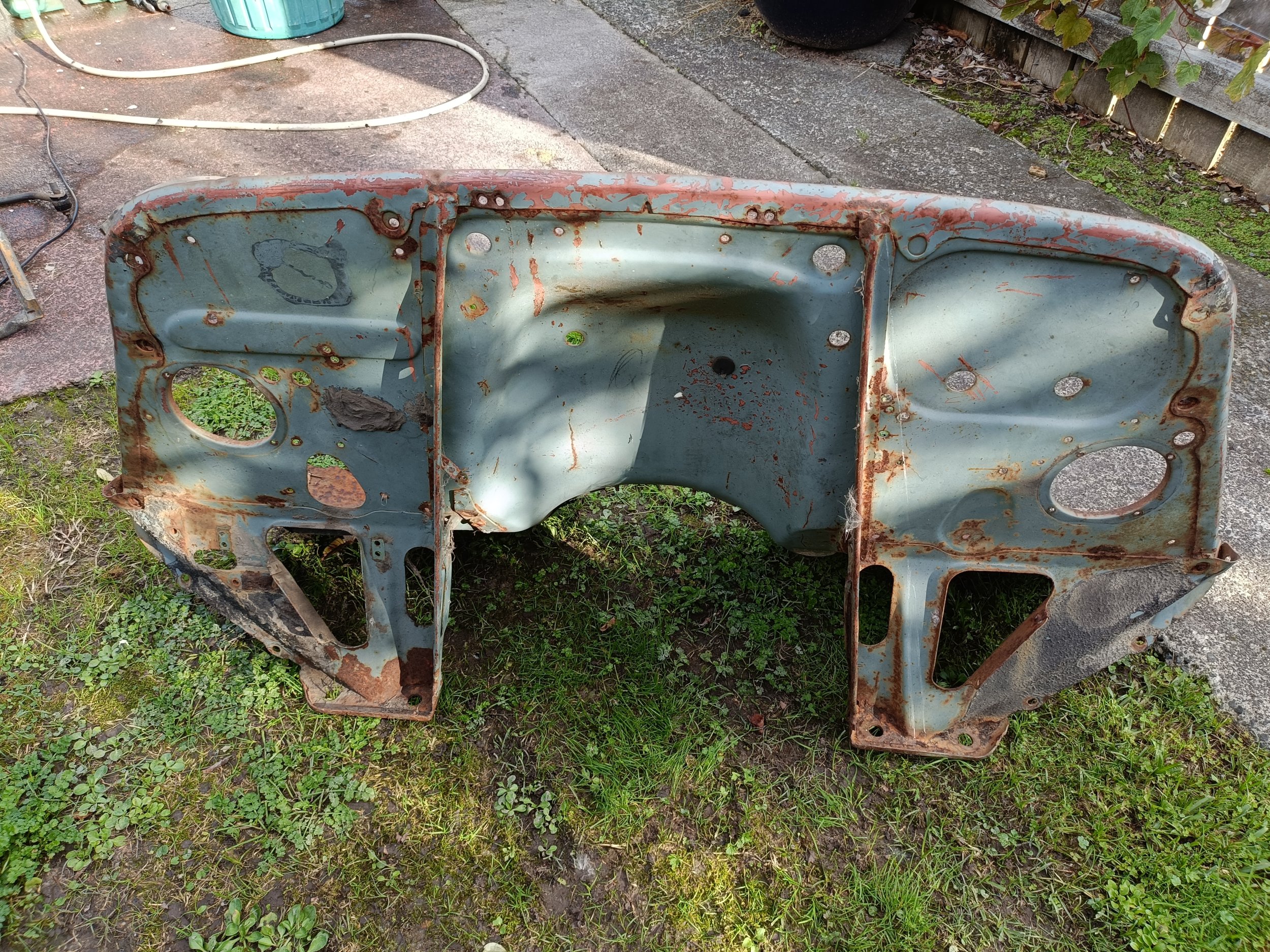

    ......well, there are parts to paint and a bunch more in the molasses bath that need attention.
    All the exhaust components had a quick coat of high temp black.
    Courtesy of the rattle can.

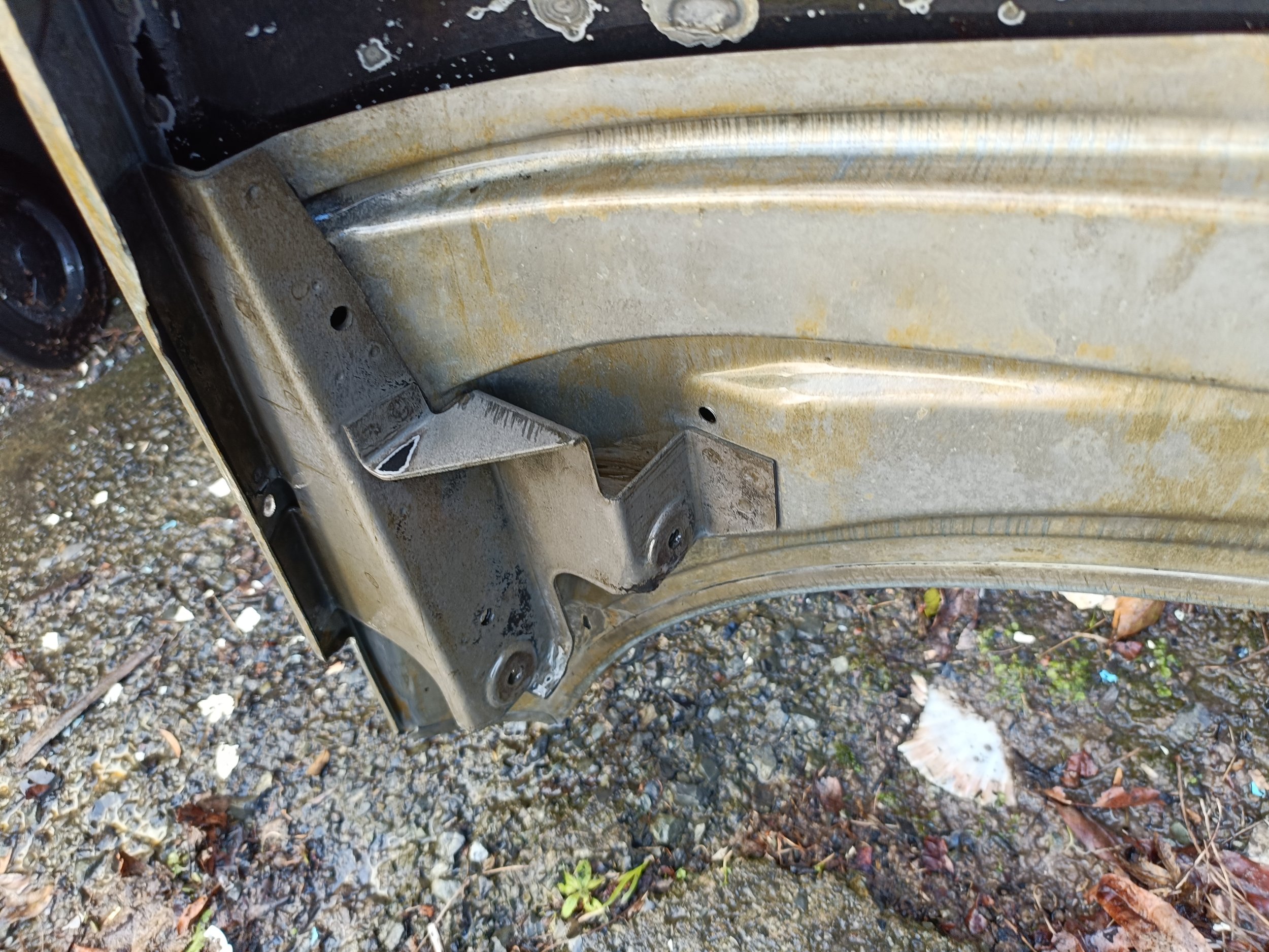

    Underside of the hood looks good, a little sanding to clean of some stubborn paint.
    Amazing how clean the molasses gets everything.
    All those fasteners should be a doddle to get undone.

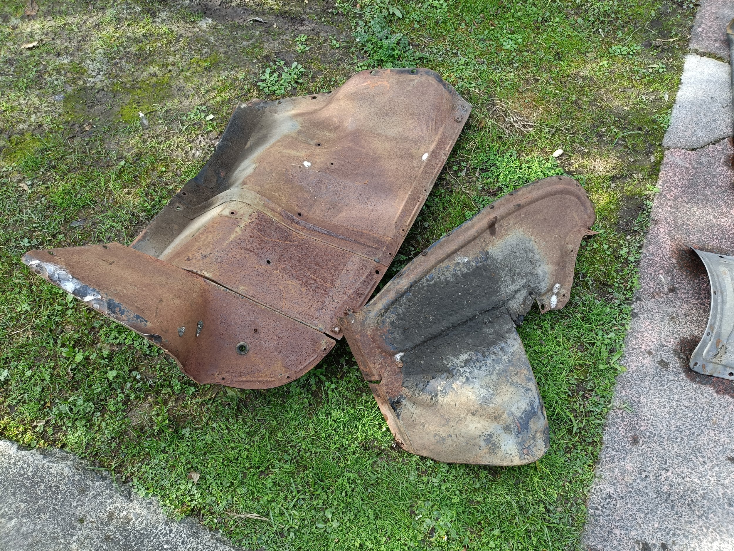

    I plan to completely unpick the hood to get in the back of all the framing to appropriately coat all surfaces.
    The fenders can't hide any sins now. On the whole they are solid but in need of a little hammer and dolly attention.
    Flash rust happened real quick, even with a baking soda flush.
    A bunch of smaller parts have been soaking for a couple of months also.
    The bath looks yucky after 2 months of hard work.
    Replacement parts going into the bath for a soak.
    Most of the paint should lift along with the rust.
    Inner fenders and another inner panel.
