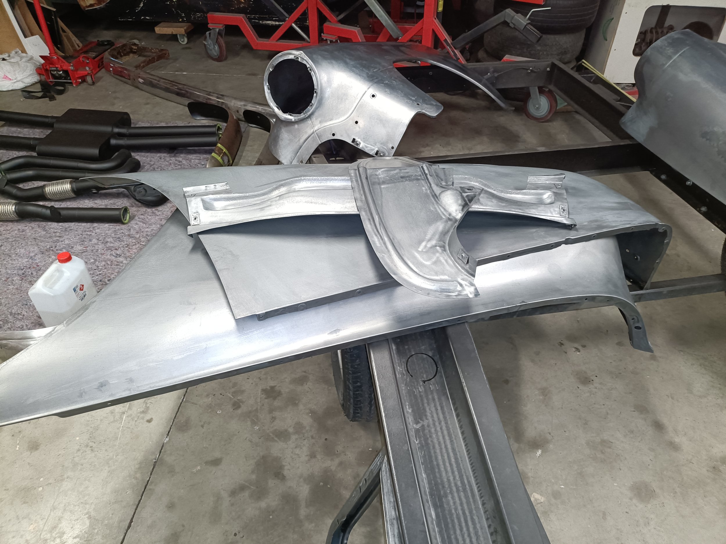

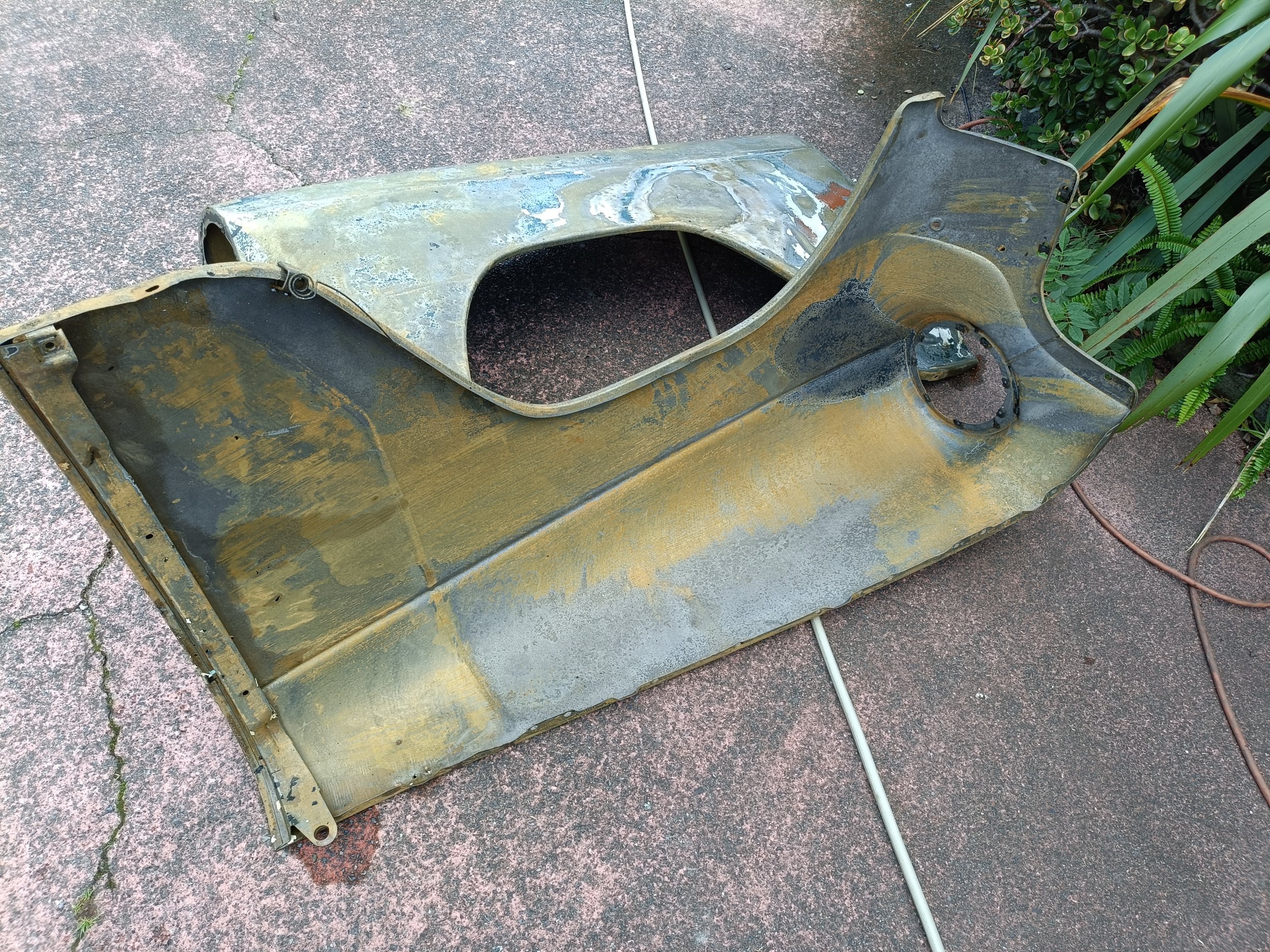

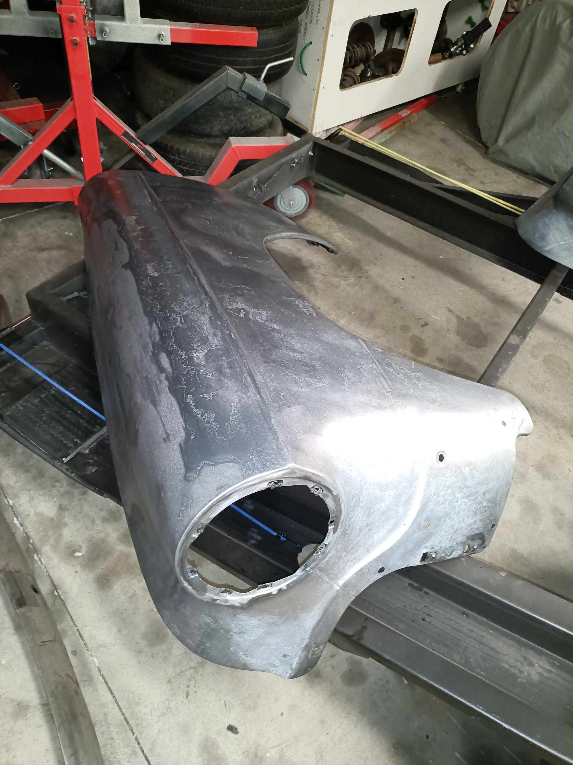

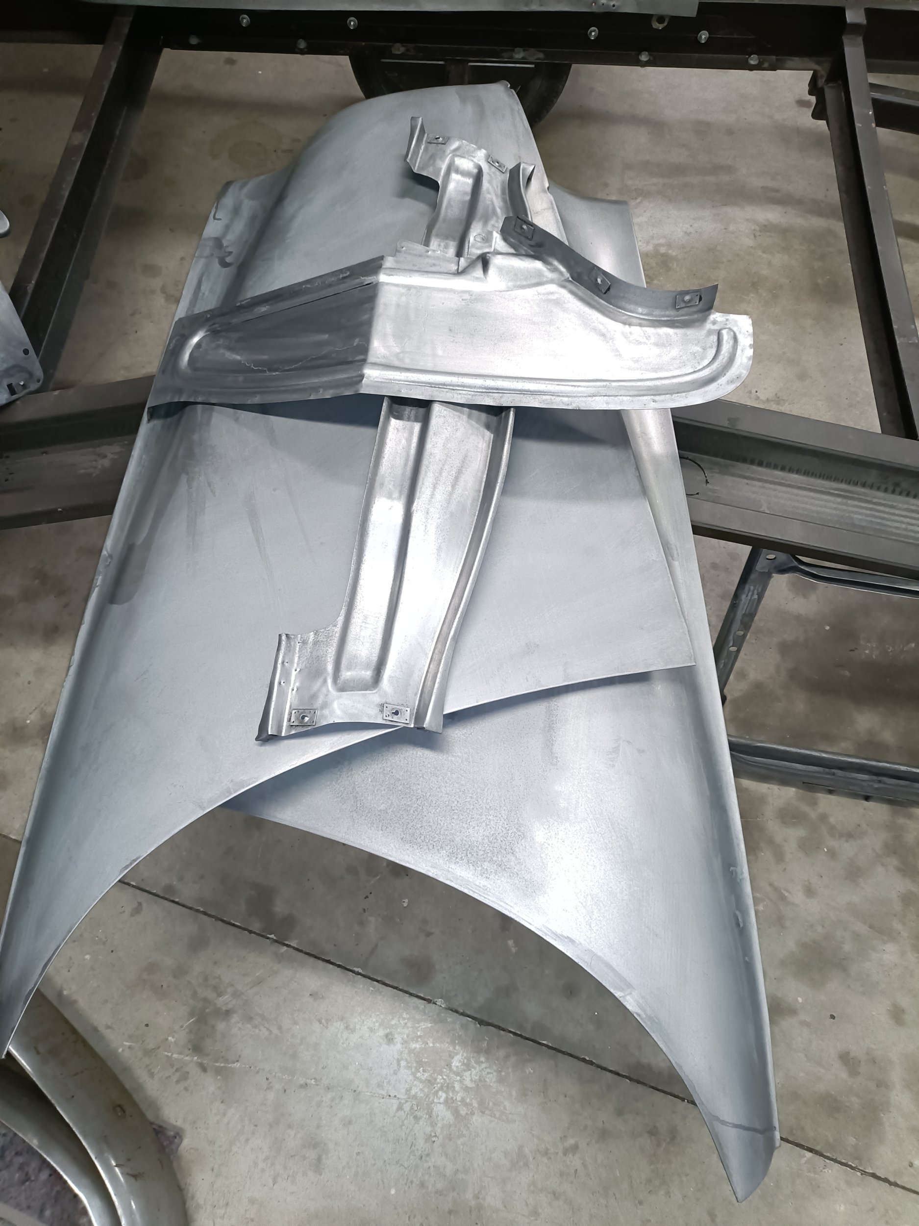

    After removing the panels from the mol***es bath I set to with sander, wire wheel, scotch pads and stripping wheel.
    While the hood went in the mol***es looking like this......
    ...After mechanical and chemical intervention it now looks like this!
    I have broken the hood down to its component parts to enable the application of paint and removal of flash rust behind the frames.
    I am really impressed with the job the mol***es does and the over all condition of the panels, dented all over the place but not so much as a pinhole of rust right through any panels.
    This afternoon I have done a rust kill acid wash over all of the panels and wiped them down ready to apply etch primer tomorrow. IMG20250509171325.jpg
    A little bit of lead in a couple of spots, a few holy patches where the screws have been used to straighten! IMG20250509171312.jpg
    So, etch and epoxy going on in the morning.........

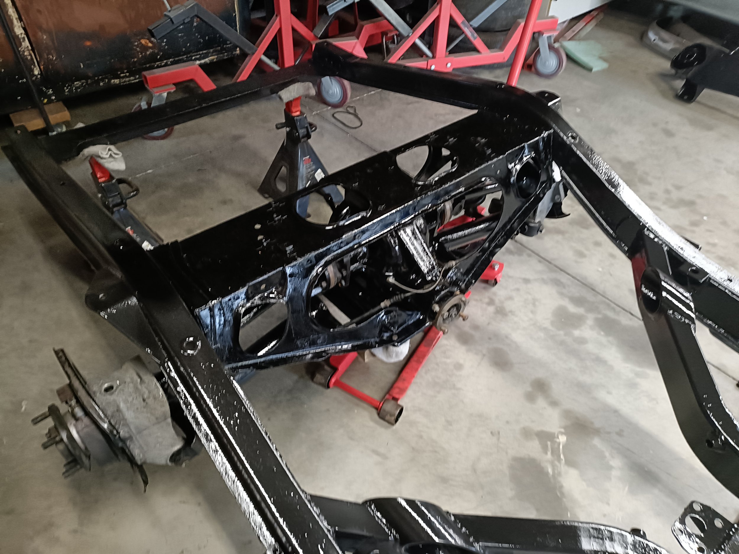

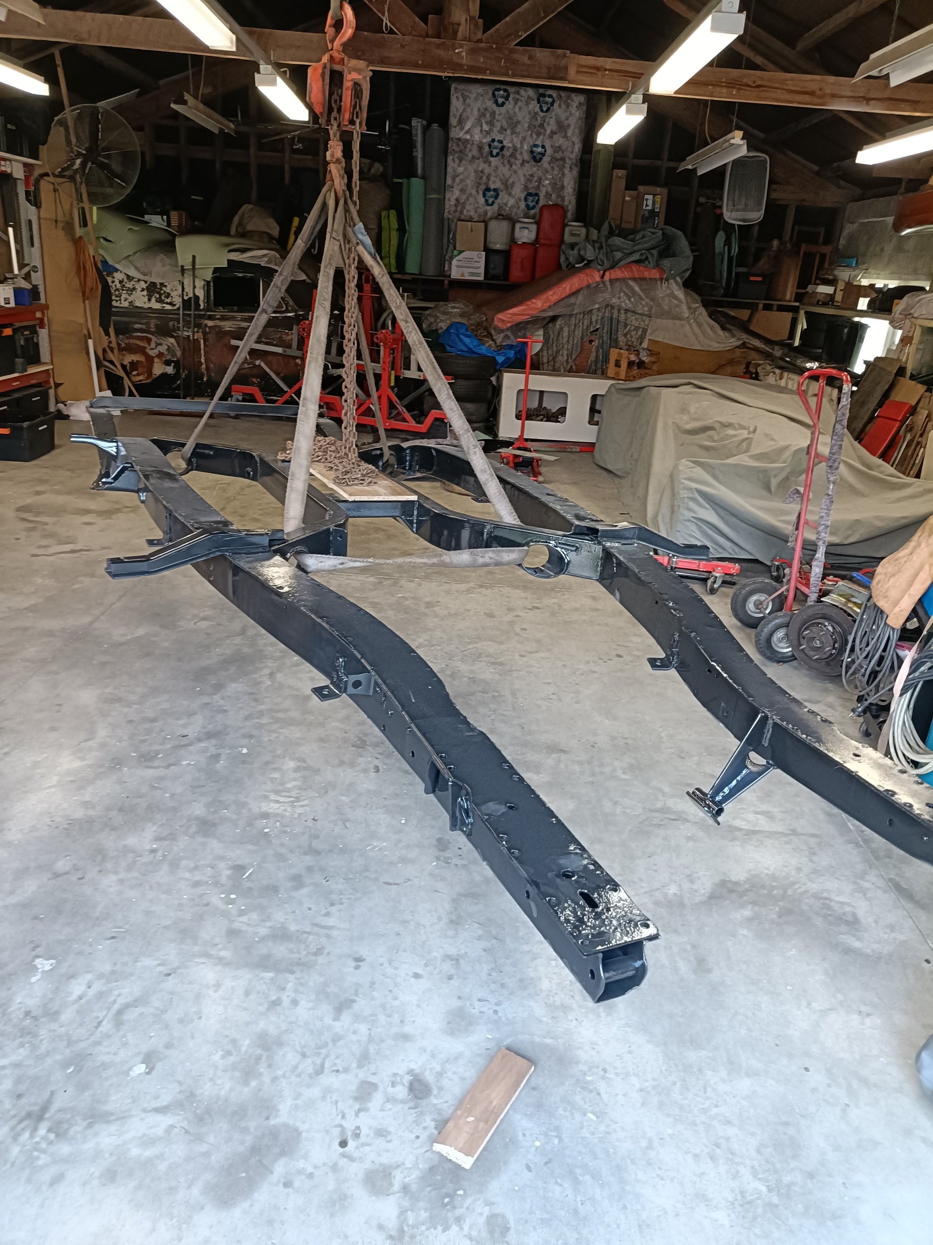

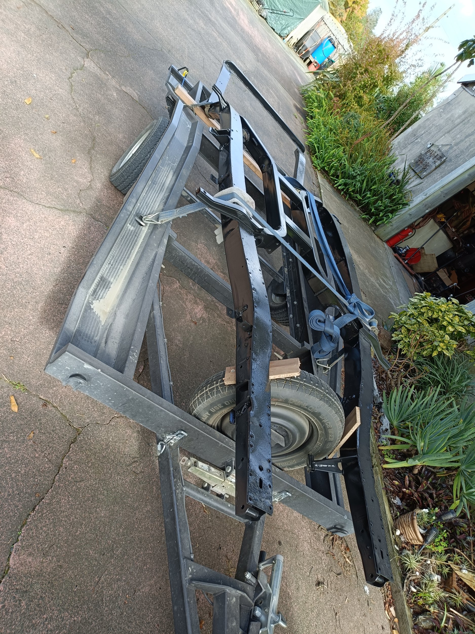

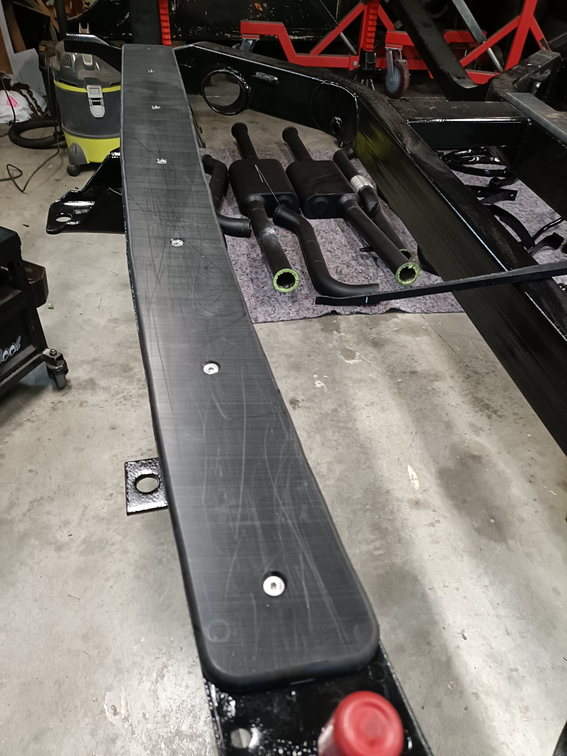

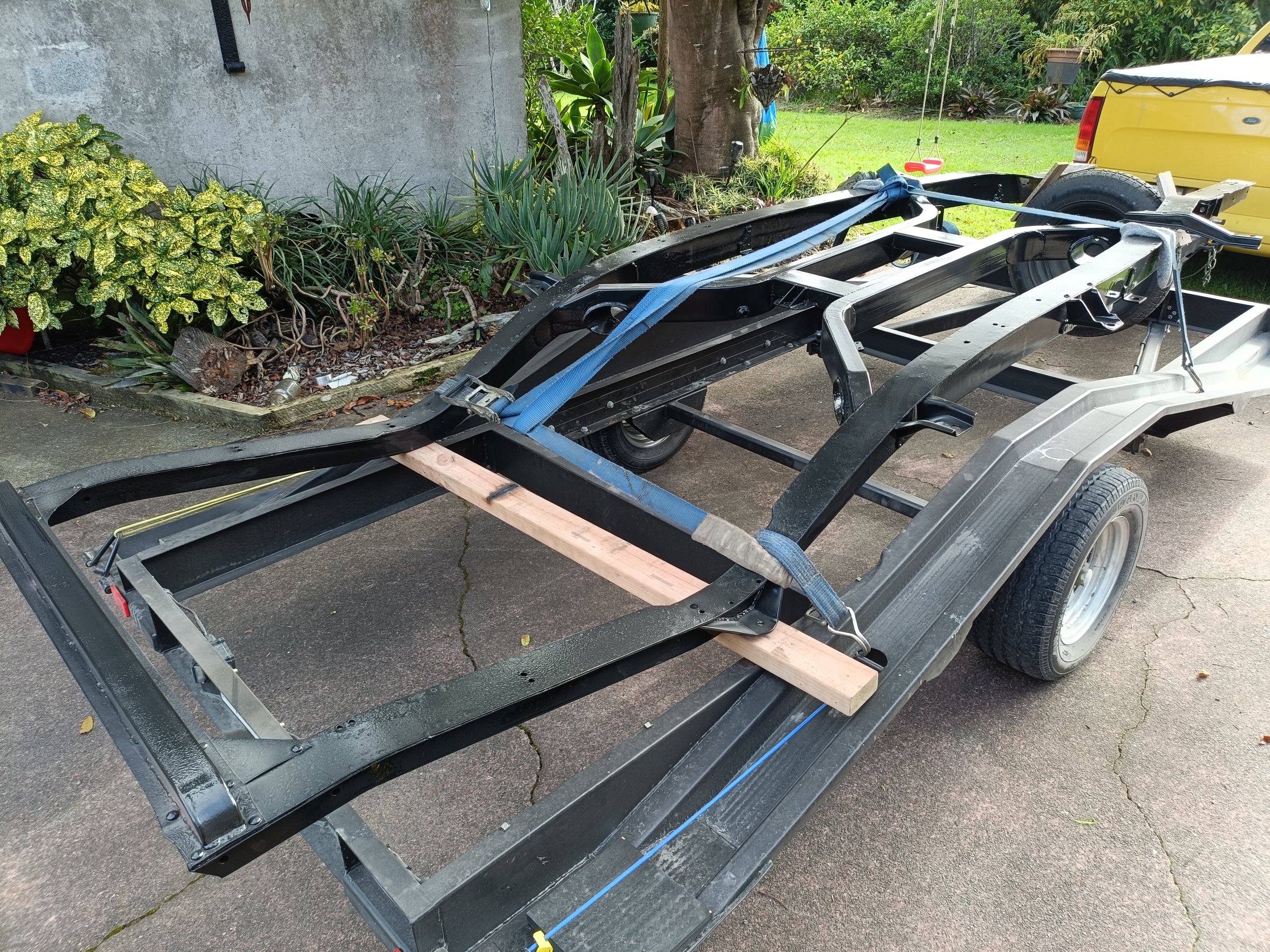

    Today we picked up the ch***is from the painter. So after a major shuffling of the deck chairs it is back in the shop, down side up on stands so I can add the UHMWPE strips to the underside of the rails without having to lay on the floor.
    Black, shiney and coated in dust from the unpaved road.
    The package of UHMWPE turned up on the courier as I was unloading the ch***is.

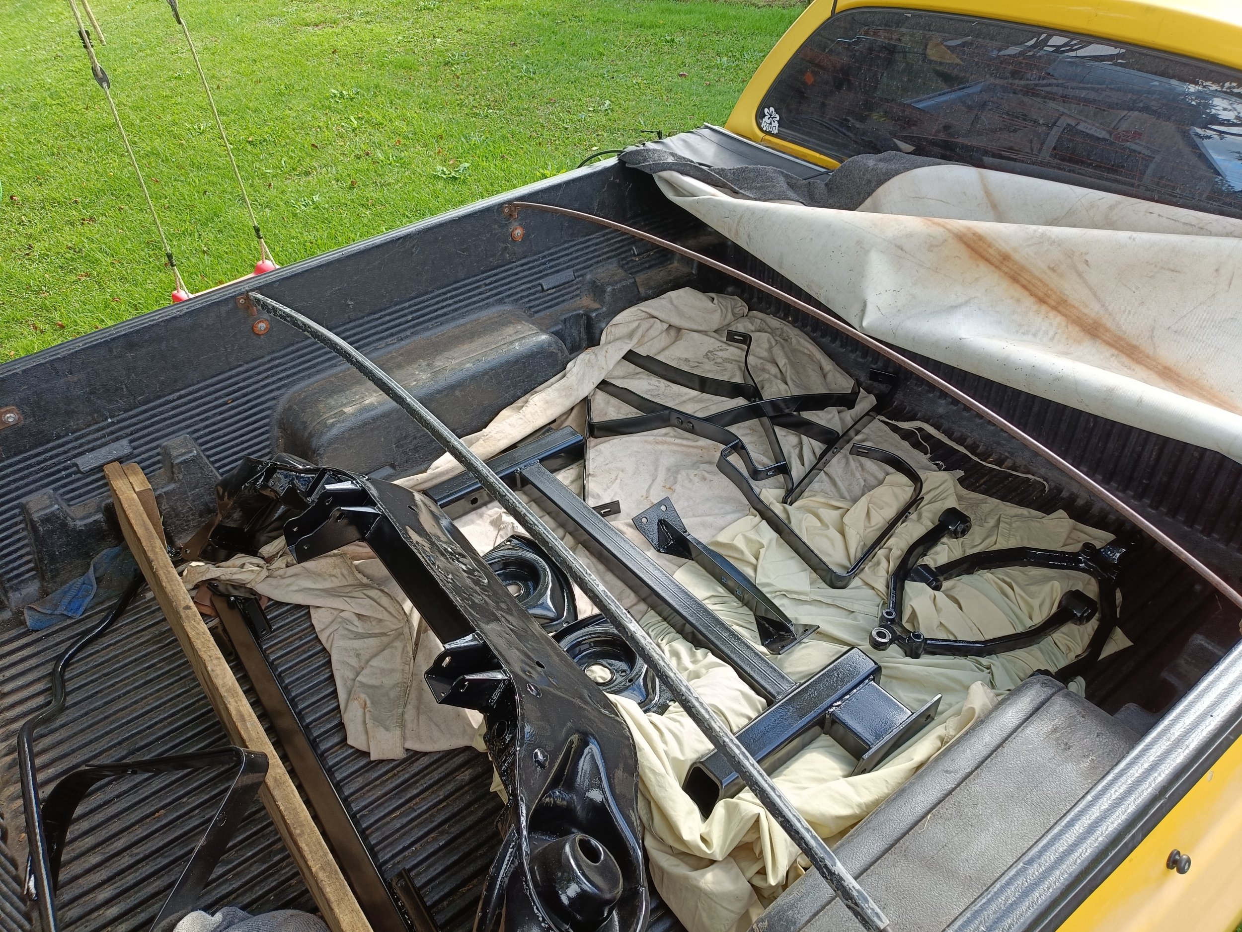

    Slung on the hook to get off the trailer.
    All the ***ociated pieces in the back of the ute.

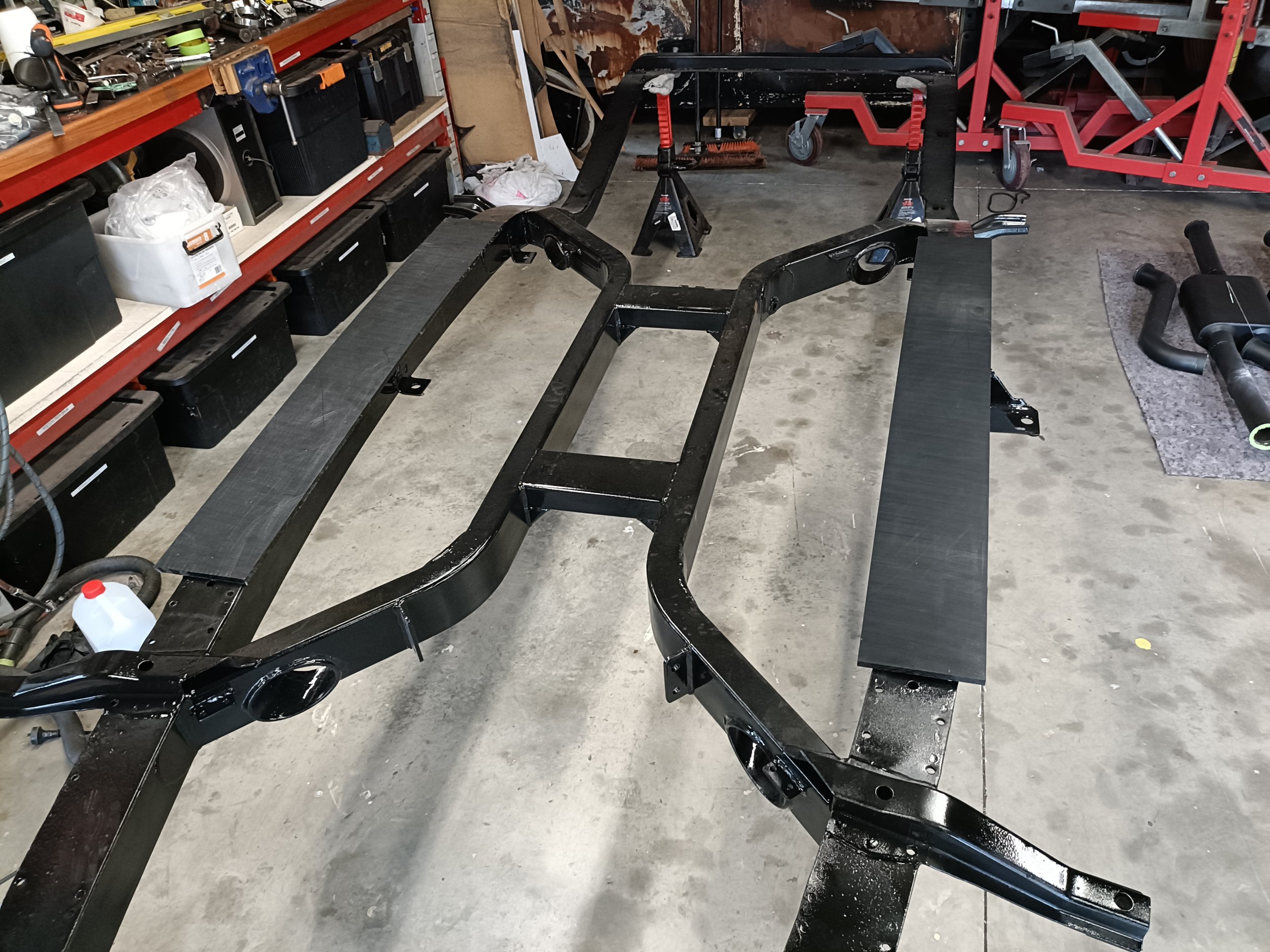

    Back on the stands ready for the strips to be fitted.
    One side done.

    High density polyethylene for when the bottom side of the ch***is inevitably comes into contact with the ground when around speed humps I can happily drag the car over them without damage to the car.

    I had a couple of pieces of off cut material, so made a couple of narrow strips to go under the center cross member as well.
    All done with the UHMWPE strips now so time to flip it over and get back on the job.

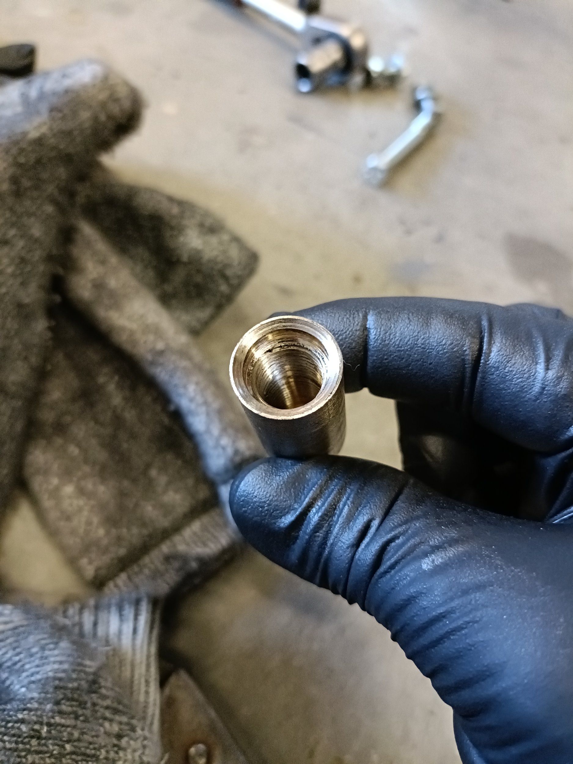

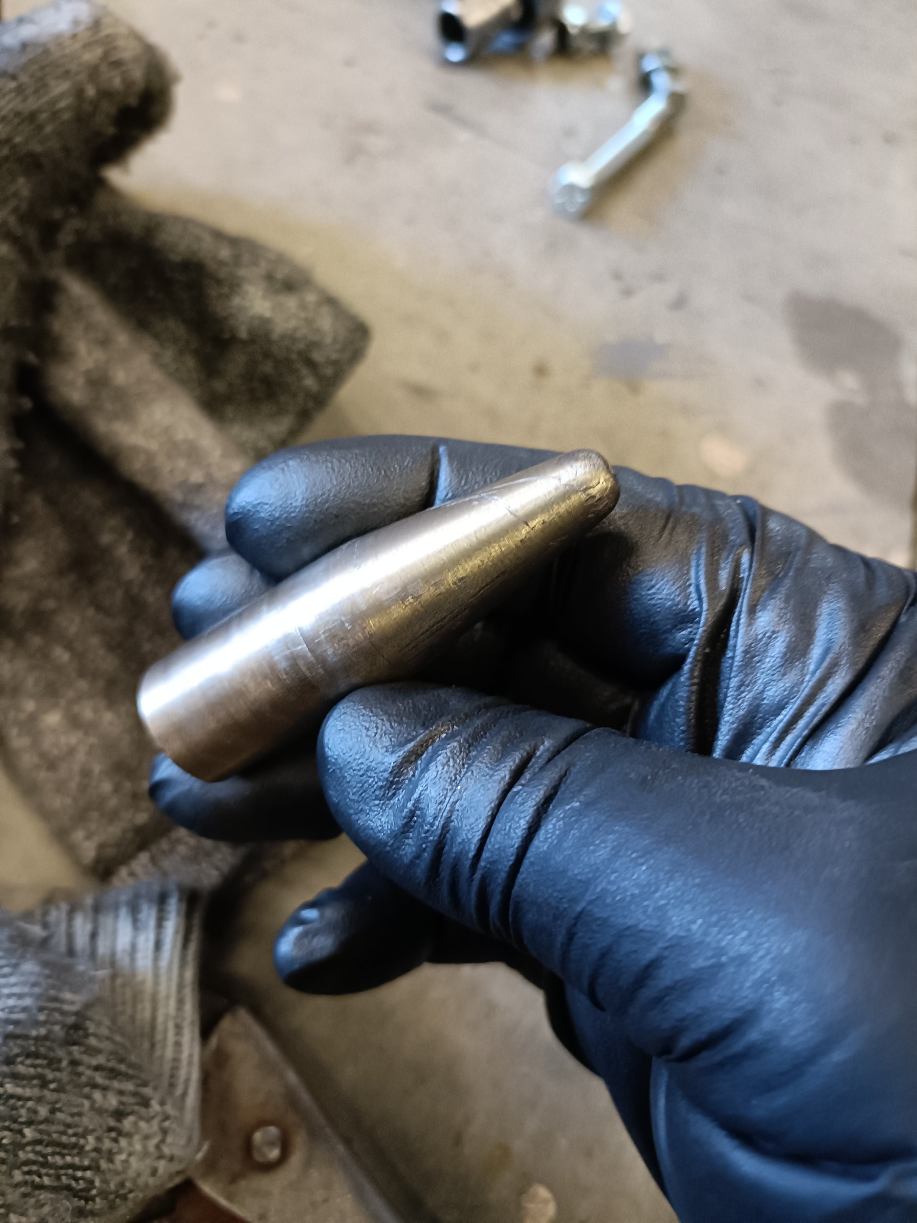

    Once I bolted the cross member back onto the frame I started to re***emble the arms etc. Getting the main pivot back through the cross member and lining up the washers was made a lot easier with this bullet that threads over the nut end of the shaft.
    Machined and tapped to fit over the 9/16" thread.
    Once the shaft is in position the bullet simply unthreaded and landed in the drawer with all the other specialty tools

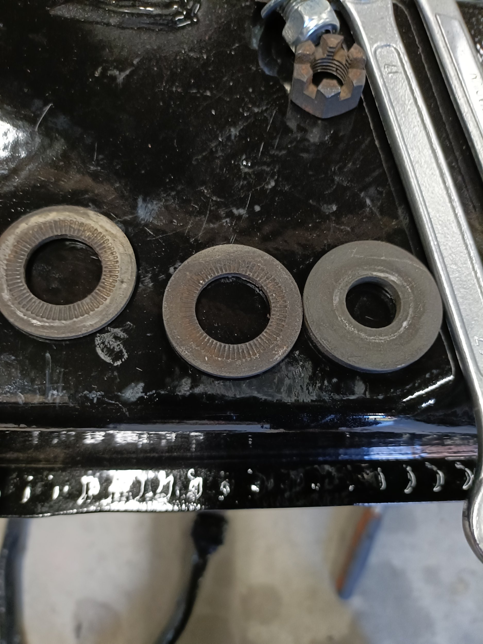

    One each of these 2 go between the bush and the cross member tube, then the small hole one goes under the castle nut.

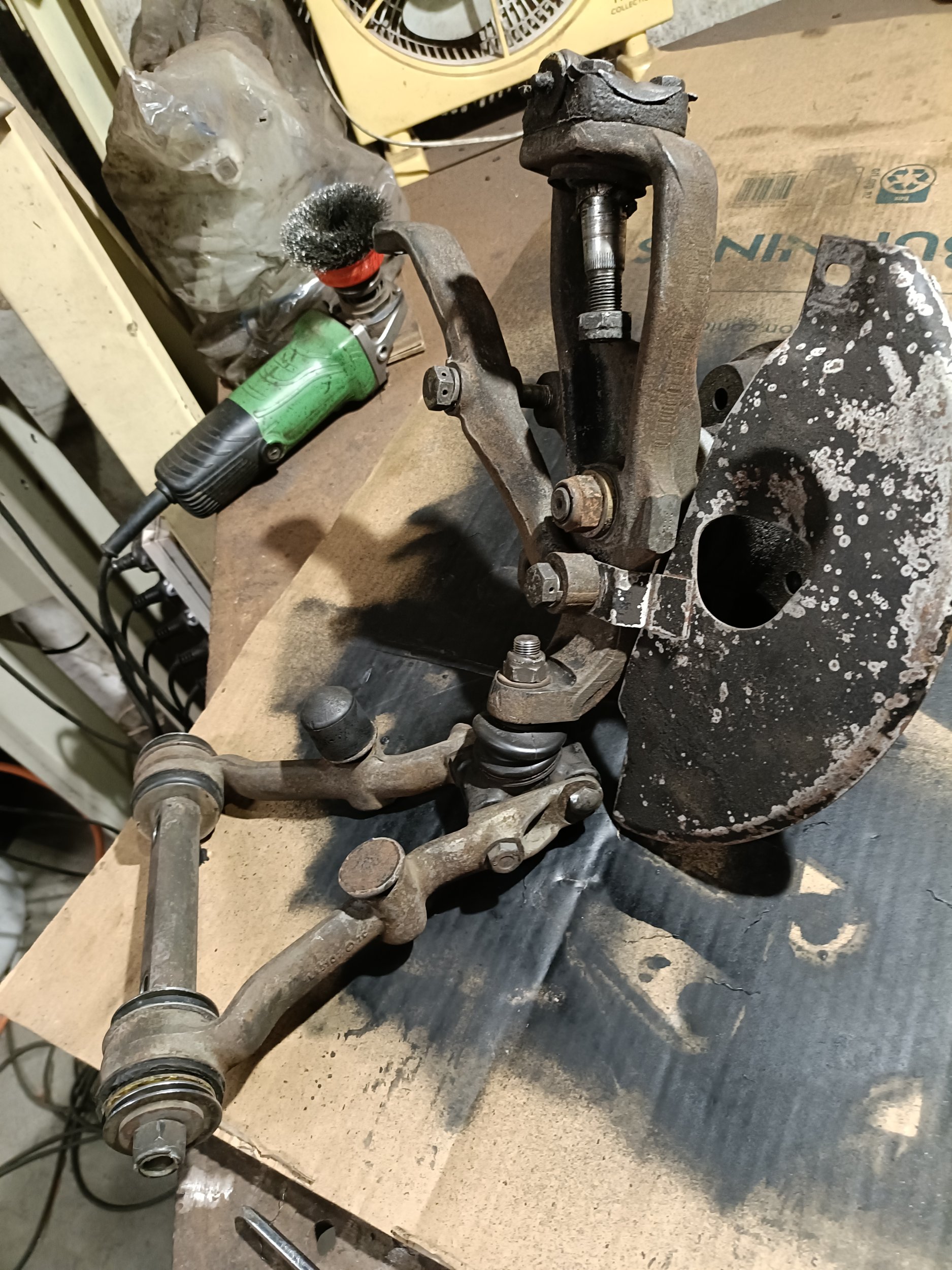

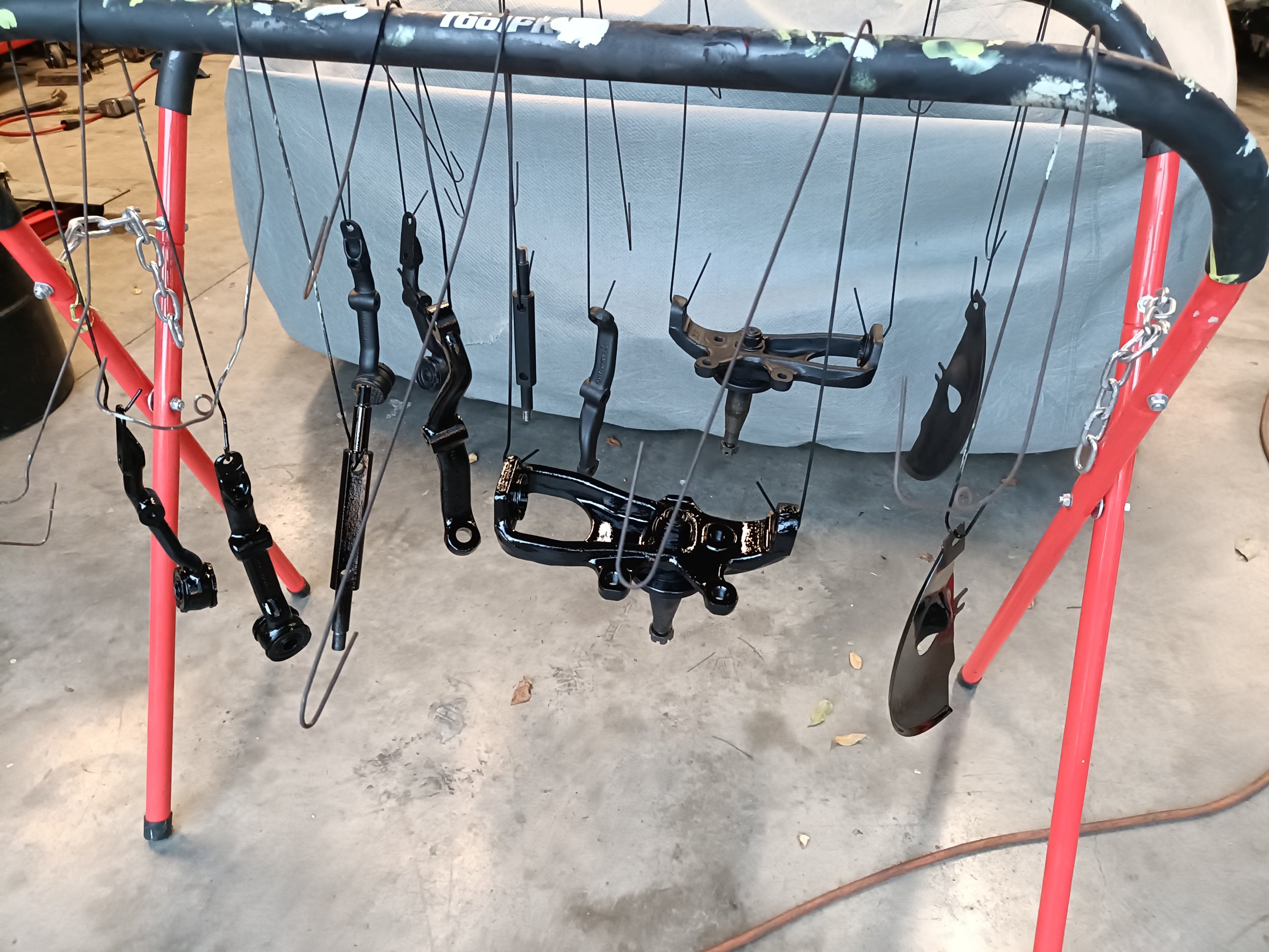

    Continuing with the ifs parts, the obligatory reference picture for later.

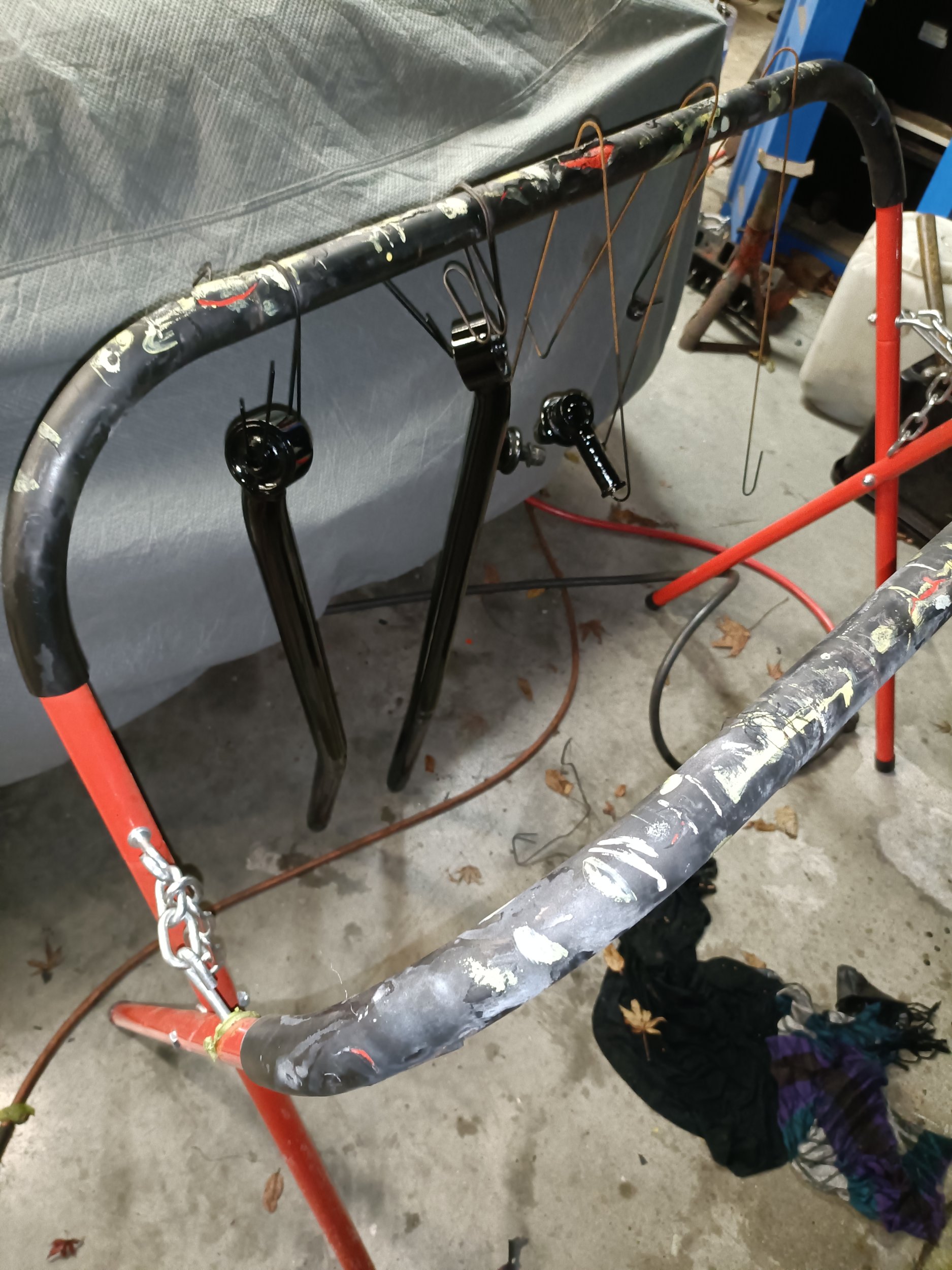

    All the bits have been through the mol***es bath and are now getting a comprehensive and thorough epoxy rebuild! Don't worry, I have ordered new top and bottom ball joints.
    More ***embly tomorrow.

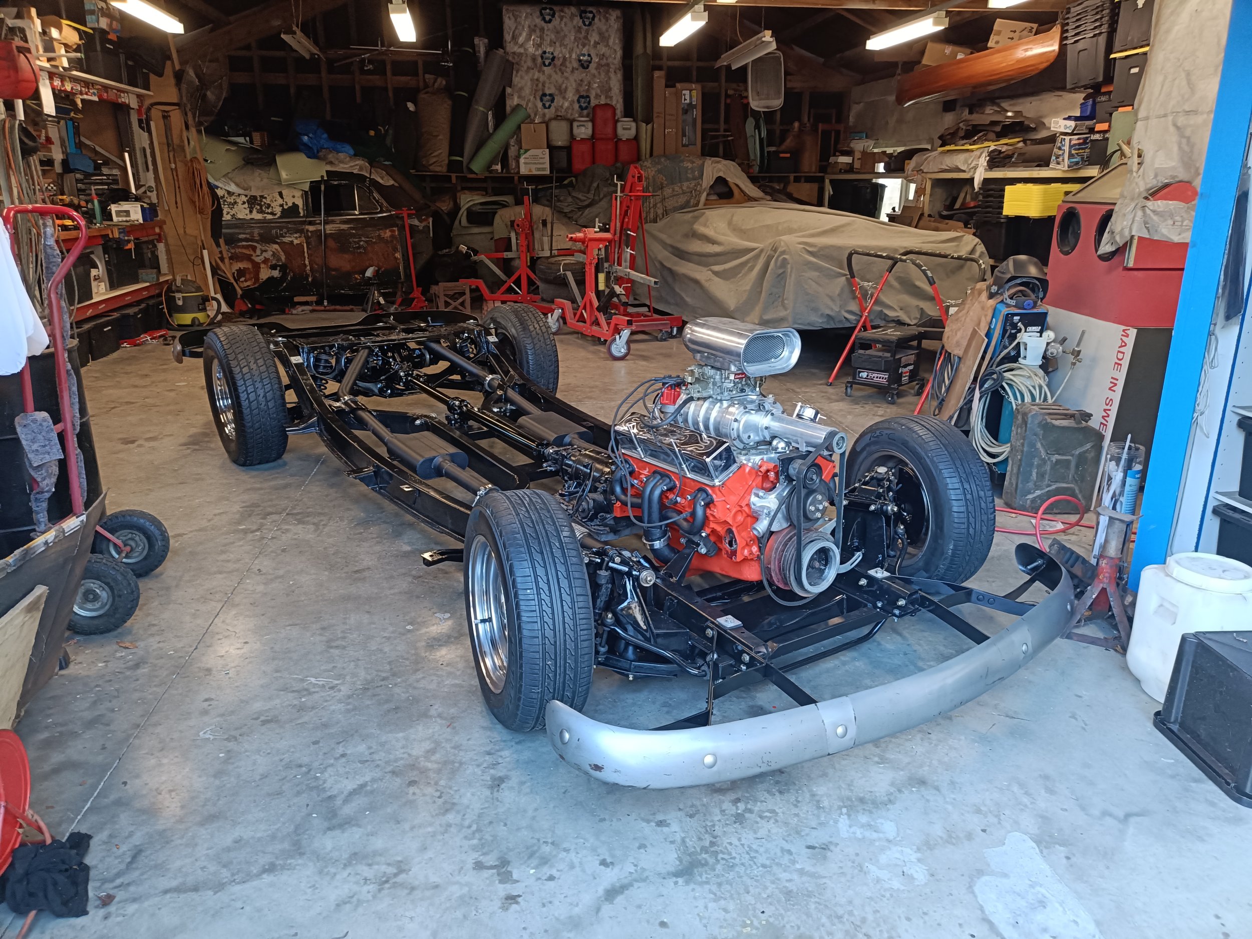

    Delivering the kiwi goods today! A sneak peek for the team.
    On a set of borrowed wheels and tires from a club members 57 nomad.
    A couple of small jobs to do on the rear bumper over riders/tow hitch points.
    No front springs yet, just sitting on the bumpstops. Like a snow plow!
    I am painting the radiator support bracket and a 6 cylinder radiator out of the coupe to help complete the look.

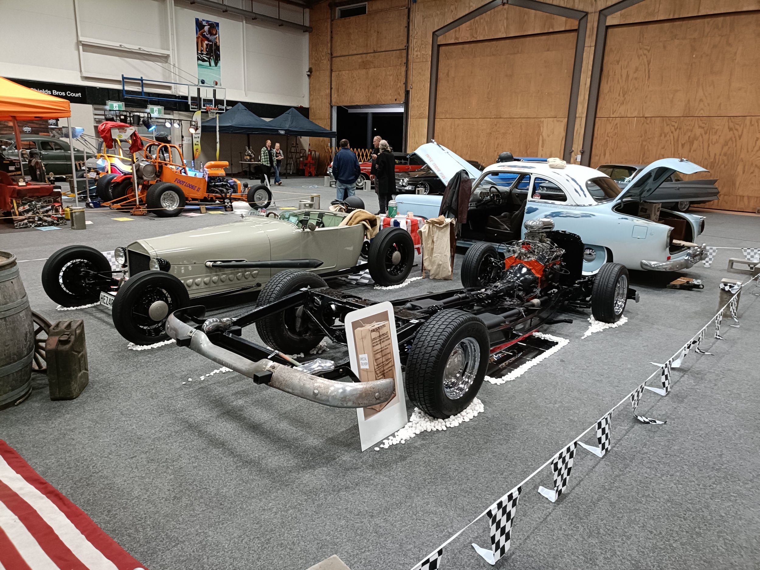

    On the trailer and on the way to the hot rod round up.
    All set up with the flock ready for the beady eyes in the morning.
    Nice little comparison, from run-about, to racecar! My friend set up his 27 roadster next to mine!
    The ch***is looks pretty good too!
    Looking forward to a couple of days of talking **** and hanging out with our car mates at the show.

    A great couple of days at the round up. All packed up now and back home in the shed. IMG20250621141937.jpg
    We had a great time shaking hands and talking cars.
    The ch***is got a piggy back ride home behind the coupe.
    The fleet all out and about made the workshop look a bit empty.
    The club did an amazing job all weekend.
